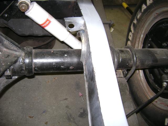

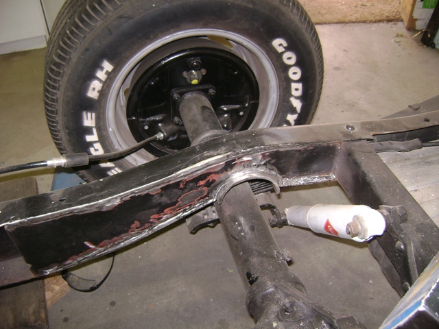

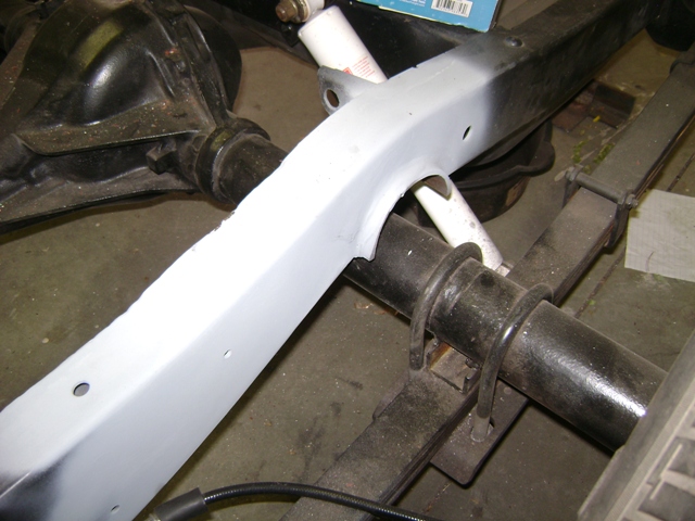

    Really neat job Gary! You did a bit of rearranging and flipping things around, and it all looks like it came together pretty good. I have the same rear end, but the shocks are behind the axle. It made room for the gas tank on your modification for sure! Congrats! - Bill

    I used KYB schocks made for a 66 Ford Econoline van and cut original shock bracket and welded the brackets on to the spring clamp sorry for the ****py pic's

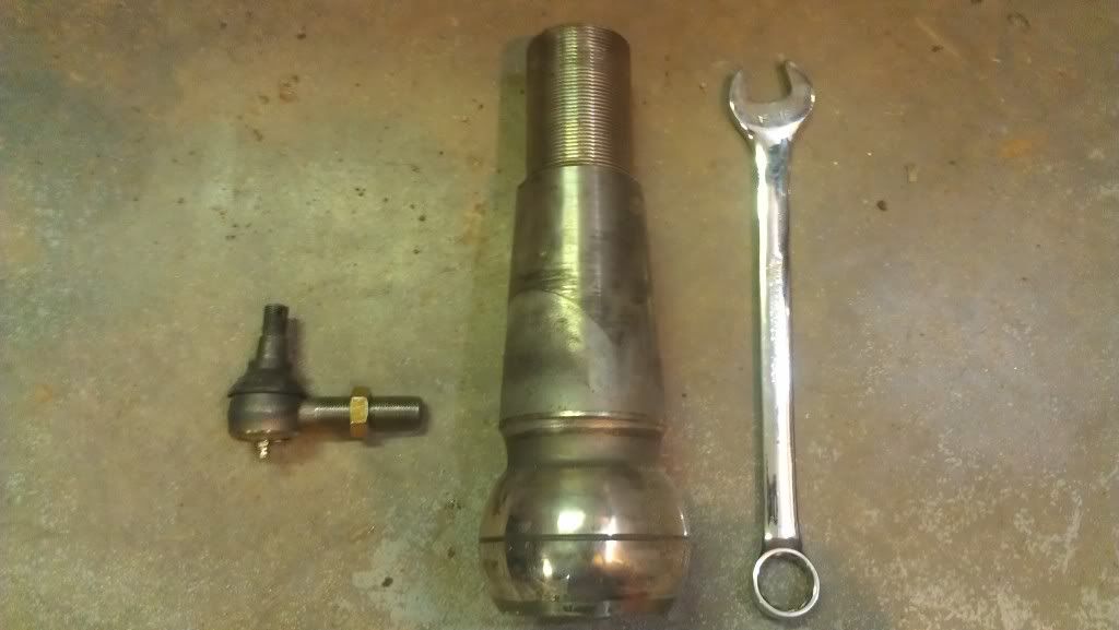

    my tie rod end is swollen! hahaha thats a 15/16" wrench. my buddy who works at Cat dropped that off today. BTW harbor freight spot cutter works awesome for $5.

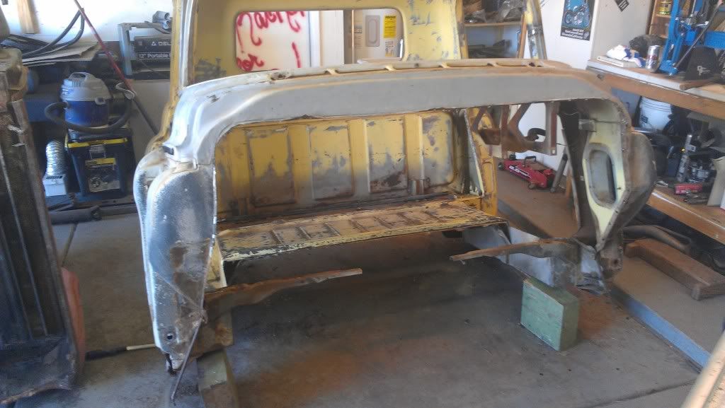

    97 firewall spot welds, 12 beers and a couple tokes later. whew glad thats done. now just need to finish cutting the front floor pans out of these cabs and start the surgery.
    the cancer thats coming out

  18. dubie
    Joined: Aug 17, 2004
    Posts: 698
    dubie
    Nice to see some more progress bud. Looks like you're finding the cure for cancer as you go along.

  20. sqrlnts
    Joined: Apr 2, 2007
    Posts: 314
    sqrlnts
    Thanks Dubie, This would all probably go much smoother if I knew what the hell I was doing!
    It really is, you can roll them around to get the best angle of attack. Plus I needed the two cabs together for reference.

    Some more cab butchering! I have made some datum points on the new cab for the lower door hinge and the cab mount hole. Hopefully it helps to align the new cab corner once this turd is out.
    Started to make some cuts to remove the good 57 cab corner. I find it funny that only the RH front cab corner is rusted to hell. Maybe this thing spent its whole life driving around Mississippi with the right front in the muddy ditch!!!
    Also removed a "small" hood valence piece from the donor 57 cab as the "good" 58's cab is damaged. hmmmmm good is so relevant isn't it......
