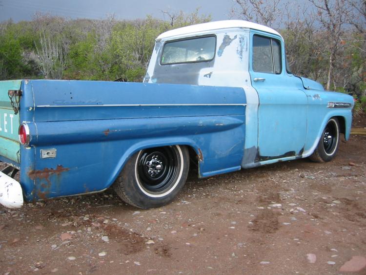

    I rebutchered the existing radio hole with a patch panel from the old cab, sorry no pics, trust me its a hack weld job. I have found a new problem, I want a 57, fleetside now...... Hmmmmm maybe Santa can drop a 58-59 short fleetside box down the chimney??!!???.....
  19. sqrlnts
    Joined: Apr 2, 2007
    Posts: 314
    sqrlnts
    Yup
    Damn, these things are uncommon, cause this one is ugly and I still like it....

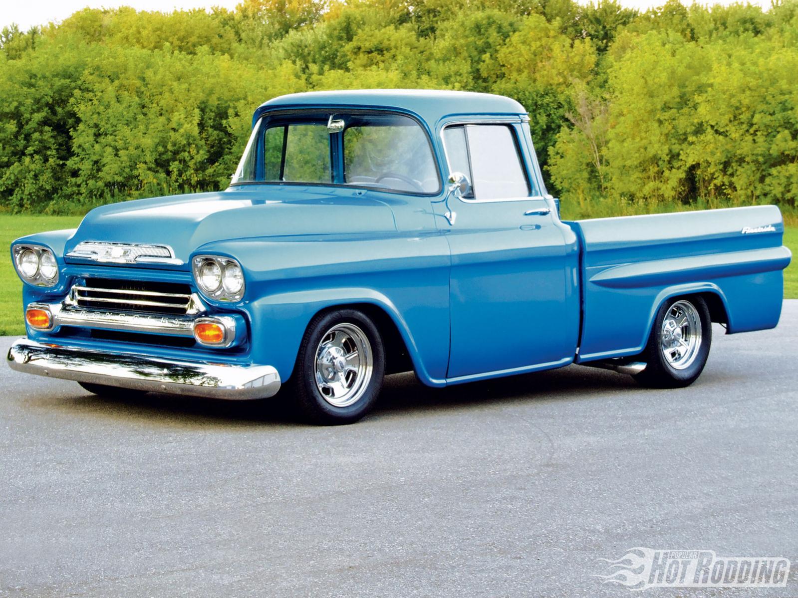

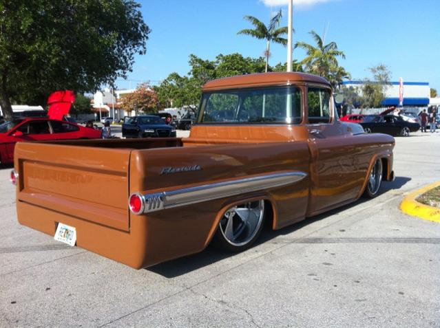

    it took me 6 years to find a nice rust free short fleetside bed to replace the original rusty one on the back of my wifes 58 GMC. I prefer this style of bed to all others in the 55-59 era. I had even thought of doing the body work on the rusty bed and spraying it to match my 56 body so I could swap between a fleet side and a step side
  22. Shane Spencer
    Joined: Oct 3, 2009
    Posts: 2,160
    Shane Spencer
    1959 apache on here told me he had a lead on a fleetside, shoot him a pm. Maybe he can make something happen for ya

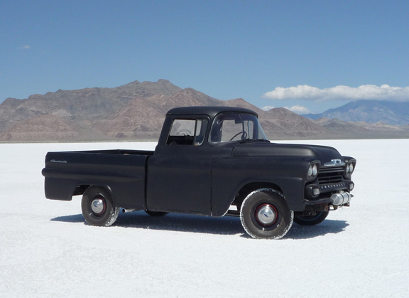

    yes it does lol. 396 would be bad***. for me, a 4x4 is a work truck. thats just the way its intended in my eyes, and other than traditional hot rods and bikes, my other interests are diesels. particularly ***mins, and old detroits. a 6bt ***mins is without a doubt the best engine for a work truck imho. ridiculous torque and un questionable reliability. heres a 58 napco with a 6bt. killer ride. my apache is a total 180 from this one but damn, i would love to have this truck.
    dont mean tyo jack your thread man. back o/t
