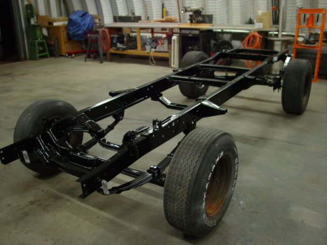

    BTW, the frame above is bare metal, still needs painted. My neighbor came over, sit his beer on the frame and said "They did a good job on your primer". I said its bare metal, now drink your beer!!!
    Did my best at straightening the slightly bent front left frame horn, I think it will work. Finally, like 3 hours total time, removed the rear most ch***is cross brace rivets and brace. Those damn rivets are some work!
    If I am going to run an automatic trans do I want to remove the bellhousing crossmember rivets and brace? I purchased a new auto trans crossmember from LMC a while back which is weld in.
    I am contemplating running the existing ch***is and rear axle brake hardlines, is this a bad idea as they "seem" to be in good general shape? I ordered replacement front (2) and one rear (all the same PN from LMC) hydraulic flex lines. Problem is the tee going to the newer style 12 bolt rear end as the shot hose is crimped on . I need to research if a standard 3/8"-24 brake tee will work for all three male fittings.
    sorry no pics

    You probably do want to remove the bellhousing crossmember, and add a new one under the back of the trans. And use side mounts on the engine too.
    I'm running original brake lines on my old AZ trucks. If you find any rust or other issues with them, replace them...better safe than sorry.

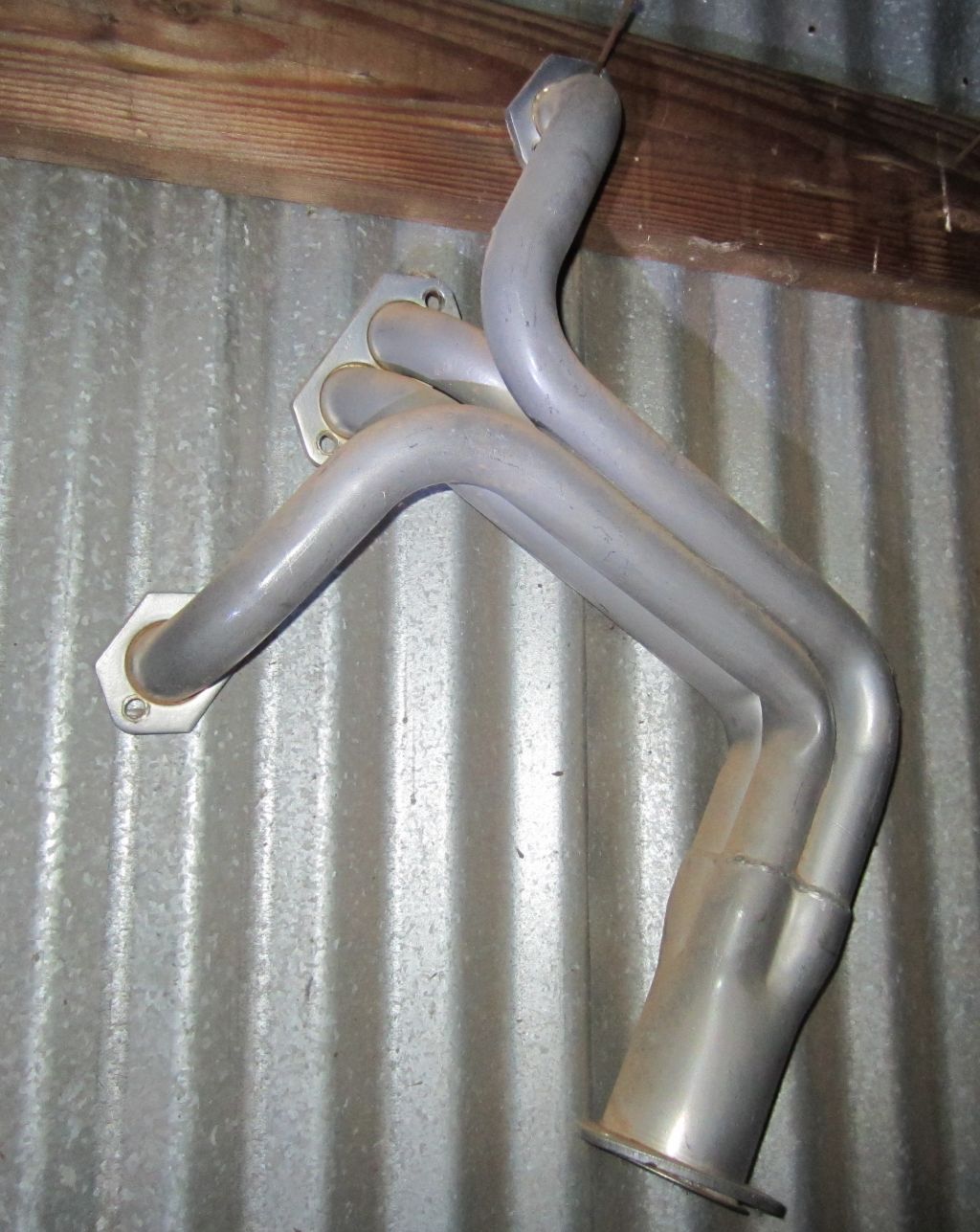

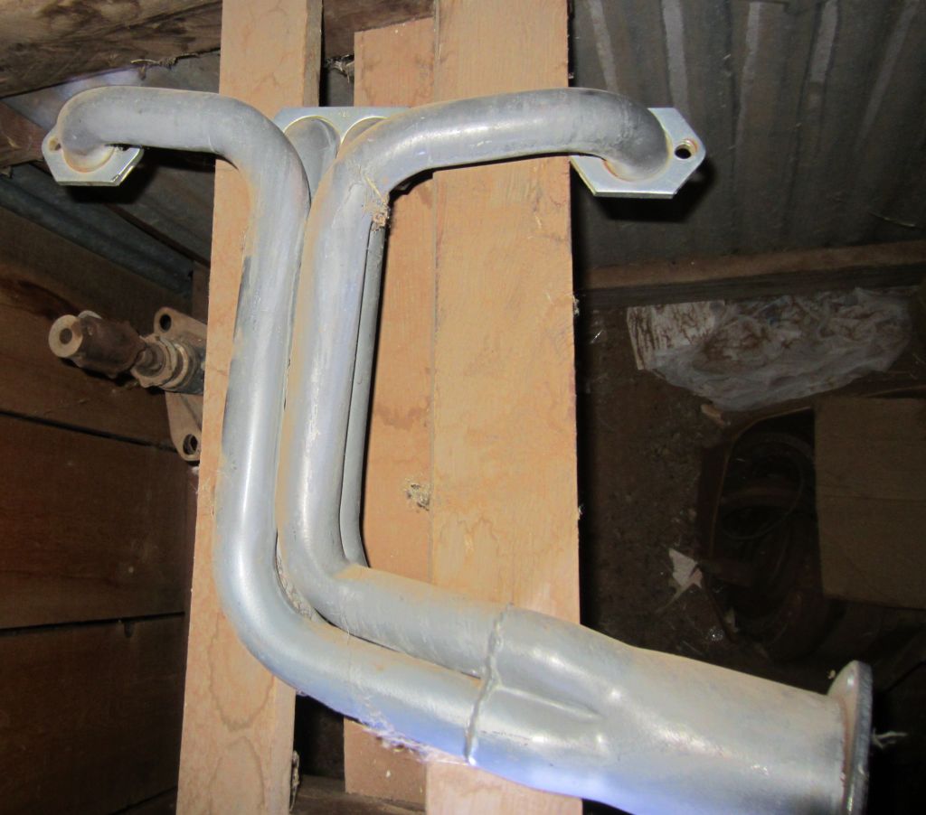

    Here are those headers I have...

    Thanks Jim. I am interested in the headers. Do you have any trips to Phoenix planned in the next couple months? I am heading to Yuma on the 14th of this month but that doesn't help much.....just trying to duck shipping costs
  22. squirrel
    Joined: Sep 23, 2004
    Posts: 60,994
    squirrel
    My kiddo might be visiting next weekend, he lives in Chandler and could bring them up for you
