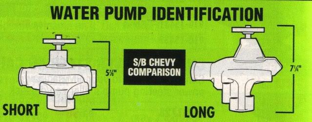

    Plan to clean out the nuclear waste in the gas tank.
    dump in lacquer thinner; add about a dozen hex nuts; shake thoroughly for a few minutes; rinse with acetone.
    The nuts act as an aggregate to loosen the sludge. The acetone rinses the lacquer thinner's residue. remove 12 hex nuts.
    Short vs long water pump

    I have a long water pump and plan to use 2 belts. One for the A/C and one for the alternator. The engine came with a 3 belt crank pulley. There looks like there is enough space to cut the third pulley off which would give me much needed room on the front cross member. Cut it, or wait to see how things come out with the engine mocked up?

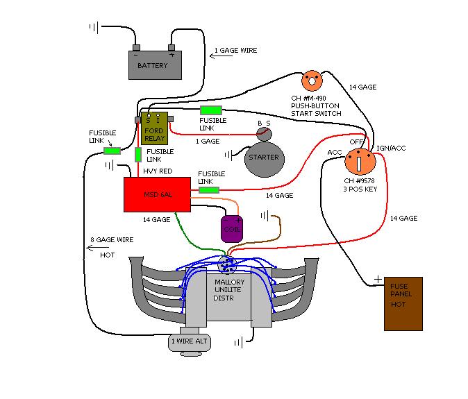

    I was looking at that print. Kinda confusing because it shows the distributor & key switch more than once.
    I made up this print on how mine is wired. I was able to eliminate a bunch of wire & the external regulator by adding a 1-wire alternator. I'm also using a Ford starter relay at the battery so the 1 gage starter wire isn't always hot. I also added 4 fusible links near the battery for safety. I'm using a Cole-Herese 3 pos key switch (Acc-Off-Ign/Acc) & a push ****on starter switch. I listed the p/n's on the print.
    This is a standard hotrod wiring diagram with an MSD box. Will work on pretty much any carbed car or boat
    BTW- this only the engine electrical. I did not include the body or lights. You should get the idea though

    Thanks tjet, I appreciate the diagram. Want to simplify as much as possible.

    Thanks TJET, interesting read on the fusable links and the ford solenoid. That sounds much safer and more reliable for a hot *** climate like Phoenix.

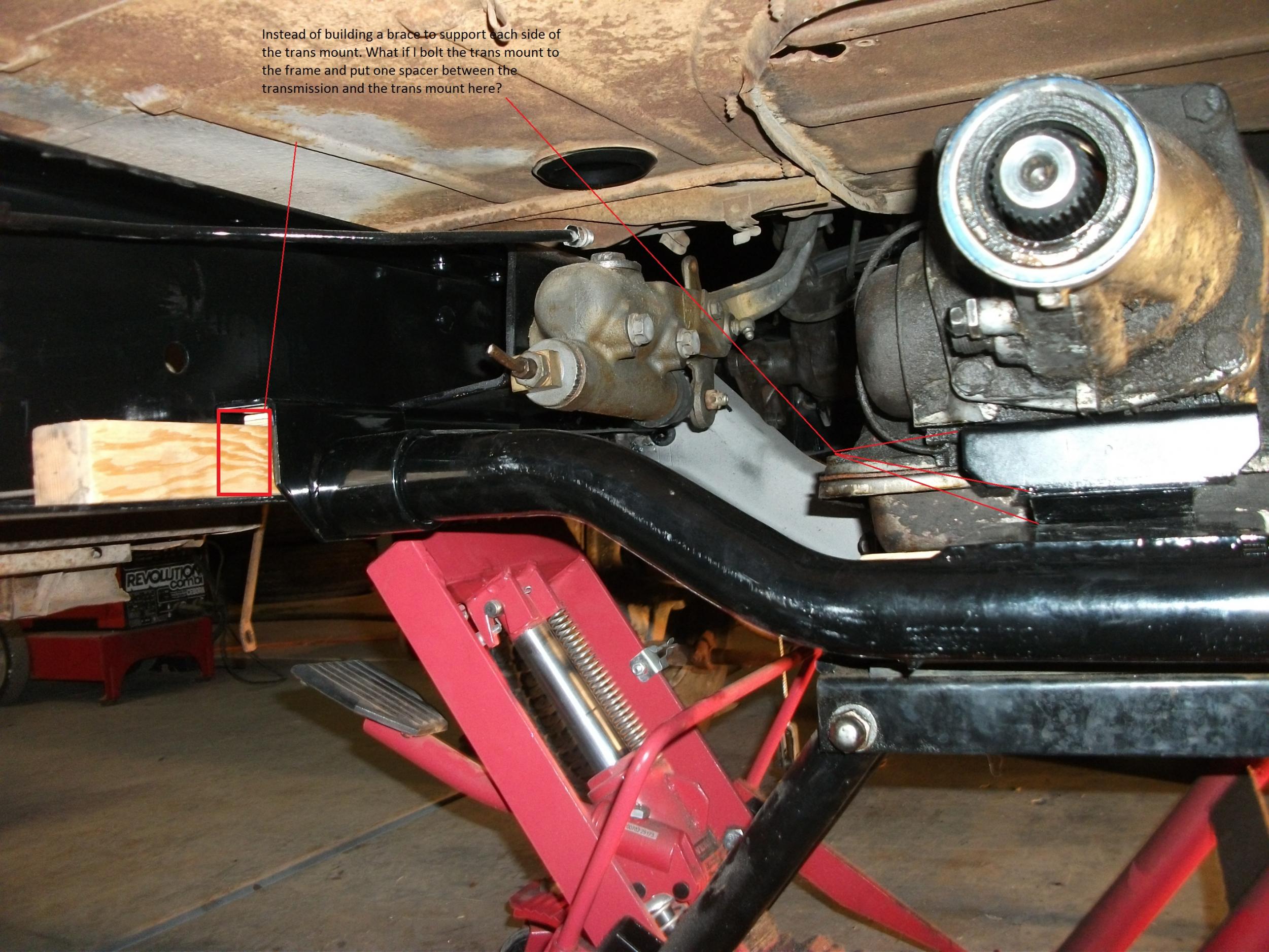

    Engine mounts are in and trans mount is mocked up. Trans mount didn't want to fit as nicely as I would have hoped. Tried it multiple ways and this seems to be the best of the worst. I will need to make some 1-3/4" spacers to take up the slack between the bottom frame rail and the trans mount.

    Chris got me thinking about the trans mount last week. Instead of making two spacers for the ends of the trans mount to go between the frame and the mounts on each end. What if I bolt the trans mount to the frame and put 1 spacer between the transmission and the trans mount. It would lower the transmission crossmember by a little less than 2". The attachment shows the locations I am talking about.
    Bad idea?
