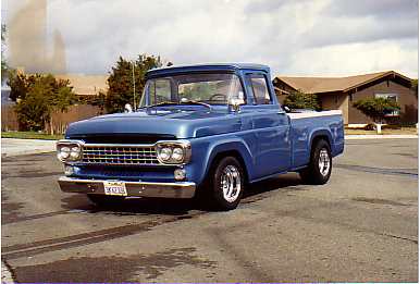

    I had a '58 and a '60 (see pics). I also had a '59 and a '57 at one time.
    I was getting things together to make a mild kustom of the '58 when a divorce forced the sale of it and allot of other stuff!
