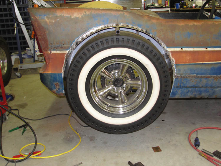

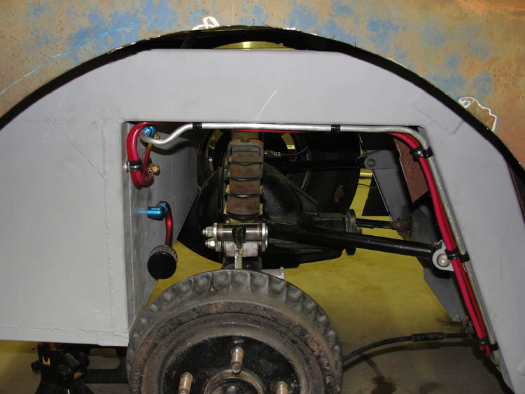

    And a little more.... Started building the inner fenders for the rear. Rolled some 18 guage, left it extra wide to weld it in. No, I am not building fender flares here! :D After they were tacked in good I trimmed the excess off. Then I rolled some round rod so the fender opening would have a lip, thought it would look better than just looking obviously cut out. Welded those in. Didnt get a pic of them with the round rod welded on though. Will finish the welds out this weekend hopefully. Also still need to cut the pieces for the inner part and weld those in. It has about an inch and a half clearance all the way around the tire. I think it will need a little more than that above the tire to keep it from rubbing but thats easy enough to address, add one more leaf from the extras laying around after I combined parts of 2 spring packs to make 1 good spring pack.

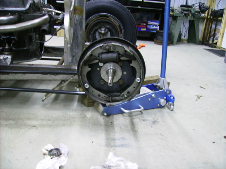

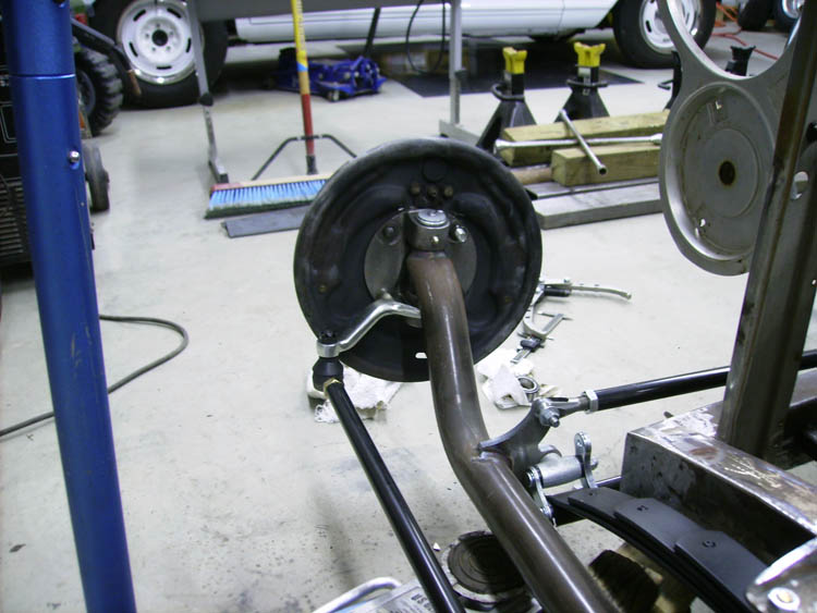

  15. Racrdad
    Joined: Jul 27, 2007
    Posts: 1,208
    Racrdad

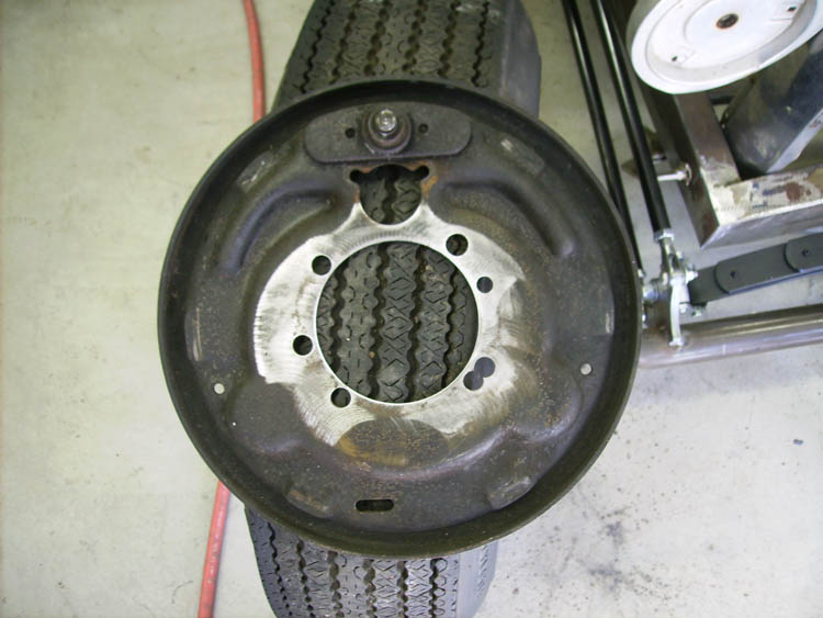

    After looking back thru some pics on my computer I realized I never make a post for my front brake swap. I picked up a set of 56 or 58 T Bird brakes (I cant remember now) at a swap meet. Guy had done a complete rebuild including drums, drove it one and did a disc brake swap. Both sides complete spindle to drum for $50! Figured it was worth a shot at that price.
    First I had to make the hole in center larger. I had some 40ish backing plates so after some careful measuring I discovered one bolt hole was already in the correct location. After marking the new bigger hole size I needed I tacked a piece of steel to the backing plate so I could clamp in the drill press vise. Cut out a bigger hole with a hole saw, cleaned it up. Welded up the old holes. Loaded backing plates now installed. I put a set of the disc brakes adapters from Speedway on the spindles. Had a problem though, the T Bird hub sat in to far anf the drum bottomed out against the shoes. Tried some various hubs I had laying around to no avail. Left it alone for at least month. Ended up buying some spacers from Karas Kustoms to space the backing plates away from the spindle. Still not quite exact on the spacing. JRacer gave me a drum brake setup from an old Mustang he had done a disc brake swap on. Well what do you know, the hubs and drums are just what I needed. I now had brakes!
  16. Racrdad
    Posts: 1,208
    Racrdad
    A few pics of the brake swap. In hindsight this was such a pain I should have just bought a complete brake kit from someone but figuring stuff out on my own seems to get the best of me.
