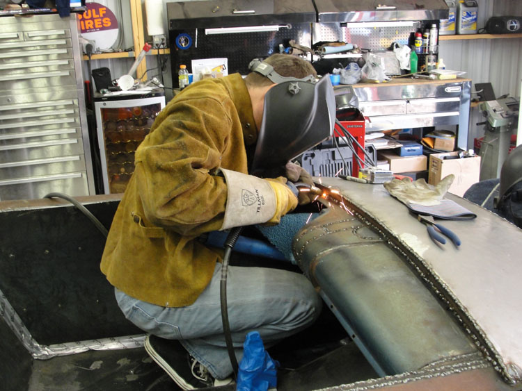

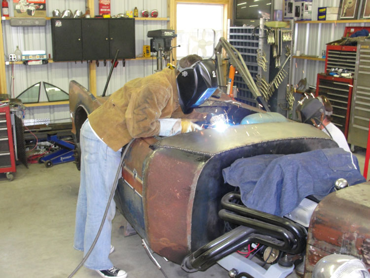

    Robelitica and JMD82 came in from Houston on Friday. JMD82 got to welding right away. I think he was already wearing a welding helmet when he got out of the truck because I dont even have a pic of him without it on! He kept way busy welding up all the seams on the body where it was just tacked together all this time.
    After the MG windshield was added earlier on in the build it ended up being farther back than the cowl was built for. Robleticia jumped right in and put a new top panel on the cowl extending it back under the windshield frame.
    Not only was it necessart but it also flowed much better with the car.

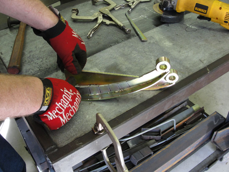

    JRACER1 showed up Saturday morning. I think he must have stopped for brunch or wine and cheese or something because he was 2 hours late!:D He jumped right in on tackling the where to mount the freakin front shocks issue that had been nagging me. Started with some Speedway brackets, cut bend weld, cut bend weld, repeat as needed.....!! Ended up with a multi-curved bracket that puts the top of the shock right up under the headlight where I wanted it. One thing about JRACER1, he never gives up, believe me this guy knows what it means to stick with something until you got it beat.

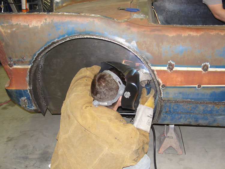

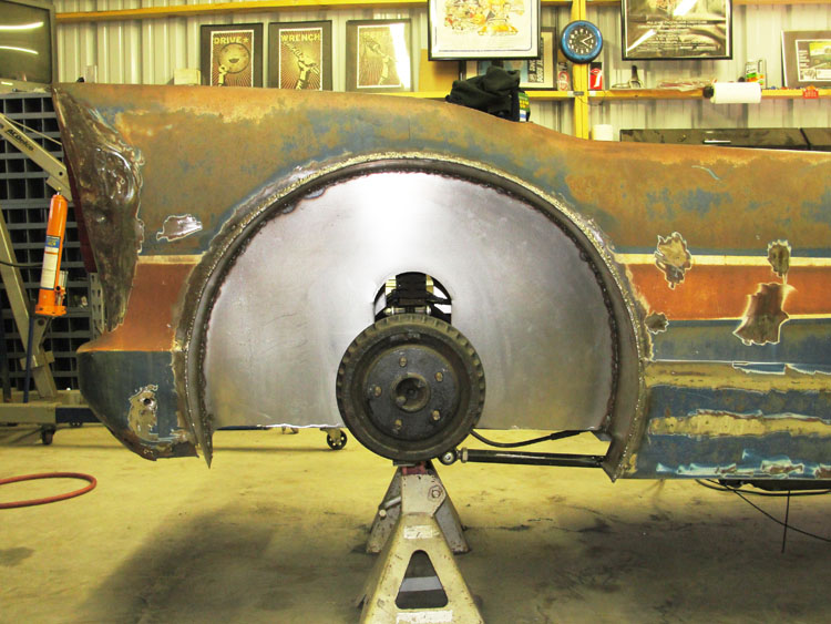

    Robleticia and JMD82 also put the inner panel in the rear wheelwells. What can I can except more great work guys! After they were welding in and the bottom edges trimmed JRACER1 jumped in and put a nice curve in them right above the rear spring.

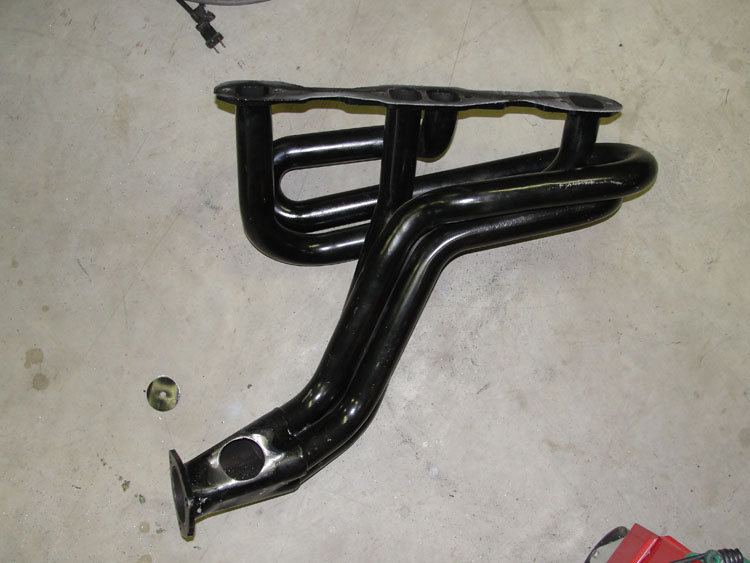

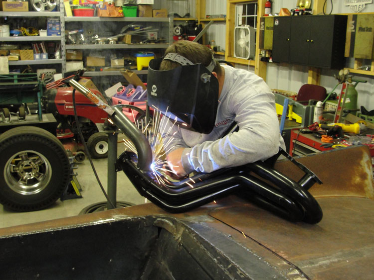

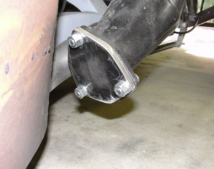

    The headers will be capped off and exhaust run under the car. There is a nice void between the frame rails and the outer rocker area. Robleticia and I drilled the headers and ran the pipes through the lower edge of the firewall. He tacked them in place, I held the pipe. I get all the tough jobs. :D Then he welded them up.

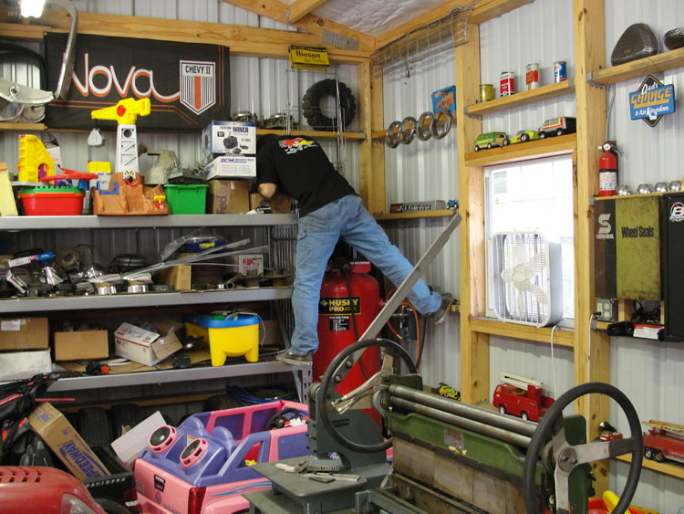

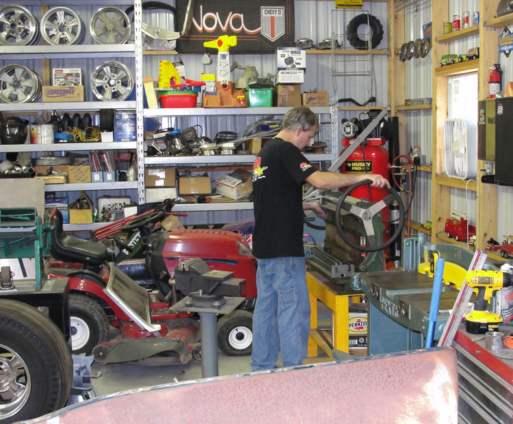

    The car still needed a rolled pan of some type in the back. So I marked up some sheetmetal according to where the body lines are where the quarter panels roll around to the backside of the car. It was done in two pieces since there is a slight peak in the trunk lid and below the trunk lid. Robleticia handled the welding and JRACER1 helped get it all in place correctly. We all think it turned out pretty nice. The taillight wont be staying just like they are in the pic, they make it look like a bat!

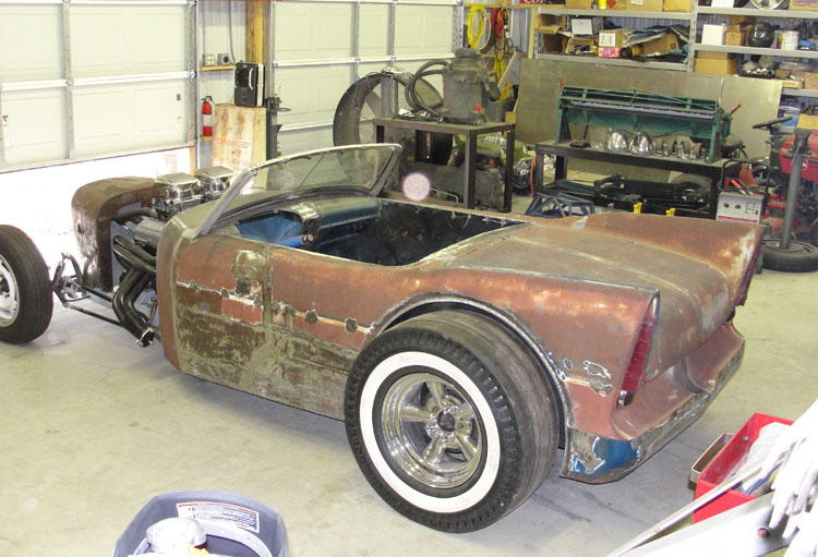

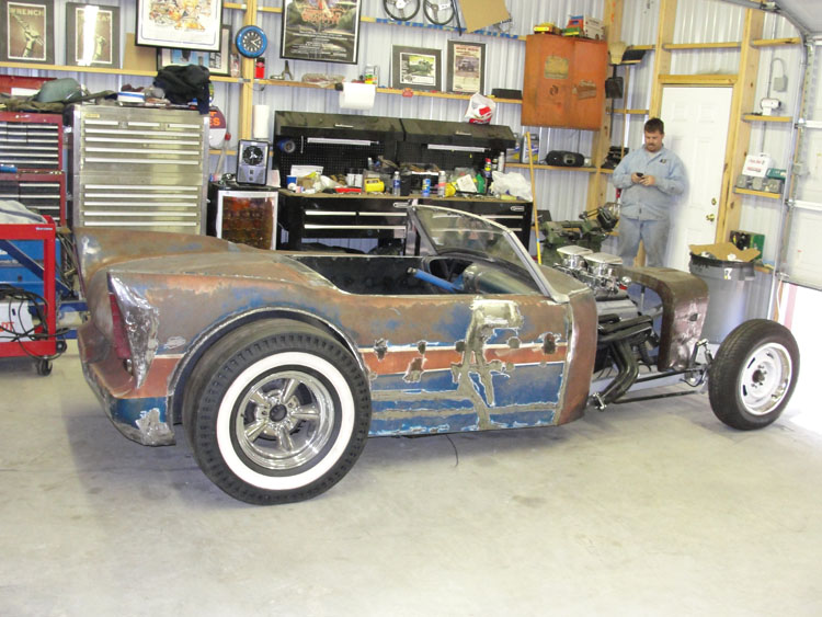

    After a long and very fun weekend with great friends and hard workers its getting real close to Rage Gold time. Strip off the rest of the old paint and it will be go time!! I cant thank Rob (Robleticia) Jonathan (JRACER1) and Jason (JMD82) enough for all their hard work. It was a blast!!! Thanks guys!!!
