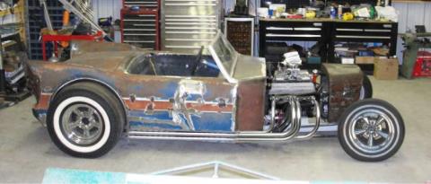

    I love the build although I have a question, how much travel do you have in the rear end ? From the pics it looks awful close between the tire and the wheel well. I am only asking because I had an issue with my Model A truck the rear end in my truck looked far enough away but when I hit any type of pot hole or bump it would bottom out against the frame. I put a few more leafs in my spring and it help me out.

    There is only about 1.5 inches right now but we are going to raise it another 1 inch in the rear. Also will put bump stops on it to avoid body / tire contact.

    *****SPY PHOTOS JUST RELEASED*****
    I cannot reveal my sources but here are some previously unreleased photos, I think his A.D.D. is giving him fits again.:eek: Note the headers with side pipes and grill mock-up. Remember, you didn't get these from me!:D HEHEHE!
