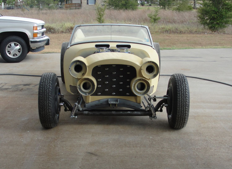

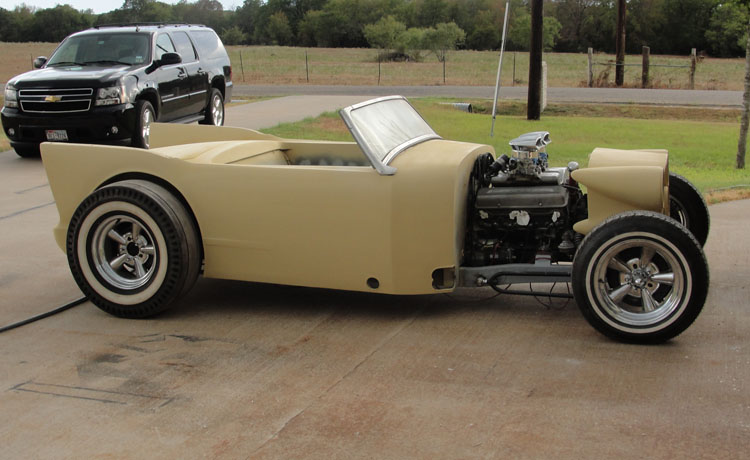

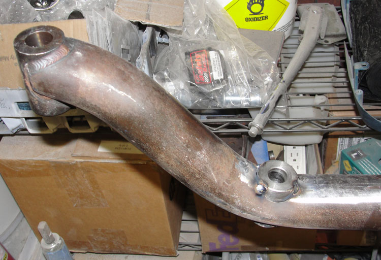

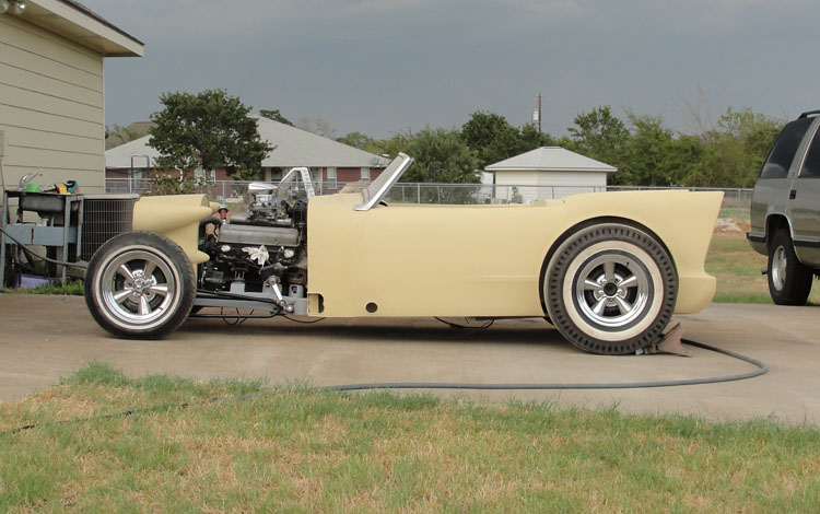

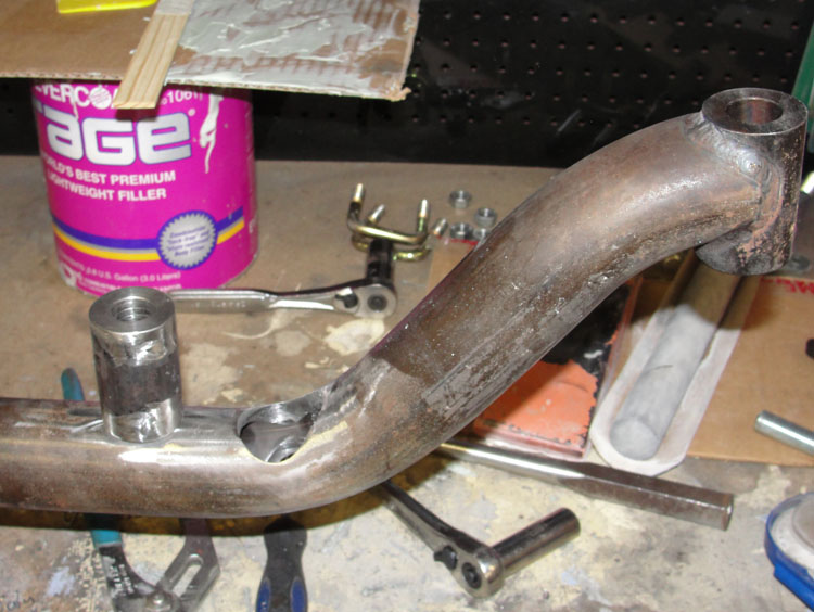

    Got sidetracked a little. I didnt like the axle in front of the spring and the tie rod in front of the axle. This had been bothering me for a long time. I removed the 4" dropped tube axle. Took a 6" dropped tube axle and cut the hairpin brackets off of it. Had a local machine shop machine me some perch pin bosses, drilled the axle and tacked them in place to mock it up.
    Ordered up a few parts from Speedway, some batwings, spring perches shock mounts, steering arms and a spring. Bolted it all in place. This shortened the wheelbase about 3.5" getting it where I originally wanted it and giving me the amount of drop I wanted. I think it looks much cleaner and I am really happy with the look. Still have to finalize shock placement and upper mounting and get it finish welded.

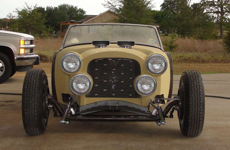

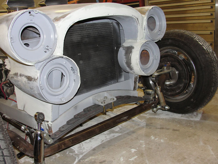

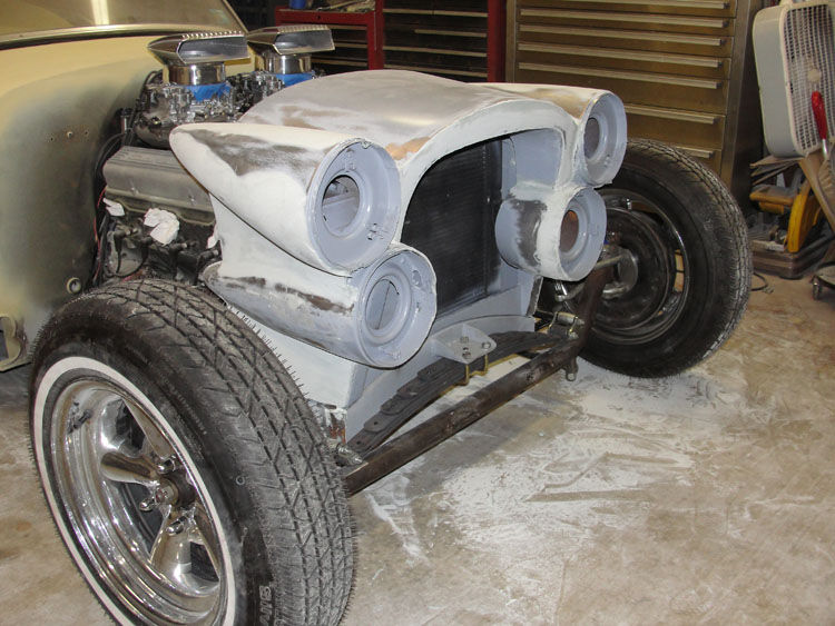

    Grille shell is in primer.....finally! I dont have headlight bulbs and trim rings yet so the last pic they are just photoshoped in.
