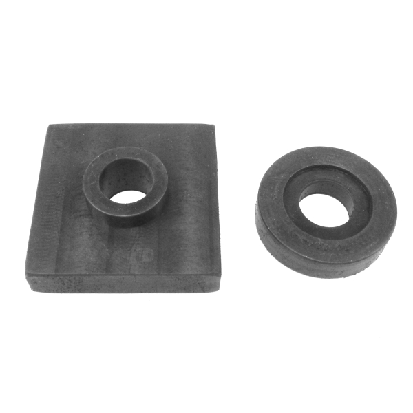

    I'm curious what sort of cushions does the body sit on and did you replace them? My car is currently sitting in Spokane on a trailer behind my motorhome waiting for me to drive it up the Alcan Highway in a couple weeks or I'd look for myself. Left it there a month ago til the road is dry. Wasn't anxious to pull that 6500 pound (car and trailer) load through the Canadian Rockies when they were covered with ice, haha.

    there's a 2 inch square 1/2 inch thick rubber mount that goes between the body and frame and a 2 inch diameter 1/2 in thick circle rubber pad that goes on the bottom side between the bolt and frame then there's a metal core that goes in them to prevent squeezing it down to far. Yes I replaced all of them. I'm replacing or rebuilding every thing on the car. Any questions you have I can probably help you with I literally had every nut and bolt off the car. 45b5a73f041c5534fee9c96e0f4f.jpg

    I got the mounts and a lot of other parts from oldbuickparts.com also kanter.com and fusick.com have a lot of stuff.
