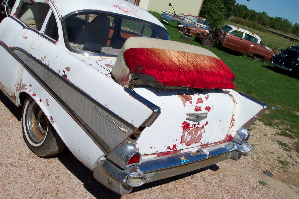

    I'm finishing up a '57 Chevy build and I took a lot of reference photos for the 2 door conversion so I thought I'd make up a build thread for it. Some of the pics are pretty blurry/poor and I neglected to take pics of a lot of other aspects of the build but it might be useful for someone in the future converting a 55-56-57 Chevy 4 door sedan into a 2 door sedan so I'm going to post everything I've got.
    This was the starting point, purchased (and photographed) about 15 years ago from a Rawhide Boy's Ranch charity auction for $300. It was customized by some high schoolers I'm guessing in the late 70's, with orange fur on the door panels, shaved hood emblems and some pinstriping, bondo'd closed back doors with shaved rear door handles and 2 door Belair quarter panel inserts, air shocks, red velour back seat upholstery and some poorly installed '71 Challenger bucket seats.

    First thing I did was pull the bucket seats and sell them on eBay, I got enough to cover the cost of the car and the ***le so the car was essentially free!
