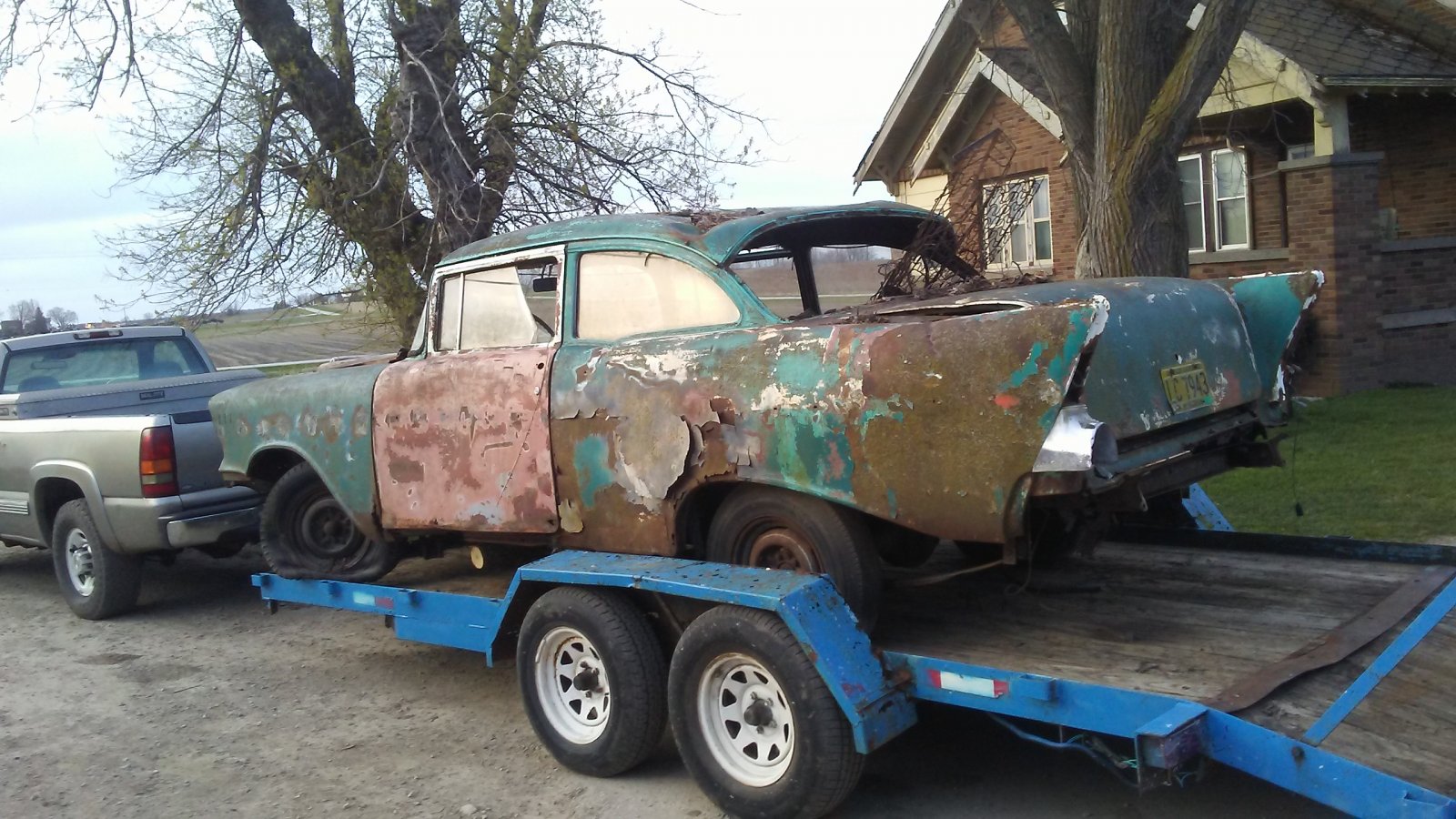

  2. 1971BB427
    Joined: Mar 6, 2010
    Posts: 9,942
    1971BB427
    from Oregon
    What a waste a 3 door would be in my opinion. Once you've gone far enough to do one side, why not do both? Seems crazy just to impress people with an oddity.
    I recently saw a video of a 2 door conversion done on a budget, and enjoyed it. I prefer yours being a step above by using the right parts to leave no trace of it's origins.

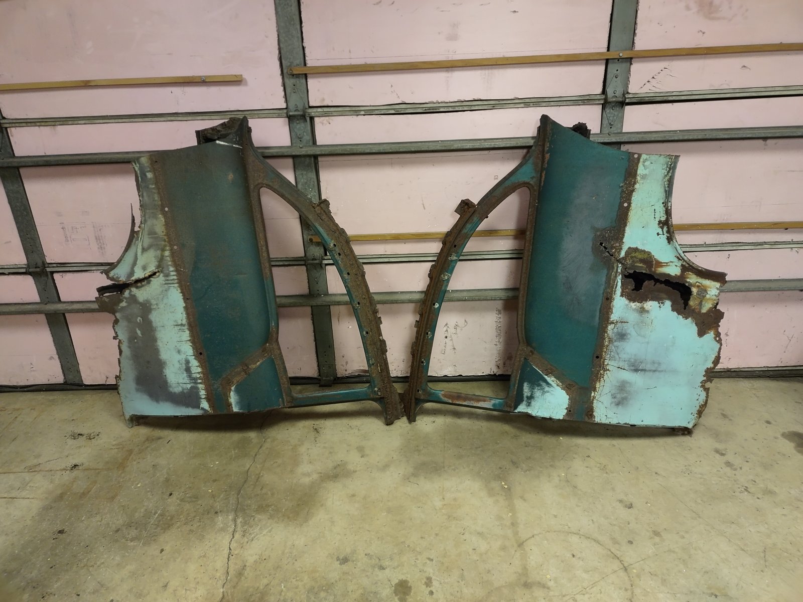

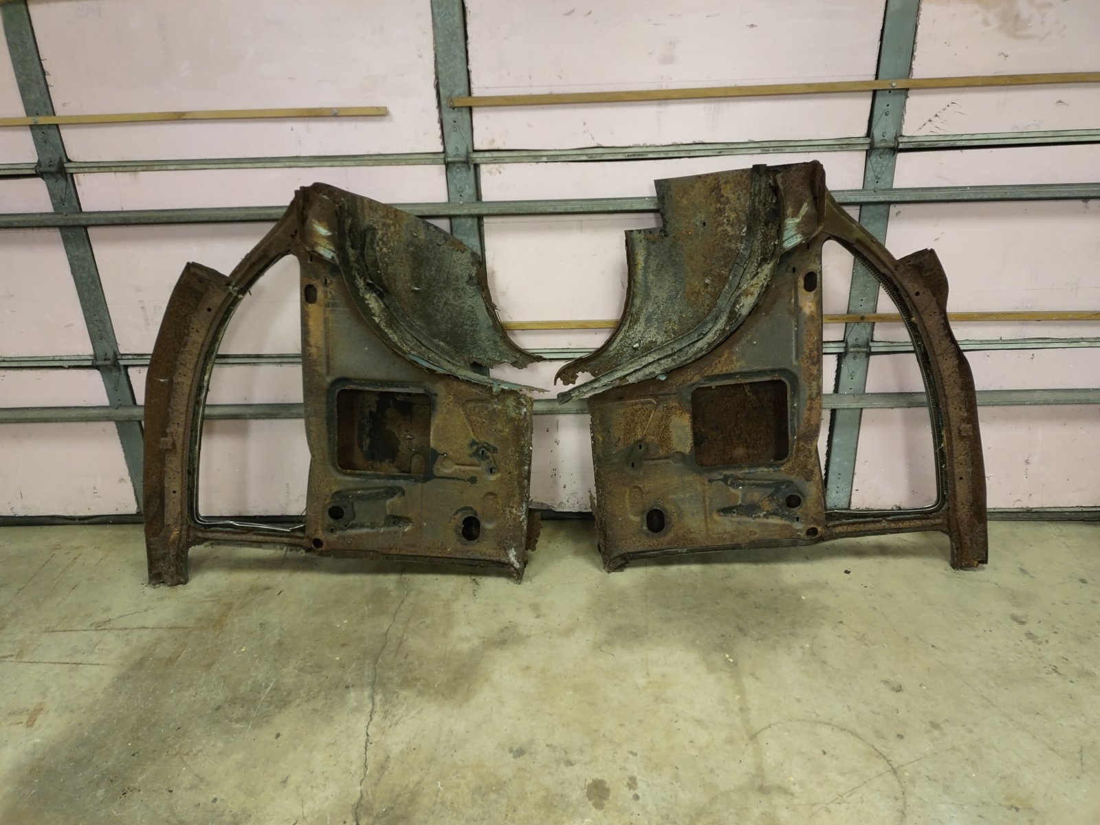

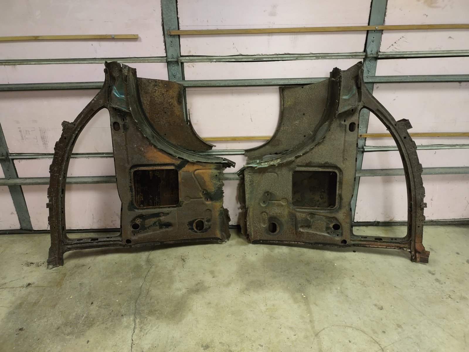

    We cut up this shell (mostly cut up in this pic). There really was no saving this shell either.
    Hopefully we can start our conversion this spring. Threads like this always help.

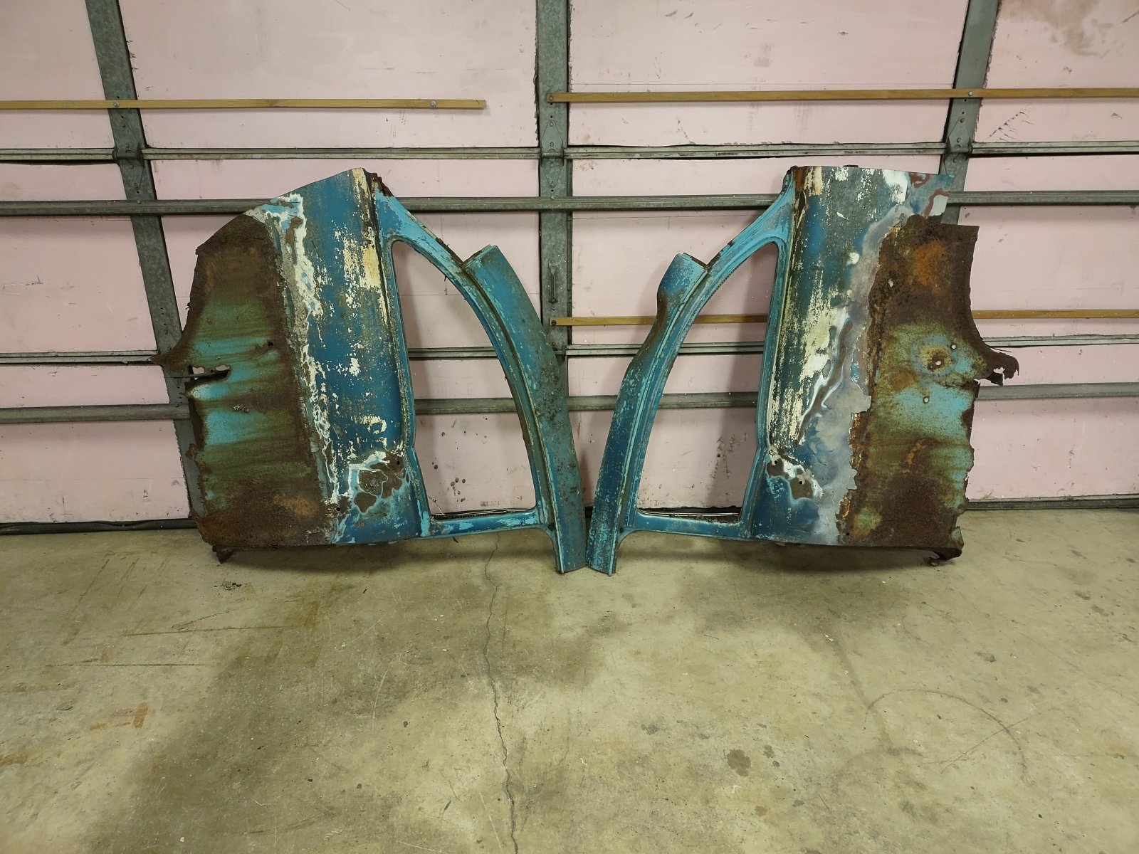

    Also, I have a couple sets of B-pillar cutoffs that are extras which I could sell if anyone out there is looking for pieces to do their own conversion. There's a set from a '57 150 that I parted out, which are pretty rusty and would take some rust repairs to be usable but still would be better than nothing, and a pair from a '56 210 which still need some cleanup blasting but are in better shape. I'd like $250 for the '57 set and $350 for the '56 set. I'd work with someone on shipping but not sure how to do it since they're big. I could piece together a ****ty pair of doors too for a few bucks more if someone had nothing to start with, would still be easier than stretching 4 door front doors.
    I figure I put about 3000 miles or so on the '57 last year and it's been a really easy car to live with on a daily driver basis, at least for the warm months. Gonna swap out the leaf springs and get the heater working hopefully in the next couple weeks and then it'll be back on the road for this year.

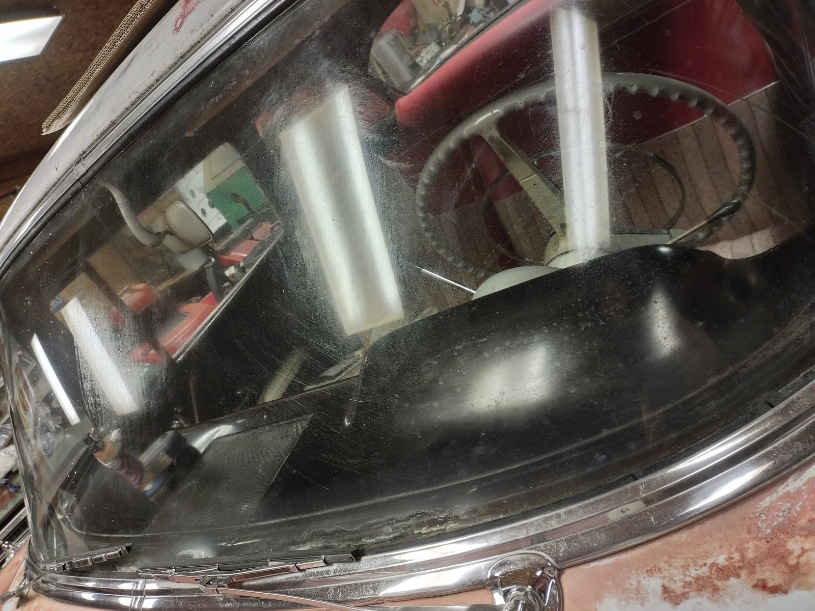

  17. Squablow
    Joined: Apr 26, 2005
    Posts: 18,706
    Squablow

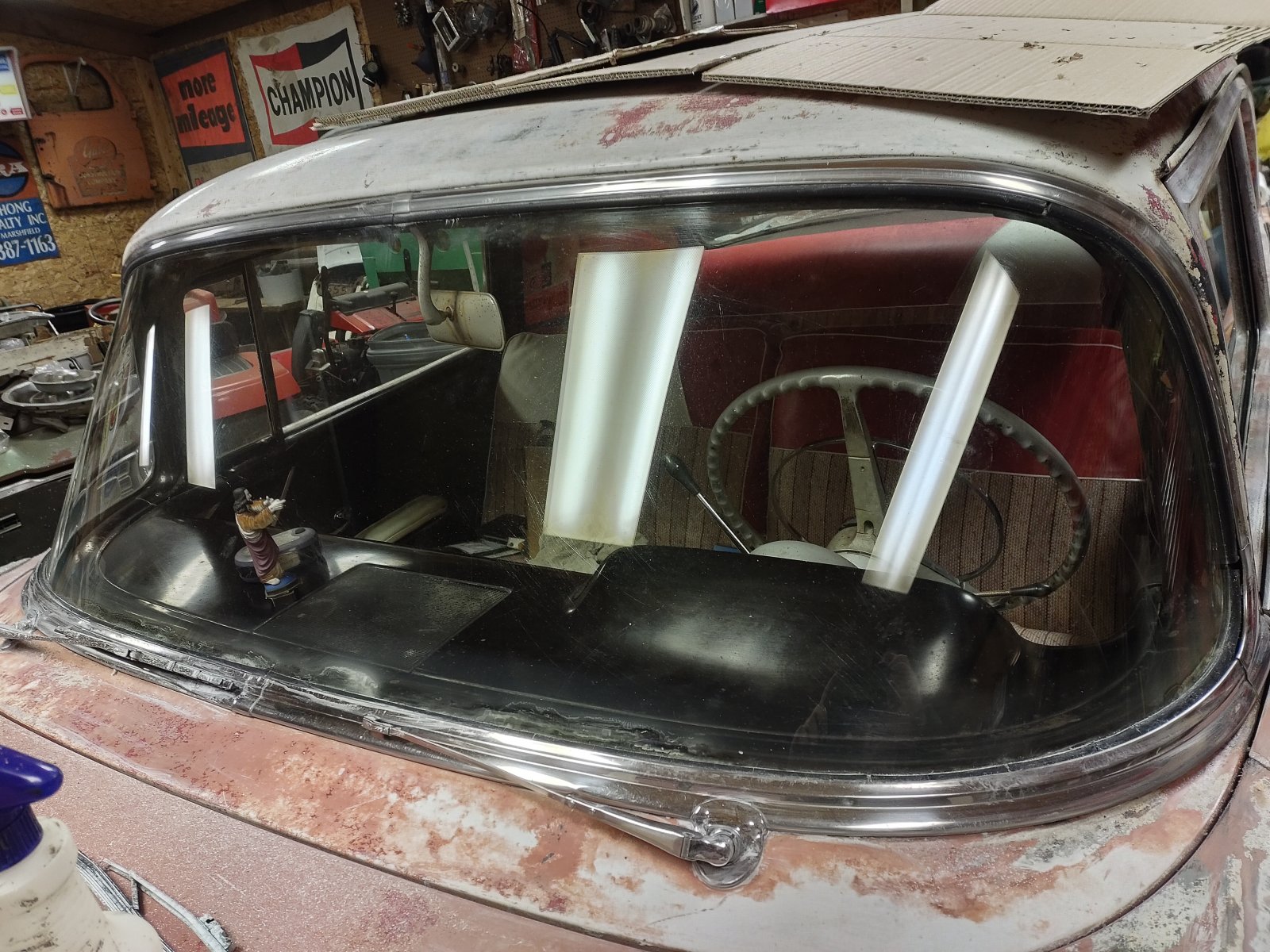

    Lastly was an experiment with cerium oxide for polishing gl***. These pics aren't the best but it's hard to photograph gl***. This windshield isn't cracked, but it's bad in every other respect. Heavy wiper burns, lots of scratches and wear on it. I used my big Snap-on buffer with a foam pad and the cerium oxide in a paste. I pounded on this gl*** for quite a while. I could get it better yet, but it would take a couple more hours. But the difference was very apparent. It's got way, way less glare now and the scratches are diminished. I might come back to it and give it more polish but this was a big improvement.
    PONTNAK123, lucky, Stogy and 10 others like this.

  19. 57JoeFoMoPar
    Joined: Sep 14, 2004
    Posts: 6,534
    57JoeFoMoPar
    That's really good info about the polish, that gl*** is significantly improved
    Stogy, 427 sleeper and Squablow like this.
  20. Squablow
    Posts: 18,706
    Squablow
    I'd been wanting to try it, you can buy a little jar of the stuff on eBay for like $28 and you could do a lot of gl*** with that amount. It just takes a lot of time and effort but it does work.

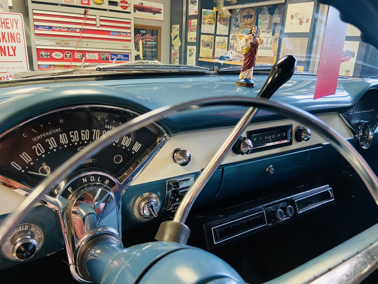

  21. HerMink
    Joined: Sep 14, 2018
    Posts: 188
    HerMink
    Man, I really need to hit my windshield with that stuff. I used the Griot's polish with the gl*** polishing pad - it did nothing, I'm sure the swirls are cleaner but that's it.
    Also, is that the 'thumbs up' Jesus from Dogma on your dashboard???

  23. Squablow
    Posts: 18,706
    Squablow
    A couple more tips I learned on the windshield polish, take your wipers off first (one of mine got caught in my buffer pad and the blade went flying) and it's not a bad idea to mask off the surrounding areas of the window before buffing. The compound doesn't seem to stain paint or anything, it just makes a sloppy mess. The stuff comes dry, I poured a bit onto my pad, sprayed some water on it, then smeared it onto the gl*** to make a paste. Helps to spritz water onto the gl*** every once in a while during buffing to keep it wet, you apparently don't want it to dry out.
    And yes, that is Buddy Christ on my dash.
