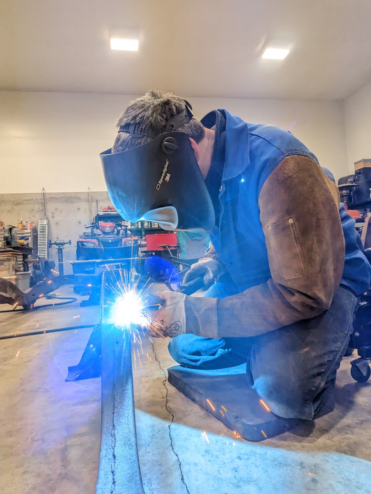

    Spring relocation frame mod is complete. Shackle angle is a little steep with the new arched 5-leaf springs and a bare frame but I played around with loading weight and I think all said and done with the car re***embled it'll settle out just right. I'm pretty happy with it overall.
    PXL_20230131_044800355.jpg PXL_20230131_033727193.MP.jpg PXL_20230131_054512238.jpg PXL_20230131_020127402.jpg PXL_20230131_020152645.jpg PXL_20230131_054431879.jpg PXL_20230131_011242304.MP.jpg PXL_20230131_031134682.jpg PXL_20230131_010532738.jpg PXL_20230131_054448562.jpg

    Fantastic job! Guessing you'll wait to weld the spring pads to the axle housing until later when the car is ***embled? The next big move is this setup on mine. To get some ride quality, lose the coil overs and a wider housing/axles so I can hang those rear tires..

    Thank you. Yea I'll wait until it's all loaded down and sitting at final ride height so I can dial in the pinion angle before welding the spring perches in place. But I'm also scouting around for a 9 inch or Dana 60 rear end so it also depends on what I settle on for a diff. Sounds like you're really coming along on your project!
