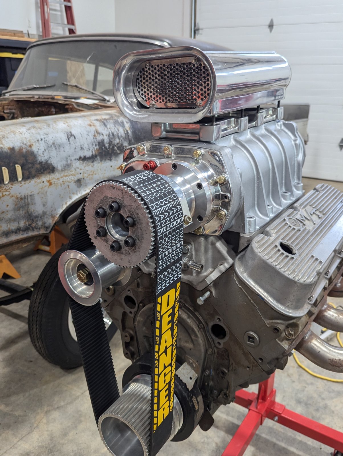

    Got idler back and installed. Just mocked up for now so not too worried about belt tension, blowers not even bolted down right now but how's this fitment and belt length look?

    Nothing wrong with that! :cool:

    That's about as far inward as I like them. You do know that you can buy a belt that when rotating shows all the Koma Sutra positions moving as fast as your little hart & RPM can handle!

  7. Looks ok, I would torque the blower down and check belt tension.

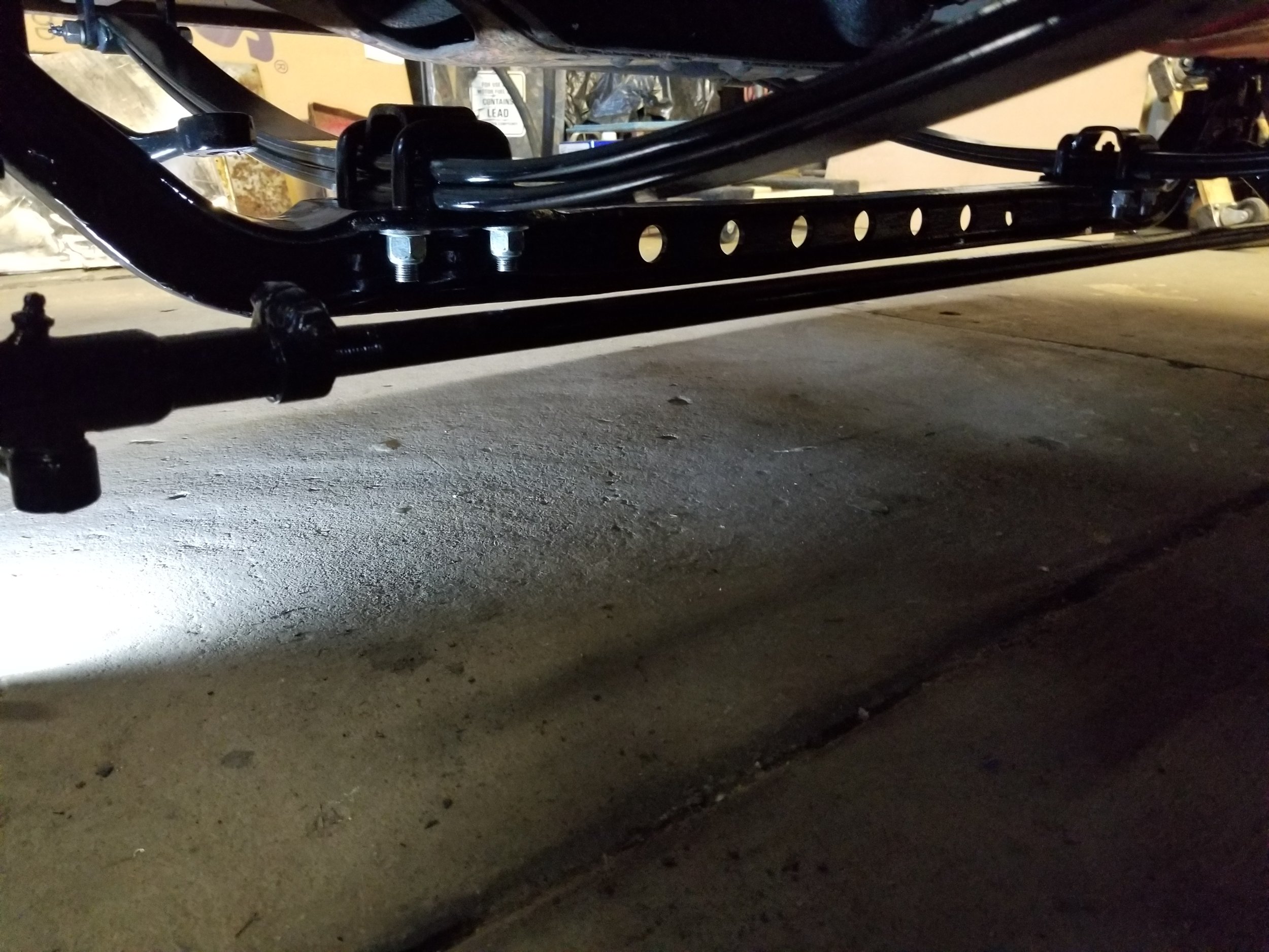

  25. Well you got to drill the holes in them man

    Definitely a cool look all drilled out.
