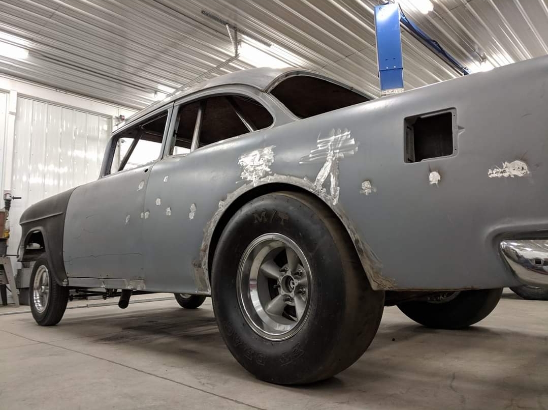

  4. COCONUTS
    Joined: May 5, 2015
    Posts: 1,227
    COCONUTS
    I am wondering if it would not be easier to just mount the spring hangers on the inside of the frame rails. Just switch from left to right and right to left. Boy you did a lot of fabrication just to hang the springs under the frame. Again, just asking.

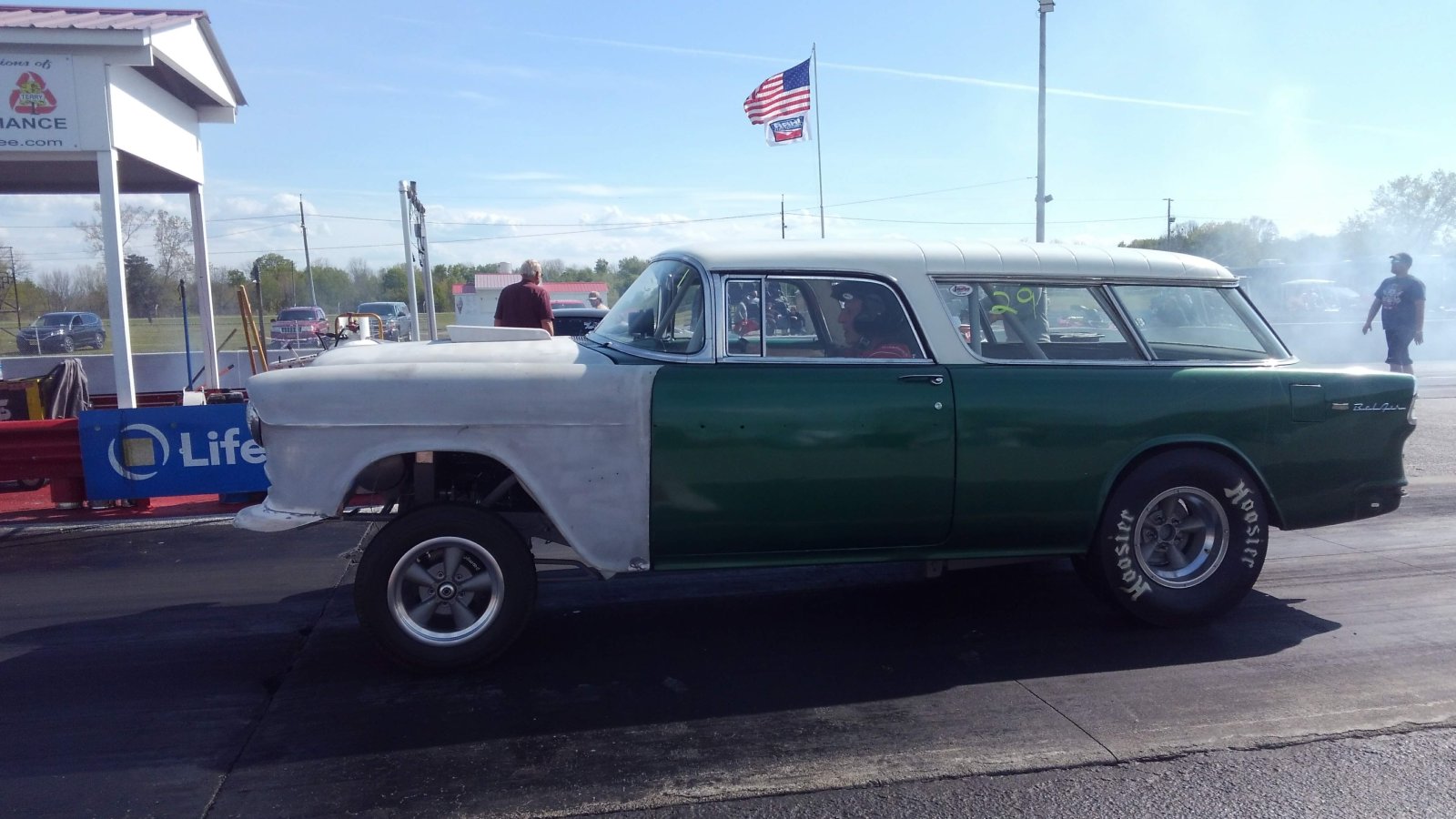

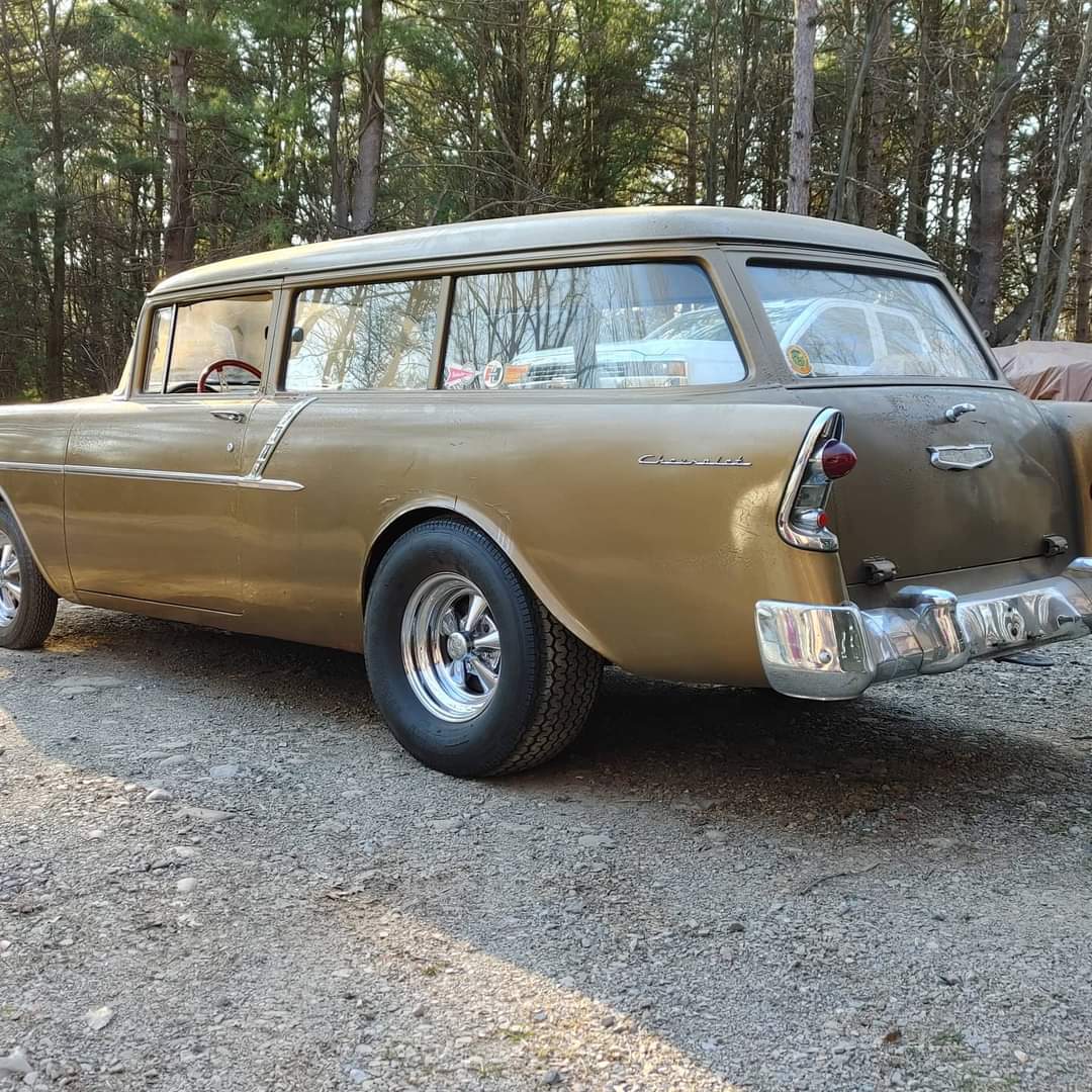

    Now what do I do?!?....I bought a 55 Nomad tonight!!! I guess one good project deserves another.... PXL_20230214_065705683.jpg

    Thank you for that info feedback! Funny you should say, cause now I got a wagon! Haha...

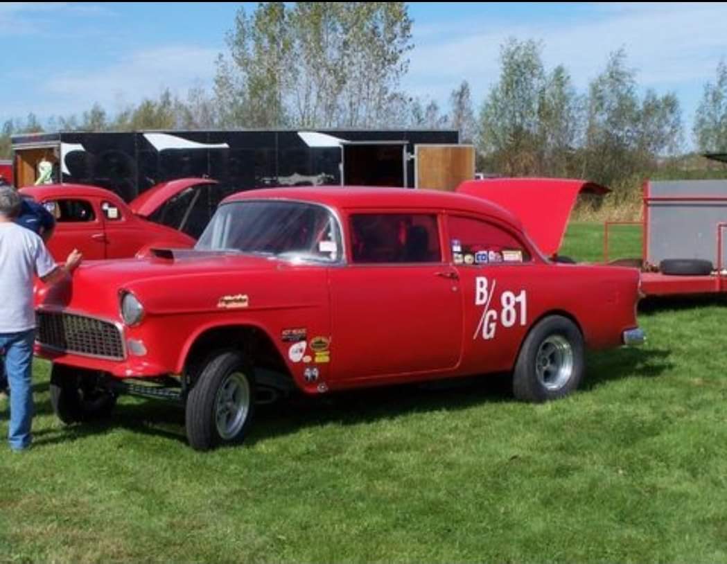

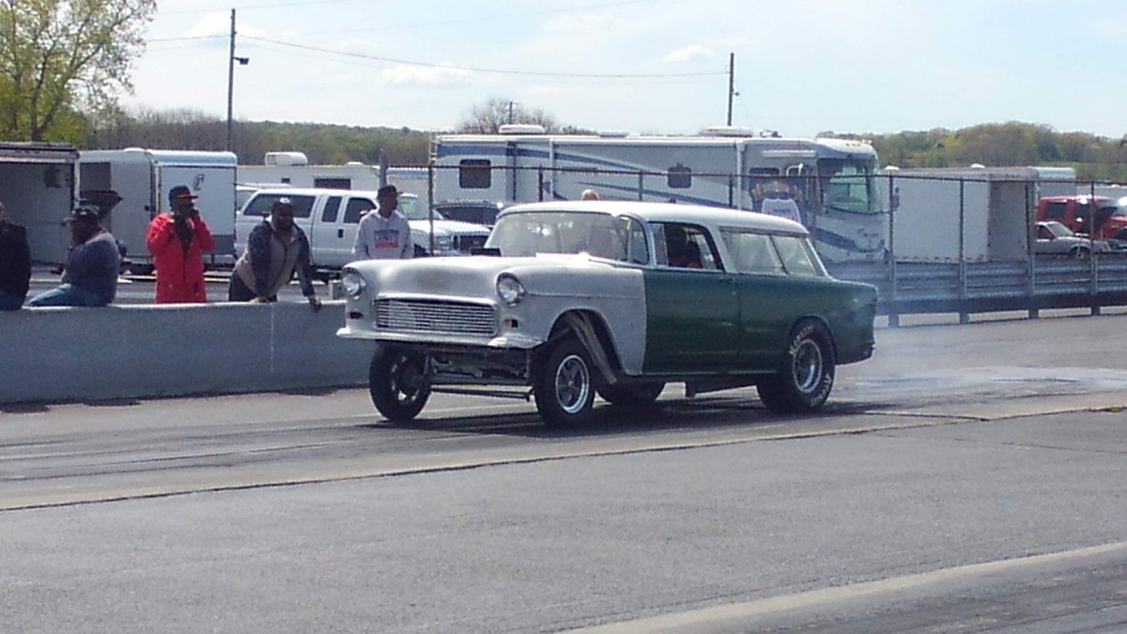

    Hmmm.... Taken a couple yrs. Ago at local track...
    If I remember correctly I believe Lee Osborne had a hand in it.. KIMG9026.JPG KIMG9029.JPG KIMG9028.JPG

    Haha, I hear ya and great question. I considered doing just that, but inboarding leaf springs is getting pretty narrow and I read several ill reviews of that method and wanted to keep the rear end as stable as possible while making room for the wider tires. This is also why I opted for the 5-leaf spring packs. When you pocket the springs like I have done here, the frame, springs, and mini tubs that I plan to install are all pretty closely in line, so mounting the springs inboard of the frame rails adds no extra benefit for fitment, but does imapct things like fuel tank fitment, exhaust routing, etc.. I have experimented in spring placement in other vehicles as well (mainly off road jeeps), and it does significantly impact the stability, the narrower you go. I guess otherwise, I just enjoy fabricating and doing jobs like this, it was a fun little project, parts were reasonably affordable to just buy the kit, and only took a weekend off and on to complete it. I do have a few stiffening support ideas I'm going to implement on the inside of the frame rails and around the spring pockets.

    My 57 bel air 2dr sedan weighs 3280lbs, no front bumper and fullish tank of gas.
    @KrucksGarage that leaf spring set up is a great approach, You gain a ton of room.
    I opened my wheelwells to the frame like you're planning to do. Mine were rotted terribly so I moved the tubs in then made strips to fill in the gaps. Wow, that was a long time ago. . . .

    I'm thinking about doing the same. The trunk floor is available with the wheel housing clearances set for minis, but I can fab off of the originals like you did and fill that gap as well. Maybe I'll go ahead with that vs. buying new housings.

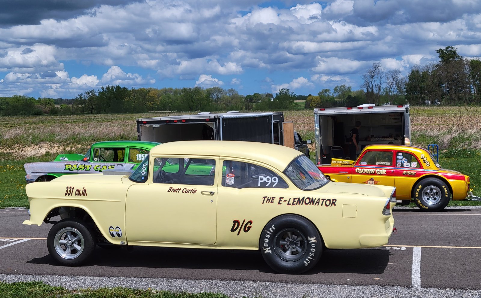

    Another Lee Osborn (sprint car hall of fame) build, number one off the ***embly line, this red car is another he had built
    Also did the ch***is on the black one and blue one

    Lee Osborne is legend...
    An builds bad *** for the most part 55's, I don't think G***er wise I've ever seen anything other,
    In the Hall of Fame sprint car builder/ Racer.. An a Hell of a great guy.

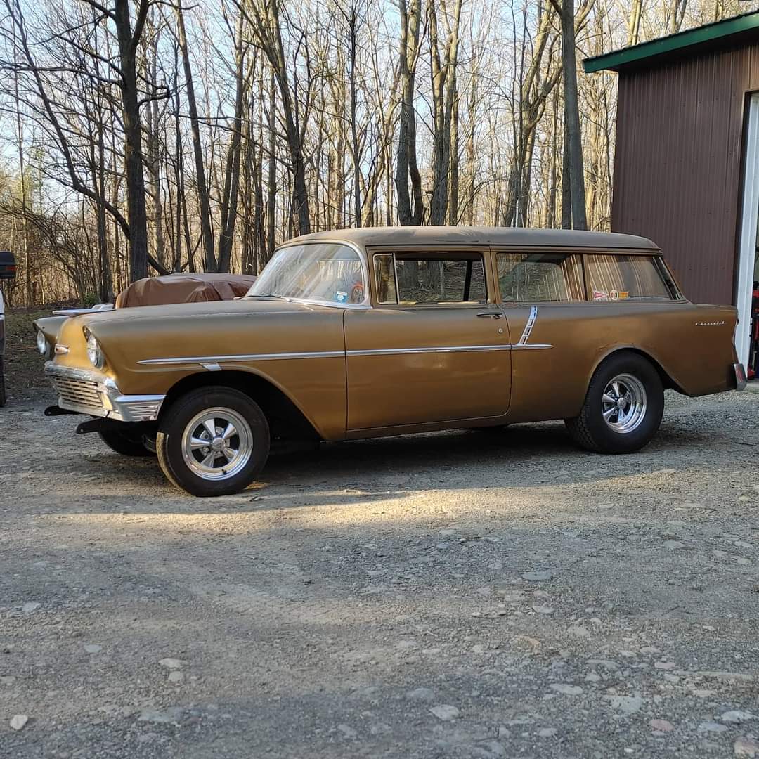

    The guy that was doing the gray primer injected 55 had a baby so he sold the 55 and got into this big block 4 speed 56 wagon, that I believe is at Lee's getting some changes
    FB_IMG_1676426363557.jpg FB_IMG_1676426360010.jpg FB_IMG_1676426372835.jpg FB_IMG_1676426412742.jpg

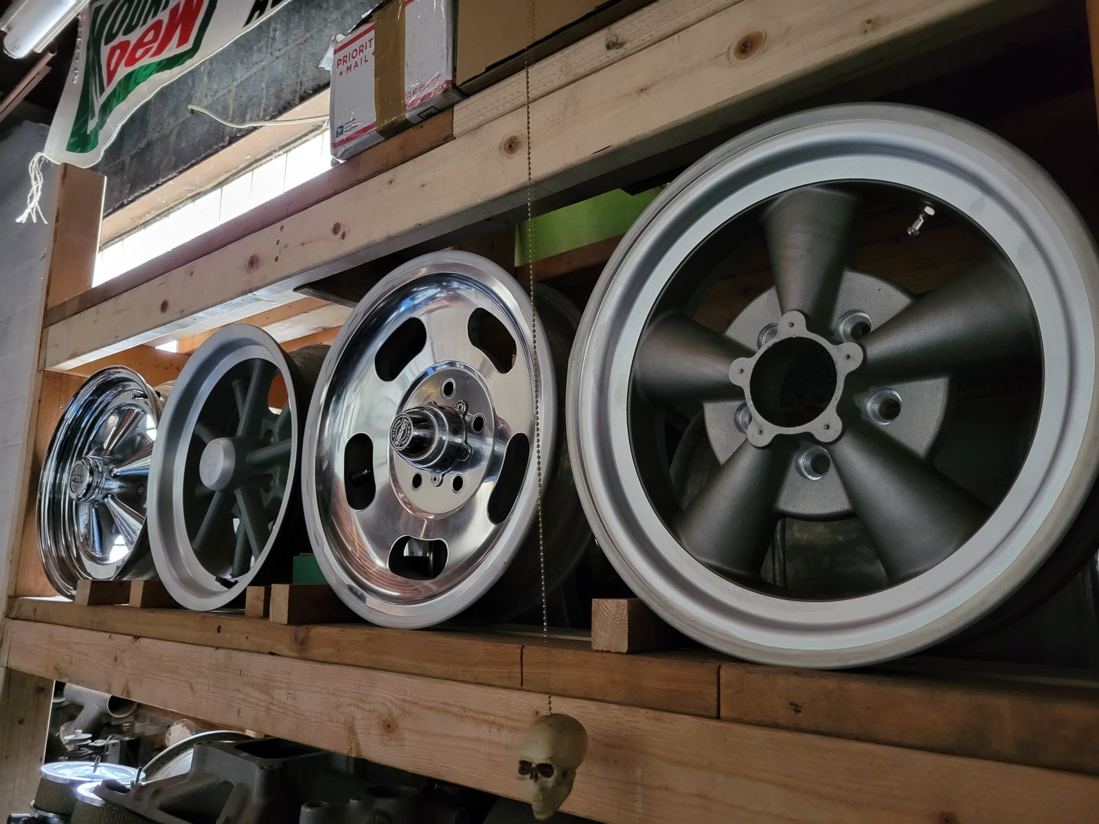

    Good looking rack of wheels you have there. Lot of vintage vibe.
