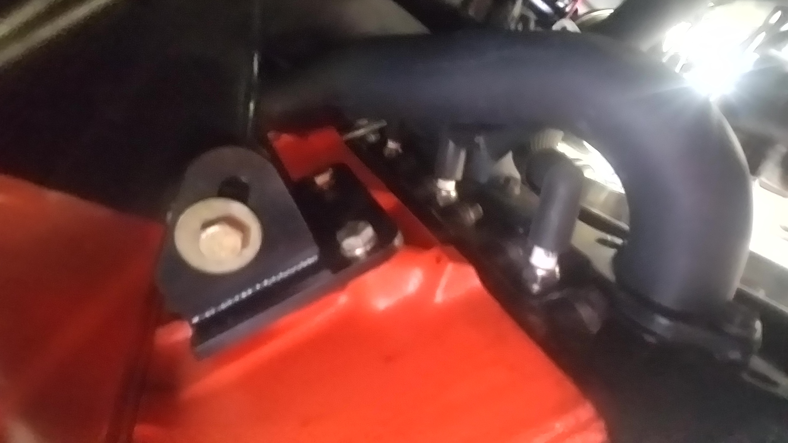

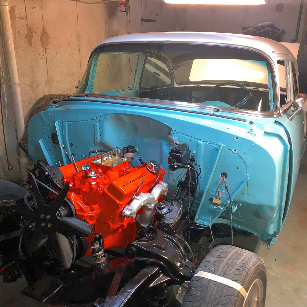

    I'm working on a '57 Chevy car and I've got some engine mount questions. Please keep in mind I'm a body man and not a mechanic so stuff that seems obvious to you probably isn't to me.
    Basically, the car got a 350/350 stuck in it just far enough to drive it onto a trailer and I want to finish it up. One thing I noticed is it has front engine mounts and a trans mount on the back of the tail shaft but nothing in between. The original frame braces for the bellhousing center mounts are still intact.
    Here's a picture of the front engine mount, questions to follow.
    First question, does that mount look right, with that gap in there? I'm not really sure what it was originally supposed to look like.
    Second question, if that is what the mount is supposed to look like, do I want to add some kind of center mounts to the bellhousing? Seems like an awfully long stretch from the front of the engine to the end of the trans.
    Third, am I better off in some way to add the motor mount brackets to use the center engine mounts instead of these front pieces, and if so, do I need to have the engine out of the car to install them? I'd really like to leave the engine in place if I don't absolutely need to pull it out.
    I will say that the custom trans crossmember put into the car looks pretty good. I do need to send the driveshaft in to get balanced but I don't want to do it until the engine is permanently bolted in place in case it gets moved around and needs to be a bit shorter or longer or whatever, but the motor mounts seem to be the keystone here.

    there are two ways to go, you could get the Danchuck kit that adds mounts to the transmission to block bolts, and attach to the original frame horns. It looks hokey, but might work ok.
    https://www.danchuk.com/ItemForm.aspx?Item=870
    Or do it right, get side mounts and bolt or weld them in place, although doing it without removing the engine might be difficult.
    https://www.danchuk.com/ItemForm.aspx?Item=871
    The gap you're talking about, do you mean between the donuts, the long stud in there? yeah, that's normal. If you mean something else, please elaborate

    Yes, the gap between the donuts, was wondering if that was how it was supposed to look. Excellent advice, thanks.
    Let me ask you this, with those motor mounts bolted the way they are, the engine should be properly located (front to back at least), correct? Like, swapping to the side mounts, if I did go that way, wouldn't affect the front to back location of the engine? I'm wondering if I can send my driveshaft in, safe in the knowledge that the length is correct, even if I did swap to the other style motor mounts. I hope that question makes sense.

    You have the factory style mid mounts, or you have the Danchuk style kit mounts for newer automatics? Because if you have the Danchuk style ones I would very much like to buy them from you, I'll send you a message directly.
  26. Squablow
    Joined: Apr 26, 2005
    Posts: 18,617
    Squablow
    You know it. It's practically my signature move at this point. Working on inner rockers and floor supports now. The body is still square and original doors open and close real nice so I want to get everything welded up solid before I start cutting it apart.
    While I've got it up in the air high to work on the rockers I figured I'd get my mount situation figured out and send my driveshaft in but I just want to make sure I'm not doing anything foolish. Best part of a '57 Chevy is someone else has already figured out how to do just about everything.
    The engine is nothing too special, certainly no race car, and I tend to drive like a little old lady but I'd rather be overly cautious.
