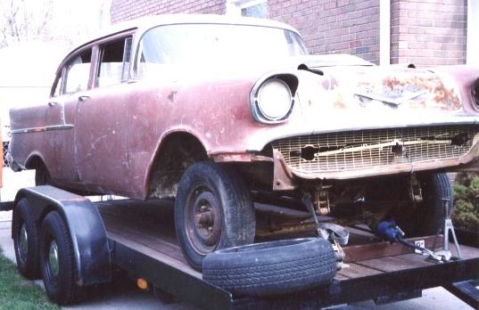

    I have a 57 chevy 150 4 door but I'm going to make it a 2 door,I've done some reserch on here to do it,it has a 235 6 cyl,with 3 speed,i'm planning to put a 350 with a 4 speed.I allready have the 4 speed,its a saginaw.not the best but its okay.350 I can find anywhere.
    well I need some advice on what streight axle to use and how to set up the steering linkage.heres a few pics of the car.

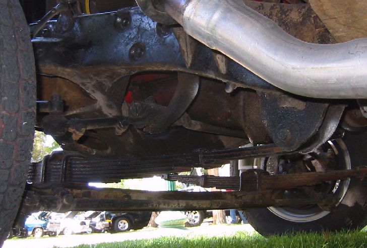

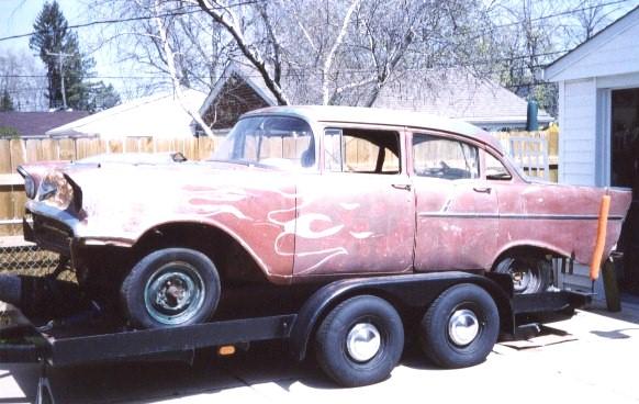

    A buddy of mine recently bought a four door 57 set up kinda "gasser" style. It came with a straight axle set-up already in it. The seller told him the front axle assembly and steering box was from an early Dodge truck.
    Sorry, no detail shots of the front suspension and gearbox, but here's the car itself for ya...

  9. squirrel
    Joined: Sep 23, 2004
    Posts: 59,600
    squirrel
    here's a really neat 56 that lives a couple towns over. Look real close at the steering linkage, see if you can figure out the trick he used. It's a 50s chevy truck axle.

    looks like stock linkages.then the tie rod on the bottom is it like that stock on the truck axle.
  14. squirrel
    Posts: 59,600
    squirrel
    yeah, stock 56 steering up top, stock truck steering below....and the wierd thing is he drives it all over the place.

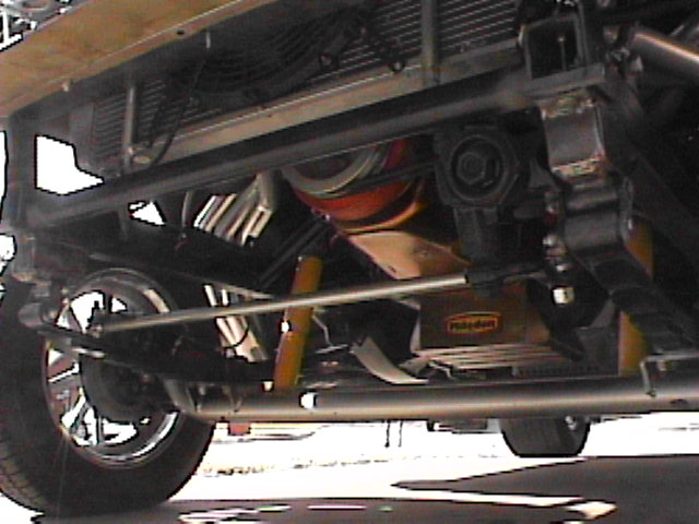

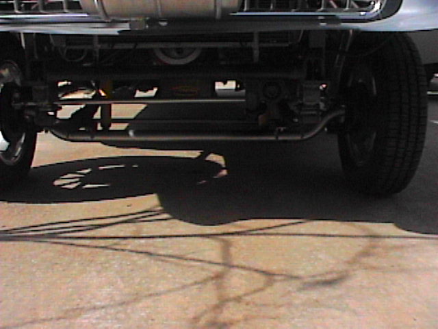

  18. Godzilla
    Joined: Jul 26, 2005
    Posts: 1,013
    Godzilla
    If you can scrape up the cash for the Speedway deal here is what it looks like under a car. It is a very doable deal in the driveway...but you must get a quality welder or tack it in place and take it and have final welded.
    The gearbox on this car came from a 64 Impala...$25 in a salvage. I built a bracket and made it a cross steer...no hands at 109 mph. The frame section is just 2x3 tubing with a piece of round tubing connecting it at the front.
    I cut the frame off at the firewall with a sawsall...jamed in the new tubing and then boxed it in. You just have to make sure that it is level and square...all labor.
    This same deal will work with an axle out of a Econoline or Ford PU...and will save you about 1/2 the cost of a Speedway axle. Good luck with your car...I had fun with mine. Ron.
