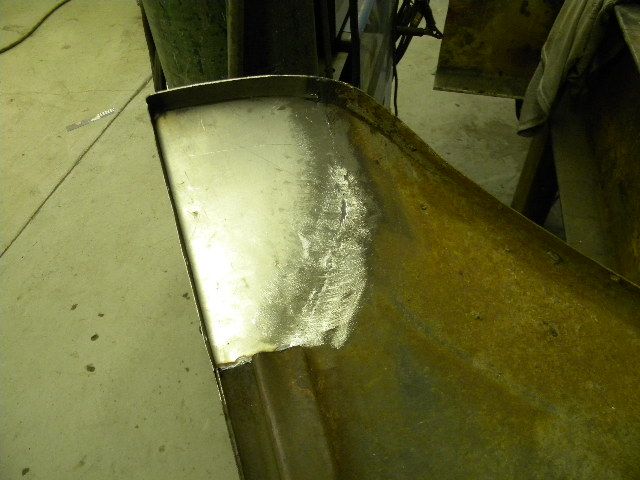

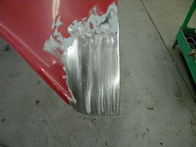

    i did some work to his fenders a while back when i didnt have room for the whole car yet

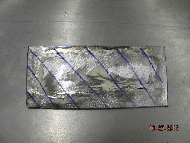

    to start on the rear lower area of the fenders, to make the patches i first made a cardboard template and transfered it to some sheet metal.
    then cut it out
    the bottom edge has a curved break on it, so to get that is used the bead roller with a tipping die.
    then i had to put a regular break on the back edge. then run it through the shrinker to get the curve to match the original fender
    here is the new (extra) panel

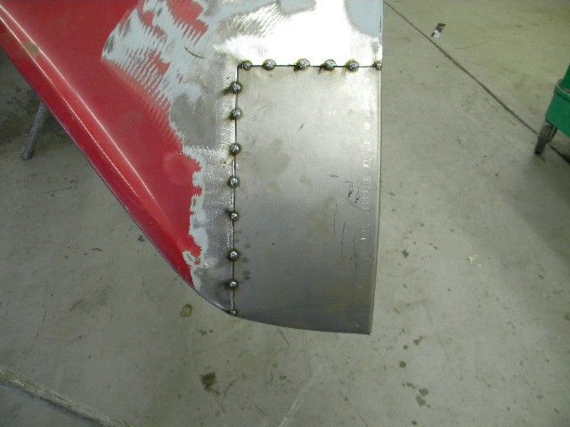

    here are some of the patches tacked in
    all the panels fully welded, ground, and hammered and dollied out smooth

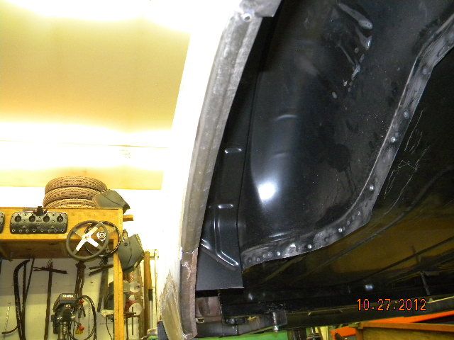

    and some pics of the backside, still need to put the support brace back in
    then he dropped the car off and the real work began

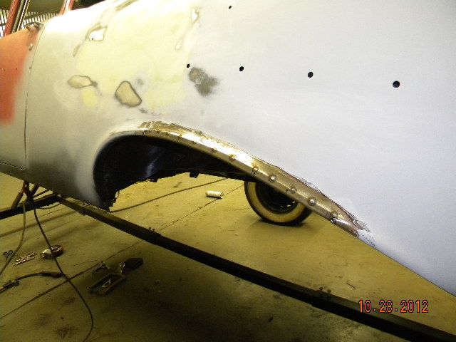

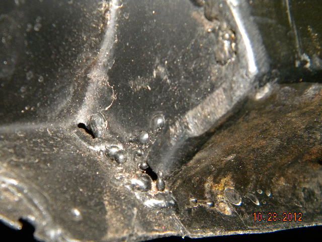

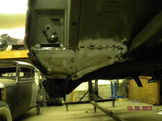

    started on this rust hole in the lower rear quarter. i am just tacking everything in right now, the welder is low on gas and cant get my bottle re filled till monday so tacks for now lol. i will try to stick to pics and keep the typing down
    a patch that someone else tried to put in, had a bunch of holes, no shape just a flat piece.
    the old butchered wheel well, formed a new section for that
  3. cornfieldcustoms

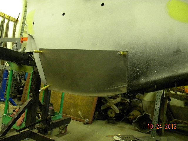

  8. Moonequipt13
    Joined: Jul 9, 2012
    Posts: 196
    Moonequipt13
    Nice work, I like the use of the skateboard wheel on the bead roller. Are you using the clecos to hold that panel in place while you scribe the body for t*******?
  9. cornfieldcustoms
    Joined: Feb 2, 2008
    Posts: 1,064
    cornfieldcustoms
    thanks guys, yes i cleco'd the panel in place to scribe the cut line

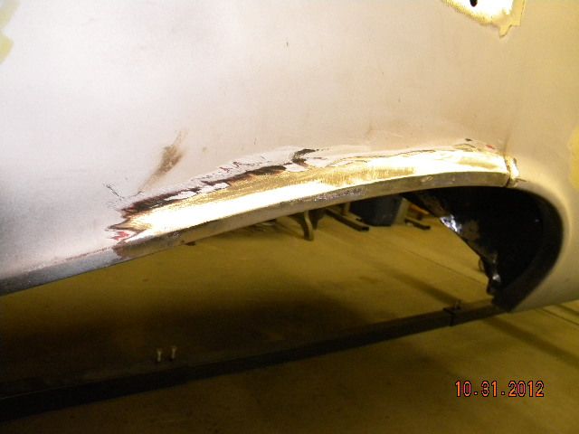

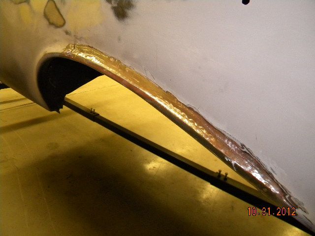

    made some more proogress on this one today,not much, but sundays are my short days at the shop.
    had some rust to address at the p***enger toe board and floor area
    looking a little better, still needs welded solid
    driver rear wheel well needed the same treatment as the p***enger side
    driver toe board needed the same as p***enger
    these are a few more of the areas i will be taking care of on the car. then the owner is coming over to see what else he wants me to repair and we will go from there. the main problems left are the welding and in some spots the lack there of as you can see in the pics
