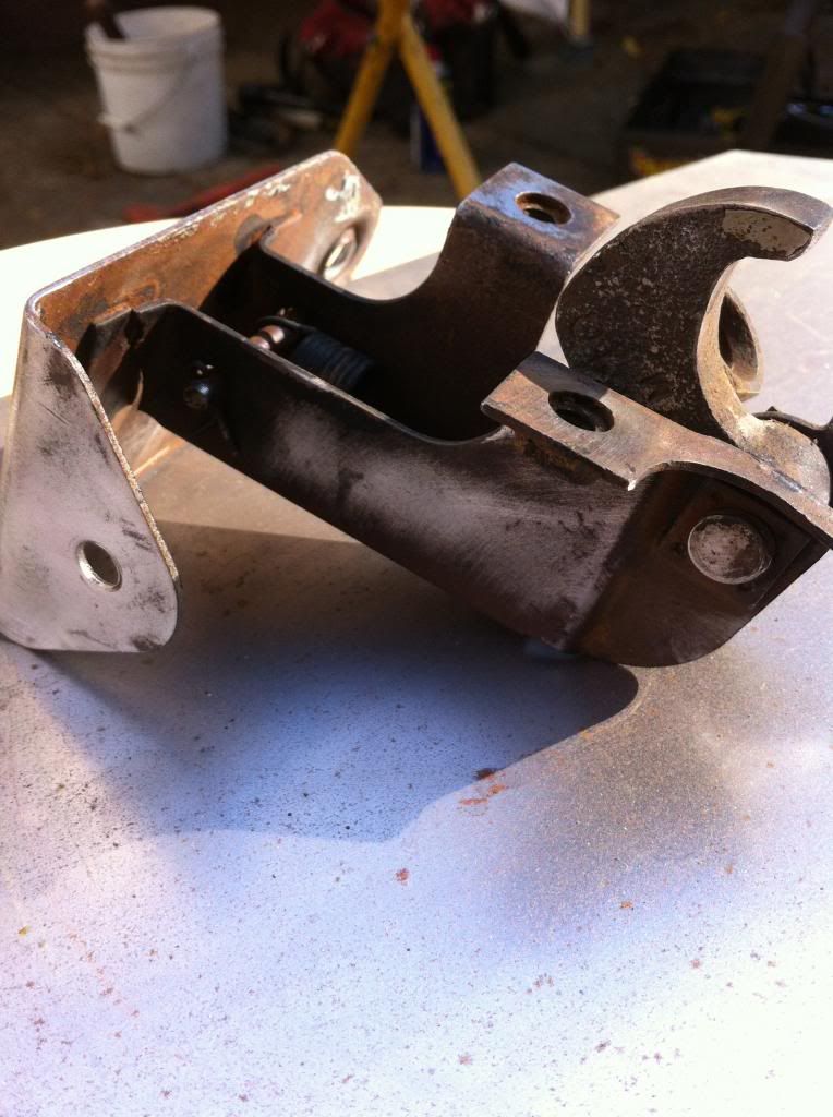

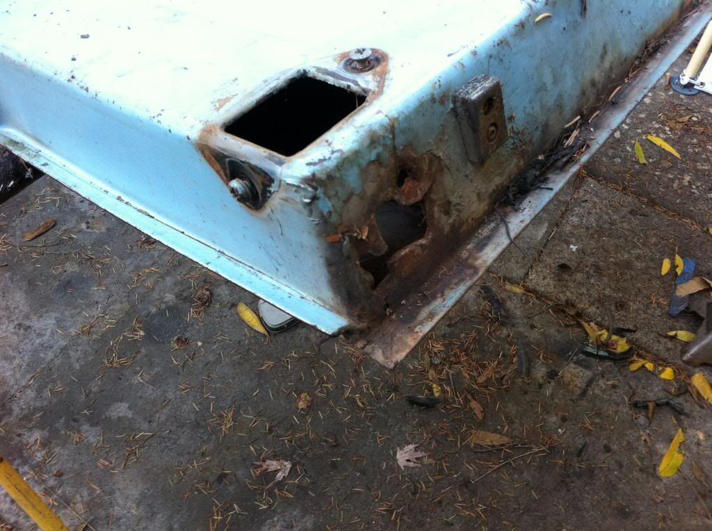

    I stole a few hours today & tackled my rear doors. The left side has the latch mechanism that hold both doors closed to the body and the right side latches to that. Without a sound latch on the left door, both doors are prone to popping open. Aside from sounding like a bag full of pots and pans when on a bumpy road, they did come unlatched a few times. I figured out why...
    The latch point on the bottom of the door looked like hamburger
    ...and the latch itself was broken free from its plate
    so, cut and weld...
    and fixed a few dents and cracks in the bottom corner door skin
    I still have a few random holes in the door skin to weld up.

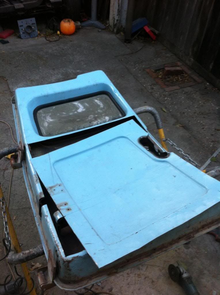

    The right side door had MAJOR cosmetic issues. Something pointed had caved in the door and split the skin at the point of impact. I found a set of doors that were straight but rusty and the guy wanted $300. Screw it, I'll fix the one I have...
    The first step was creating access...
    Got it roughly hammered back into shape and decided the impact/tear point was so distorted and stretched that I'd have a ton of time in shrinking and hammering if I left it in. It was also preventing the rest of the door from going back into shape...bye, bye

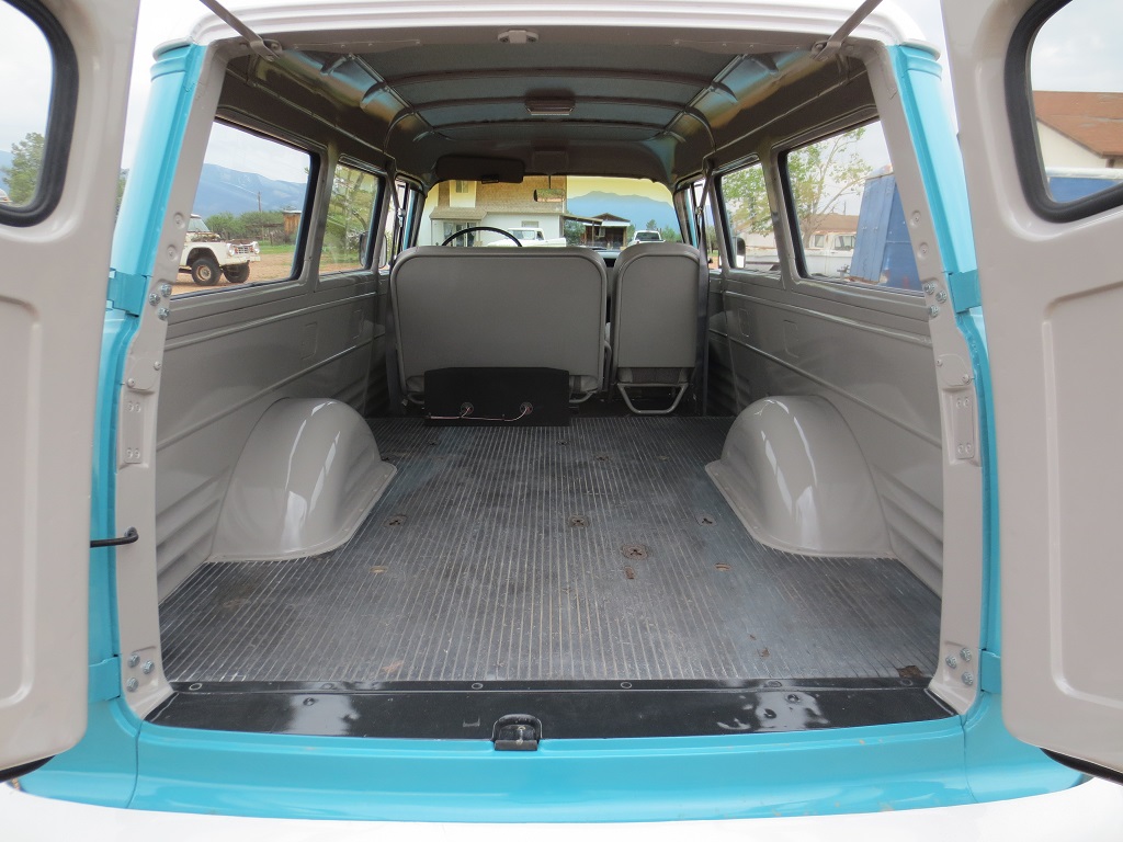

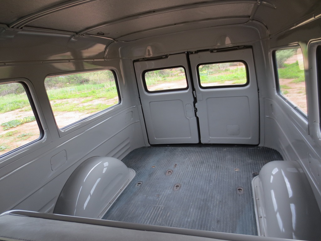

    It started getting dark, so I cleaned up and took a minute to lay out my new parts. I had been looking for the interior roof perimeter paneling since I got this thing. I'm not actually convinced that all panel trucks came with them. Mine does not have the holes to attach the sides or rear and I've seen another with no holes drilled.
    Anyway, they were standard in Suburbans and I have seen one panel with them...so who knows. They really finish off the interior and this is not a restoration. I'm running them.
    Big thanks to Squirrel for the side pieces! I searched high and low and came up empty until he helped me out. I really appreciate it. The back piece was no easier to find and NOT cheap. That's it 'till after the holiday...Merry Christmas!
