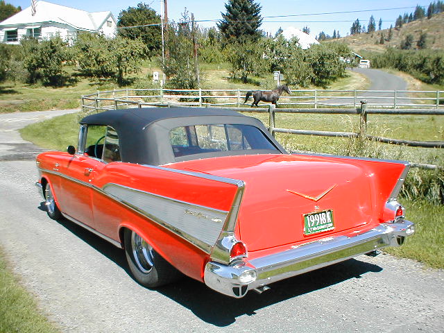

    I've had this problem with my 150 2dsd and have asked many times about this issue. This S.W. difference would explain a lot! Mine is at least 1.25 too wide.

    Have also ran into 3 styles when doing the 150, here's a S/W rear bumper on a '57 150 that would have fit better had we known about the 1 1/4" diff. before plating....................................

    Thanks Brigrat and 5w coupe.Sorry you are in the same boat i am in.I talked to my plater and he has a s/w bumper center that i can modify to fit.May cost a few bucks but the fit i have is not happening,bugs me every time i look at it.

    My customer and I spent a day and a half trying to fit his rear bumper and ends. It involved some unseen surgery to get it this far, even though I was not happy with the fit he was and that's where it ended. You will forever be checking out '57 rear bumper fitment on others rides.....................
