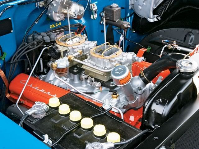

  10. The Corvette valve covers are probably wrong. The big oil bath "Batwing" air cleaner on the pass cars used the stock valve covers as a support. The stamped steel valve covers had brackets welded to them for this purpose. (See pix below) The Corvettes used a totally different air cleaner; low, flat stamped aluminum with a horse-hair type element.
    And the replies above are correct; no way that I'm aware of to authenticate a factory dual quad car. The block casting numbers for a DQ car are the same as a Power-pack car.
    (Oops, simultaneous posting above. Sorry!)

    Both 245 and 270 hp. come with regular,orange, valve covers and the "real batwing" air cleaner on passenger cars, (not the Oldsmobile/Cadillac 4 barrel air cleaner everyone calls the batwing).......

    57's with dual four's from the factory had a "bat wing" style air cleaner, not individual air cleaners like the Corvette had. They came with steel painted "Chevrolet" valve covers and not the aluminum finned "Corvette" covers. There is no definitive way of determining if it came from the factory with dual quad's short of having the factory invoice. There should be a VIN tag applied with screws, not rivets to the driver's side door jam. By extrapolating info from you can determine approximate build date for the car. Then you can check the casting date on the motor to see if it jives with the assembly date of the car. On the front of the block is a stamped sequence of numbers/letters that indicate the build date of the motor and the type of horsepower-transmission configuration it is. It all are in agreement then maybe you have the original motor. Hope this helps!

    A dual quad car will also have a 3/8" fuel line out of the tank instead of the standard 5/16". I am sure all passenger 2x4 cars came with the script valve covers and not the corvette ones.

    what they all said--3/8 fuel line and sender,997 heads,different pulleys,gen and fuel pump-tin covers with batwing-was common in early 60's to put on vette valve covers cause the tins ones leaked after a few valve adjustments (I did it too). There is a nice 57 around here with a later eng/trans but I happened to notice the lg gas line and correct frame clips on it-he thought it was a 270 HP car but has no way of knowing either-hope this helps
