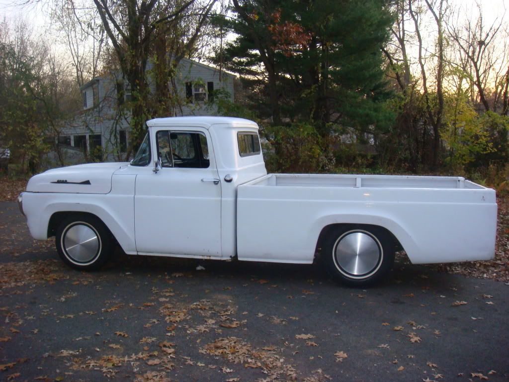

    Got the truck more or less ready to go just before the snow flies and I put her away. The majority of the mechanical work is done. I am just waiting on the driveshaft to get back to me so I can take her for a drive. The drop is complete though. Ended up being a total of roughly 4 1/2 inches up front and 6-7 inches out back all with simple axle flipping and frame notches. I was able to reutilize the stock rear shock mounts simply mounted a little differently and use the shocks the truck had on it. For the front I had to order some Bilsteins that were the appropriate shorter length.
    The 'lil 272 is ****oned up and ready to run but has some major plans in it for this winter. Going to be getting a Tri Power intake and a pair of small turbo's mounted up 50's style. Going to keep it a simple street cruiser so I will be running low boost and pump gas. I'm not trying to make her faster...just cooler.
    Anyway here is a pic of the truck sitting on the ground with the sheetmetal all ****oned back up and the the new steelies and rubber. They just simple black the way I bought them but will be getting a color change with the rest of the truck this winter. This is a bad small pic but I will get some good ones up soon. The rear tire is a little photo shopped since I was messing with it trying to get a feel for how a bigger tire would look.

    Nice progress on your truck. Good score. 57's are cool, Dean Moon liked them, well, almost. His was a 58-9....

    What size tires are you running? The truck looks awesome!

    that's a '60... still cool though!!

    Those are 235 /75/R15's all around. Probably gonna go to a 205/75/R15 on the front though. I'm thinking that if I crank the wheel and hit a bump at the same time I'm gonna be into the fender.

    I'm running 205 in the front and 235's in the rear. My truck was lowered 4.5" in the front and 6" in the rear. Even though my truck is level it appears to be tail dragging. The pic on my profile is an old photoshop. I would prolly do 215s in the front. Ill get some decent pix of my truck so you can see the difference.
