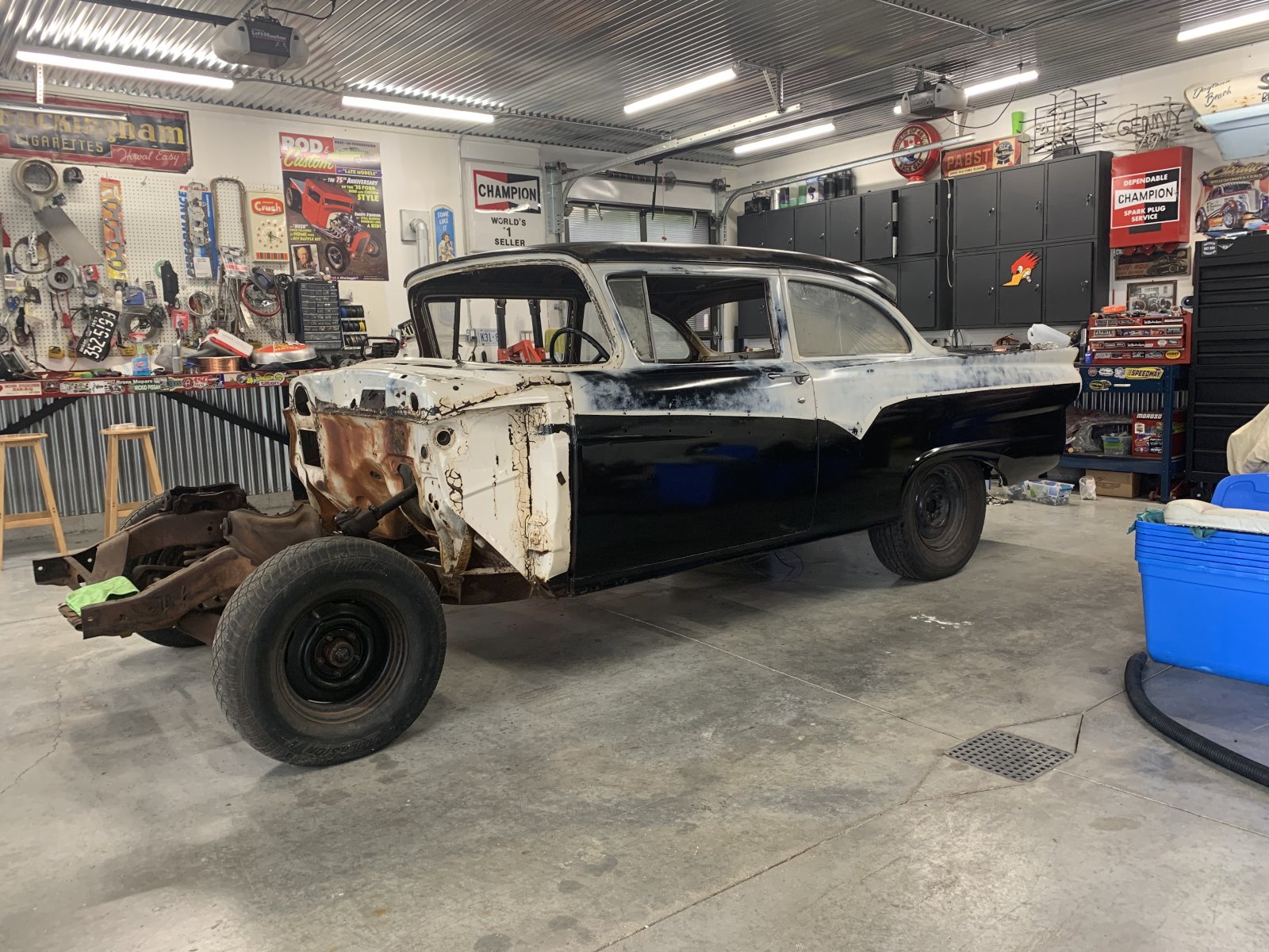

    Well,.... since my Black 57 is in Bodyshop Jail and no parole in sight... I decided to start the second one.(ooooffff!)
    Some of you may remember the kinda long thread(and when that car is back...I will continue on that thread.)
    https://www.jalopyjournal.com/forum/threads/my-57-is-home.818109/
    Anyhow..... Work has begun on the Texas 57 300......
    After staring at it for years..... and really thinking about the final end result.... I have come to the conclusion of leaving the body and paint as is...... not because of any love of the long since dead Patina craze..... simply... I just don't have the funds(nor do I want to pay for it)... to paint the car...... I feel something would be lost forever.
    As for now, its just gonna be a local beater.....
    FE Powered,4 speed and a factory feel.....
    As much as I love G***ers,drag cars, exotic drivetrains.... I have found myself moving towards simplicity rather than complication.

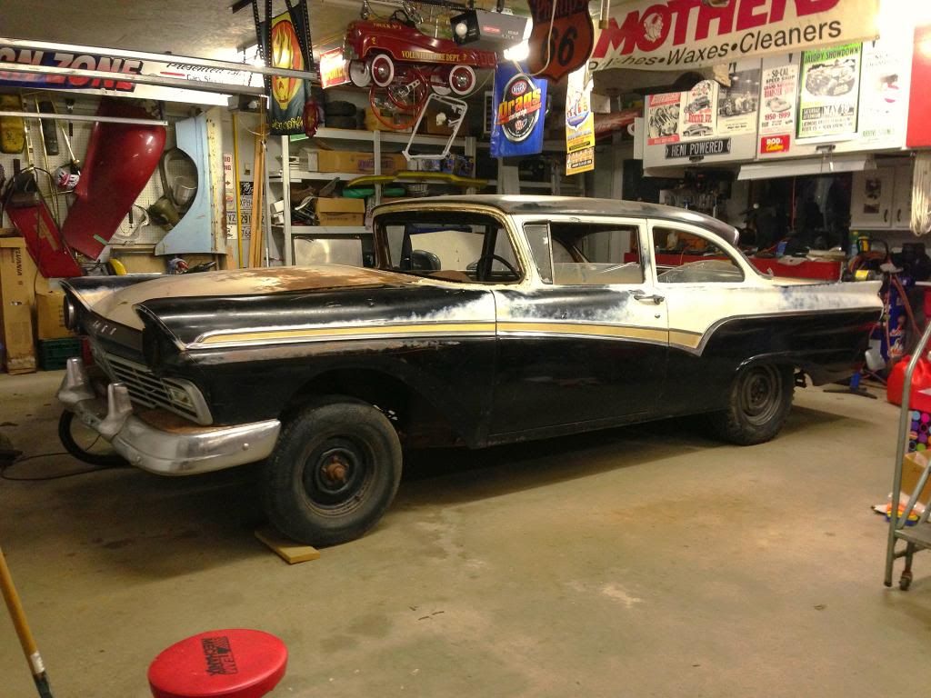

    This was the state I dragged the car home from Wellington TX.

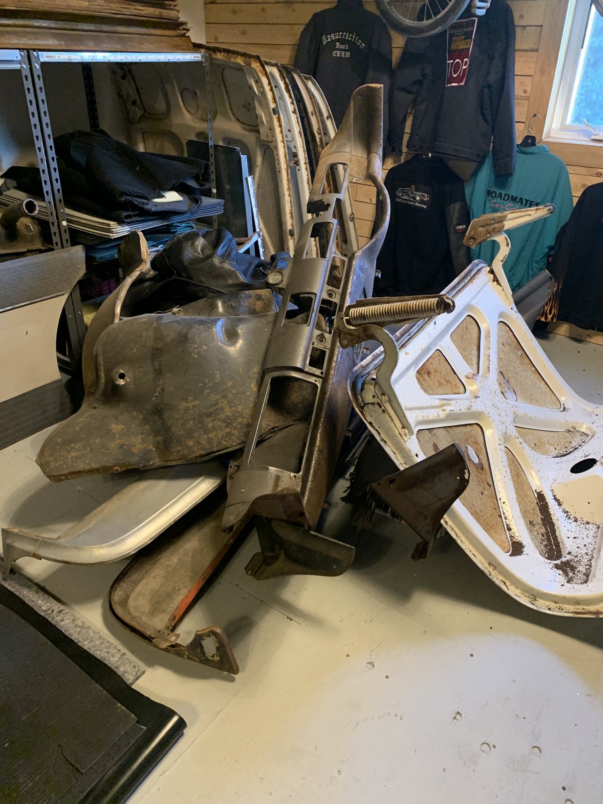

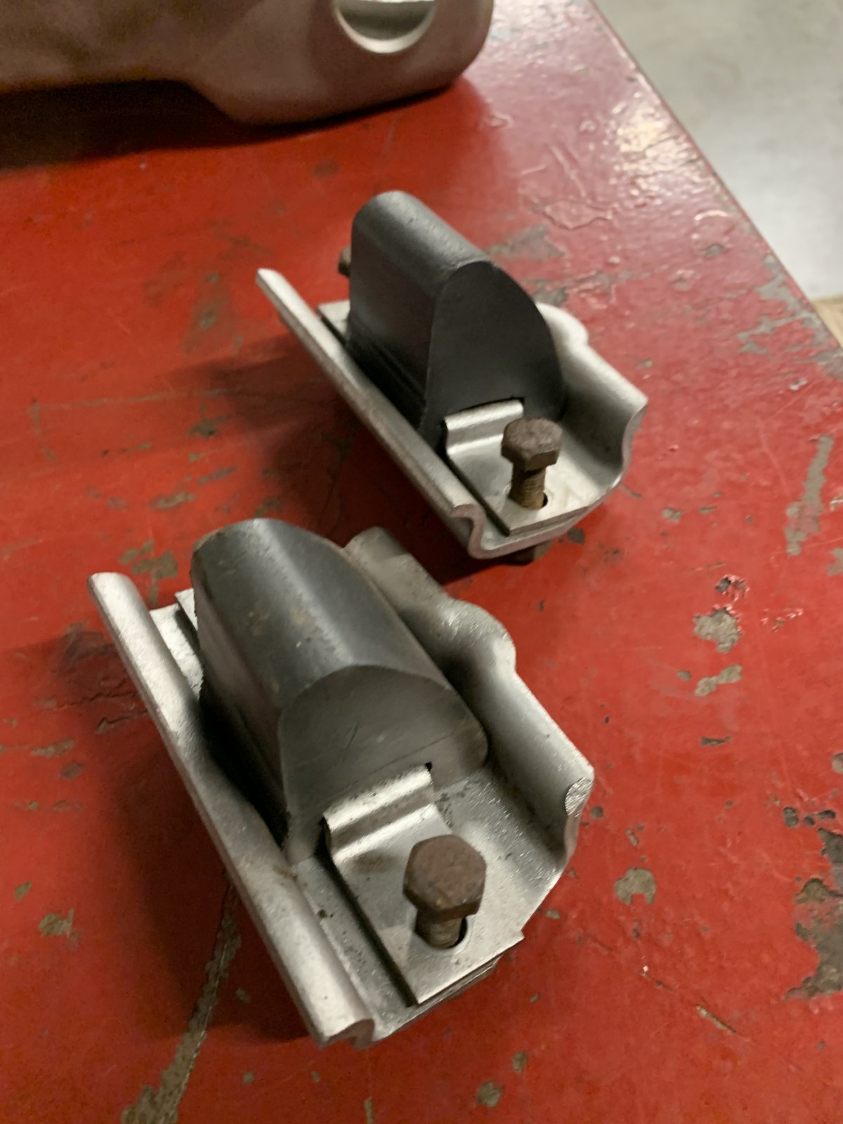

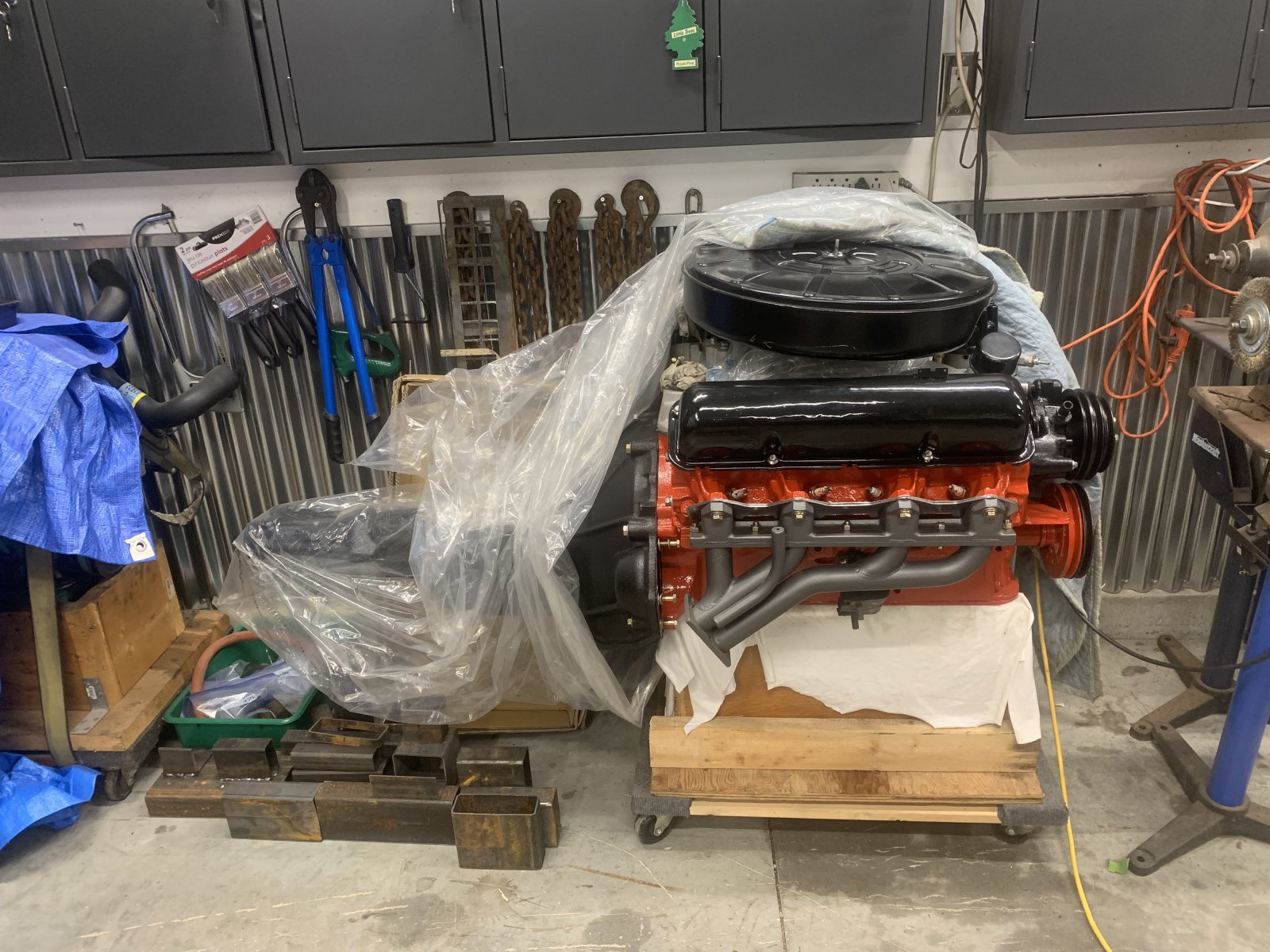

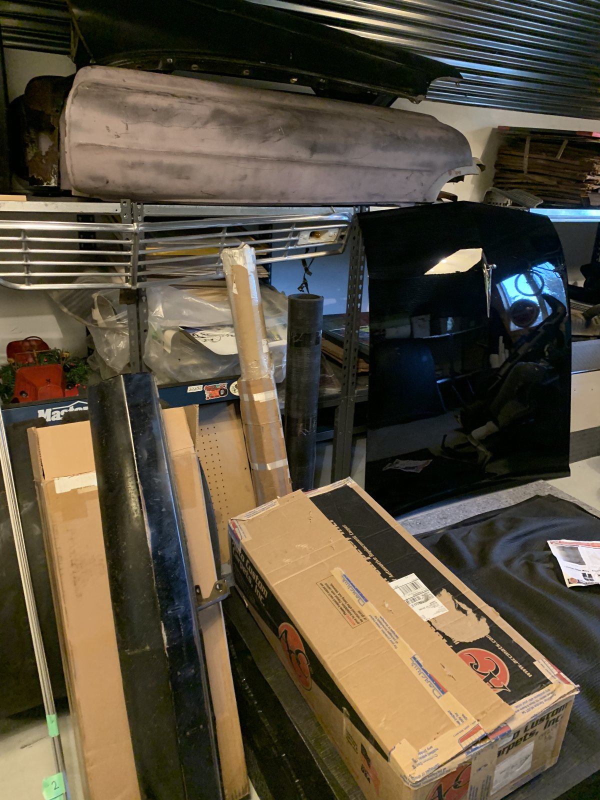

    And of course..I have collected most everything I need for this build,..I hate waiting on stuff.... so I have 95% of what I need........

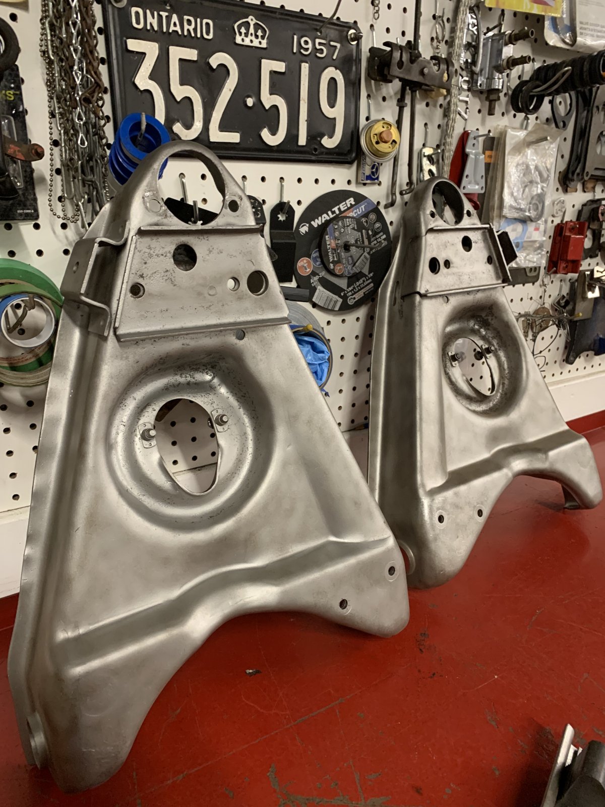

    I removed all the components that were in my way.. and started to do a rebuild on the front end.....
    I am very lucky to live near a pal who specializes in vintage parts.. and he had everything I needed for a complete overhaul on the front end...(bushings, ball joints,Idler arm rebuild kits, etc,etc....
    Shay from pre-sixties has all the good stuff. and a m***ive inventory of great NOS and NORS items for nearly every brand....
    https://www.pre60s.com
    Great guy,.. check him out.

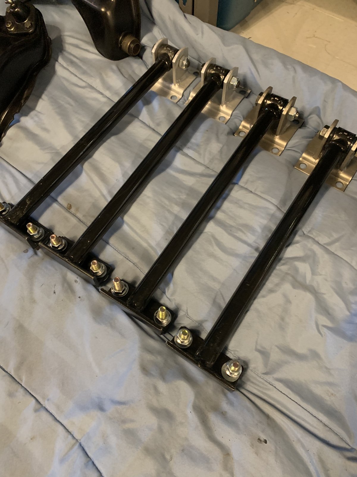

    I should mention..Last summer I did pull the rear out and rebuilt the 9, new bearings, seals,brakes and a new 3rd member ... 3:50 post unit..... new brakes. IMG_8517.jpg IMG_8510.jpeg
    ....As well as new Eaton 6 pack springs,shocks,spring pads, etc etc.... pretty excited I just received my traction masters to be added as the job progresses.
    (they took a very long time to get due to the current situation of the lockdowns and such.)

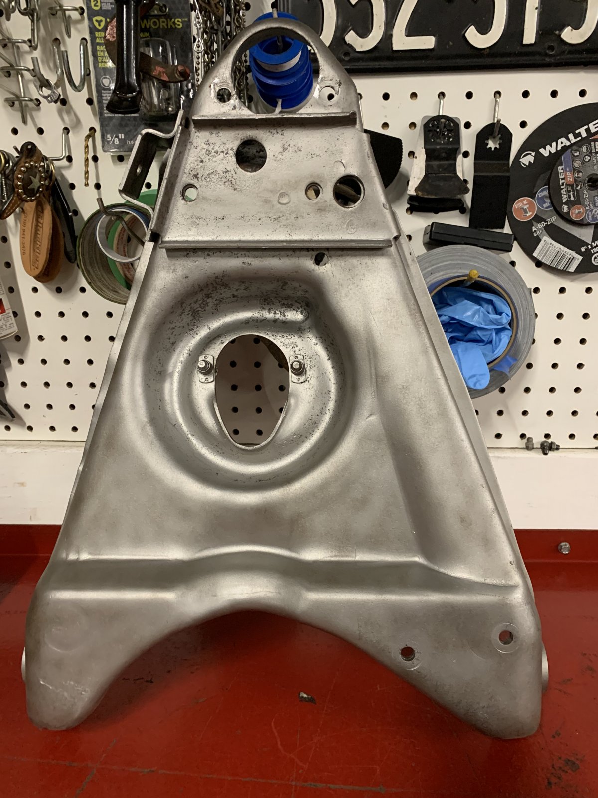

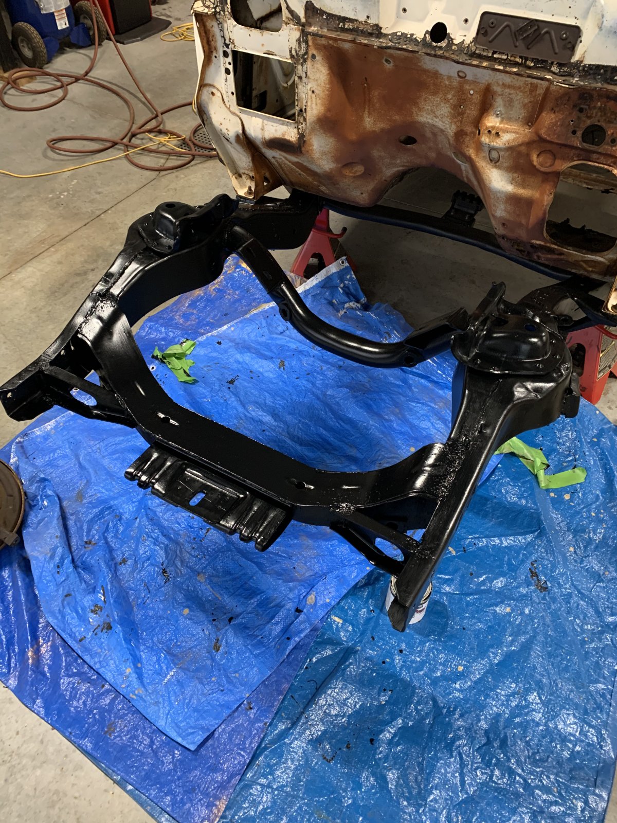

    After removing the front clip..... I began on prep and of the front end stuff.... again... pretty dirty job.
    Had a friend press in all the upper and lower A Arm bushings at his shop...
    ... just a visual of the journey so far.....

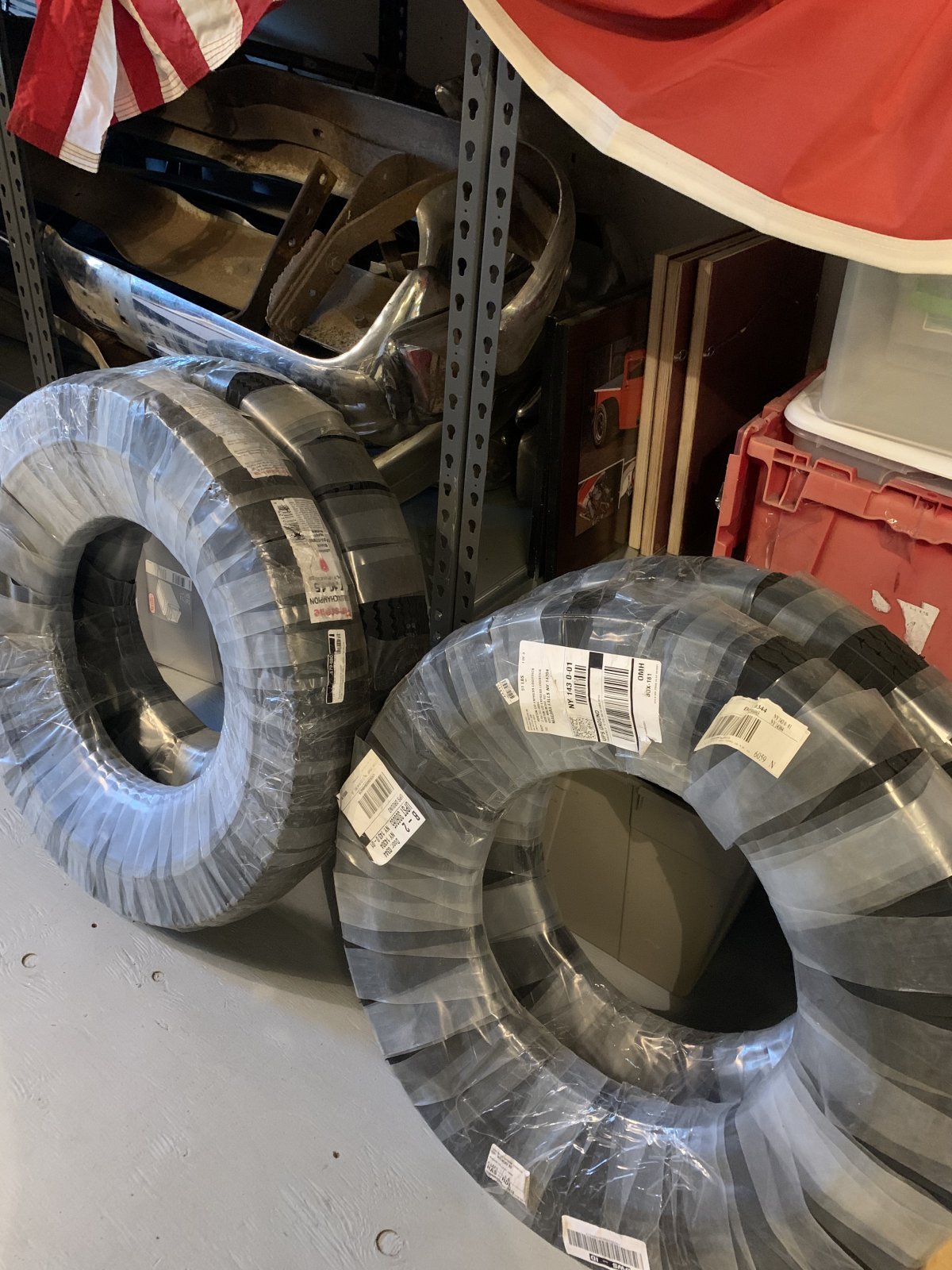

    I remember back in the day when tires came wrapped in paper. They were a real PITA to get to bead up, even with a cinch band. IMG_8514.jpeg

  16. If you aren't in a rush, take them out of the packaging, put a tube in each tire (no wheel) and pump them up. Leave them with the tube in them until you are ready to install on wheel.
