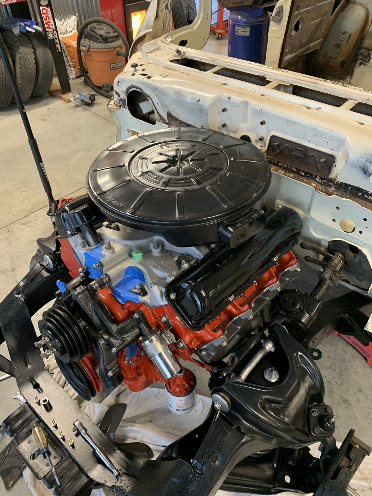

    Needed to mock up the carb quickly... I dug through the parts bin and found a spacer/riser I needed.. the carb throttle arm needed some height to p*** over the intake.... Going out to get some studs for the carb pad... this week some time.The Holley was rebuilt about 6 months back.

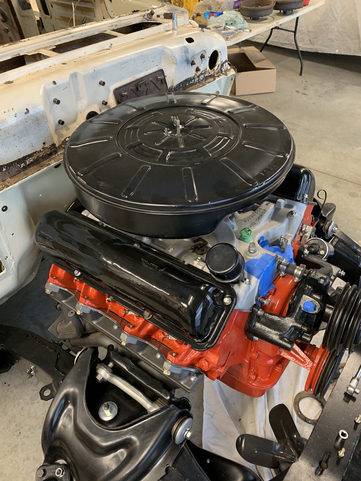

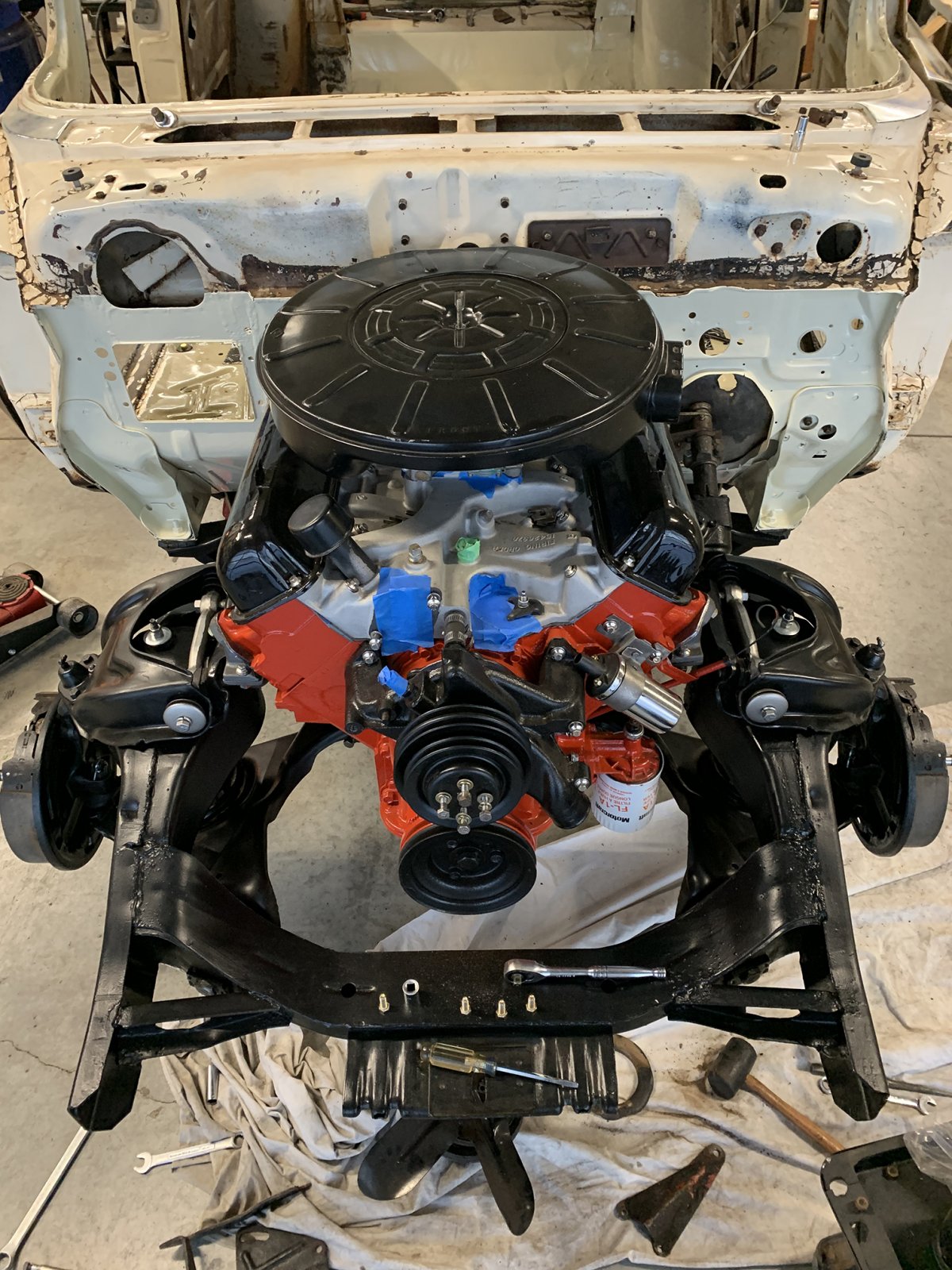

    Also,... I want to use a big ole factory Air Cleaner.... Which I plan to modify internally and add a matching air horn on the opposite side.
    My end game is to build a ram air induction unit... similar to a Thunderbolt unit..... so think of this as an early experimental unit(if I can make it work,)I have about 4-5 of this units.... so it may be a mix match game.
    But I needed to mock up and see if this Air Cleaner will actually p*** the hood latch.... or will I need to modify....
    ...looks clear so far.
    We will see.
    Still lots to do yet....

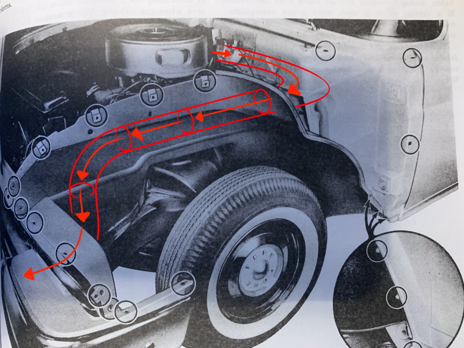

    If I were to do this Ram Air set up..... I would go through the inner fender at this point....

    Yea.I realize that......
    If I even attempt it, I would run the system as the quick mock up shows..... easy to find tubing material and even easier to attach to the inner fender.Both sides of the car in each fender of course.
    There is a open box under each DUCT 01.jpg headlight....
    anyways.... just ideas
