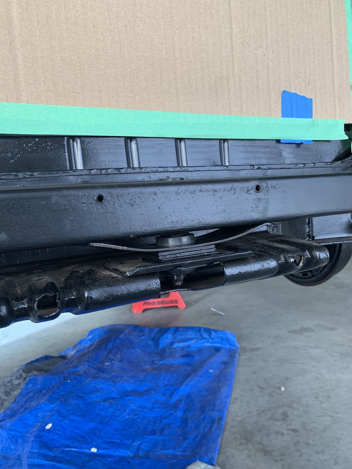

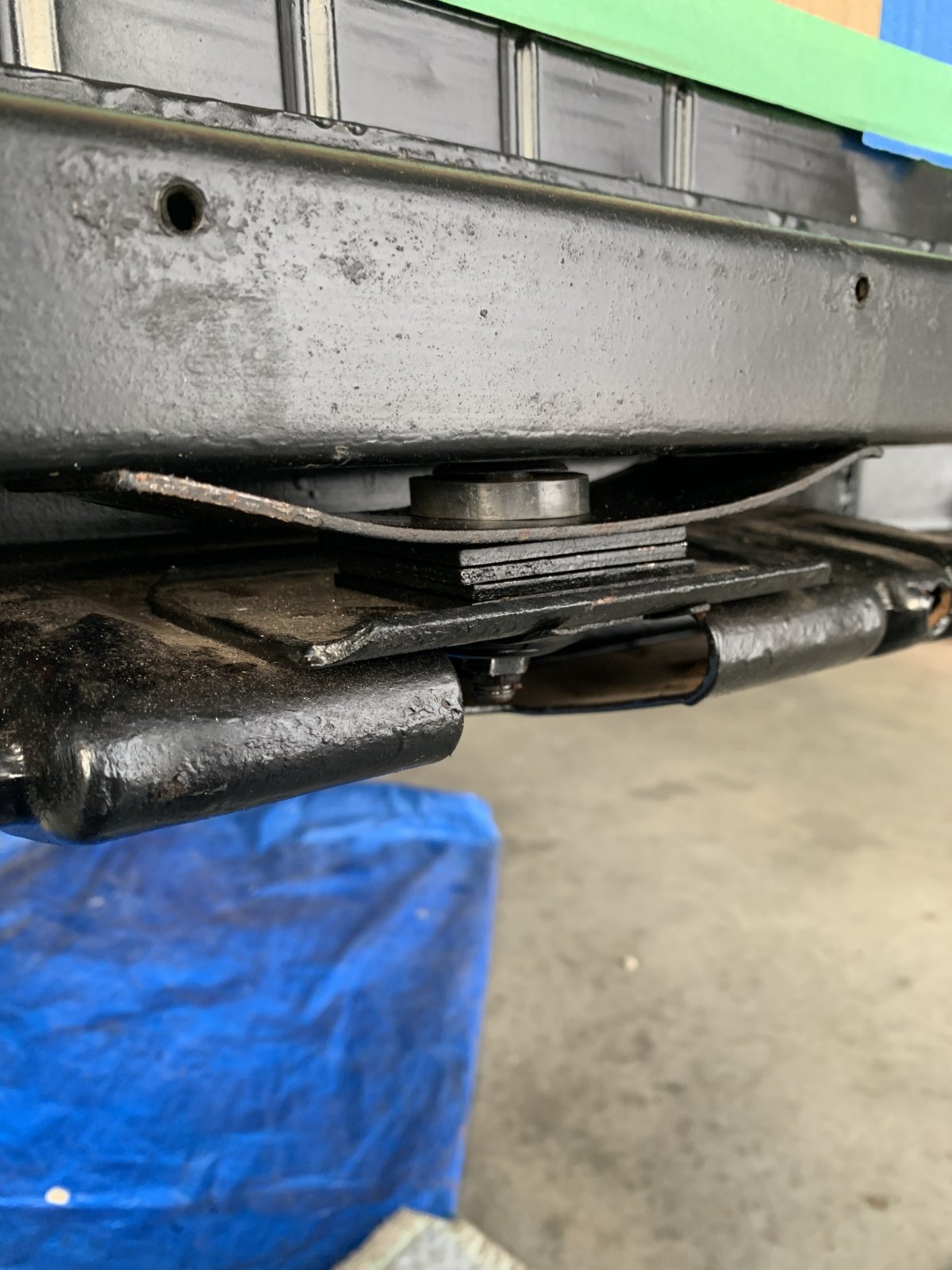

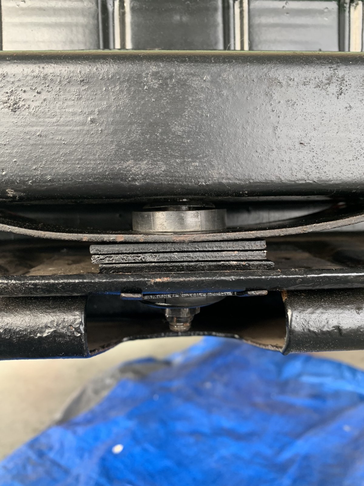

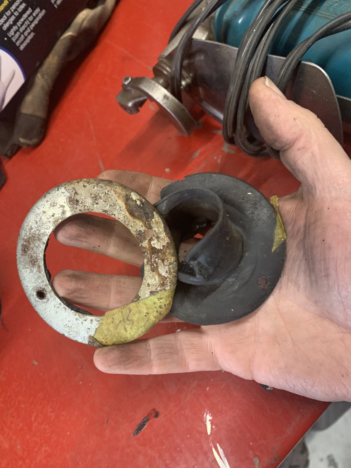

    In the past,.I seen missing shims.... missing retainers, broken springs and no rubber.
    Some folks indicate they have a bad rattle and severe vibration under load, idle de-acceleration or all of the above.
    Others, as I have stated... can't align a fender, the hood, the grill and use a m***ive amount of shims,... which just compound the problem and make the ride.. simply miserable.
    It's amazing how in 57 and 58 the whole front end was based on one core bolt.
    Another note.... your rad cradle(or saddle) as some people call them.... rot out hard at the bottom... drain holes get blocked and all kinds of **** just ferments in the base of the rad support and becomes a mess.
    The rad supports are getting pricey these days because of this.... if you need one... get a good one.
    So on mine... I coated as much on the inside base... and was astonished how much red west Texas dirt came out.... I literally spent a half day,. rinsing, blowing drying and the coating in inside base as best as possible... the painting the entire rad cradle with a rust inhibitor.
    It's not a pretty thing. but I saved it.
    Some pics of the rad saddle(core support) with the shims and stuff..... nothing is tight yet and that won't happen until I get the rest of the sheet metal in place.
    Later.....

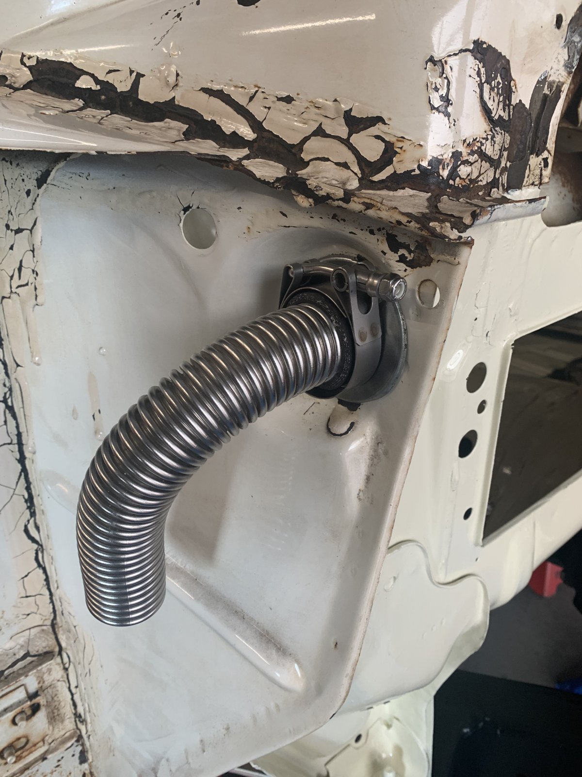

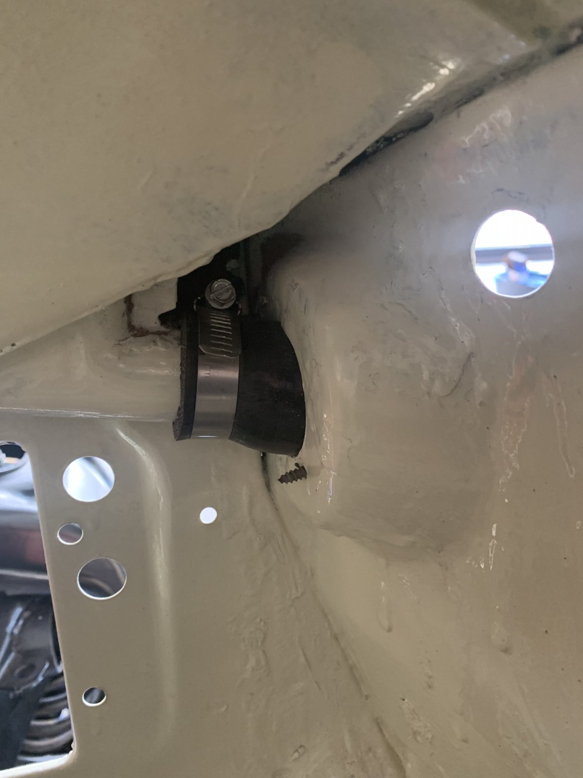

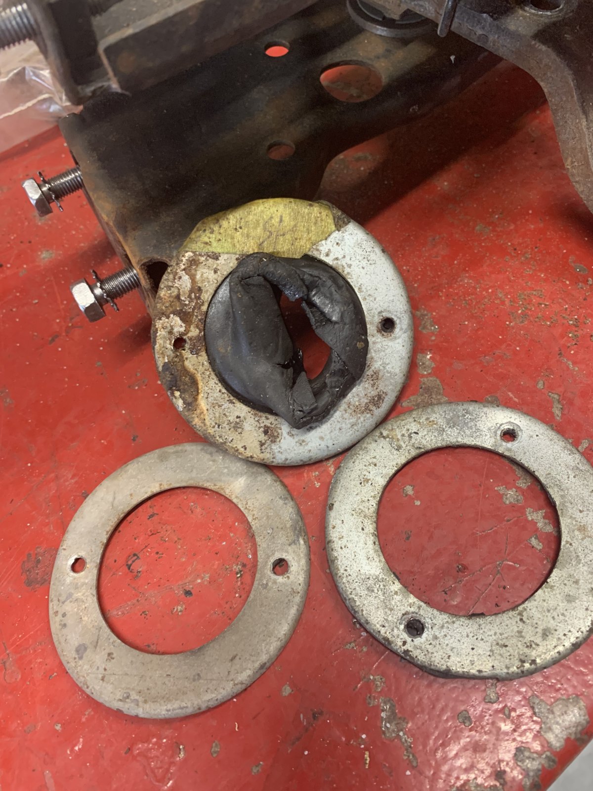

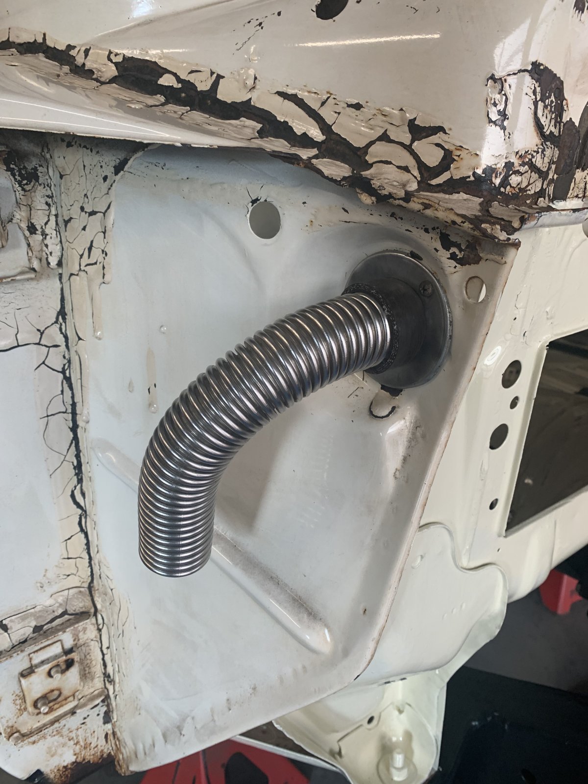

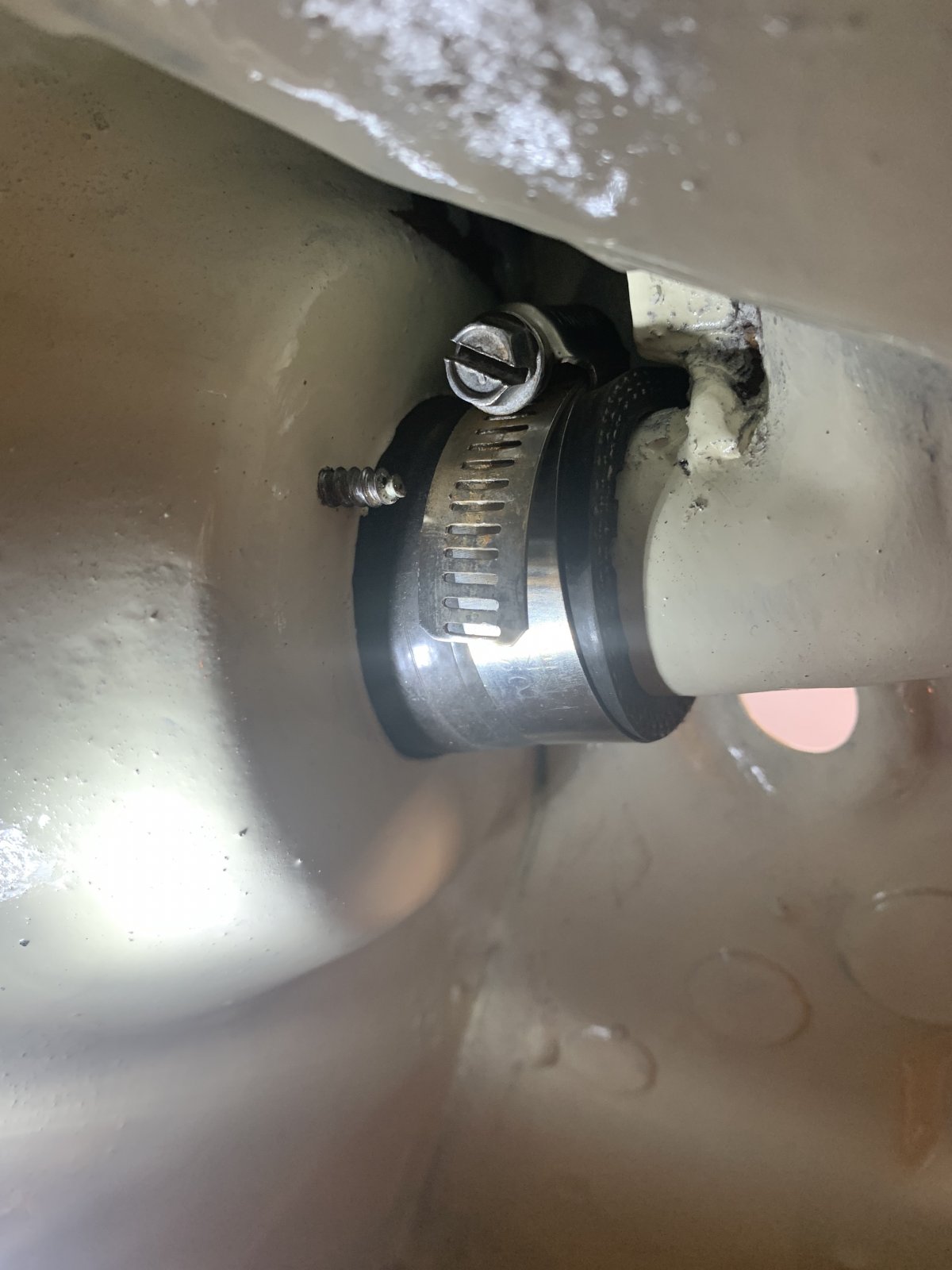

    Another are of concern is .... the cowl drains.
    If your 57 for 58 leaks from the inside.... its a really good chance the cowl drains are shot. The factory installed ones are/were useless.Now... again. not to get hard on the Ford designers.. but lets be honest... they did not really care, they wanted you to by a brand new 60 or 61 and trade in your well used 57/58.
    It's just business.
    In my journey for gathering parts I picked up some in my quest... I never really examined them until now..... I'm pretty sure they were thrown in a lot of parts years ago.... but they were junk.
    Many solutions on this and I am no different...so.....
    Started to look for things I could use.... I used some left over 1.5 rad hose, that horrible cool flex **** I used on my 32 (LESSON LEARNED!) and the original outer rings from the OG stuff.
    I still have to ***emble a reducer on the bottom of the C.F. .... I have an idea here... and run a 3/8's fuel hose out and thru the body and p*** by the front frame mounts.I could use clear hose as an exit line.... but.... not sure if it would stand up to heat and such.
    but so far.. its tight, and drains water after a test with zero leaks.
    I stand and look at it and it kinda reminds me of a limp **** at a wedding. ha ha
    Once the front sheet metal is on.... never going to be seen.
    IMG_9686.jpeg IMG_9688.jpeg IMG_9689.jpeg IMG_9690.jpeg IMG_9691.jpeg IMG_9693.jpeg IMG_9695.jpeg

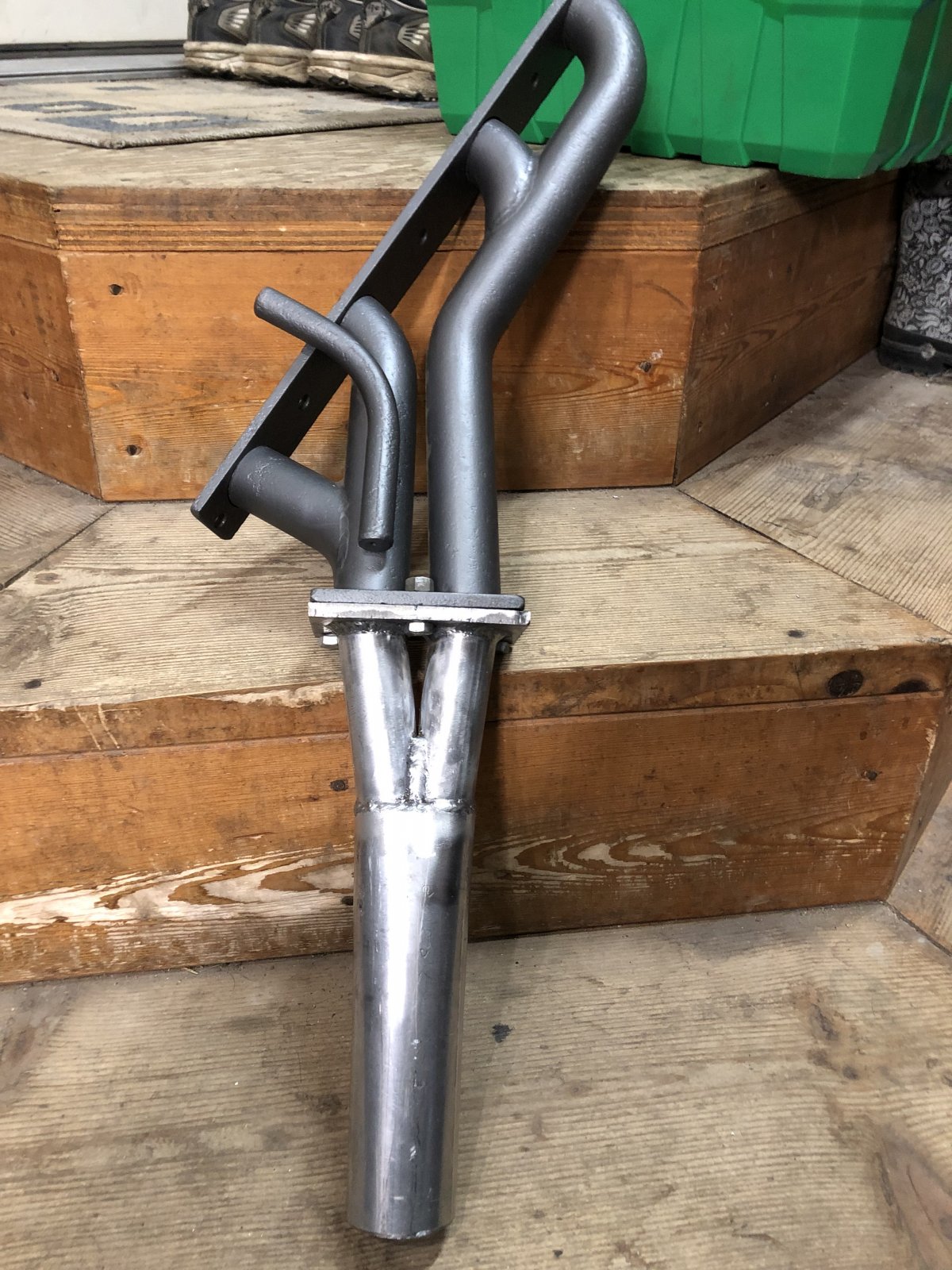

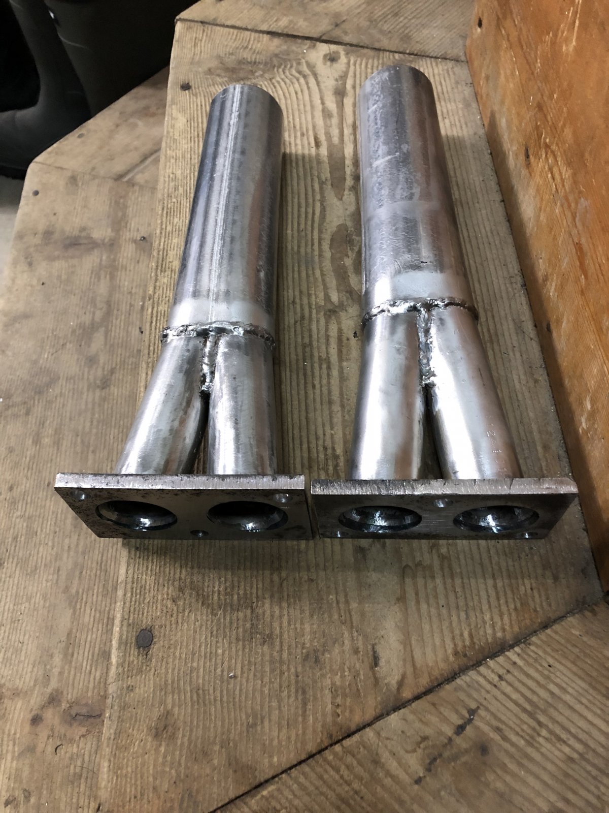

    Also..... the Header collectors are done... now,. they are very long at the moment..but, better to be long where I can see and shorten to where each side needs to be.
    The welds will be cleaned up and softened, then a manifold Heat paint applied... and attached to the system.
    Exhaust is a 2.25 through out.

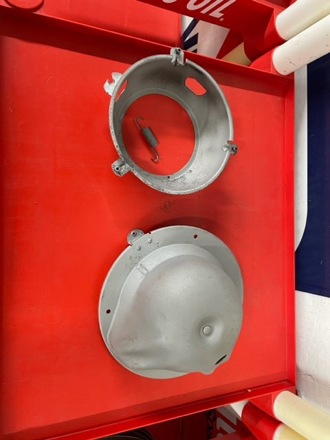

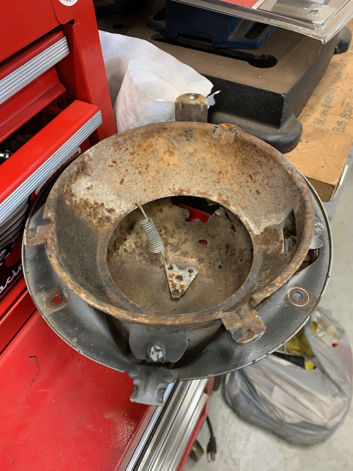

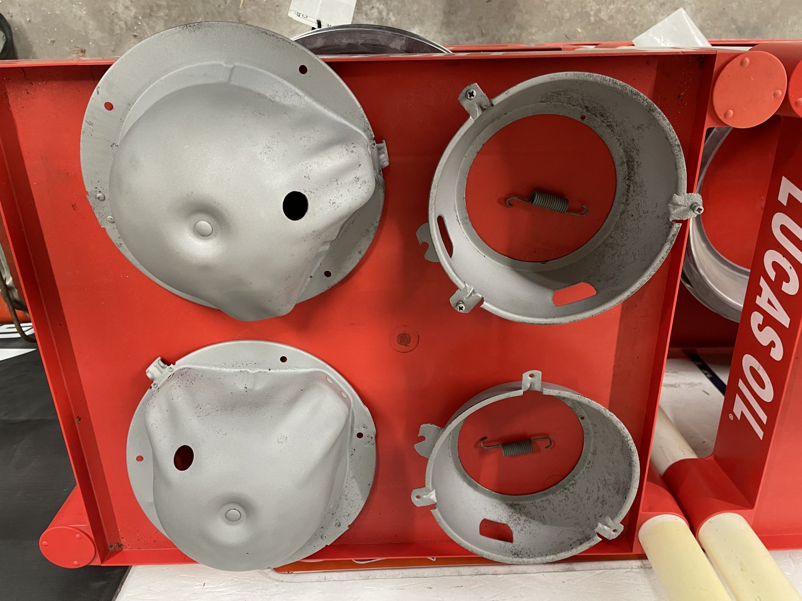

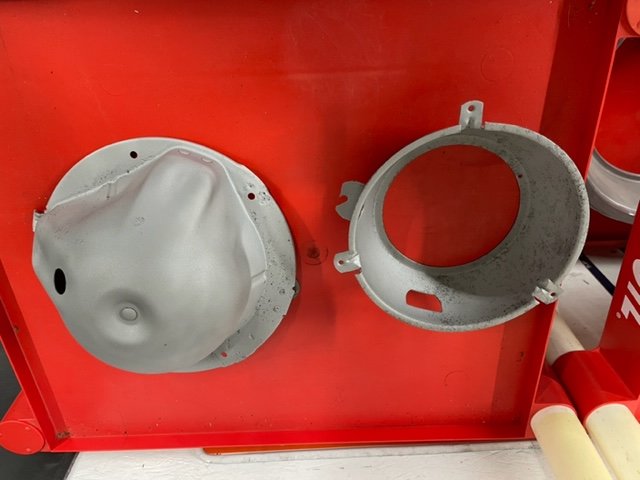

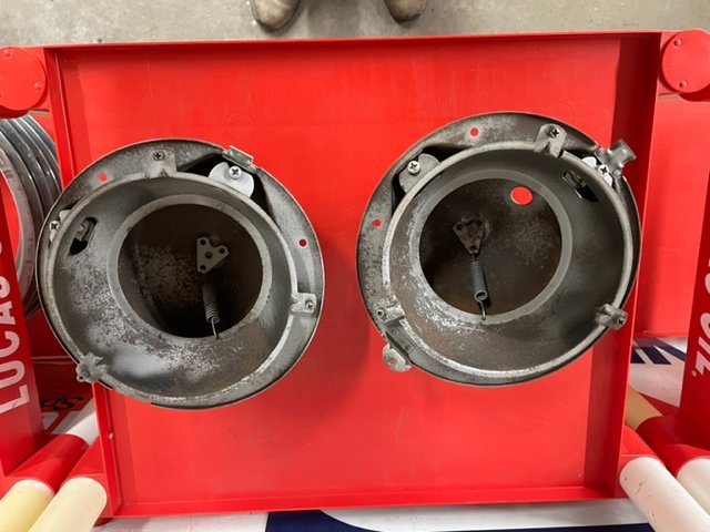

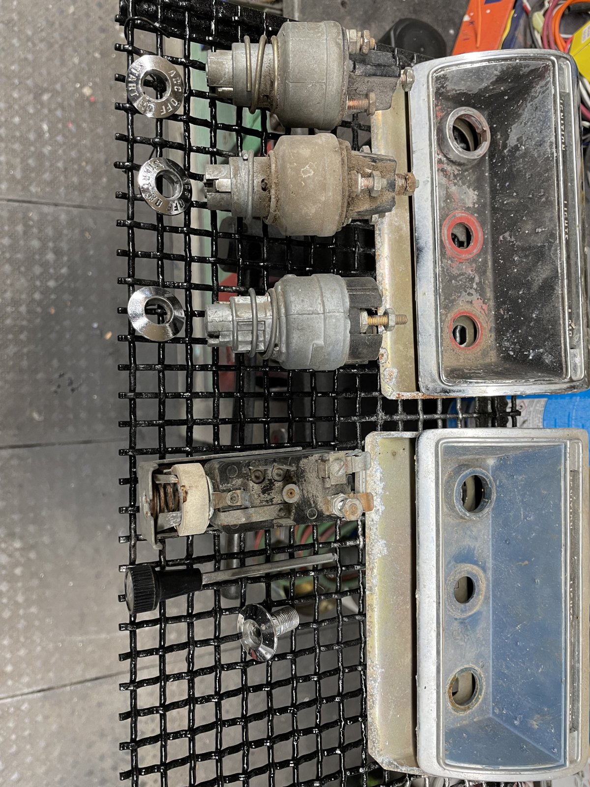

    Was in need of some Dash parts and headlight buckets.... the buckets I have.. are done.... another part on a 57 that gets rusted out very fast.....
    What I had in stock was ... eh.... less than desirable...I guess I could have fudged and gl***ed about... but... they are gross.
    so. speaking with yet another Terry @PoTaToTrUcK ... a very good member here .... out on the Hippy Coast.. he came to my rescue.
    The ignition, light switch and bezels(no one sells the 57 bezels) and much needed headlight buckets....
    are being sent.
    Happy now, and another thing crossed off my list.
    Thanks Terry!
    My old Buckets..... gross
    66577720418__7B4CFC09-30E5-490C-82D6-985BDA19153C.HEIC.jpeg 66577721505__14A4EA9E-8CC2-44E2-A003-58B0649CB009.HEIC.jpeg
    Again. the items Terry is sending my way will fill my need..... IMG_2607.jpg IMG_2613.jpg IMG_2616.jpg IMG_2617.jpg IMG_2618 2.jpg

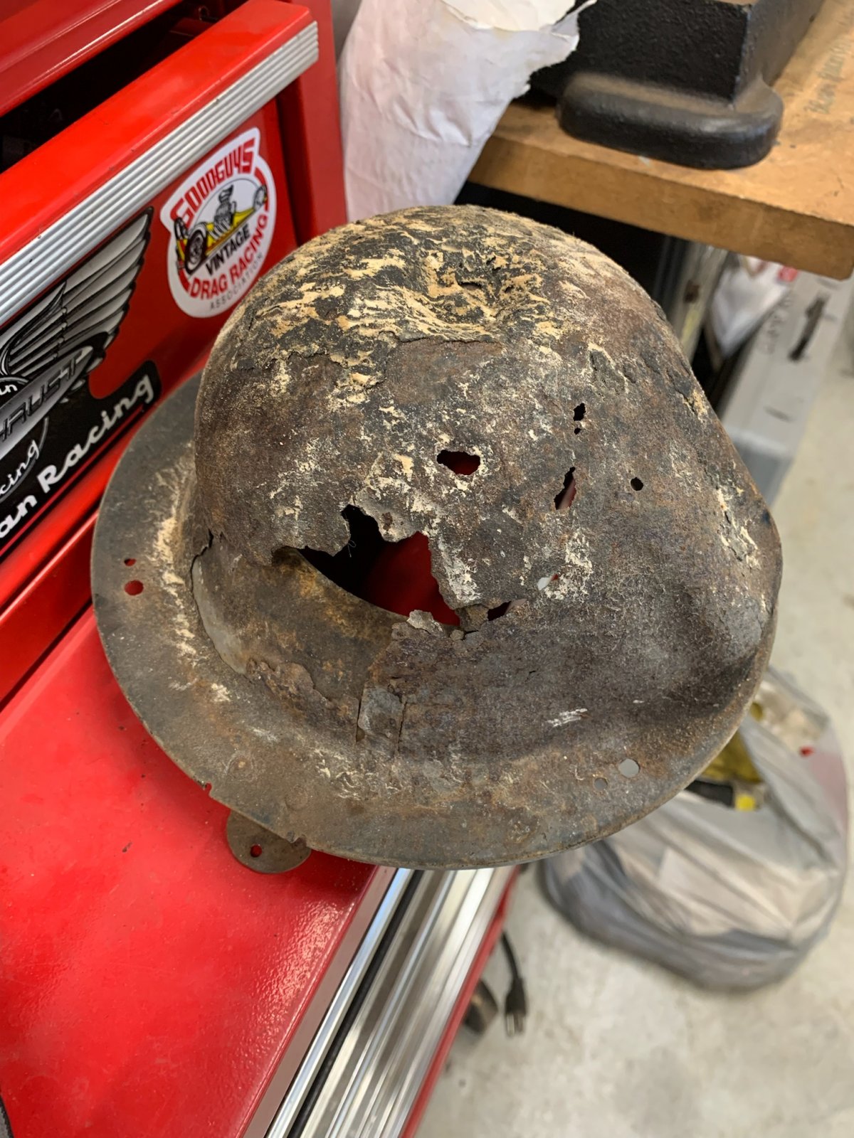

    Nice score on those headlight buckets. I couldn't find rust free ones when I restored mine. Mine were actually a little worse than yours, at least after a heavy sandblasting. What you had can be restored, and actually pretty easily. I did mine about 14 years ago, and they still looked like new when I had them out 6 months ago. I won't clog your thread with a lot of detail, but basically it involves a good sandblasting, a plastic walmart bag, some (wet) fine sand, and a tube of POR-patch. Por patch is a thickened version of por-15 in a tube.
    The bag is put inside the bucket and filled with wet sand, just a little more than full. cardboard is cut to shape and taped to hold the sand in. . get as many wrinkles out of the plastic as possible, and make sure the bag/sand holds the needed contour. Just apply the por-patch to fill the holes smoothing out and let it dry overnight. several coats, and finish to suit. After painting (or por-15) you won't be able to see where the rust holes were., and it's so solid you can't tell by knocking where the repair is.
    Don't forget to remove the sand, lol. Sorry it got so long. And, I couldn't find pics.
