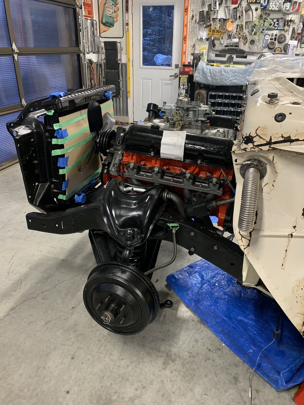

  17. Jeff Norwell
    Joined: Aug 20, 2003
    Posts: 15,281
    Jeff Norwell
    MODERATOR
    Well........good amount covered today...
    Mocked up the rad and rad cradle today.... its just sitting there on its single core support should bolt.
    I really wanted to see the spacing between the fan and rad.I think I have 2 inches at the max.... which in the future I can adjust when the inner fenders and fenders go back on.
    No other sheet metal will go on.. so I can do all the other things needed and freely,(steering, headers ,etc, etc)
    Also,,... the front suspension is not tightened... I need to wait until its on the ground and on its on weight.... don't want any binding.I also want to move freely to do the master and brake lines.... and finish the cowl drains..... plus a plethora of small things....

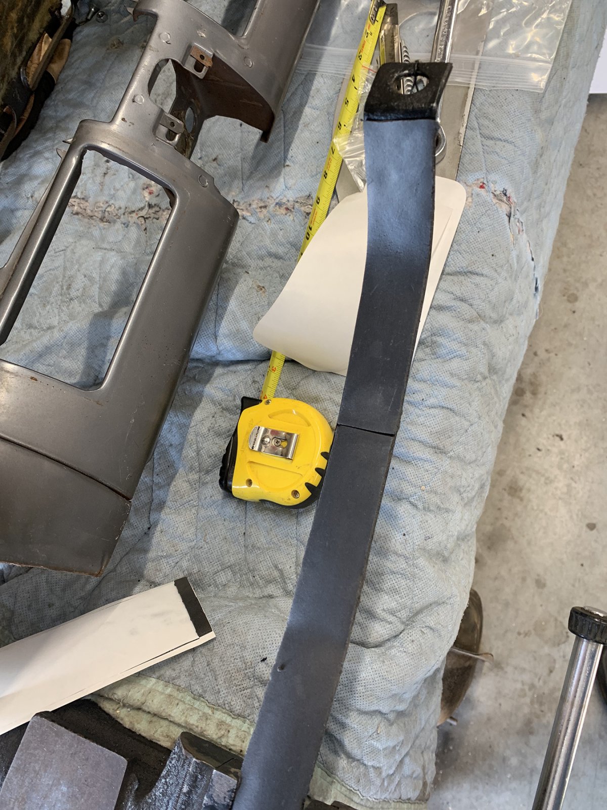

  19. Jeff Norwell
    Posts: 15,281
    Jeff Norwell
    MODERATOR

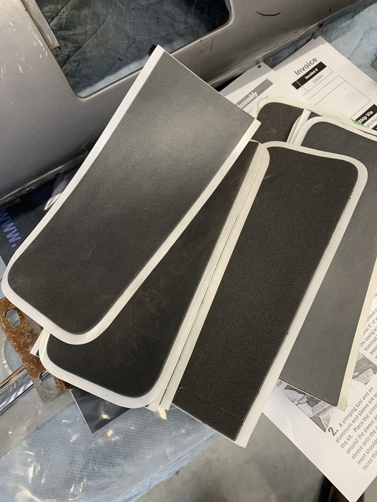

    So.... I'm really close to seeing the fuel tank go in...I had 2 spares....but after a closer inspection..I broke down and bought a new one,.... the 2 I have would require more $$$$$ than buying a new one.... they are really filled with rust..... and somewhat dented.... hard to fix ,clean, boil and pray it works.
    but I have many tank straps... cleaned and painted, but did not have the rubber bands to go between the straps and tanks.
    Yea.... you "could use a old inner tube... but.. its just plain sloppy.
    My pal Terry who I have mentioned a few times is a Ford Tech, works the local dealership..... anyhow.. months ago... he had a ton of this material that is used on a re-call for a certain Ford on the door handles..... can't remember the vehicle.... but he said..."Maybe you can use them for something"
    Definitely,..... They at Ford, just throw this excess away.... and its really pliable, stretchy and super strong, very easy to cut.So I cut some strips, using the adhesive side down and will work and never be seen. Gonna use it as well between the body and fuel tank.The factory used a cardboard fabric that was long disintegrated.
    I am going to use it as well in the interior as a sound deadener.In between the dash/body, anywhere a squeak could happen.Anywhere where 2 body parts or brackets are joined.. its so thin, durable and easy to work with.The Adhesive side really sticks well.

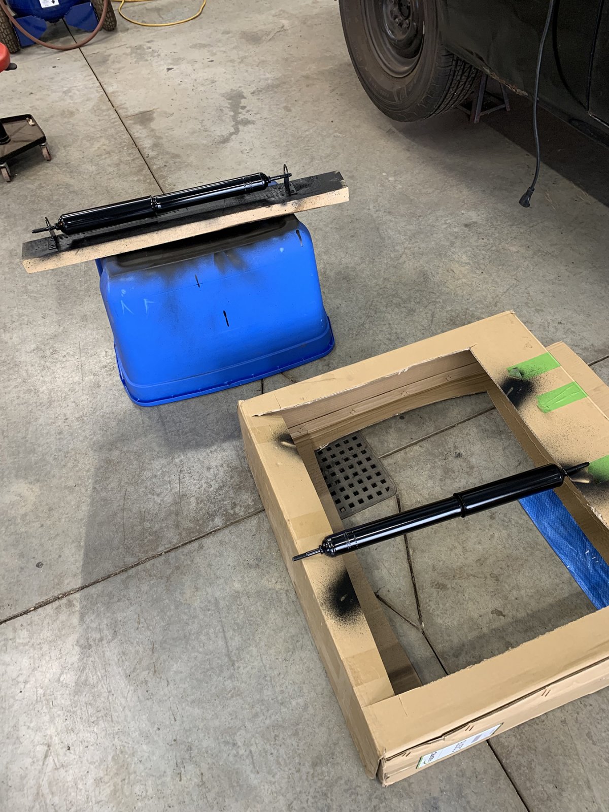

  25. Jeff Norwell
    Posts: 15,281
    Jeff Norwell
    MODERATOR
    So.. I mentioned this at some point in my other 57 thread.. but.... if you wants a bigger tire on the rear(and the 57 is VERY limited , ) Go with a standard 56 Ford rear shock... drops the rear another 2-4 inches, .I had an issue because I LOVE a big side wall... I literally had to deflate the rear tires to get them on and off.
    Real PIA,.... so I picked up another set.....
    Now.. when I bought my first set...Napa,... They were $22 bucks a shock.... now..... $45 bucks in 2 years........
    Oh well... the world is very greedy.

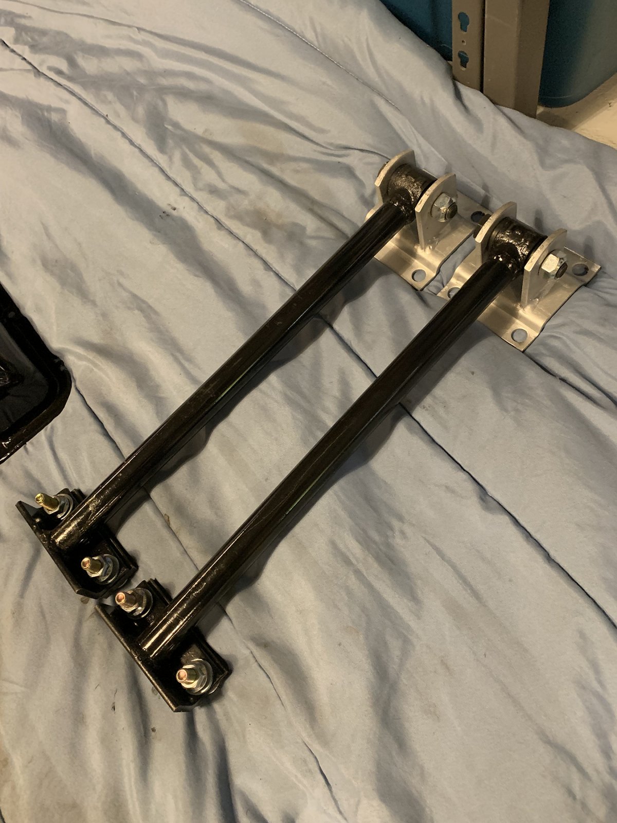

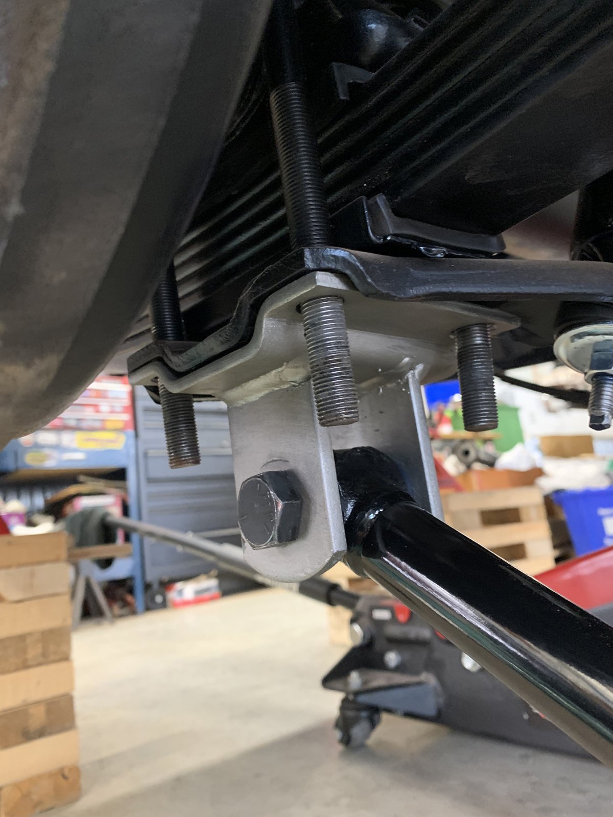

  26. Jeff Norwell
    Posts: 15,281
    Jeff Norwell
    MODERATOR
    So after the shocks went on.....(I'll keep the 57's for spares) I have been itching to get my Traction Masters on....
    Well made and these are the bolt on units..... Did not the permanent weld on units...
    so got that done.... Since the company has been around since 53... it was the right choice.
    Whether they will work to maximum efficiency.. doubt it... this is a street car.... but..I love them and they are correct for the car and cool.
    At least they aren't those god awful yellow Mr Gasket JUNK....
    hahah
    I left the arms loose until the car is sitting on its own weight.....
    but.. it was very straightforward.... Just reefing on them long U-Bolts kinda got real long in the tooth.

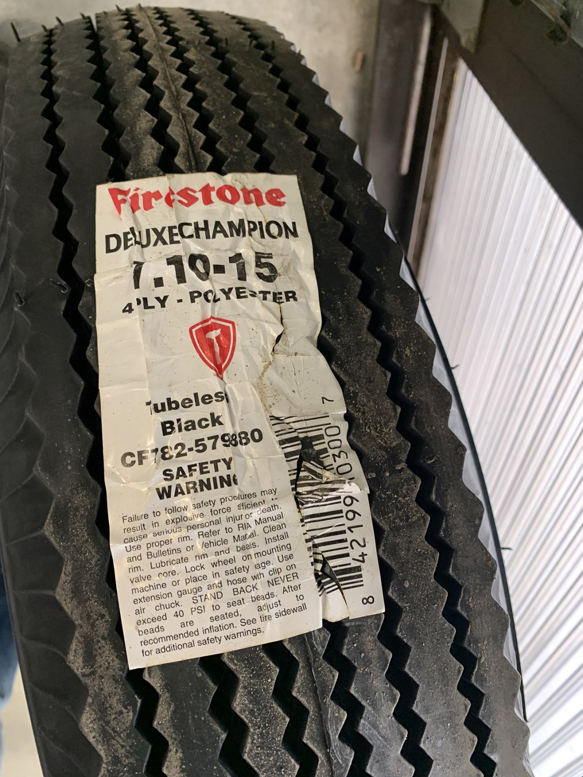

  27. Jeff Norwell
    Posts: 15,281
    Jeff Norwell
    MODERATOR
    And lastly.. Had my 56 Ford 15's painted up by Tom the Painter (like 8 months ago) and bought the Firestone Champs in the summer
    Trying to get Coker or Universal products... today is PAINFUL.... not their fault.... but if your looking for rubber for your ride... better order.... you could have an extremely long wait.
    So....running a 6-70-15 up front and a 7-10-15 in the rear... they balanced up PERFECT.
    I keep hearing these horror stories.. and Owned countless Bias Plus...... NEVER an issue.Ever.
    When I go for a super long haul...I'll dump the radials back on.... but 80% of the time.. I will be hugging my Stones.
    Im a happy guy today.
    The fight continues.......

  29. Rickybop
    Joined: May 23, 2008
    Posts: 10,697
    Rickybop
    Cool, Jeff.
    The wheels/tires look great. Good to know that the bias ply horror stories might be a very small minority.

    Your traction bars don't look like they're floaters. Are we thinking that we can live with a little bit of bind?

    How do those traction type bars hook up? Just curious as I am not building a hot rod just a stock wagon.
