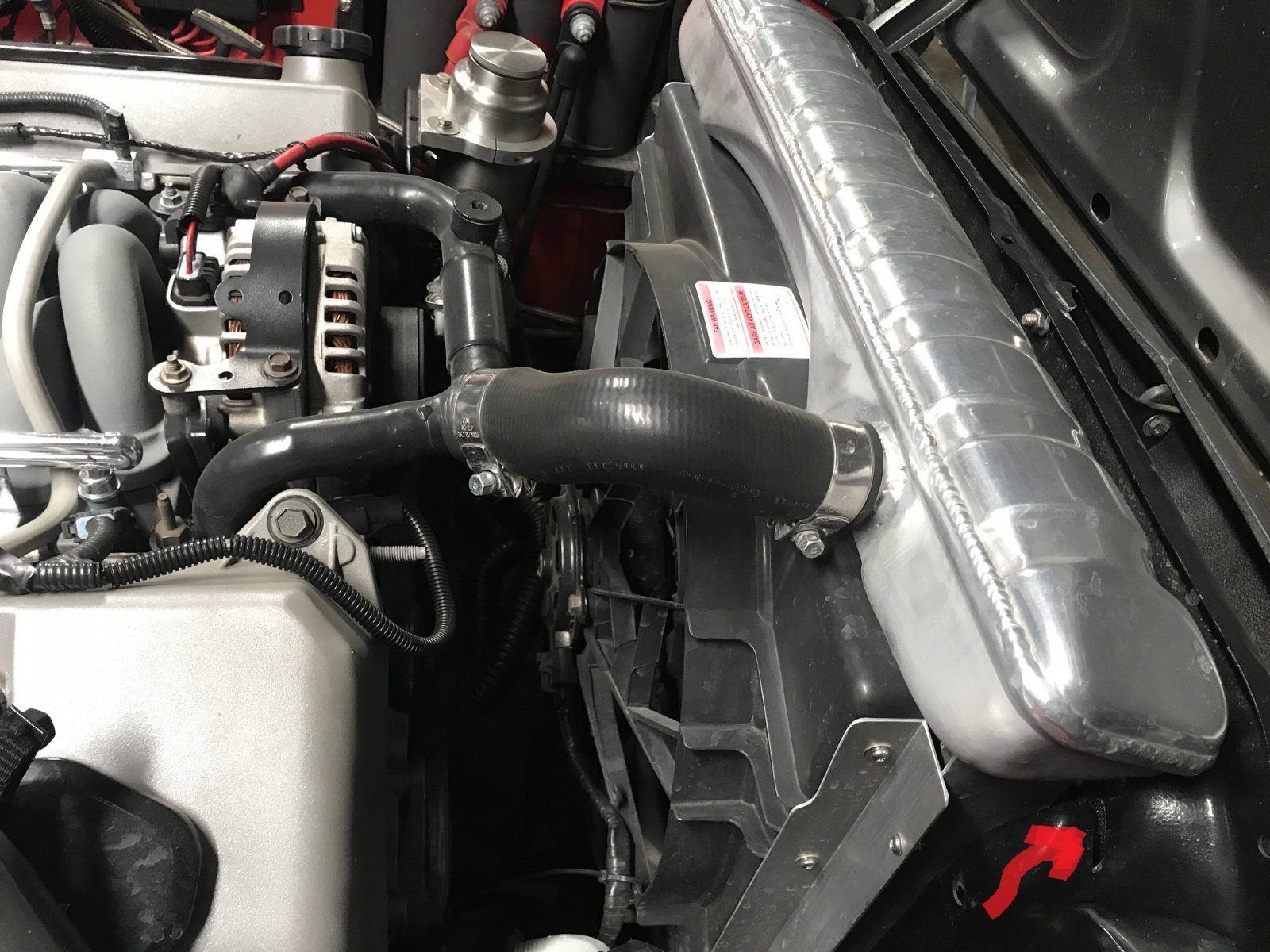

    IMG_3731.JPG Jeff, if you need a little more space between the radiator and fan, there's a pretty easy way of gaining an inch or so. It just involves cutting a narrow slot on each side of the core support so the radiator flange can be dropped down in front of the core support's flange. Then a length of 3/4" square tubing for a spacer with matching holes. Some type of a press nut will solve the fiddling with loose nuts and washers issue.

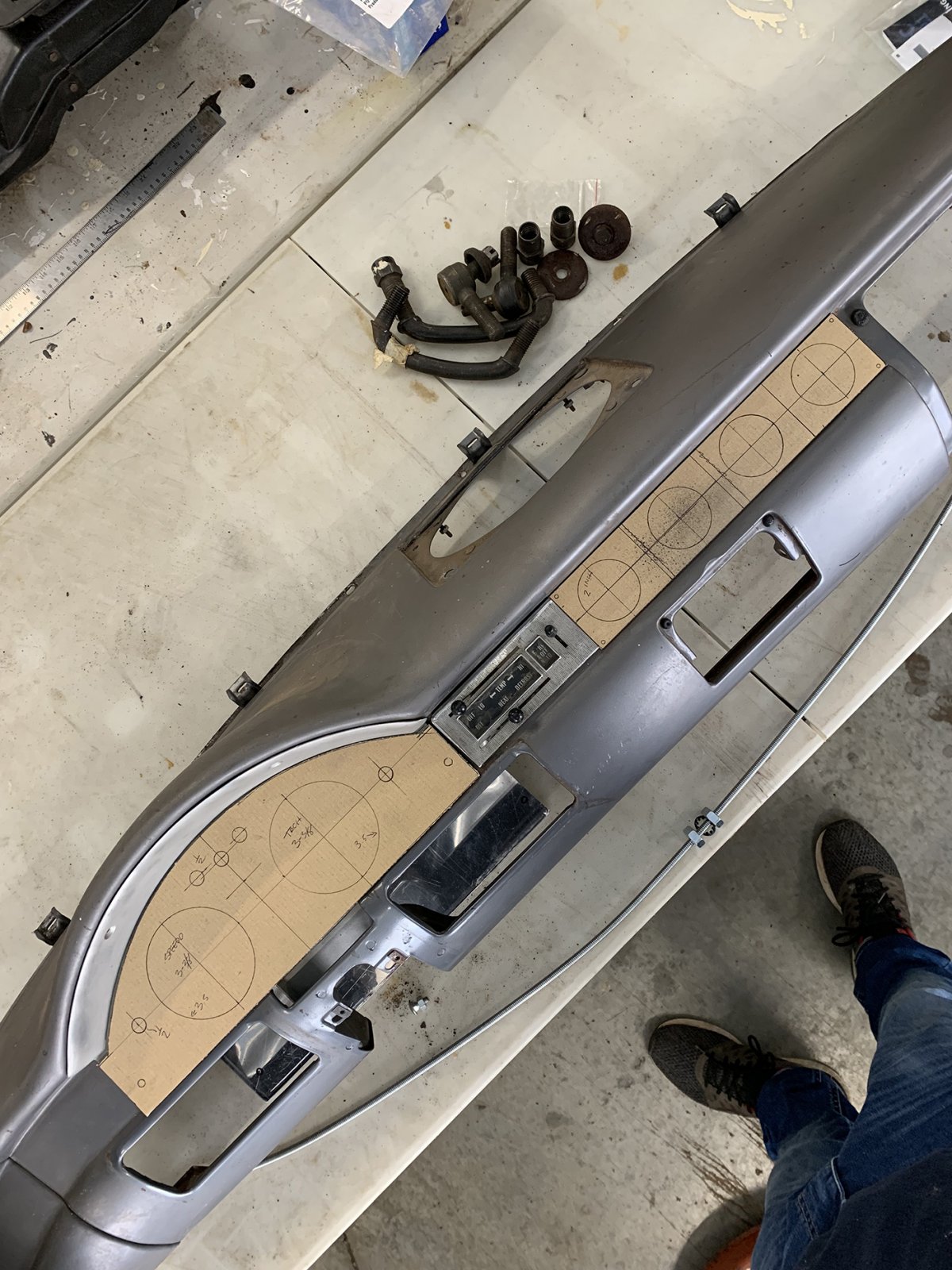

    Well. a few moves forward today.....
    Spent the morning scratching up my layout for the dash design.... nothing world crashing.. just simple.
    Removing the radio area and clock....Plan on engine turning the plates with the gauges.....
    I am gonna run the factory heater/Defroster.....

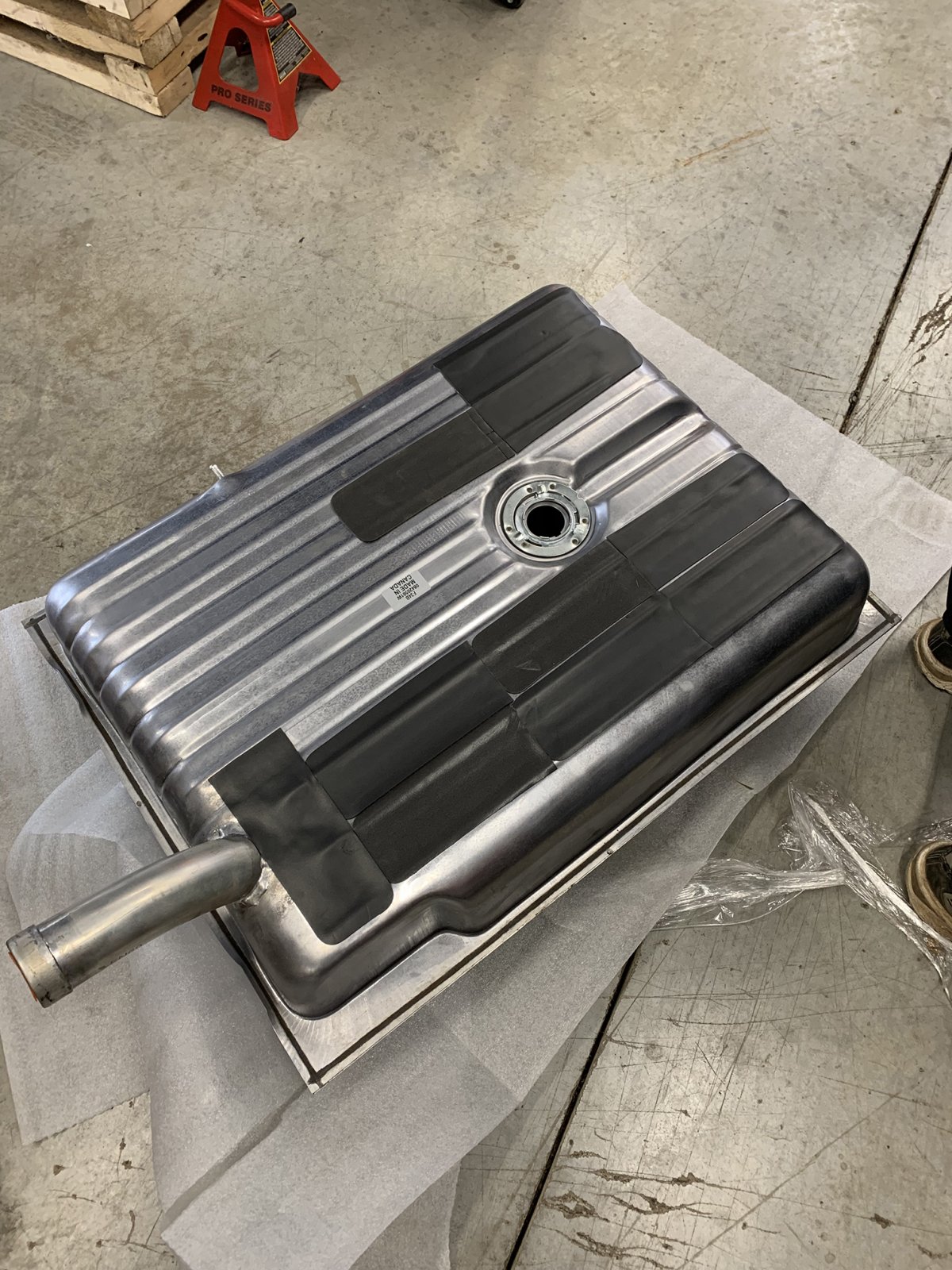

    48.jpg That stuff I mentioned a few posts back..... the stuff from Ford ..... I used it on the top side of the tank to use as a noise/anti squeak pad.... So easy
    Found out they use in in a Ford F-150 re call for door Handles.
    So the fuel tank will go in very soon.... sender and all.

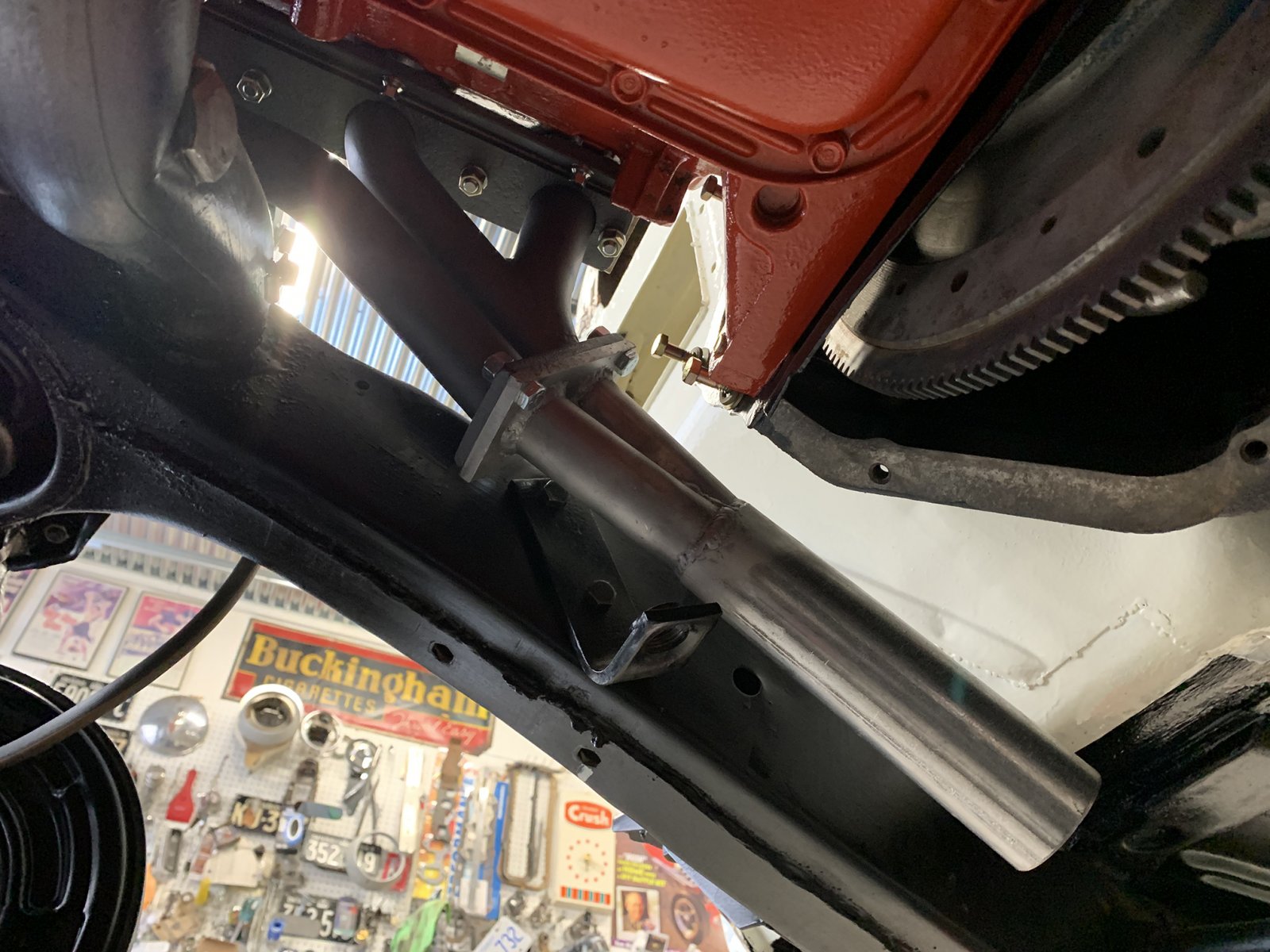

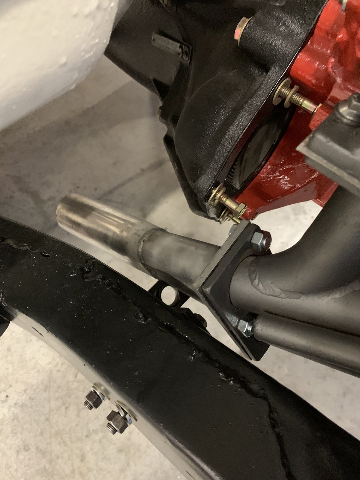

    And Lastly.... Mocked up the new Header collectors and everything is looking good....
    I really appreciate all the encouragement and comments Guys.....
    More to come soon
    thanks!

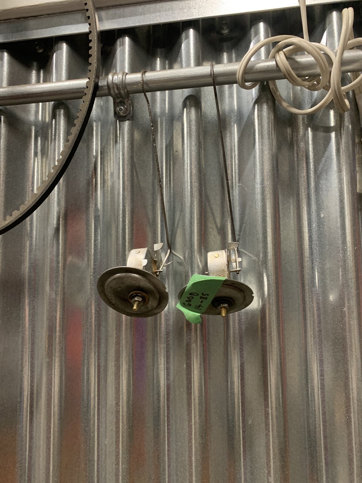

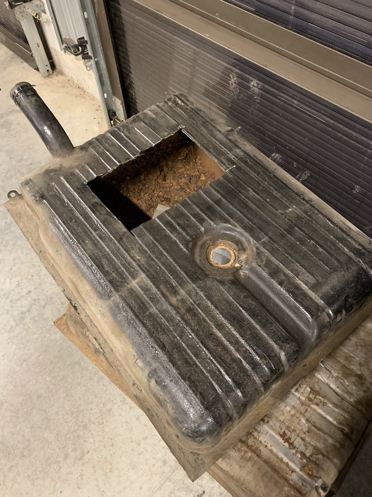

    On a side note.... I was reading a great thread by @guthriesmith and he and his son's adventure of the boy's Edsel.Great thread..... Have a look and read.
    In his thread..... the Edsel needed a new tank and all the headaches that can come with that....
    I am an admitted Hoarder.
    I had 2 old 57 tanks I thought I could keep as spares.... but I knew they were pretty beat.... the undersides looked like they went 12 rounds on the losing end.Way too much to fix and you could never save the tank and straighten them
    How the heck does a fuel tank get that beat up?... or filled with rust????
    Anyhow.. being a cheap ***..... I pulled the senders out and cleaned and tidied them up.
    I admit..... fuel senders have always been that super magical hidden unit that could say"You need Fuel!"
    Very simple in reality.... but. here where my skinflint plays into action.
    I'll be damned if I am gonna pay $40-80 bucks, then dollar exchange, then shipping then customs and duty tax on a $3 part made in India.
    Anyhow.. got both senders to read.... and one very well.I thanked my pal Terry for taking all the mystery out of the $3 part... and he is a cheap *** like me.
    One of the reasons I like him.
    Hahaha
    Sorry..... Useless post.

    My sender was ancient, so it had to go. The br*** float crumbled like it was made of a thin egg shell from a small bird. IIRC it was $60 from Rock Auto and $10 to ship. I called that a deal.

  19. my tank could probably be fixed up with steel bbs, alcohol, and pushing out the bottom of the tank with a stick, but with the amount of work it would need, its just easier, and smarter, to buy a new tank.
  20. RmK57
    Joined: Dec 31, 2008
    Posts: 3,119
    RmK57
    You could have cut out the bottom of the tank out slightly smaller and welded in a sump.

  22. Texas57
    Joined: Oct 21, 2012
    Posts: 3,741
    Texas57
    I don't believe that top tank is a '57. Look at the front corners vs the one underneath it.
  23. Jeff Norwell
    Joined: Aug 20, 2003
    Posts: 15,280
    Jeff Norwell
    MODERATOR
    They are Rich.... one is stacked facing the opposite direction.

    That's what the inside of my Olds tank looked like. Made me sick to throw it in the s**** pile when new tanks are over $600.
    My 57 Ford tank was fine until I ran over what looked like a printer cartridge that apparently at 80 mph punched a hole through the front of the tank so big I could put my fist through it. A new tank from Rock Auto was like $120, and was made in Canada!
    Good for you for keeping the senders, I wish they were like a GM tank though that bolted through and didn't lock in with the ring. I can never get them to seal all the way.

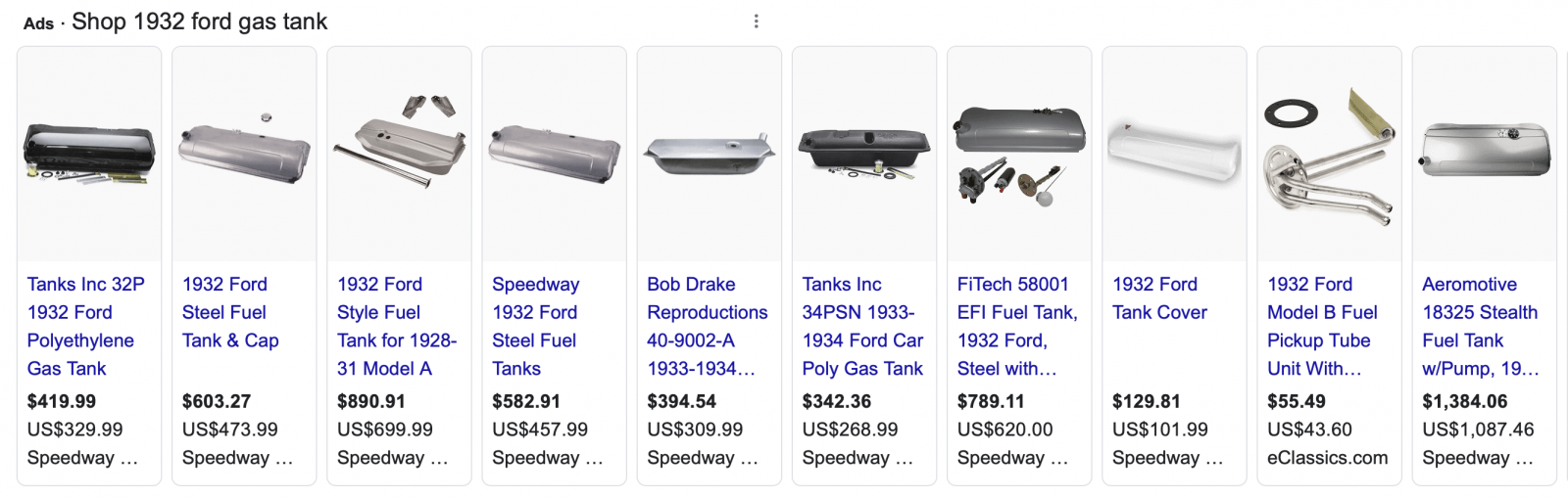

    Most tanks are made here in Canada.Spectra is the company.
    This recent tank was $300... so.... It's ok.(I Guess)...... But the last tank I got for the other car was $240 about 4 years back..... So I dunno.
    Saying that.. I always compare a 50's Tank to an early Ford Tank...... (1932)... yikes....

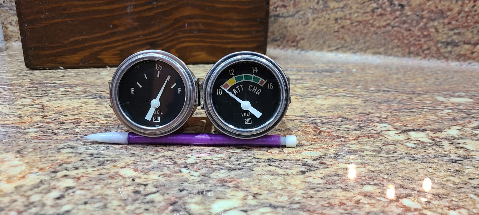

    You're making great progress, Jeff. Your dash looks incredible! The engine turned panels are going to send it over the edge!!
    Speaking of which, your Fuel and Volts are ready...
