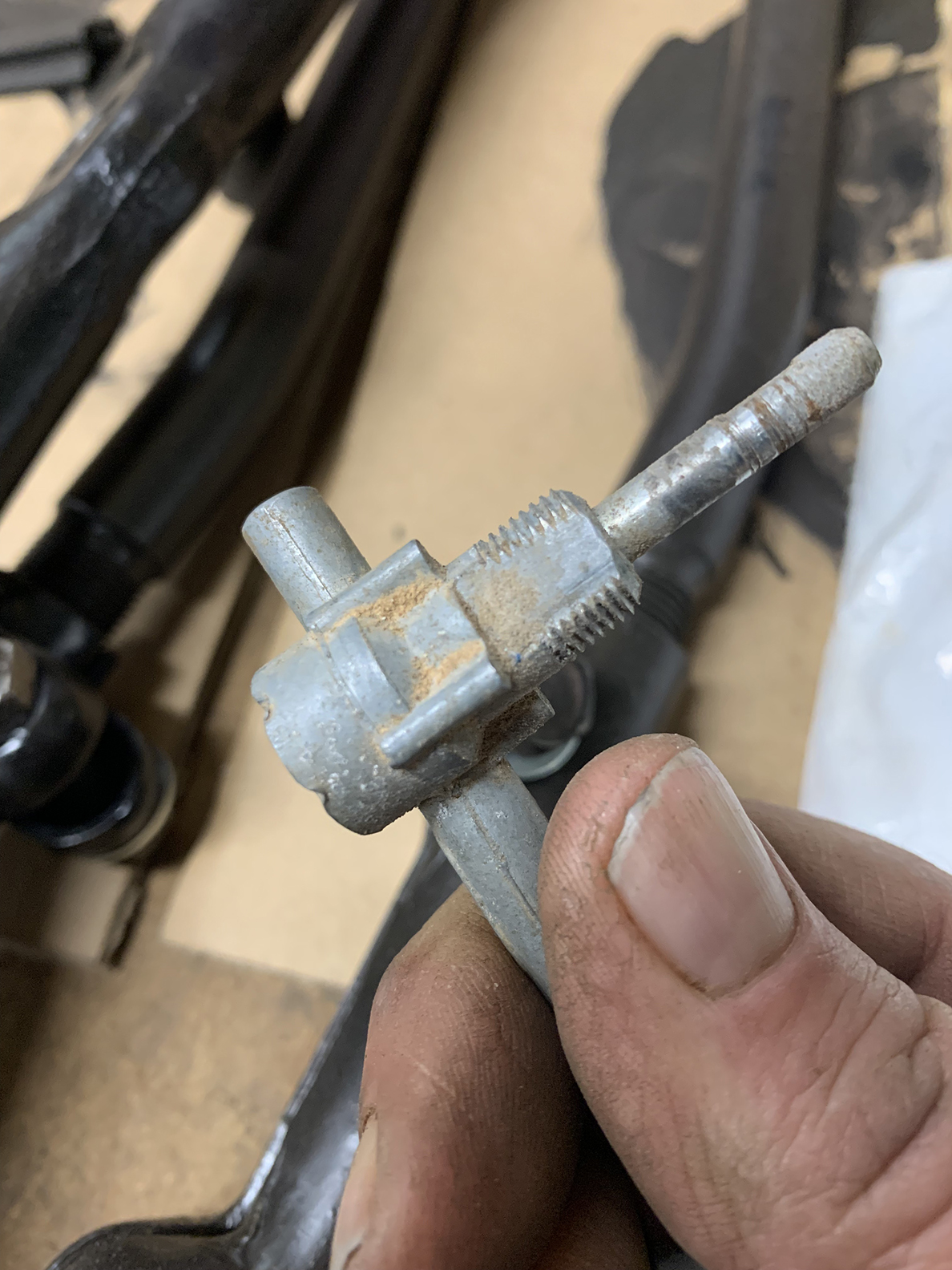

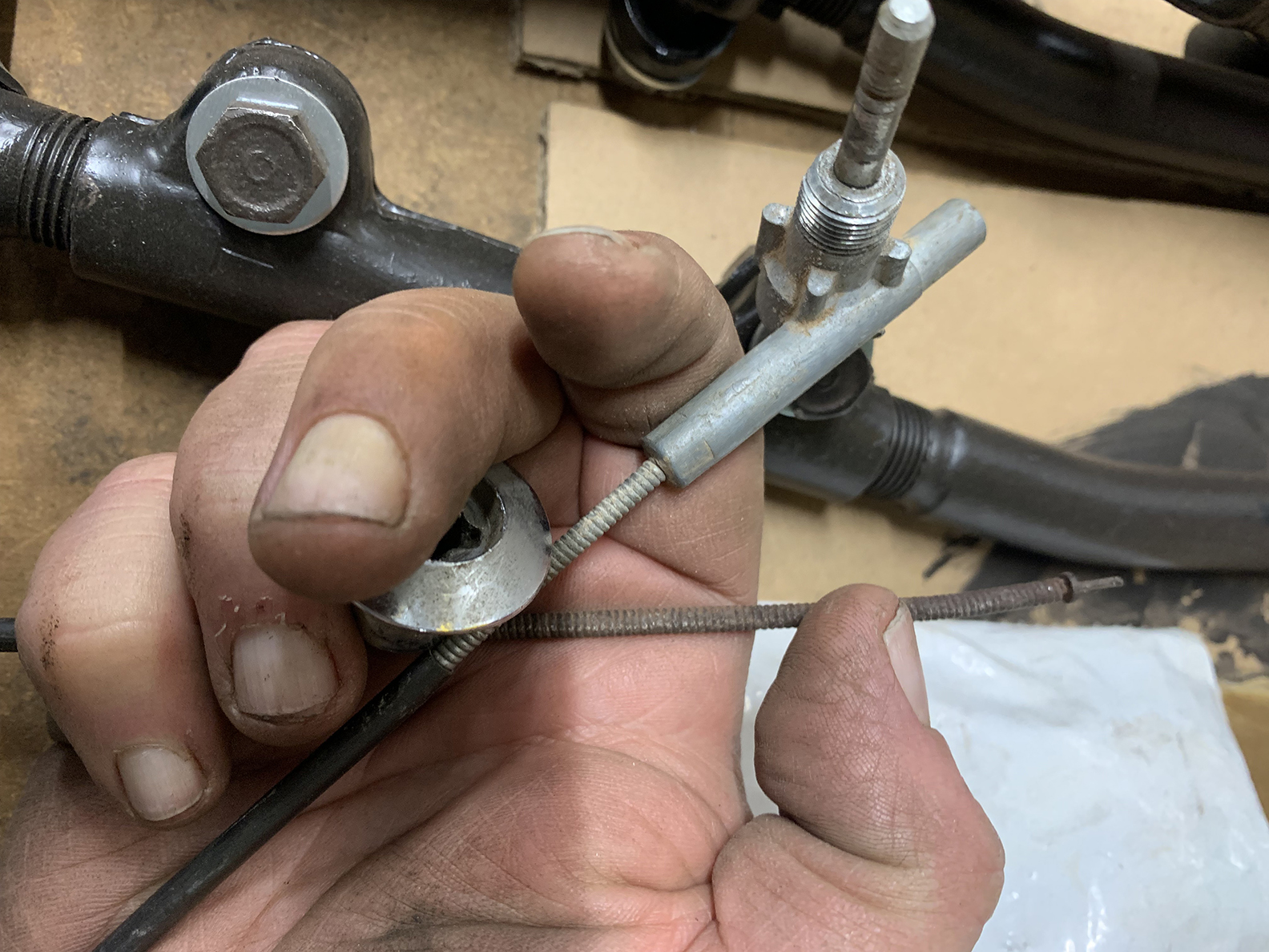

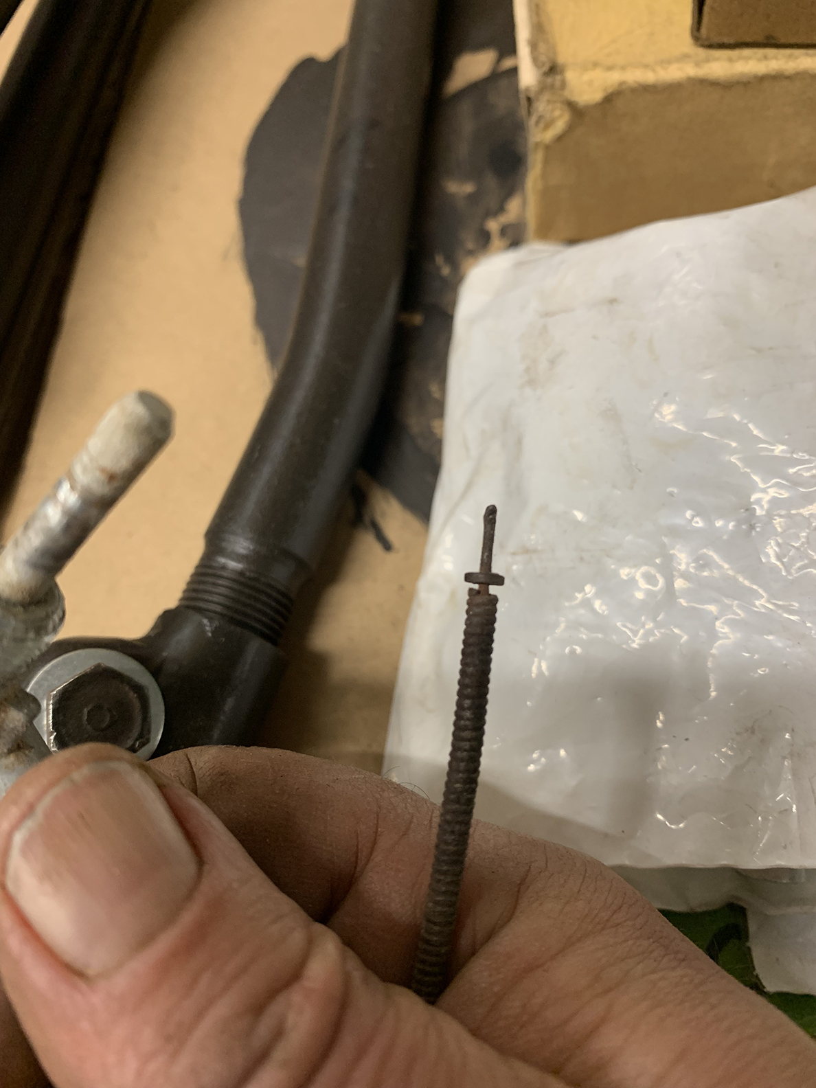

  3. that explains why i was unable to pull the wiper switch out, its a dial that turns, ive never seen anything like this,
  4. Jeff Norwell
    Joined: Aug 20, 2003
    Posts: 15,232
    Jeff Norwell
    MODERATOR
    Yes....... and on the underside of the knob.. is a very tiny set screw to hold the knob on the switch.. don't lose it!........ hahah!

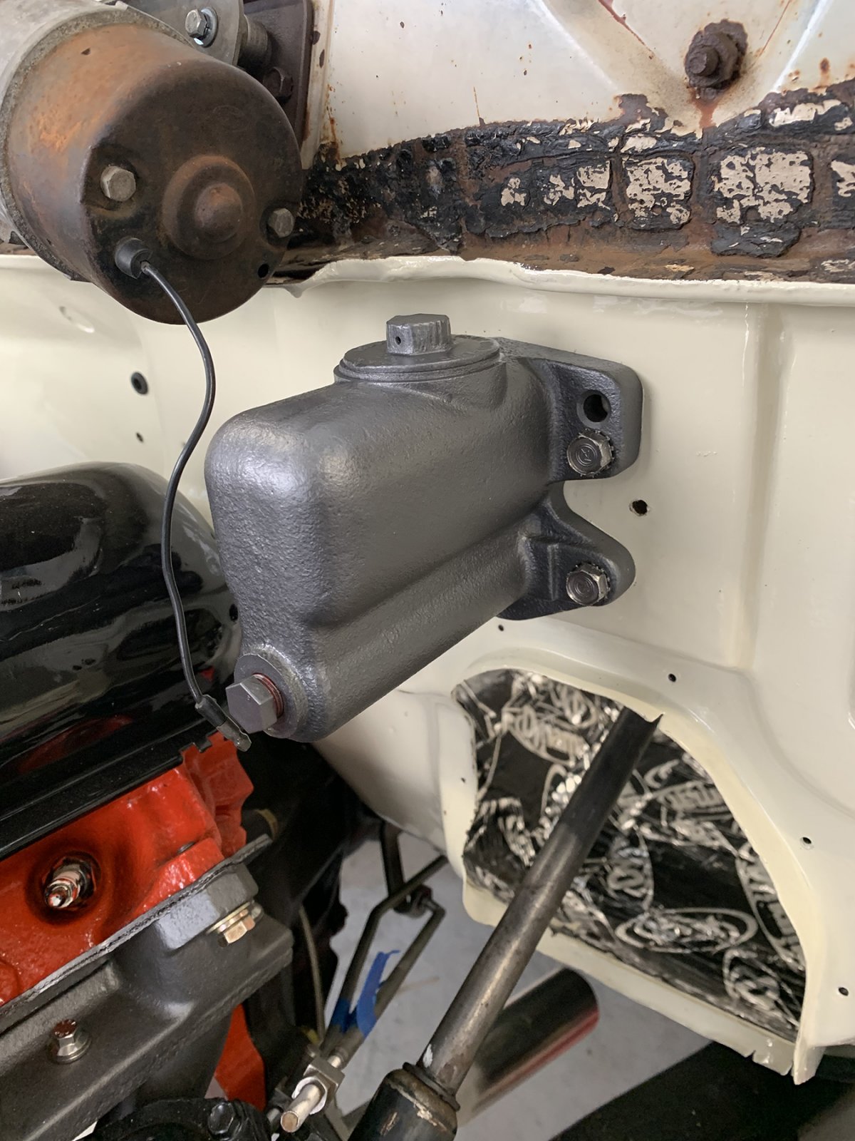

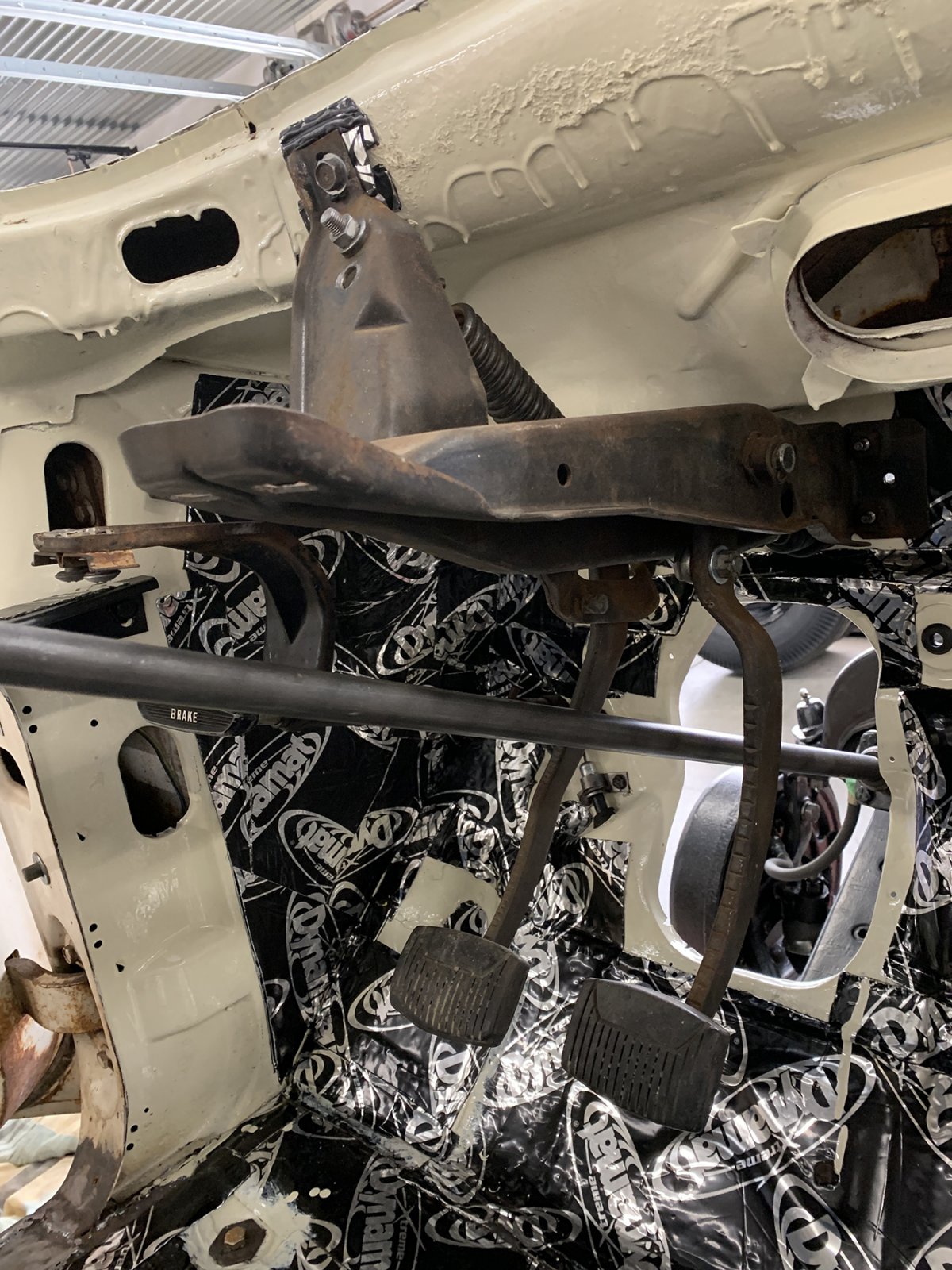

    Got the master in and the brake/clutch pedal assembly in..... Went easily.....

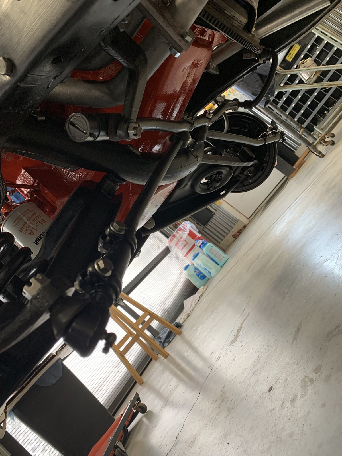

    63.jpg 64.jpg 65.jpg 66.jpg 67.jpg 68.jpg Swung underside and started to mock up the steering.
    With steering, can't stress to make sure your idler arm, links and cross shaft are in good working order and not damaged or bent.
    All theses parts are new NOS I collected from my pal Shay at pre60's,.... All good rubber, NOS, rods ends, shafts,steering linkage, everything..... I really didn't trust old parts sitting in a junkyard since 1971.
    Anyhow.. all is just loose and mocked up.
    So I had an "Oh S@#t" moment,.....
    Before I put any steering gear together, I was noodling with the Pitman arm and steering shaft,.. turning and finding centre. I got roughly 2.5 turns left and right finding the centre. as I turned the pitman to the right.... it was hitting the header collector.(At 2.2 turns to the right)
    Ugh.... then I realized that I did not have the steering together and the shafts turn to the right and left would be much shorter.... with the gear attached.
    .........Relief!
    As well I dug out some bump stops I have and if in an emergency, you can also use hood stops as well.....
    so if I need them I can just my turns left or right.
    I looked and looked and could not find if Ford had factor bump steers(for 57 or 58)... there is a place for them. and I have never paid attention or noticed on other cars....Anyone know this?
    But...I think we are good.

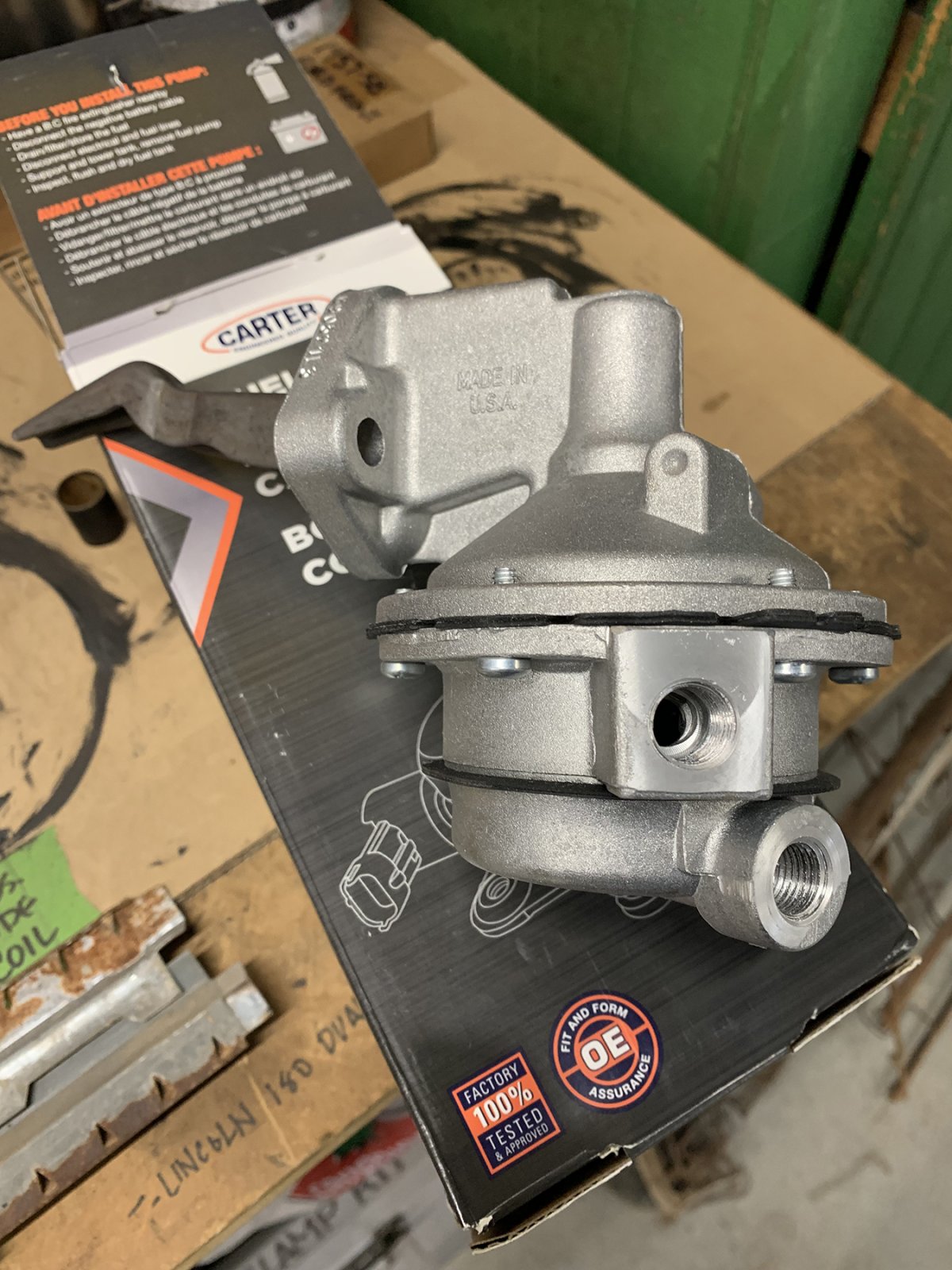

    Well..... also decided on a Carter 406-427-428 fuel Pump.. Picked up this Friday and I am gonna run back to the shop and install... 3/8's line....
    Carter has a golden reputation and it's all made in the USA.
    I am happy about that.

    I've had my Carter pump in my big block 57 for around 9 years now, it's been flawless and the car has also been deep 11's with it with no electric pump. My 1970 Boss Mustang also has the same pump, built for Ford by Carter and I finally rebuilt it a few years back after 50 years of service.

  11. Maybe not useless trivia: In the Ford Performance catalog form the 60's an upgrade was going from 5/16" to 3/8" on fuel lines. On of my class mates had a 67 fairlane with a 390 2 barrel engine. He swapped to a 4 barrel and went through the Ford steps. I remember him saying the fuel line was worth 500 more rpm. Also, the clutch and brake pads from 57 are the same they used for almost forever. I know that the late 80's f150's use the same pads so if you're going to the parts store for pads, that might help you. :)

  13. Jeff, how do you plan to deal with the 5/16" line fitting in the Tank?
    loudbang, Deuces and Jeff Norwell like this.
  14. bobss396
    Joined: Aug 27, 2008
    Posts: 18,687
    bobss396
    I have a 5/16 line in my car, this is why I run out of power sooner than I'd like. The tank is plumbed for the same, I should have thought about this before I put the tank in.

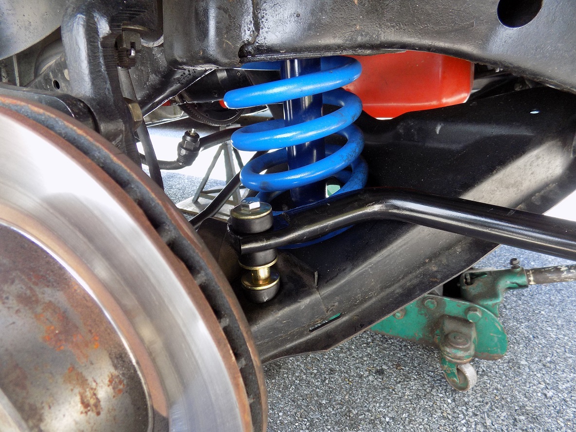

    Good Progress this weekend.....
    .......tied up all suspension, put the car on its own weight, tightened the suspension to factory specs,Waiting on my front sway bar to arrive,Looking for my grease gun, to grease all points needed, and such.
    Lots of little things to do, but the next big step will be to wire the car.
    Of course running brake lines and fuel lines as well.
    As for the rear tank and the 3/8's line..... for my car.... I have adapted the fuel barb out of the tank to accommodate a 3/8's line.
    That's about the extent of it..... this is a street car and a 3/8's line from the barb to the carb will be more than sufficient.On other applications I can see the use to mess with the tank and such.... but not this 57.
    yes.. when the tank was ordered from Spectra.... there were no options on a 3/8's bung....

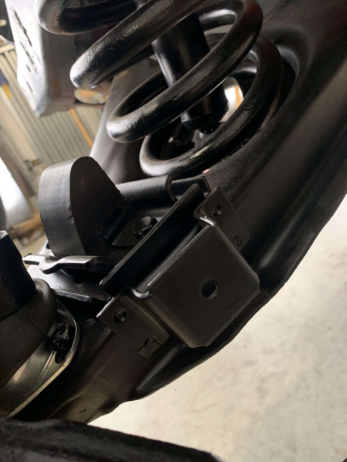

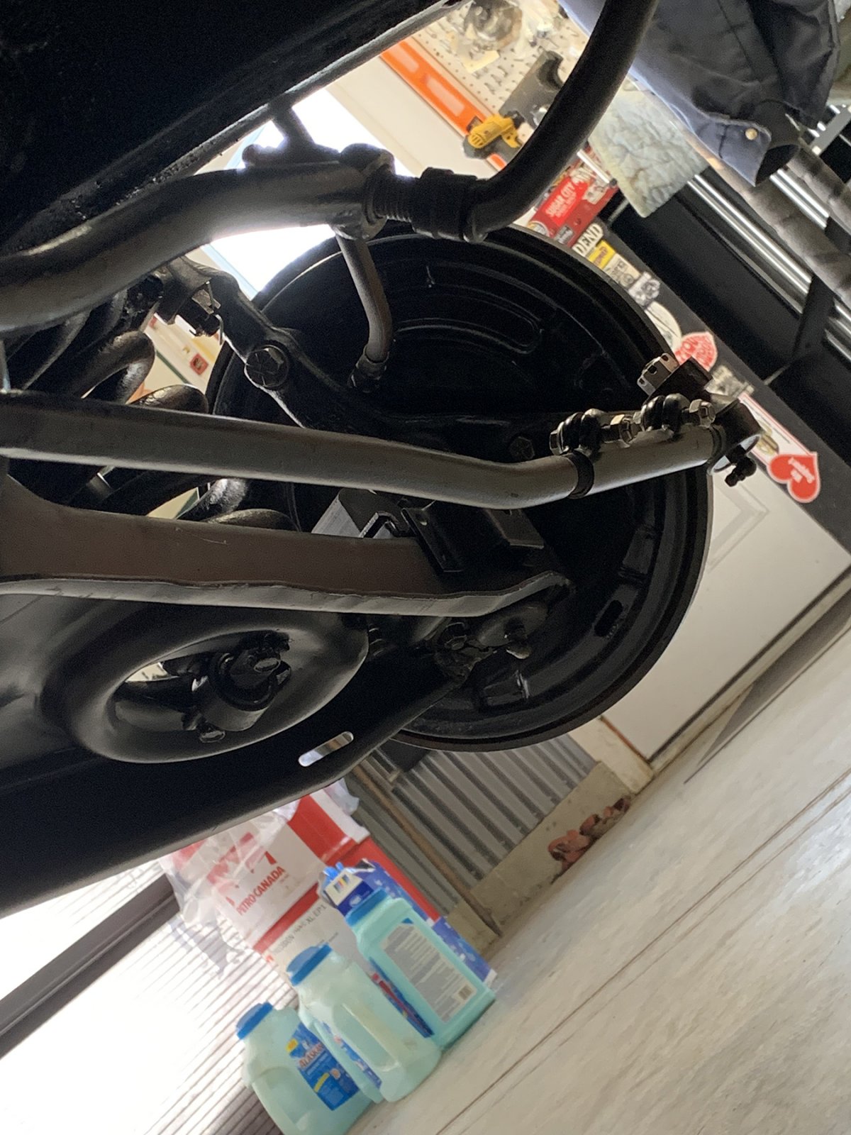

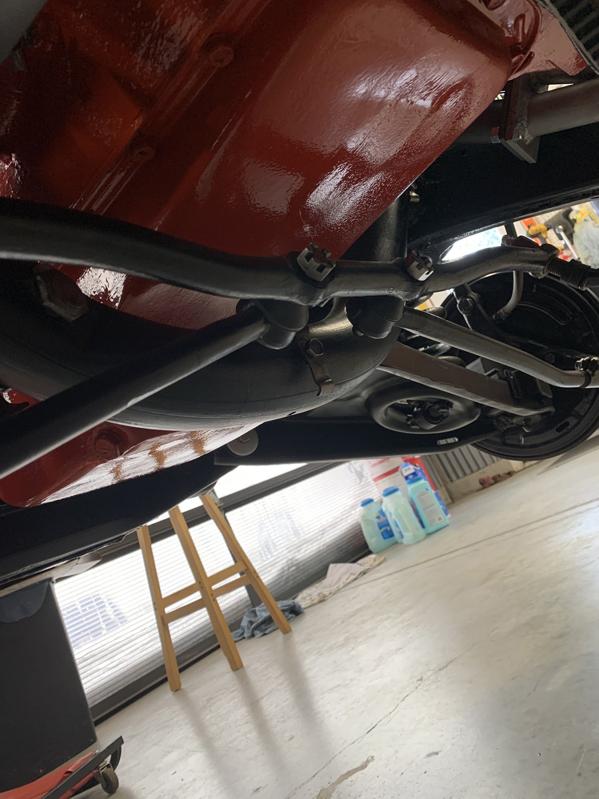

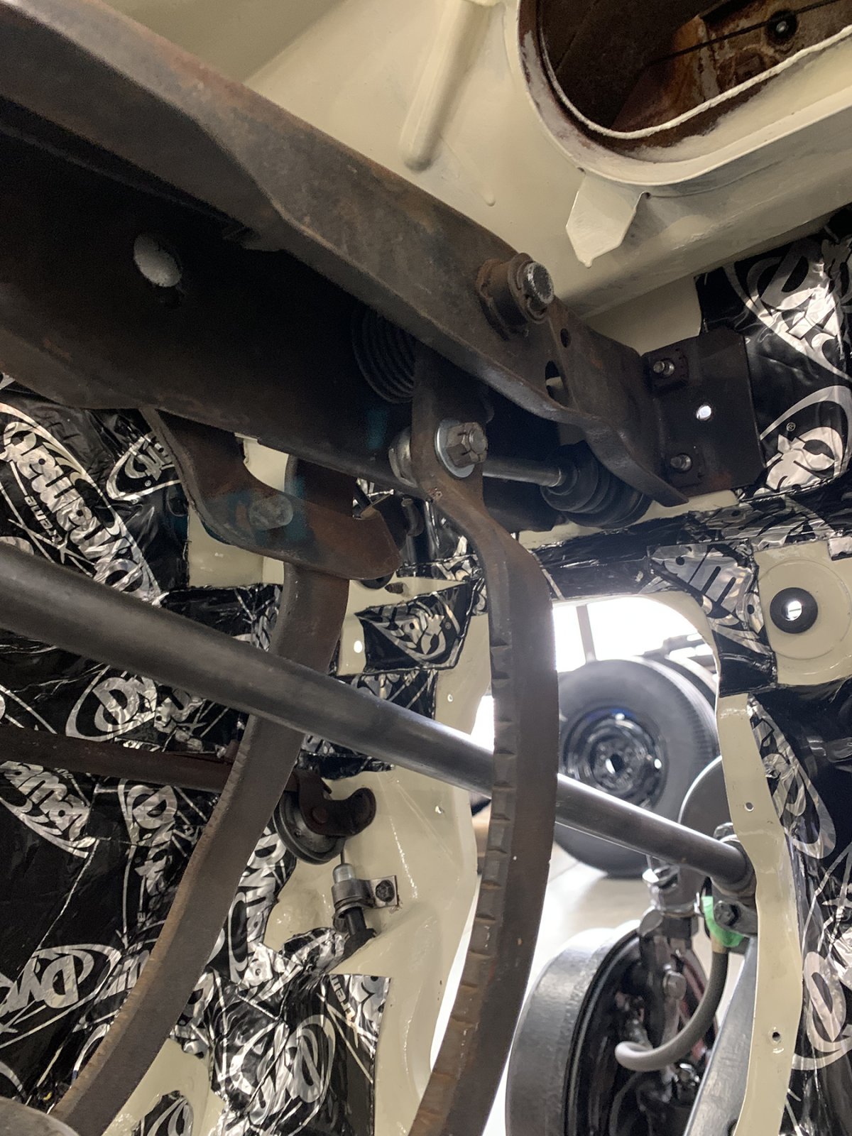

    Which sway bar are you using? I went with a fat 1.125" on mine.

    @bobss396 ... where did you get your sway bar from?... looks exactly like the one I ordered ....

    Bob........the sway bar you posted pics of is different than the SWTbirds/Concorse sway bars made for the '57's unless they've changed) What brand is yours? maybe that's the difference. The SWT '57 bars are not bent upwards like yours. They are much straighter and the front of it actually goes below the double bracket the core support bolt mounts to. However, with that said, I don't understand how YOUR setup works with the bumper brackets. The way you have it mounted would have moved the brackets outboard by the thickness of the sway bar bracket because you sandwiched that bracket between the frame and bumper brackets. The '57 sway bar mounting brackets are located to the outside of the bumper brackets, so it does not affect the bumper bracket's position in relation to the bumper's holes.
