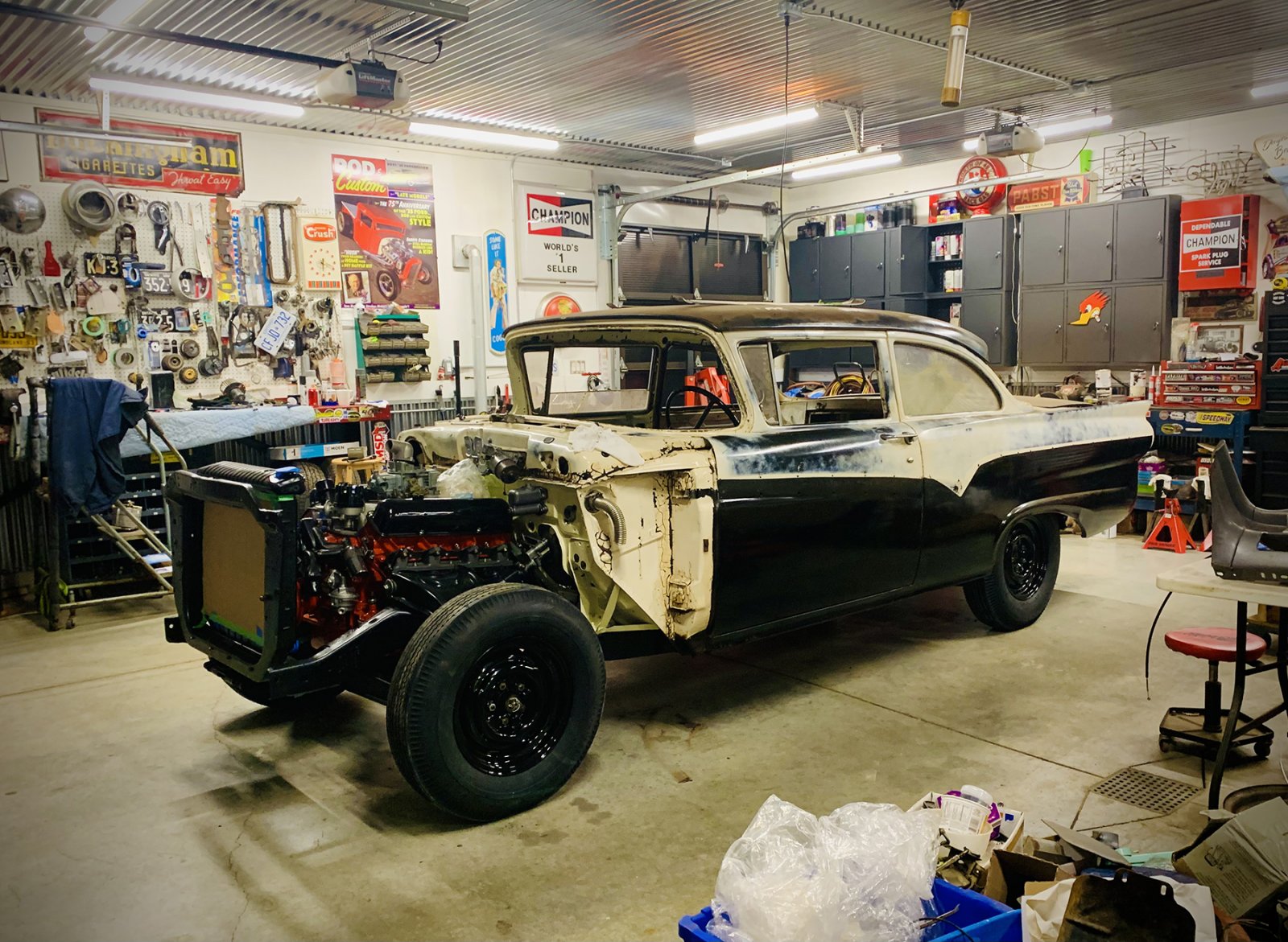

  12. Jeff, these cars were famous for floating down the highway at 70mph. Did you change spring and shock rates to alleviate that or was that your desired result?
    Texas57, loudbang and Jeff Norwell like this.

    I "Believe" .. my front springs are from a Sedan Delivery.... been such a long time .... The front shocks are a HD factory unit I ordered a long ways back as well..... I can't remember.
    And with a fresh HD front sway bar coming....I should be in good order..... I have to check... but I think the sway Bar is like @bobss396 on his 59 in thickness..1' or 1-1/8?....
    I believe this will solve the floating problem.

  20. how do these cars drive without an anti roll bar?
    Jeff Norwell likes this.
  21. RmK57
    Joined: Dec 31, 2008
    Posts: 3,082
    RmK57
    They "roll" more in the corners. My 57 has the anti-sway bar removed and I also have 90-10 drag shocks. I drive mine the speed limit on the highway, secondary roads and it's fine. Having said that I'm not into twisty canyon, road carving driving so I'll never know the cars limits I suppose.
  22. Texas57
    Joined: Oct 21, 2012
    Posts: 3,738
    Texas57
    They had one, just inadequate. The originals were 5/8, and the ones being discussed are 1 1/8". To be mentioned about handling also are the 6 leaf springs he added to the back in place of the orig. 4 leaf. I still don't like real windy days, but other than that, those same changes to mine makes my car pretty damn stable at 80-85 on a lonsome highway, and it loves the twisty mountain roads!!

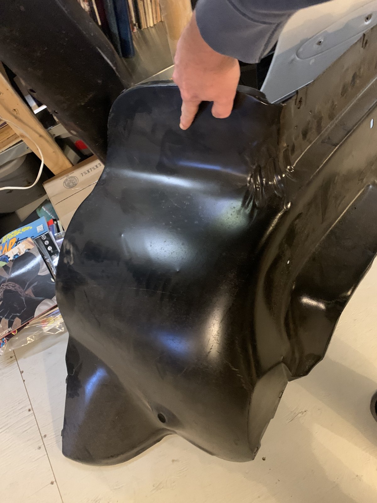

    Another little update, and a big thanks to @PoTaToTrUcK for his help gathering these much needed parts... the headlight Buckets which are absolutely perfect and some small instrument parts.
    The trick now is to put them away in a "Safe" place and not to forget where they are.
