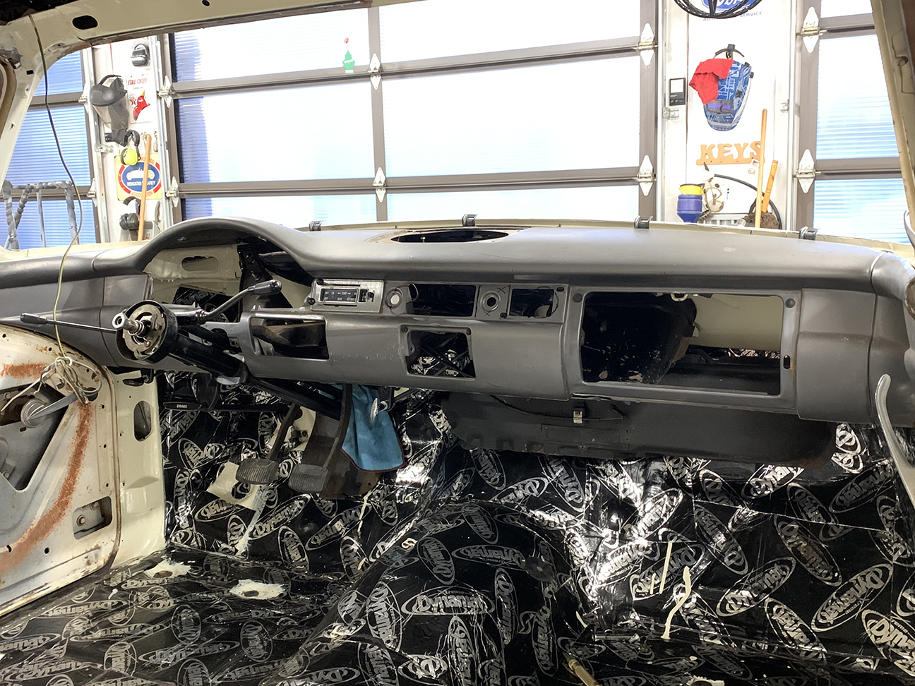

    Well,.... no big updates.. but small all around the project type things....

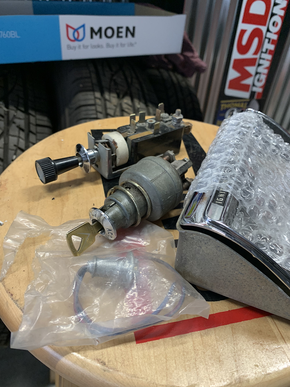

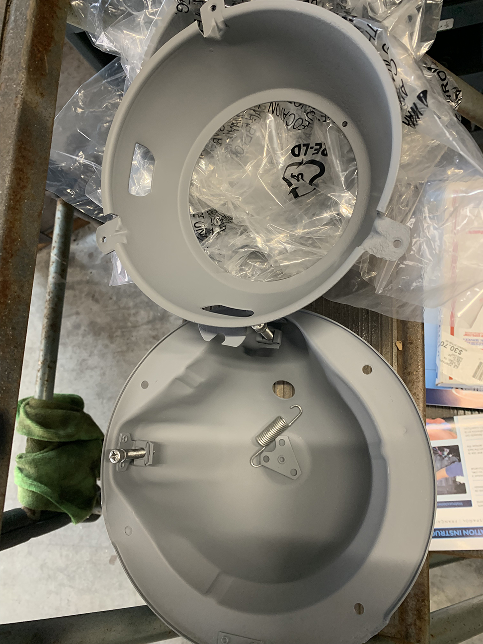

    I received the parts I needed, Headlight switch,Bezel and Knob with an OG ignition.Fantastic shape.
    My headlight buckets came as well and I was floored how good of shape they were in.The man in B.C. primed and packed flawlessly.All the small spring hardware was included.
    Very Happy on that.

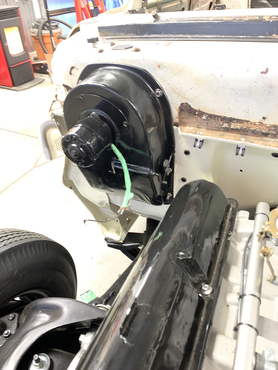

    I started to ***emble the heater/Defroster for the car,.... cleaned and painted, then fit the the heater core, vacuum controls and outer heater box.While doing so I ***embled the Vents(Pia) then put in the dash.

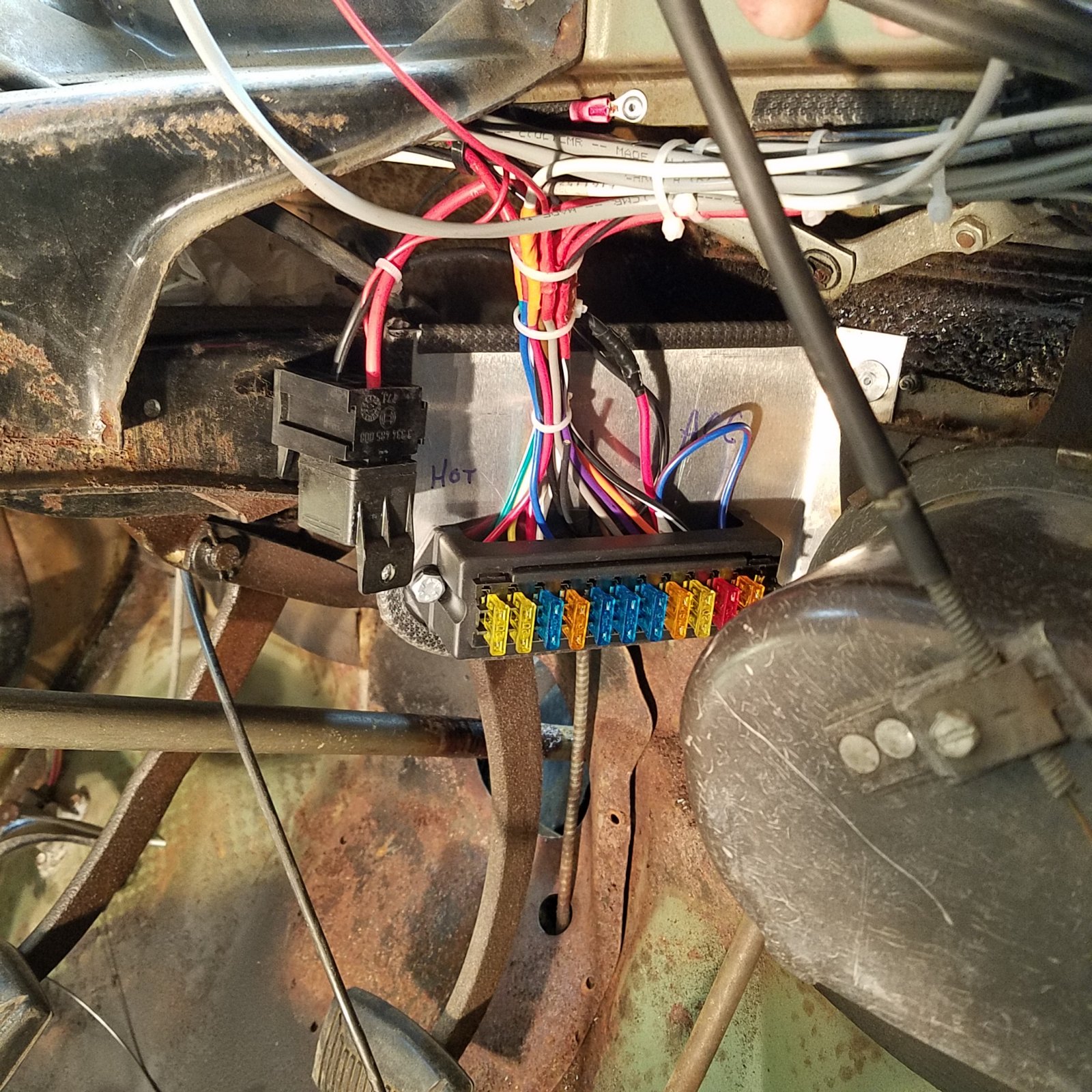

    All went well but I learned from the last car to have this stuff in place before wiring.Just easier(for me anyhow)
    With a bare firewall,.. one would say"man... loads of room"
    not really.... last car had the fuse panel on the left cowl side.. this one will have it on the p***enger side(right side).The left has just too many obstacles for me.. parking Brake, hood release, pedal ***embly and steering..... so, yea.... fuse panel- p***enger side.

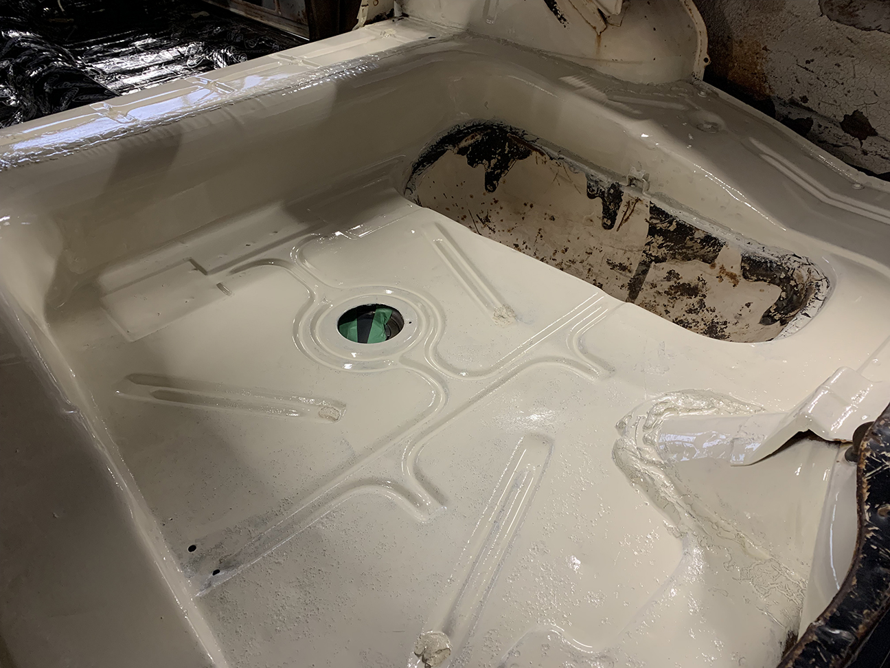

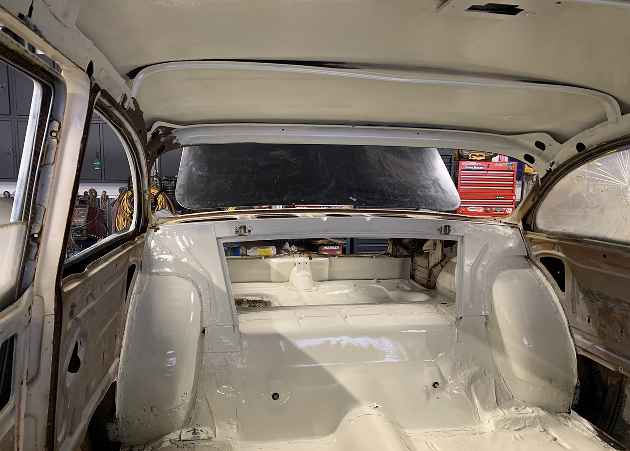

    Tackled a little painting on the trunk area, rear floor.. with again a myriad of rust paint, and Por-15.
    Just started and a rough first coat is on.... but I will allow it to dry for a few days before a second application.
    I need undo a weld on the cross-roof bow and bend it back into shape,.... a 10 minute job... but next on the list.... and I can also apply paint under there as well.
    Gonna run a Wildwood small master for the clutch.... just need to order.... but a small 7/8's should fit nicely beside the factory master.... "It should"......
    Famous last words.
    Later guys.

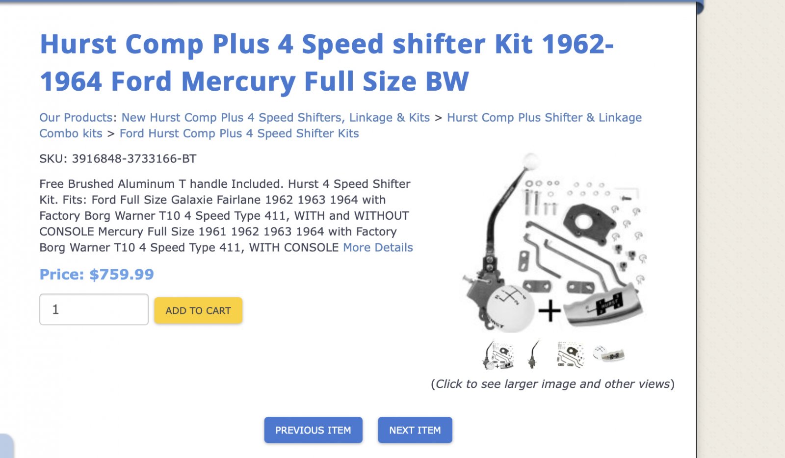

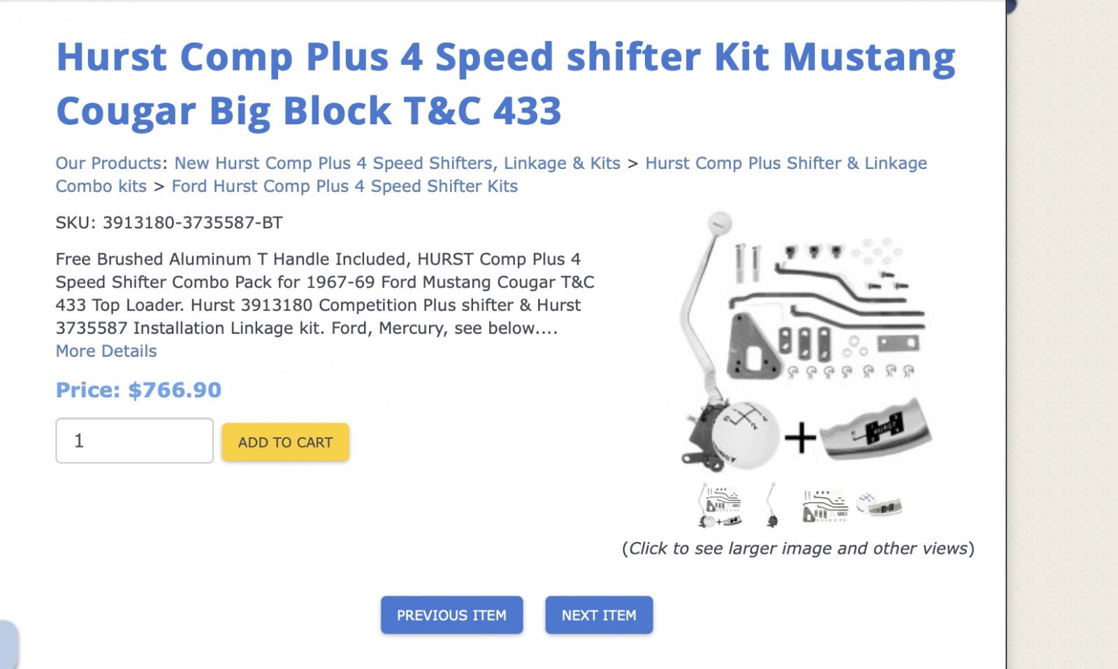

    Next was to find the shifter,... the perfect Hurst shifter and all is a 64 Galaxie unit.
    Since I have been down this road before.. believe or not.... the cost of a Hurst for my application is super costly..... $750 USD.... and then add shipping, duty, tax and exchange(20-25%).... I am into the $1200-$1500 range.Combine this with a shifter handle that needs to be altered because of the bench.....
    I went down this road with my other Black 57. I did not want to buy a used unit from Craigs List or elsewhere.... Not much cheaper and some old unit that was beaten and tortured to death.
    I was prepared to swallow all this...... and buy a new unit.
    COST

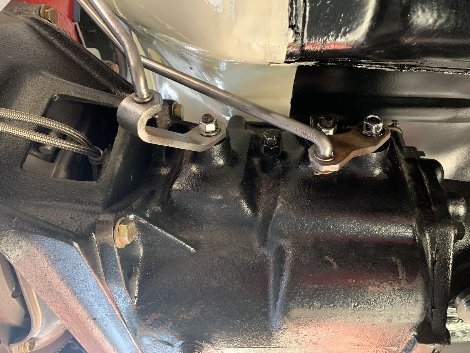

    So, I speak with my pal Jay from M***.... and he asks what were my plans with the shifter and trans?
    I tell him that I plan on buying a Hurst unit....
    He asked me.."Why not a 4-speed on the column?"
    I was intrigued ..... So he begins to tell me about his 406 with a 4 speed on the column... and how easy it was...
    Basically... the shifter rods, shifter tabs swap directly over to a 4 speed Toploader .
    At first I didn't believe him.... this was impossible.
    So... Enters Lane from out west.... @57 Fargo
    Lane and I start to converse and he has this 58 Meteor with all the parts I could use and need.... anyhow.. we strike a deal(which is still ongoing)
    Lane wants a Hemi.. he is a mad Mopar nut..... so he will be getting a 54 331 for his P/U and I will get a boatload of 58 Meteor parts I need for now and the future.
    Problem is Lane lives in North Alberta.... about 1500-2000 miles from where I am.... but... I have a trucker friend that has agreed to transport because he does North America moving..... so a deal was struck and hopefully Lane will have his Hemi by June.
    This board moves in mysterious ways...

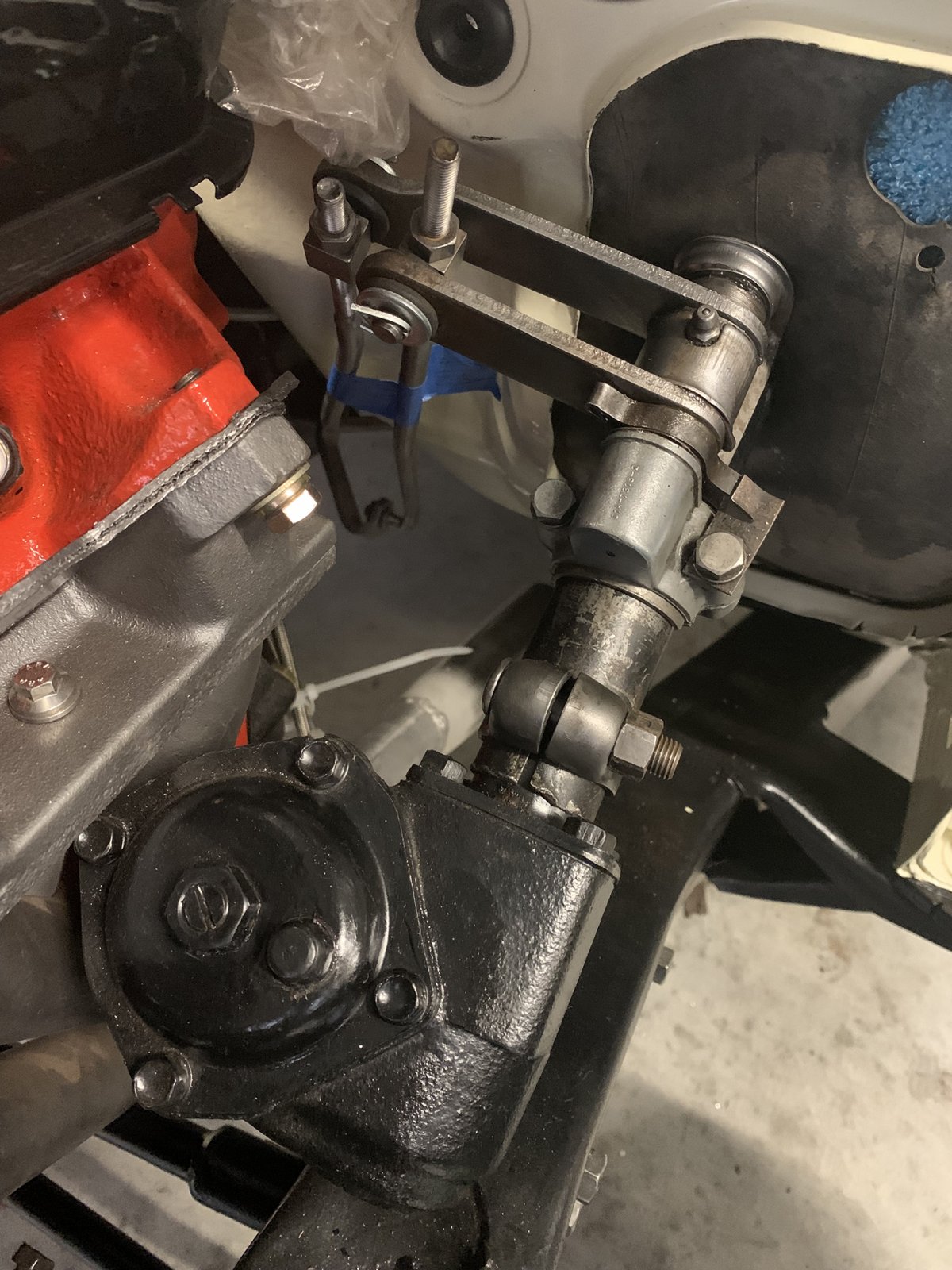

    Lane sends me the shift rods and shifter tabs.... I stare at them..
    "this aint ever gonna work"
    I have several columns.. and pull a cherry 57 manual column in very good shape.. give it a clean and grease.... start bolting and lo and behold.. the darn thing worked!...
    The rods line up... the shifter shifts into every gear..... I never even had to adjust the rods.... so....
    1-2-3-4 ..H pattern.
    I then called Mr. Mac Vanpelt.. at VanPelt and I spoke with him and got a OD cable and reverse parts for using reverse(small kit) using the cable.
    Great guy.. and really knows his 3 speed and early transmission stuff..... so....
    I was going to use a old vintage Morse throttle to pull reverse..but... ehh.... it just was too big and out of place.The OD cable out of a shoebox is a perfect fit.
    The only fly in the ointment is I have a small amount of relief to be made on the 1-2 shifter tab.. as it knocks into reverse.... no big issue... doing that now.
    so... Ford Never made a 4-speed until 63.... so in my mind.... it works on this build.I had a 55 Ford with a 3 speed OD and column shift.I loved it.
