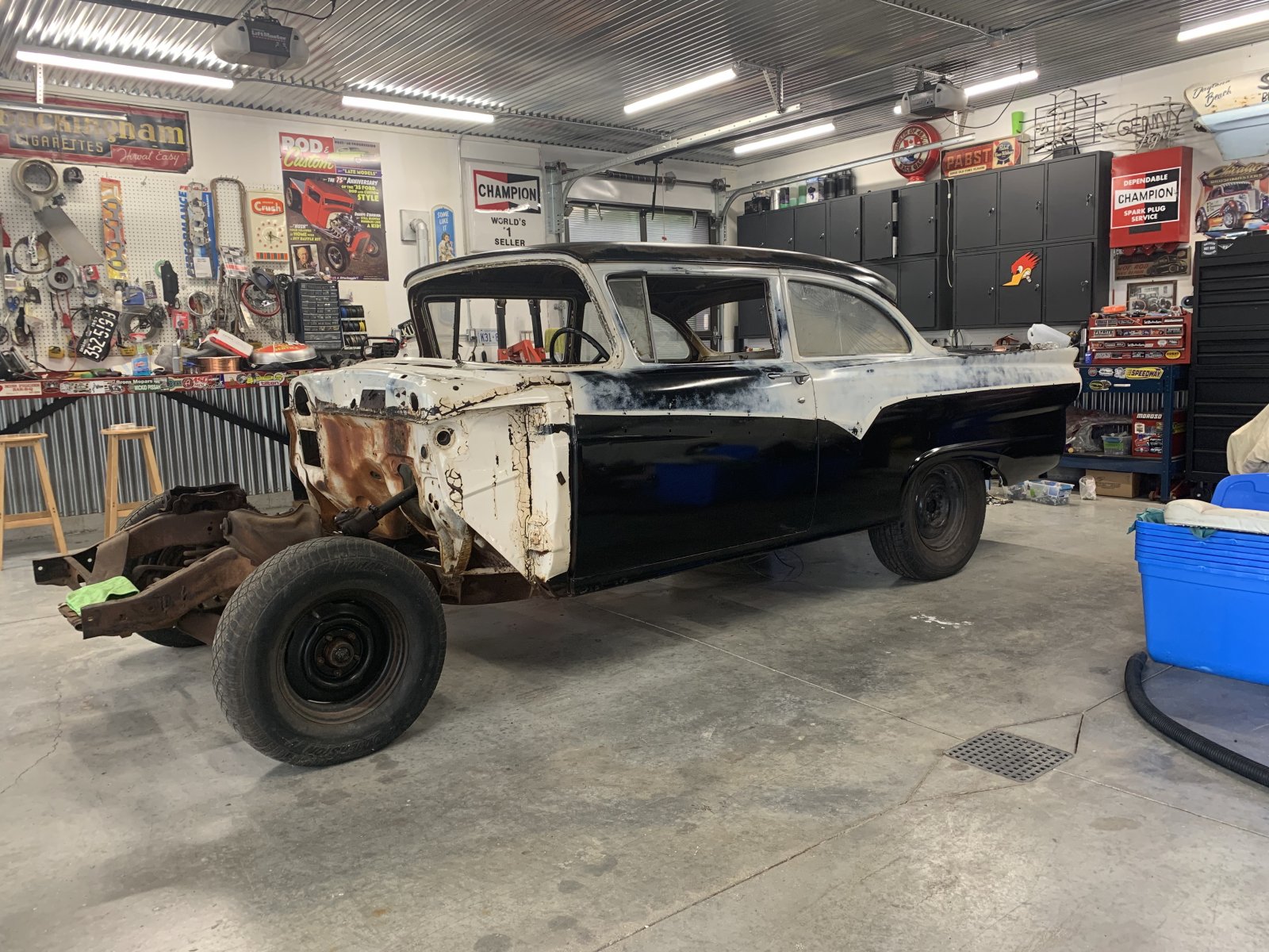

    Way cool, always enjoy seeing pics of your shop as well!

  20. I had to stare at your photos for long time trying to figure out what I was looking at. Finally got it... floor space and room to move... I haven't seen that in so long I forgot what it looked like.

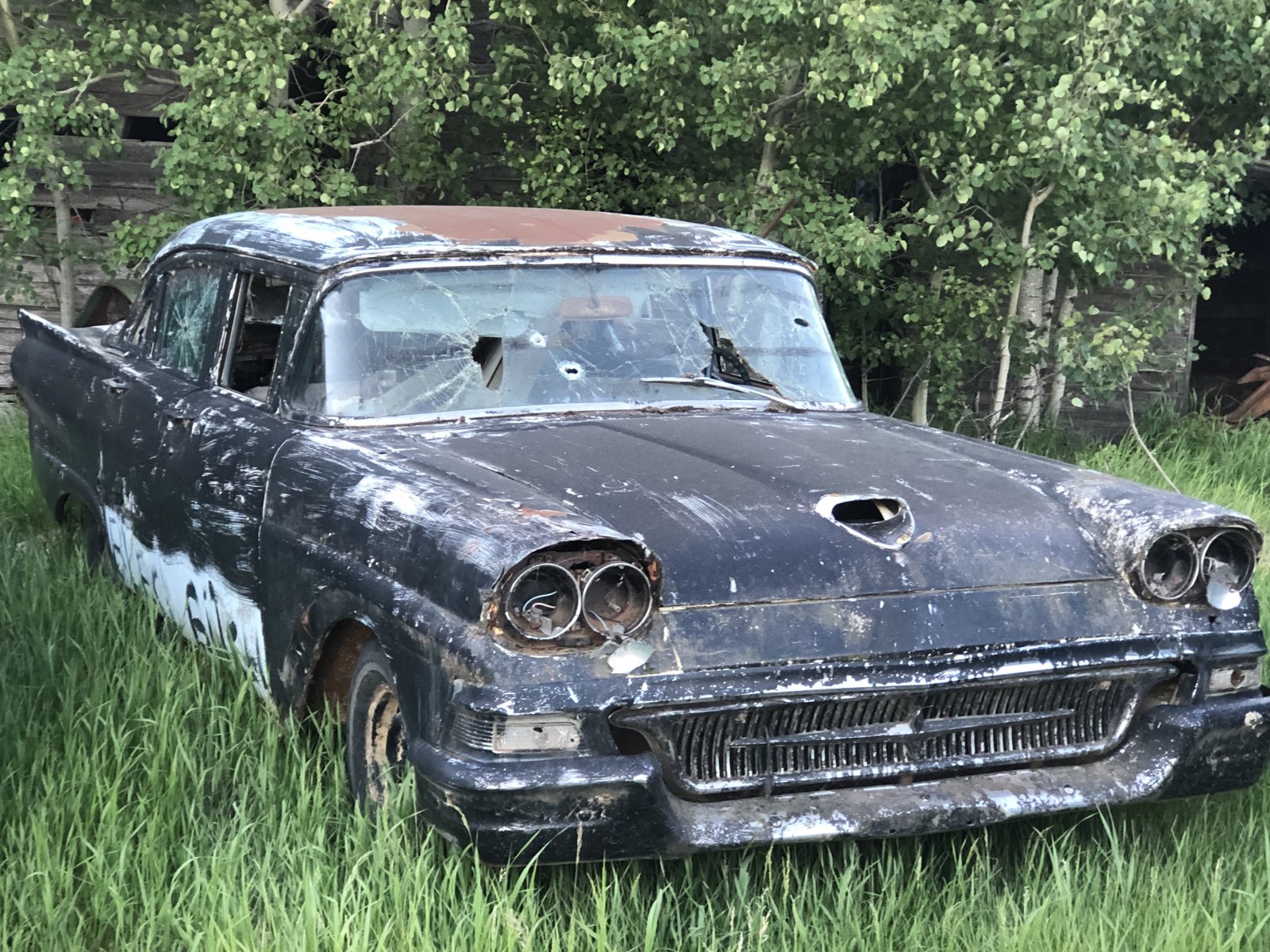

    Whoa... your fix up Mopar stuff and you seem to be offering up parts of a Meteor?! I think you’ve worked hard enough on your truck to deserve a reward so restore that great Canadian Meteor! LOL
  28. 57 Fargo
    Joined: Jan 22, 2012
    Posts: 6,232
    57 Fargo
    This one is past restoring, it was destined to be crushed so I hauled it and a few more home this summer, I sent a bunch of stuff to a Hamber in Texas earlier in the summer. It does still have the yblock and the 9" in it though.

    Here’s the car, and it looks better in the pictures….
    It’s extremely rotten…
