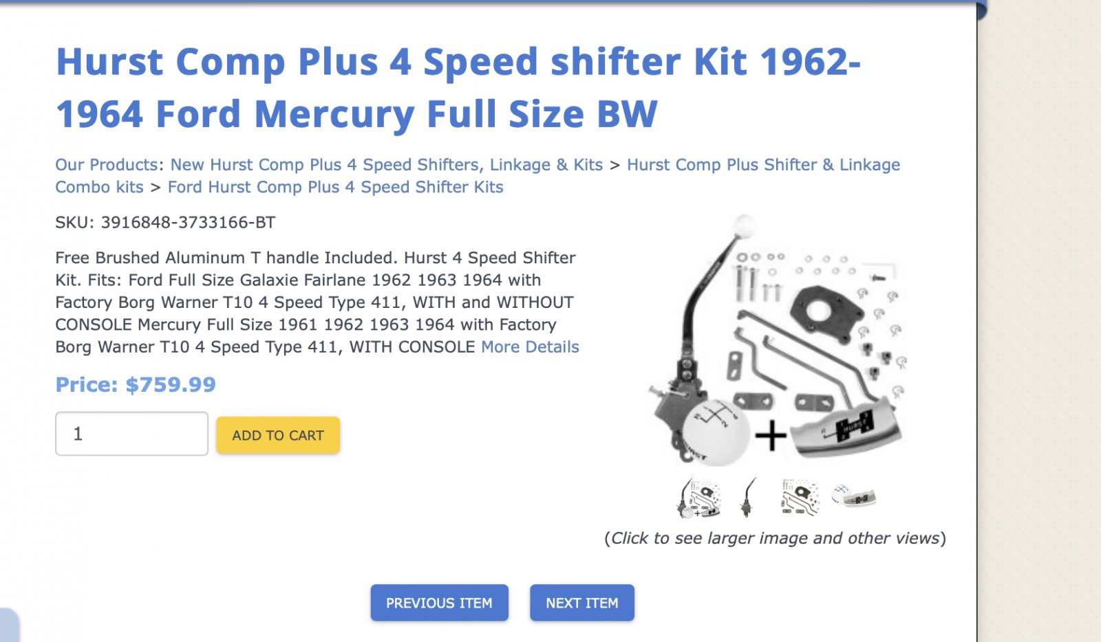

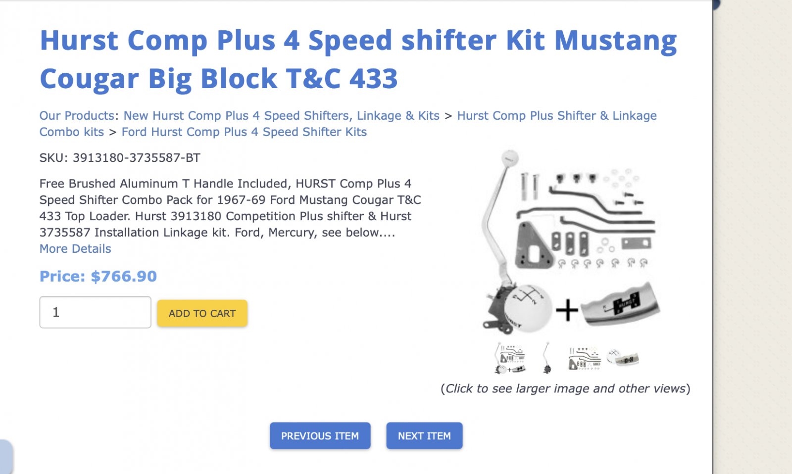

  4. Hurst pretty much abandoned the early Ford 4-speed market a few years ago. You can still get the shifter, but no install kits. There is still some NOS stuff floating around

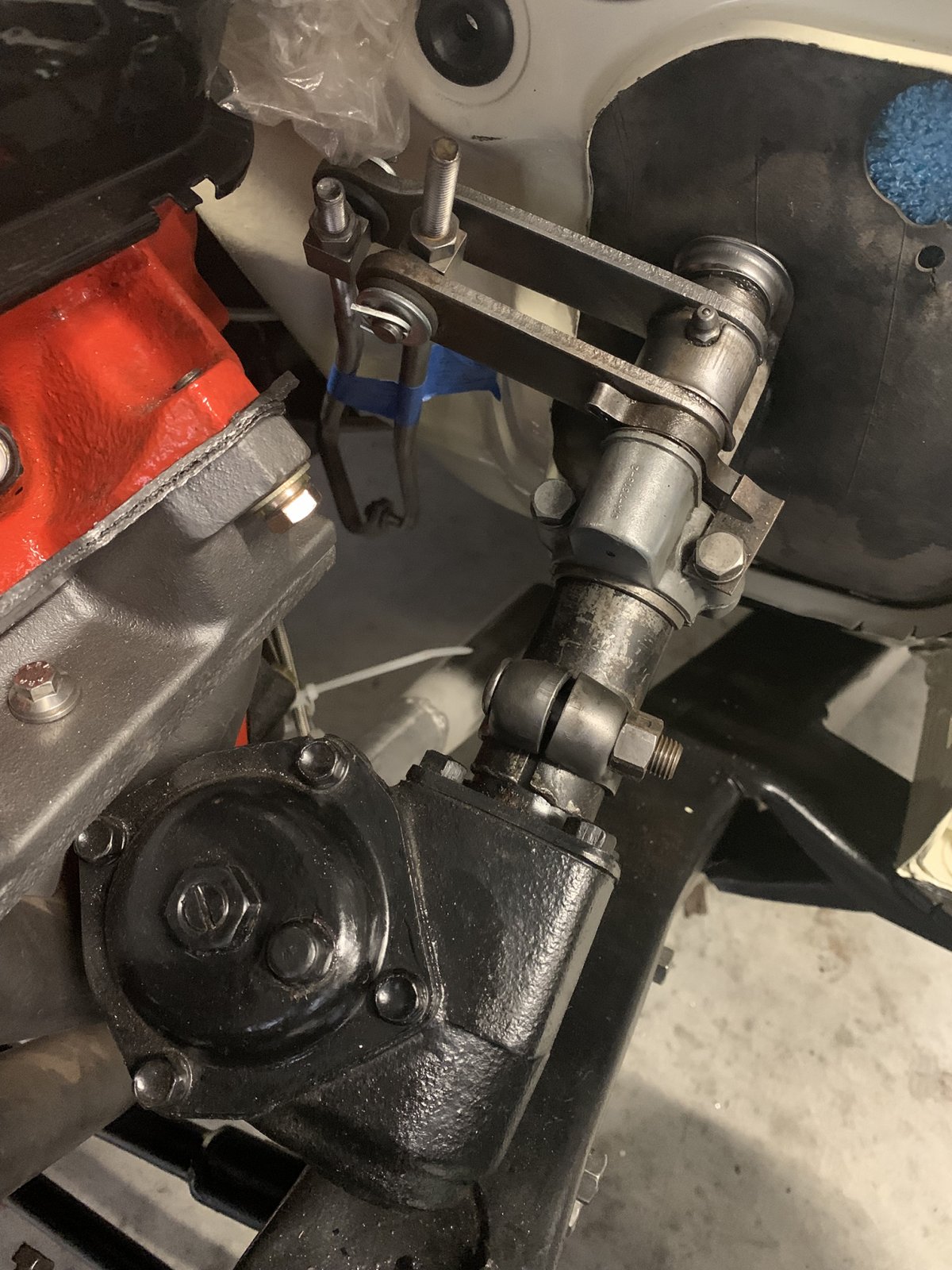

    I built my 59 to be a 4 speed colum shift last winter. I used the iron case 3+OD T170F out of a 1979 Granada/Mustang. The 4 speed toploader is the same externally other than the 3/4 shift lever is reversed. I had to weld mine and it is in perfect alignment for the origional 3 speed colum shift.
    I will totally agree that the colum shift arms and linkage are quite stout surprisingly. No stamped steel, all machined parts very solidly made. I had only worked on 70s colum shifts prior to this 59 and they were complete junk. I know I'm showing my age here....
    Jeff, I'm very intrigued by your reverse strategy, I have yet to permanently figure mine out. For the last summer I've been using a universal cable for a hydraulic valve tucked away under the seat. I'd like to have something period or at least something more stout. I was going to use a PTO cable but I never found one I was happy with. What I have now isn't rugged enough for long term use, I have it pulling the lever into reverse, and springs aid in pulling it back into Neutral. I'd rather a stout push/pull cable with a rack and pinion type of lever in the cab.

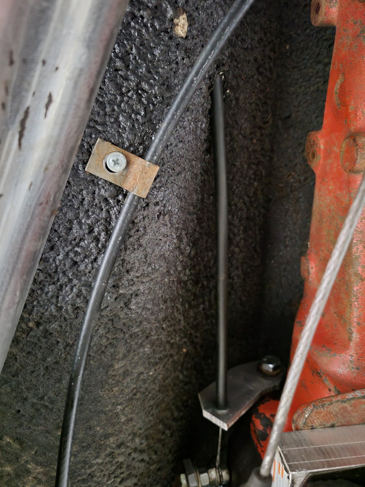

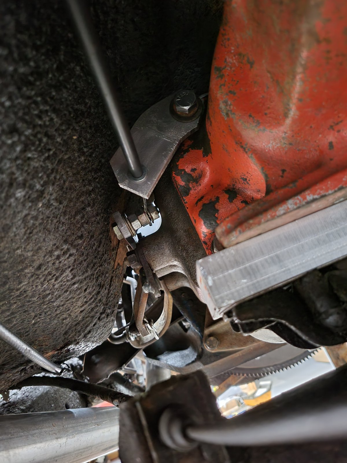

    This shows the cable going through the tunnel ending up under the bench seat. This is just a temporary measure so I could drive it last summer.
    This is the best shot I could get of the trans end of the linkage. It's not as pretty under there. I didn't paint the case as I didn't think anyone would see it! The springs are the temporary 20220301_220643.jpg
    The "shifter" for Reverse. It just floats under the seat until i find a better solution. 20220301_220411.jpg

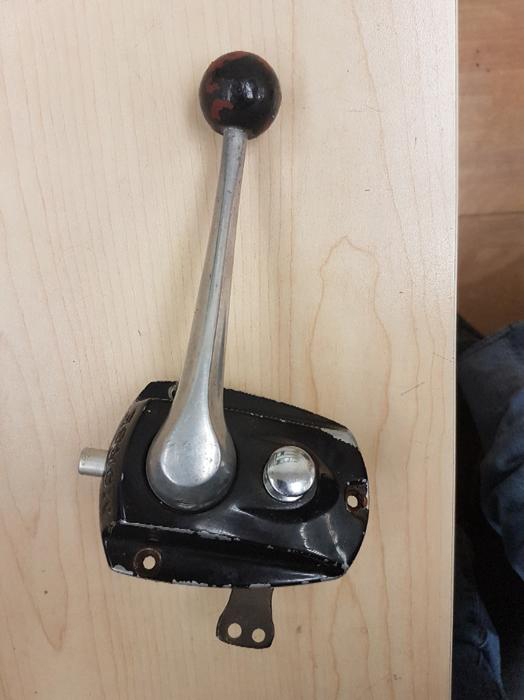

  7. Some small locking shifters and and throttle control in the boat world . Check out your local marina or boat repair /wrecker .

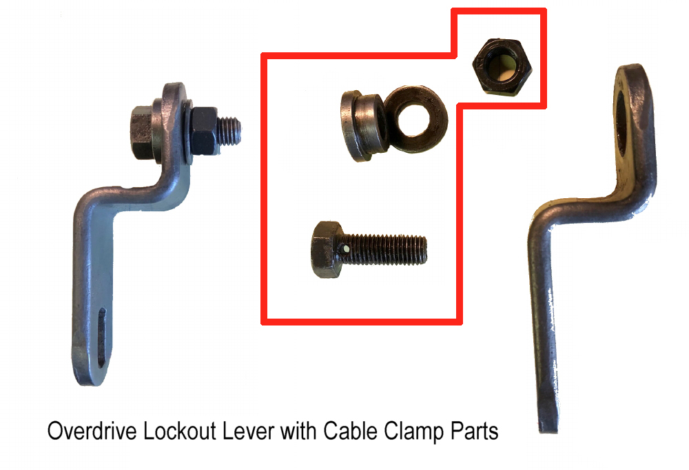

    Love what you're doing.My system will be very close to what you're doing.I indicated I was going to use a Morse throttle from a vintage boat... it was neat... but little out of place (for me) I too looked at a PTO lever... but could never find the one I liked.
    The shoebox OD cable I have used is very big.. much like a parking brake cable in size.... at first I thought of a choke cable.... but... it would not have the strength I needed....
    I plan on making some strong cable brackets in 2 points to keep the cable straight and avoid any tight bends that may bind.

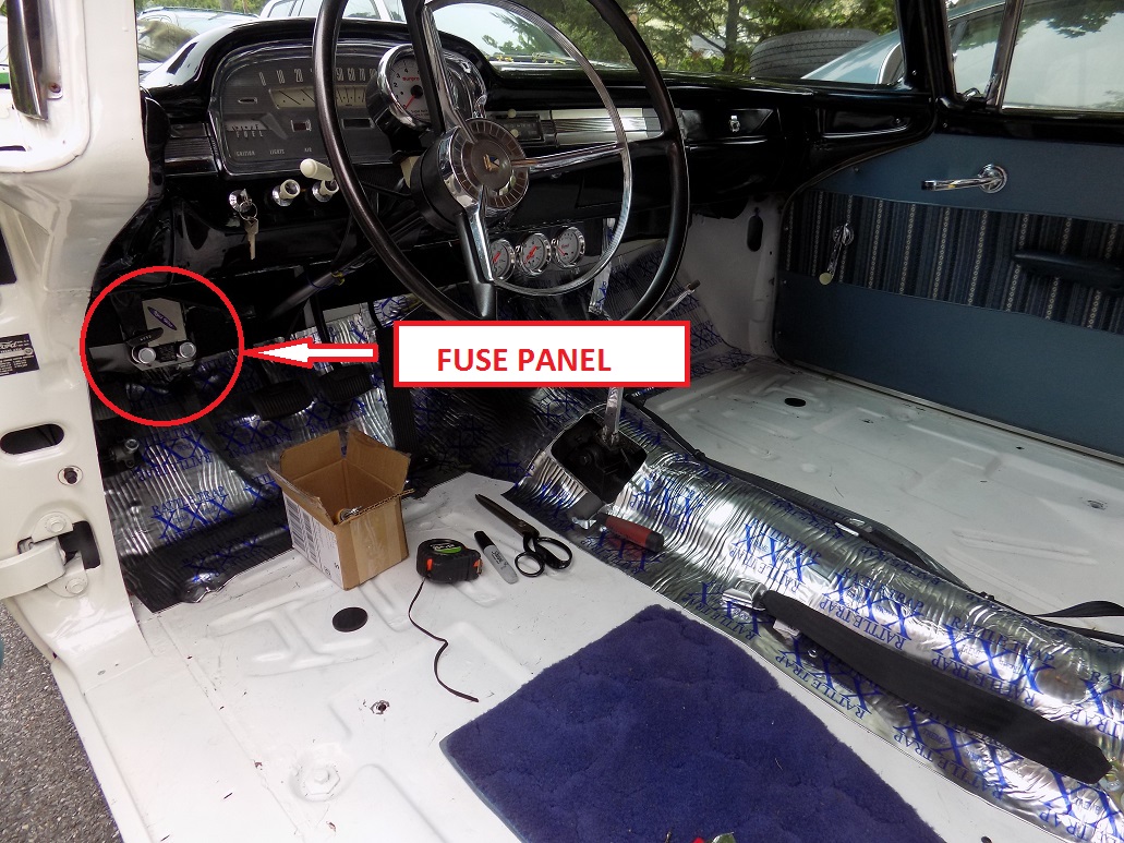

    This is where I snuck my fuse panel in. I made a sub-plate and mounted it on standoffs so it was off the floor. I cut the carpet out around it.
    Yes, the floor is that clean, shot it with a quart of Duplicolor white after cleaning it and priming it.

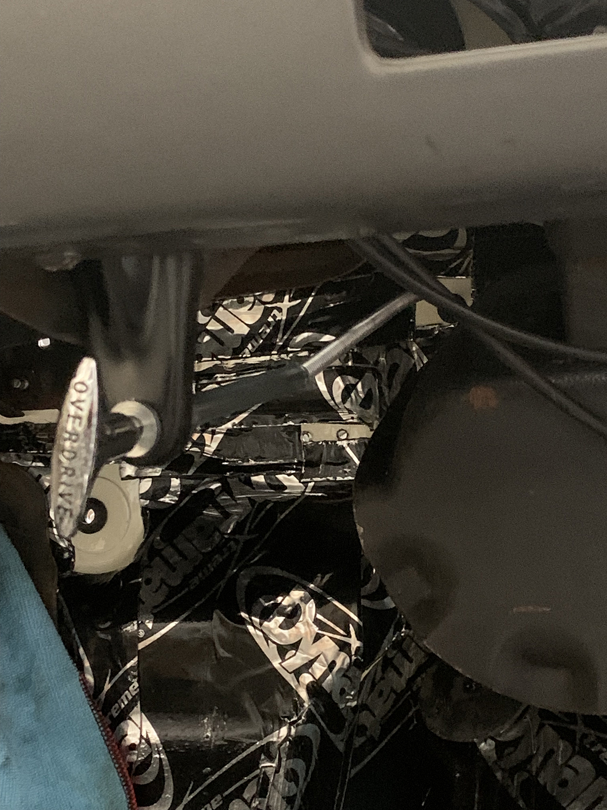

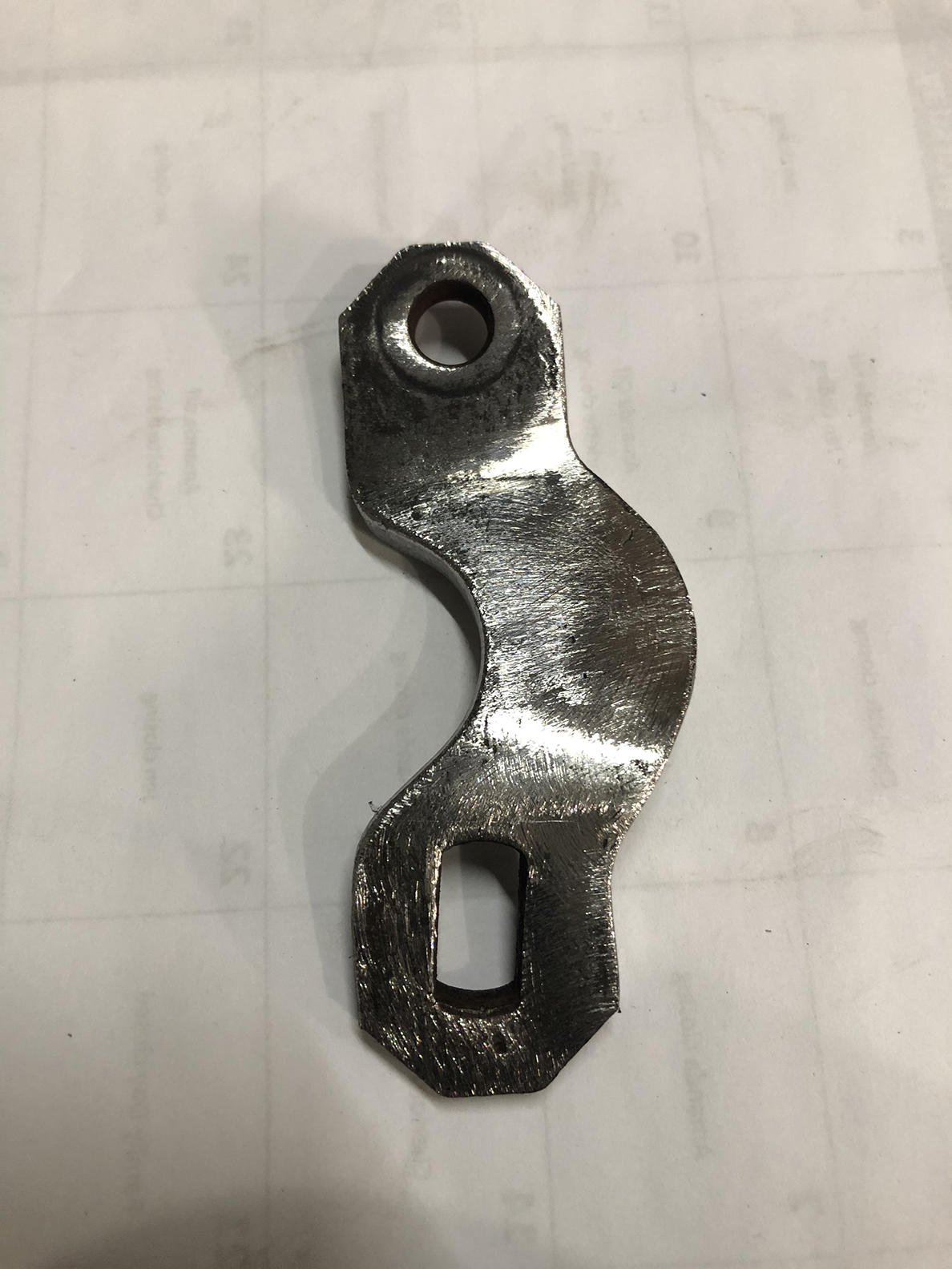

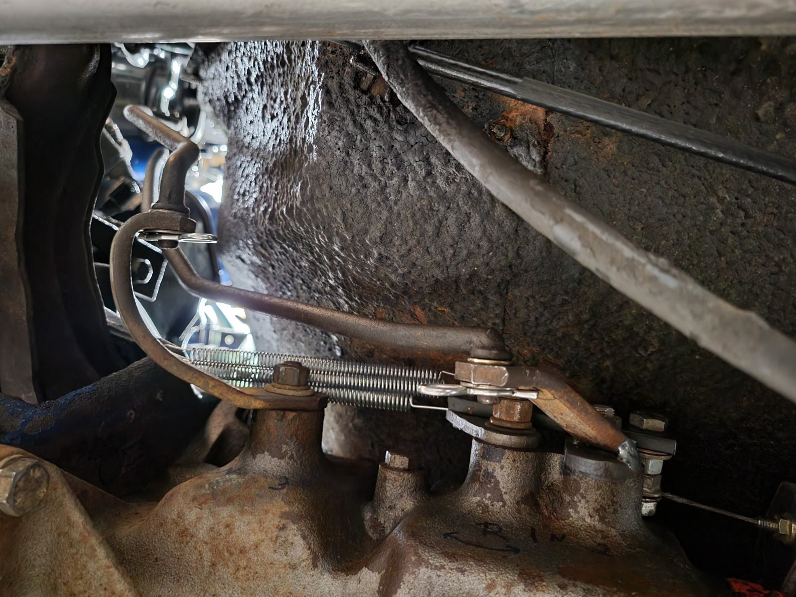

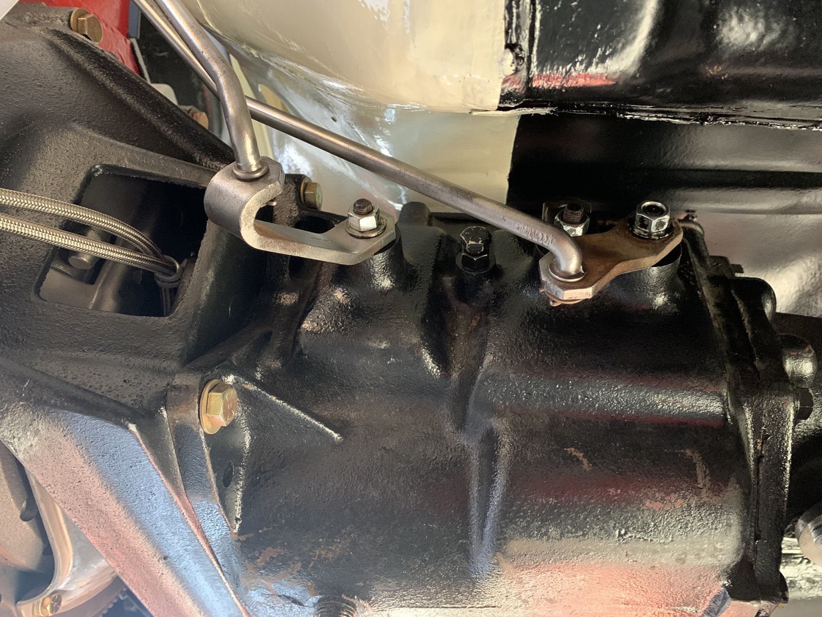

    So... this is how I have done the OD cable .... straight shot from inside the car-right side of the dash in line .....p***es through the firewall... gentle arc doing a near 180 heading in-line to the trans and reverse lever/gear tab.
    I have yet to make 2 brackets to hold the cable in place.... the most important one is to be 5-8 inches from the reverse tab(shifter tab)The cable must not move side to side or swivel. dead straight.
    I have a plan for the brackets.... based on the bracket style of the heater cables or hood release bracket.
    The 1-2 Shifter tab has been Modified ... a notch cut. and the same added to the opposite side..... looks factory.
    ALL of this is just mocked up at this point
    More later.....

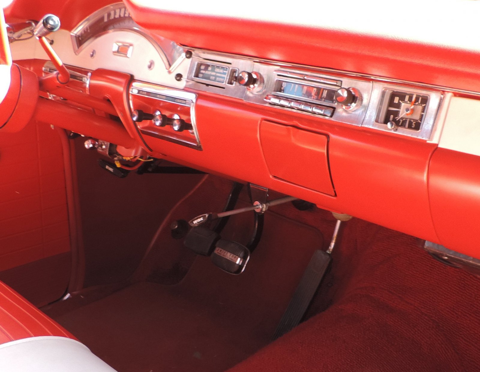

  17. Jeff, this website has a pic: https://www.gaacl***iccars.com/vehicles/25049/1957-ford-fairlane-500.
    I didn't have a 57 with od but we had a 58 and a 59. The knob was above the accelerator pedal on both of those. For the young who might be reading this, the od knob was for lock out only. The actual od was done by electric solenoid on the trans controlled by the throttle arm on the engine.
    Thor1, loudbang, Stogy and 2 others like this.

    @wfo guy
    Well. dang.... I have seem to have it in near stock positioning.... that's a fluke.
    Thank you sir!

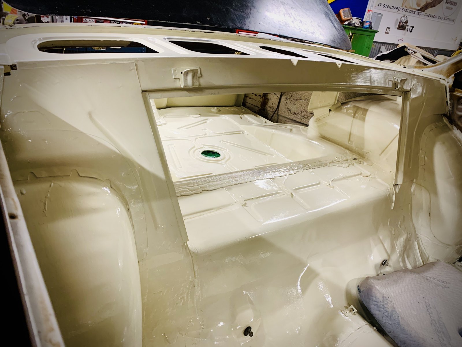

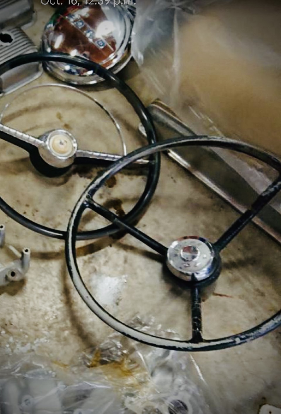

    Just painting and moving forward… gonna pull out the inner fenders…and clean them up in the next.
    I scored a 57 Meteor Custom wheel… not many of those around.
    I’m kinda sprinkling a bit of Canadian 57 Meteor throughout this … so the wheel is an additional bonus… needs some black paint… and we’re good.
    3083EF5F-DC03-4BB4-9A14-133239344900.jpeg 0EFEEAA3-7B6C-4FDC-84A6-0164302A991E.jpeg FF38C569-46D5-4256-97DF-7129D7EA0241.jpeg
