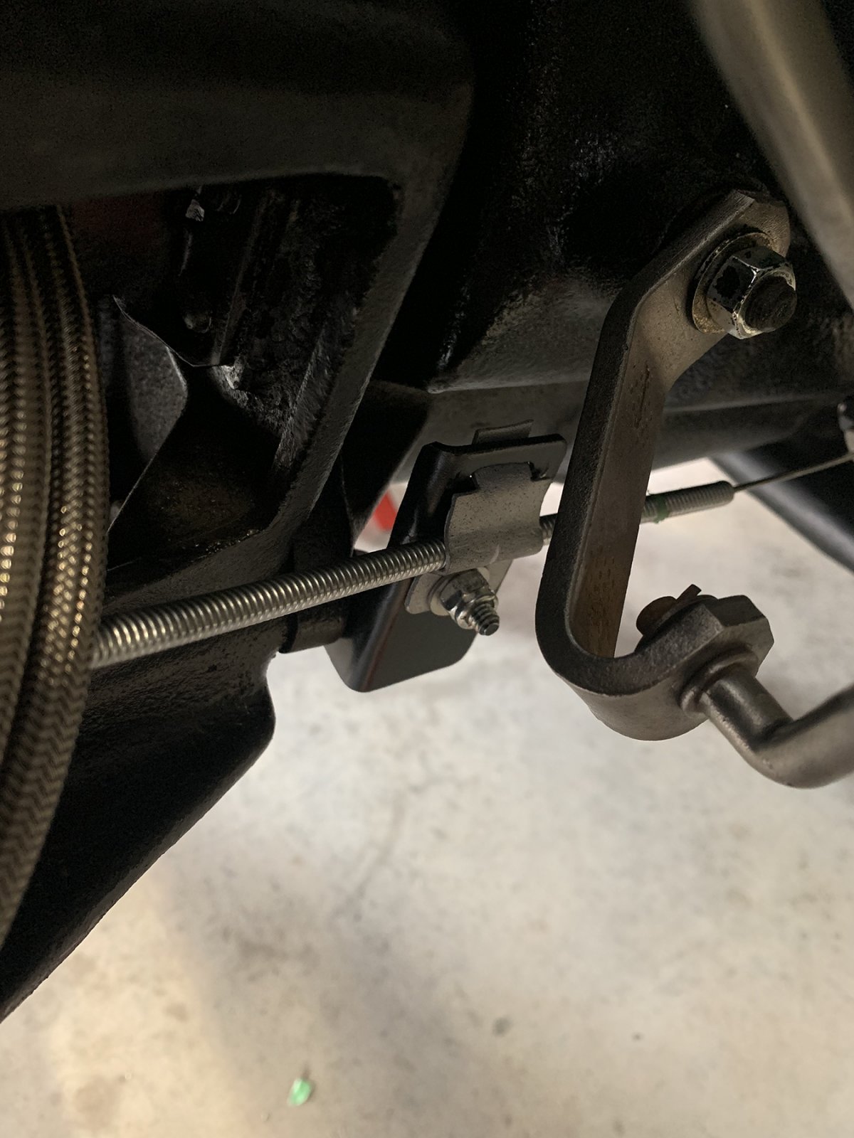

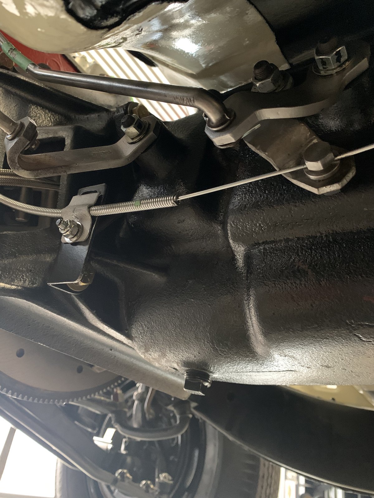

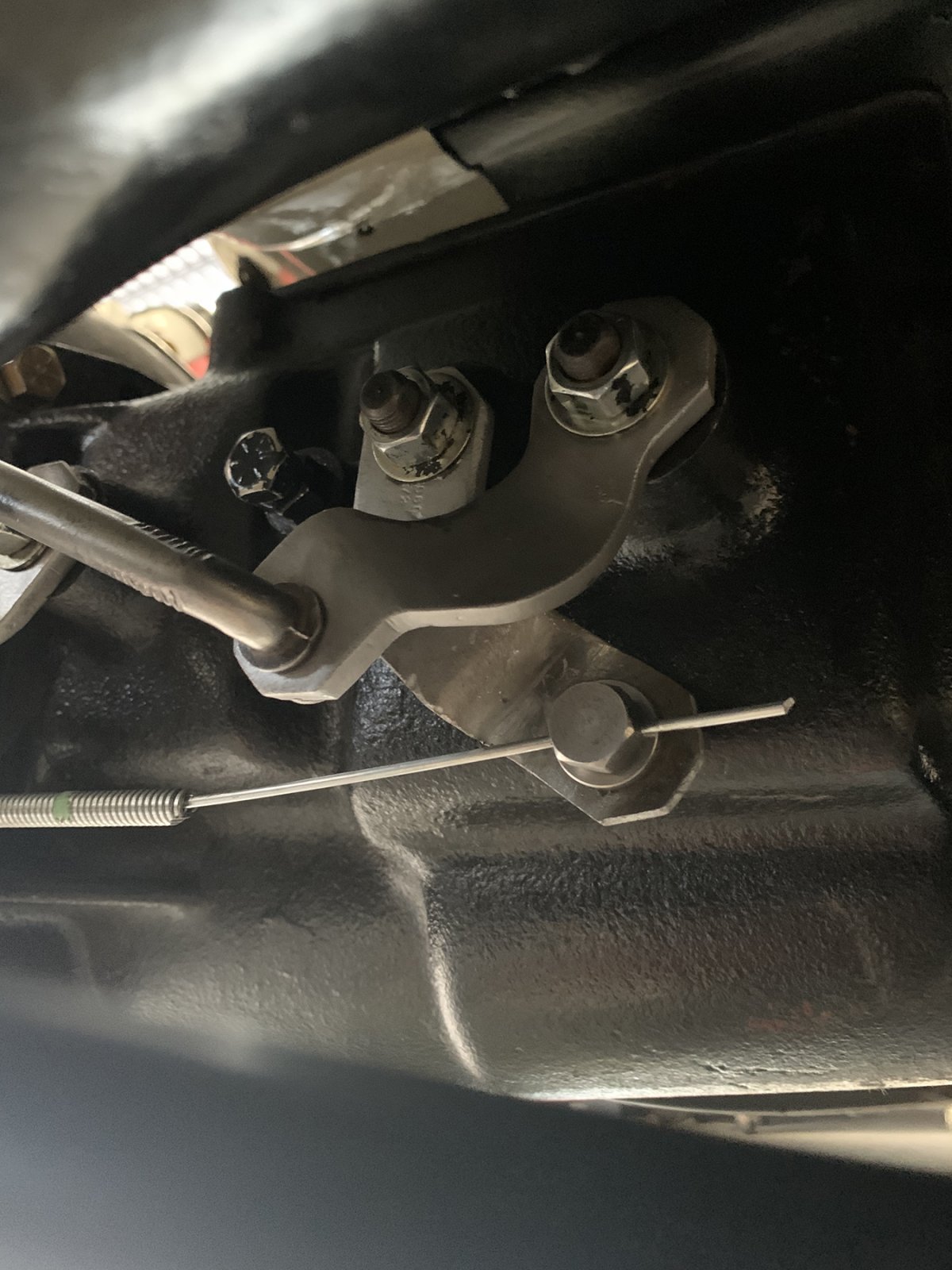

    Well...... the column/shifter/OD cable is all done and works perfectly.
    There were some adjustments. but nothing tricky.

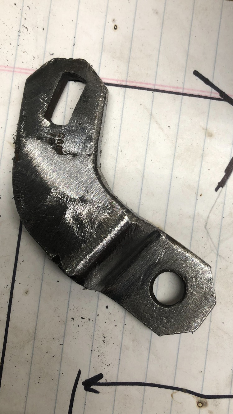

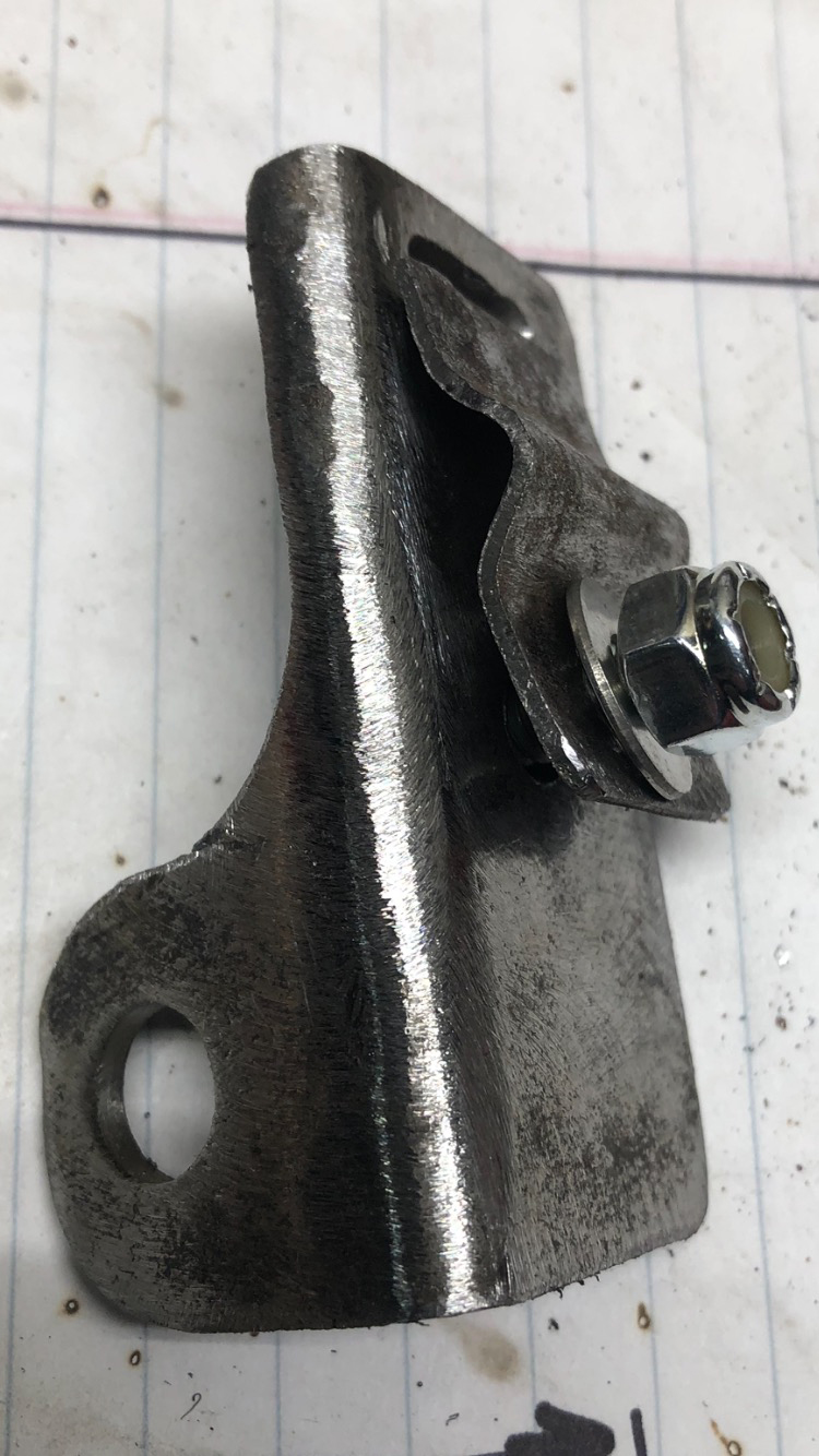

    My pal Terry wanted to make a HD bracket and place it on the lower bottom left bolt where the trans mates to the bell.
    Also... had to flip the reverse lever and clock it to a 45 degree point..(at 4 o'clock )
    We installed that last evening and all works very smoothly.On final, we pulled the inner cable and greased... installed, locked things down... and all works very very well.
    The only thing I want to do is make a secondary support bracket at the handle end.... to give a bunch more rigidity attached to the dash.
    Should have that made up by this weekend.
    Now starting to lay out brake lines and fuel.....
    Still need to install the sway bar, waiting on my starter and fab an Alt. bracket.
    Pushing forward.Can't thank my friend Terry enough for ALL his help.... and folks like @34fordjay (a****st many many others)
    I get excited about the fact that this car was last on the road in Childress Texas in 1971.
    And hopefully soon it will be rolling again.

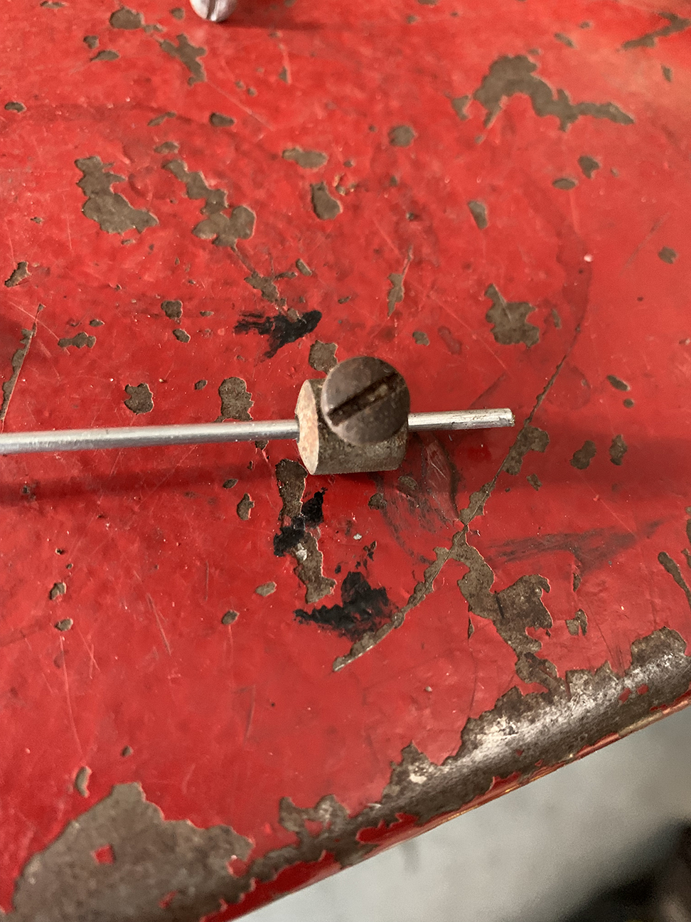

    Maybe take a pair of need nose pliers and give that cable a little eyelet at the end. It'll stop the cable pulling out if the bolt loosens off and it may save you a painful bite at some point down the road!
    Thor1, Stogy, loudbang and 2 others like this.
  17. Jeff Norwell
    Joined: Aug 20, 2003
    Posts: 15,278
    Jeff Norwell
    MODERATOR
    Yep,....Have that covered..... thanks.

    Nice work Jeff. Might I offer a suggestion, get a long piece of heat shrink and cover the cable with it to keep an moisture from getting in and the grease from coming out. Size it so it barely slips over the cable housing and it will seal it up very well.

    GREAT idea Bill..... I will do just that.

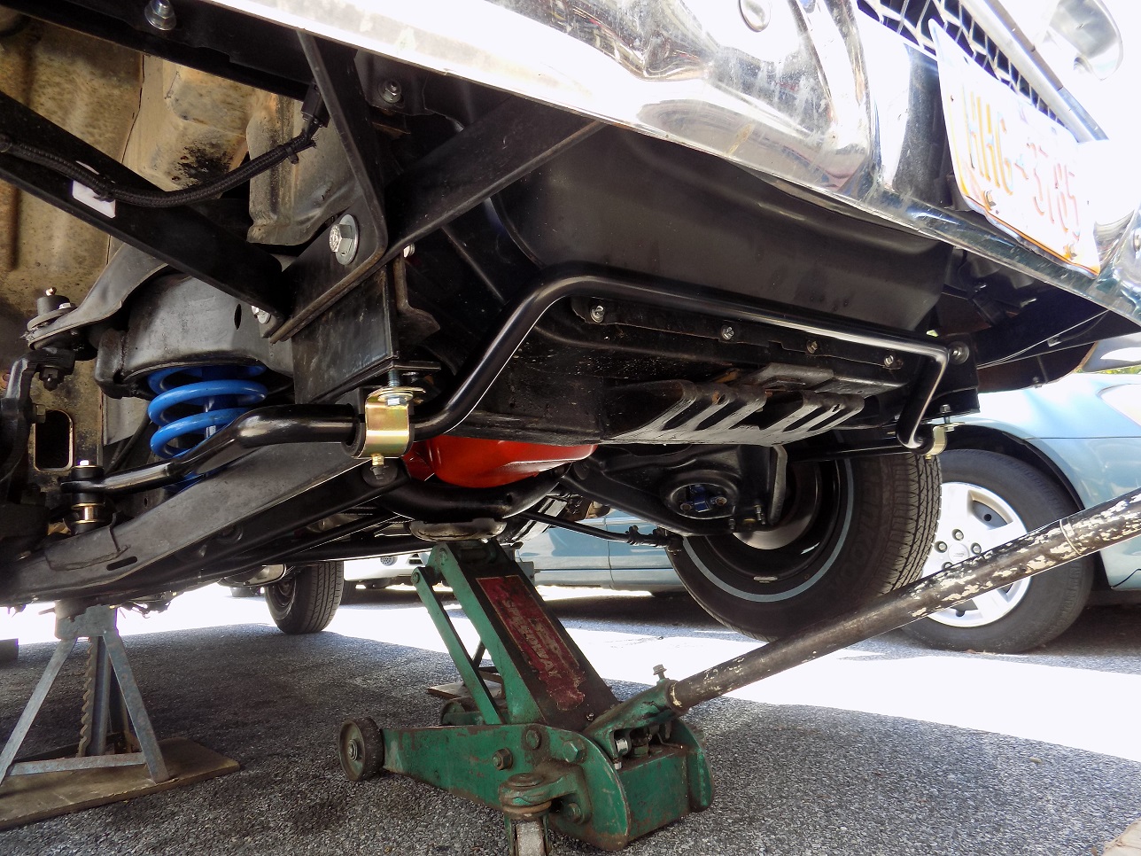

    I took my front end down to the bare frame, acid-dipped every part to get them down to bare metal. It made a huge difference putting it back together.
