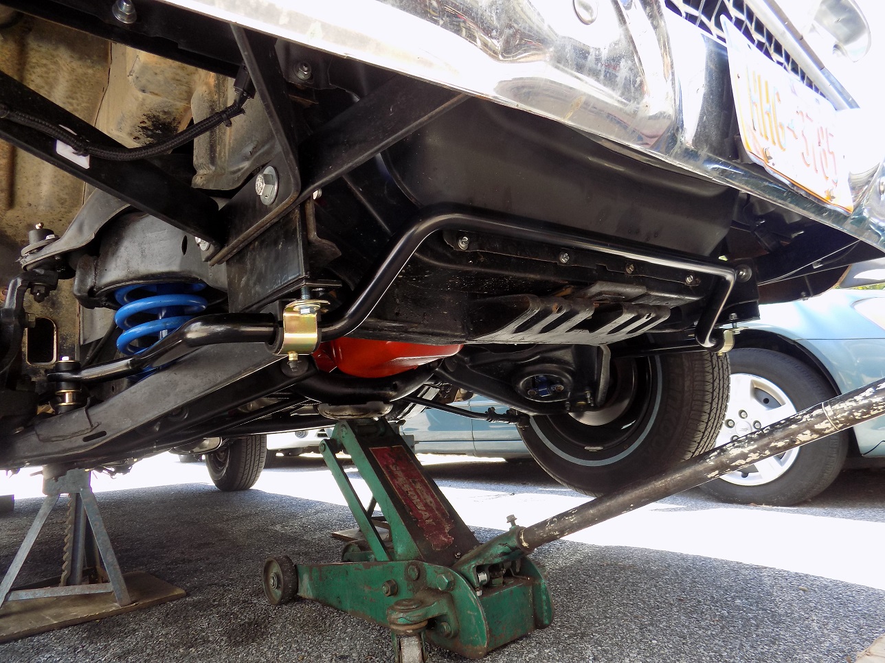

    So with in 45 minutes... all was installed..... pretty easy and the big 1-1/8 swag bar is a M A S S I V E improvement over the silly little girl 7/8's factory unit.
    I have one on the other 57...... and the difference is night and Day.
    Well worth the investment.
    As a side note... the bumper brackets are sandwiched between the big L brackets and the frames..... I will do that later... I know I will take a knee cap off if I put them on now.....

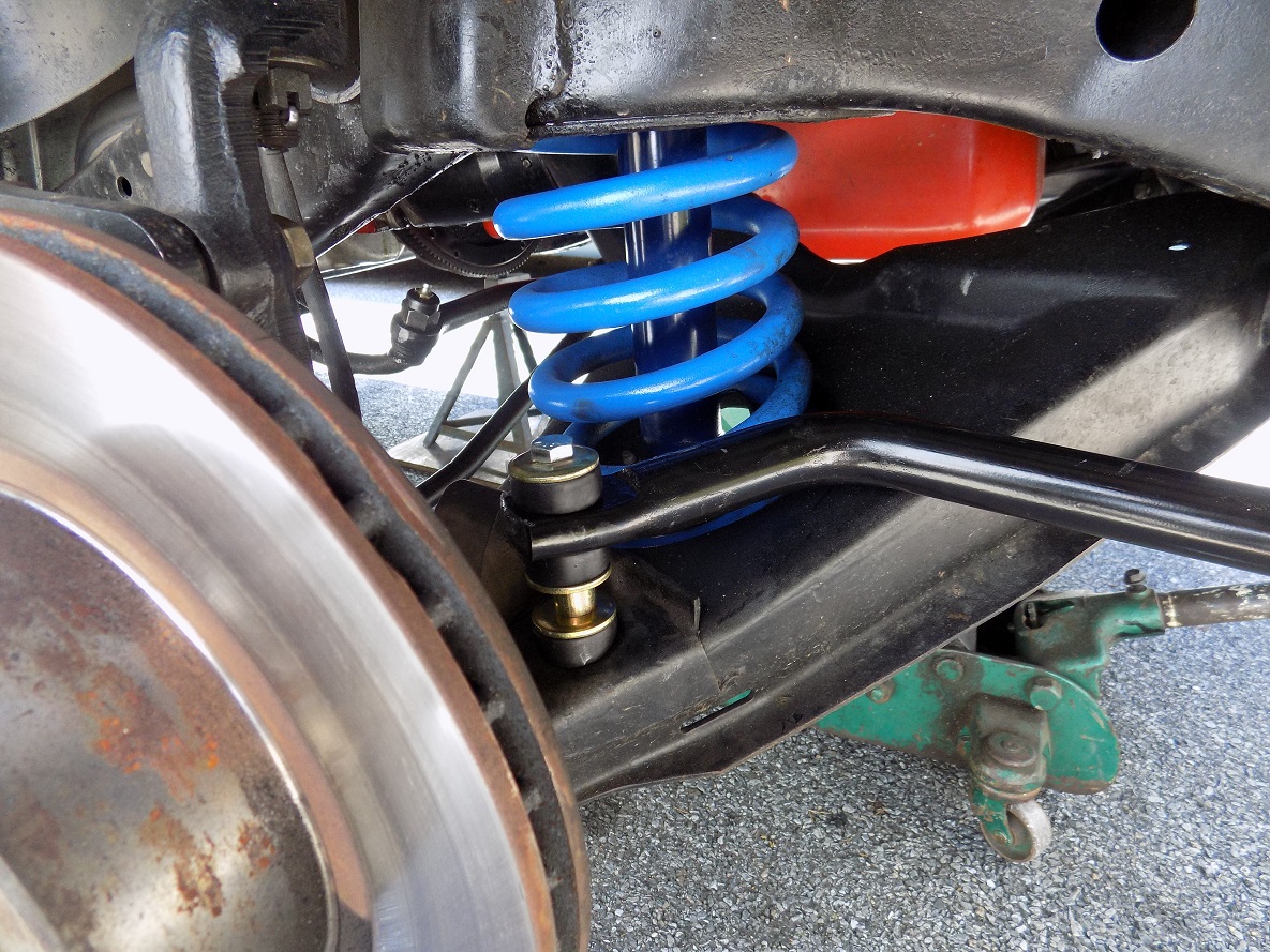

    So.. had a fitment issue with my traction masters.........
    at the spring pocket end.... the retaining bar flat stock bracket.. was just hitting the frame.
    Not good.. the spring will flex under hard acceleration or even normal driving conditions.
    Very tight area.
    So..I mentioned this to my pal Terry and he asked to make a new bracket to solve the issue.
    he really likes solving these type of issues.... so I did a doodle of what I thought and the issue,.. and he bent up some stock and it works perfect.
    a sandwich wrap of sorts....
    did a test fit today and ready to install.
    That dude Terry,... is the cats meow... and a ******** Ford man..... he is building a 427 Hi-Riser and another side oiler under his work bench.
    We get along well and have a great many laughs.

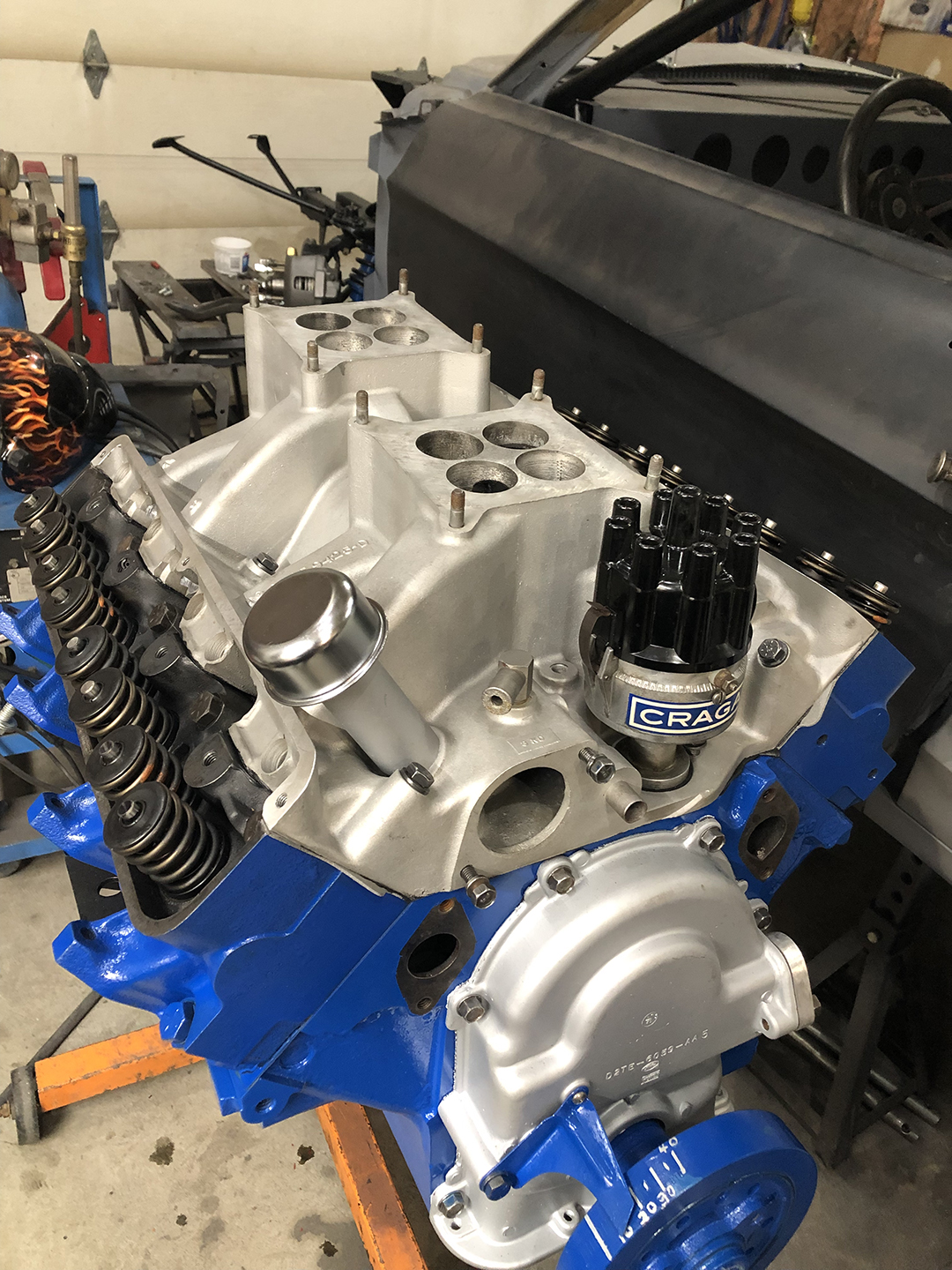

    A fast shot of Terry's 427 he is ***embling
