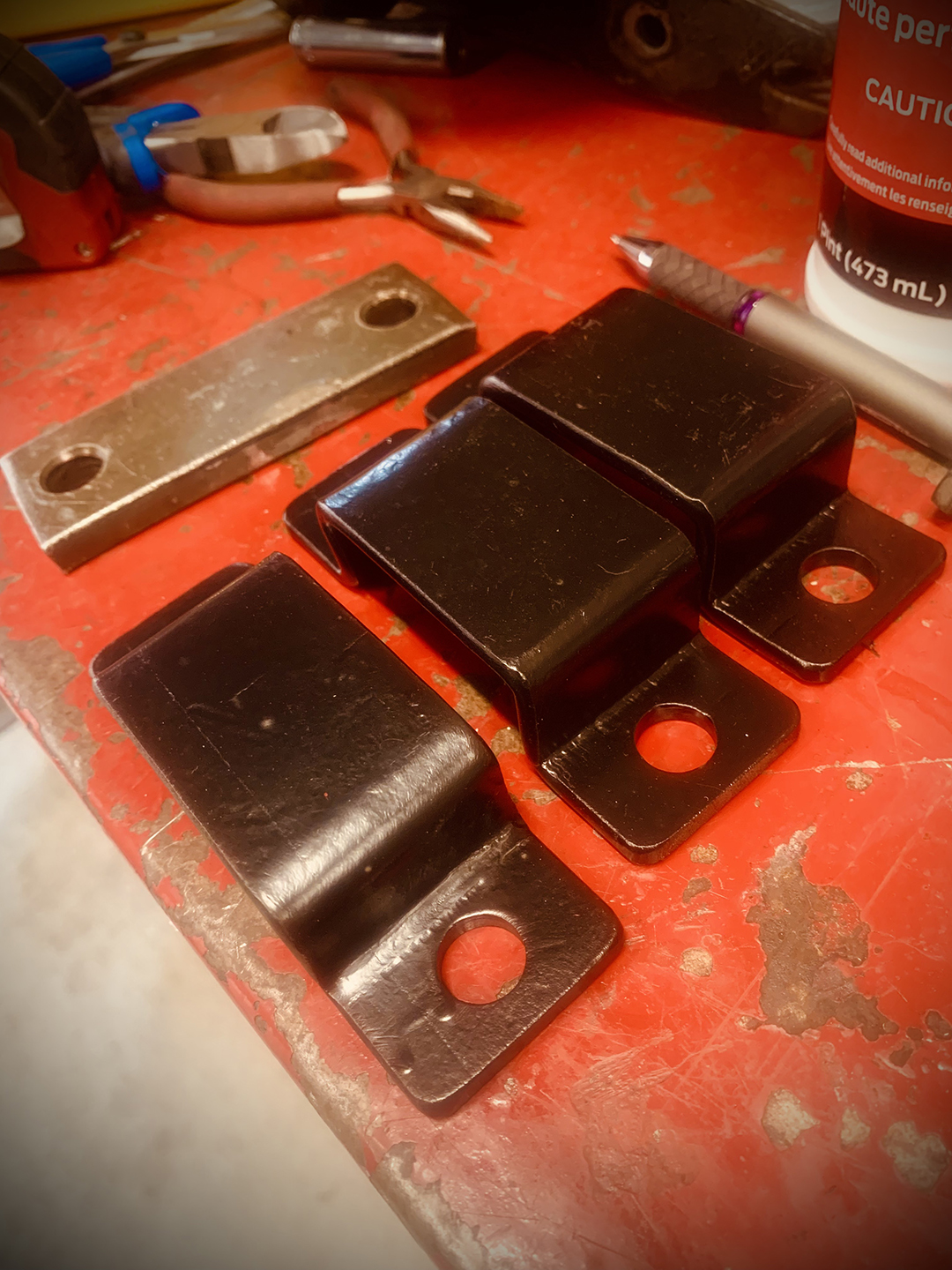

Hot Rods 57 FORD Build #2... Glutton for Punishment.
Discussion in 'The Hokey Ass Message Board' started by Jeff Norwell, Oct 20, 2021.

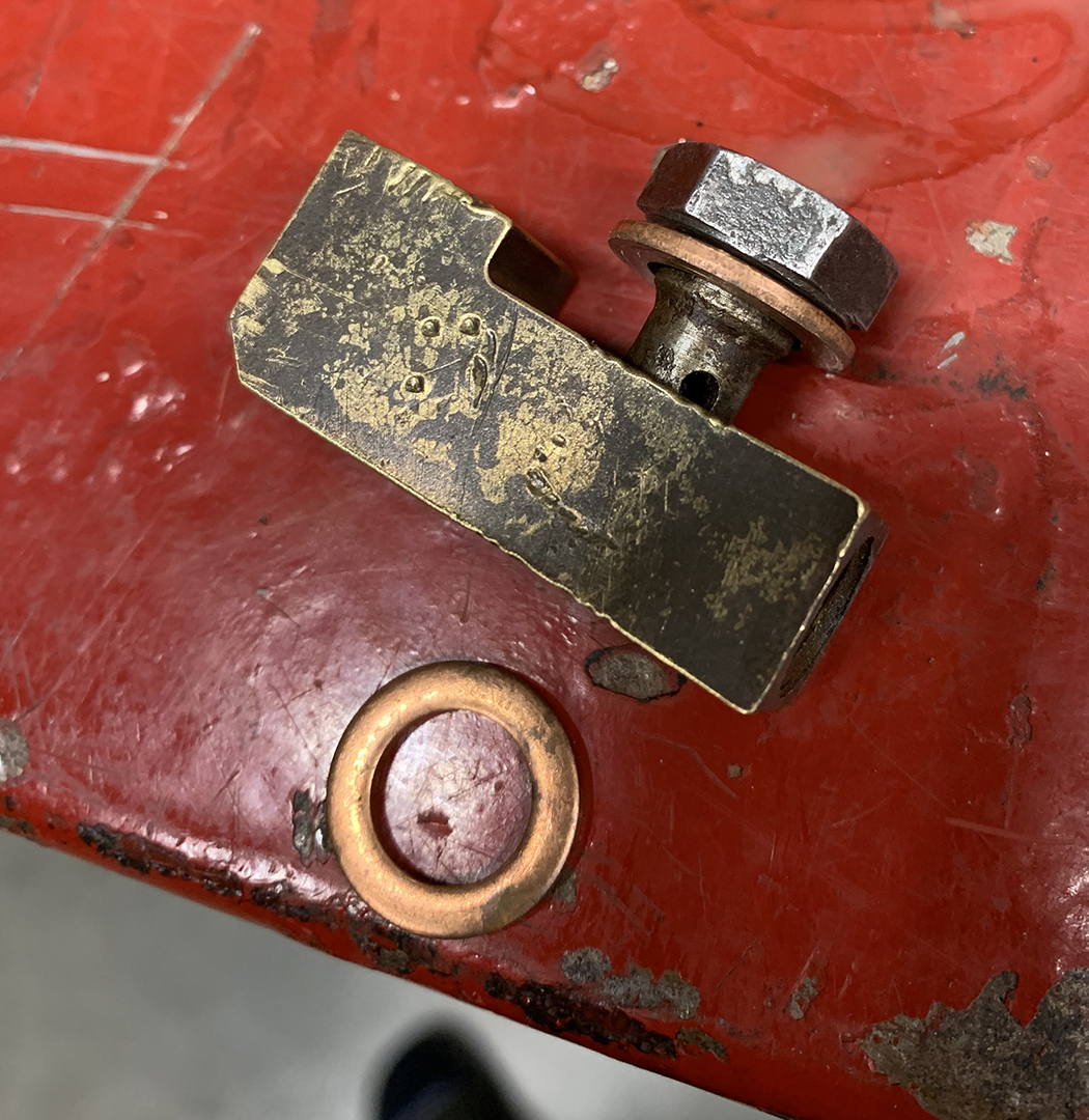

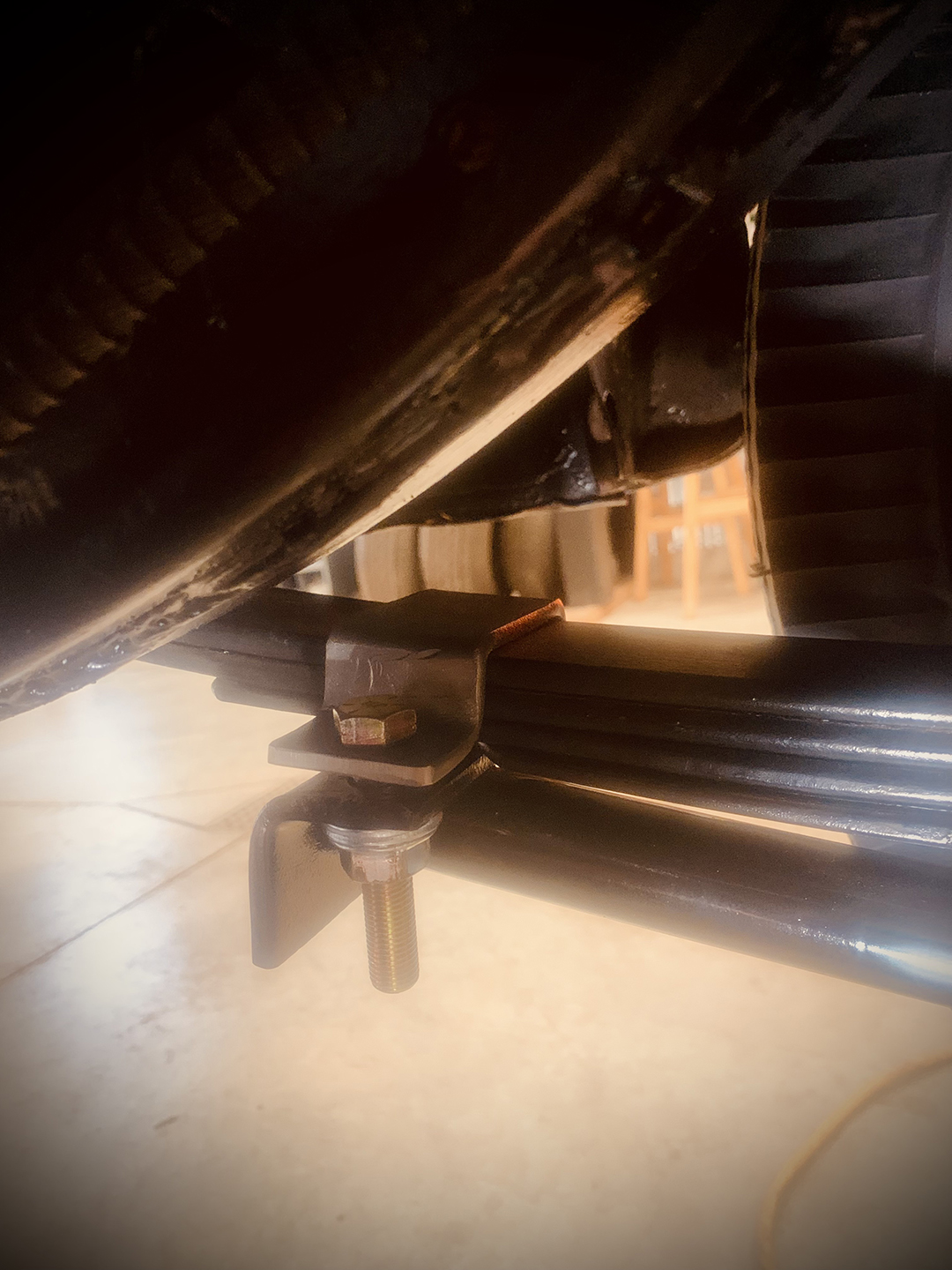

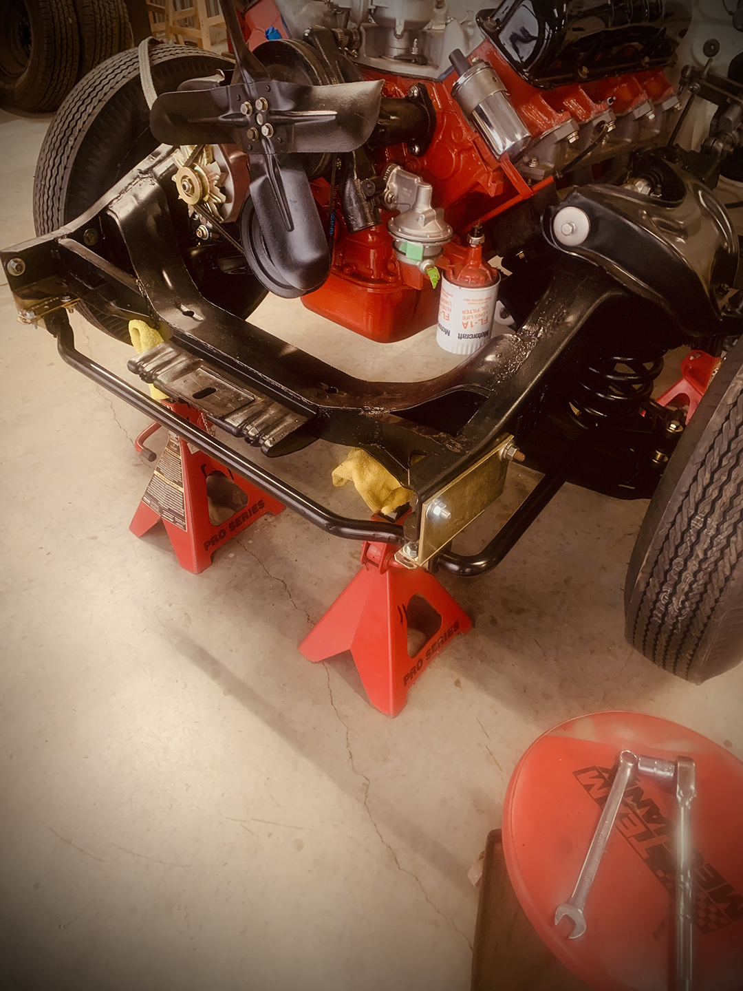

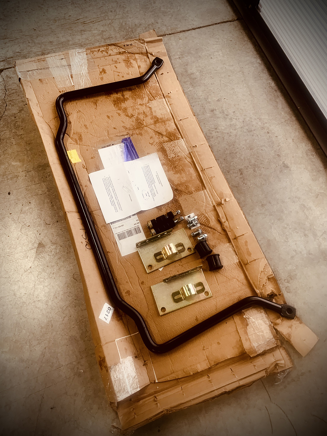

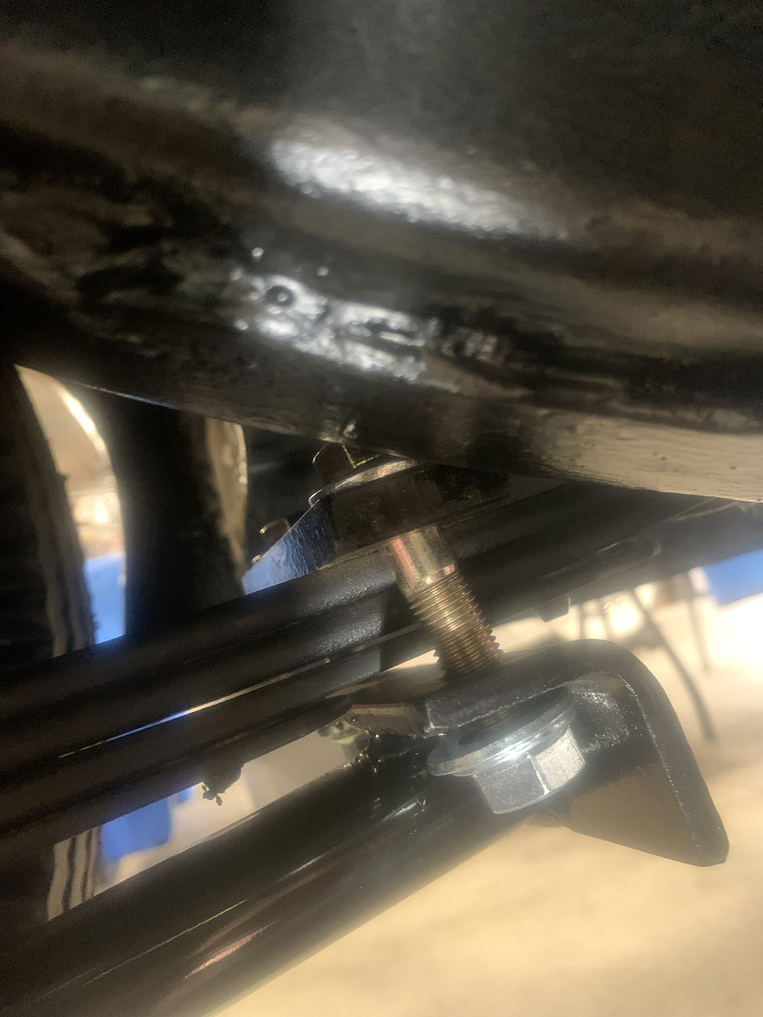

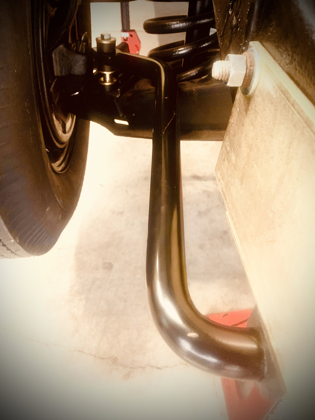

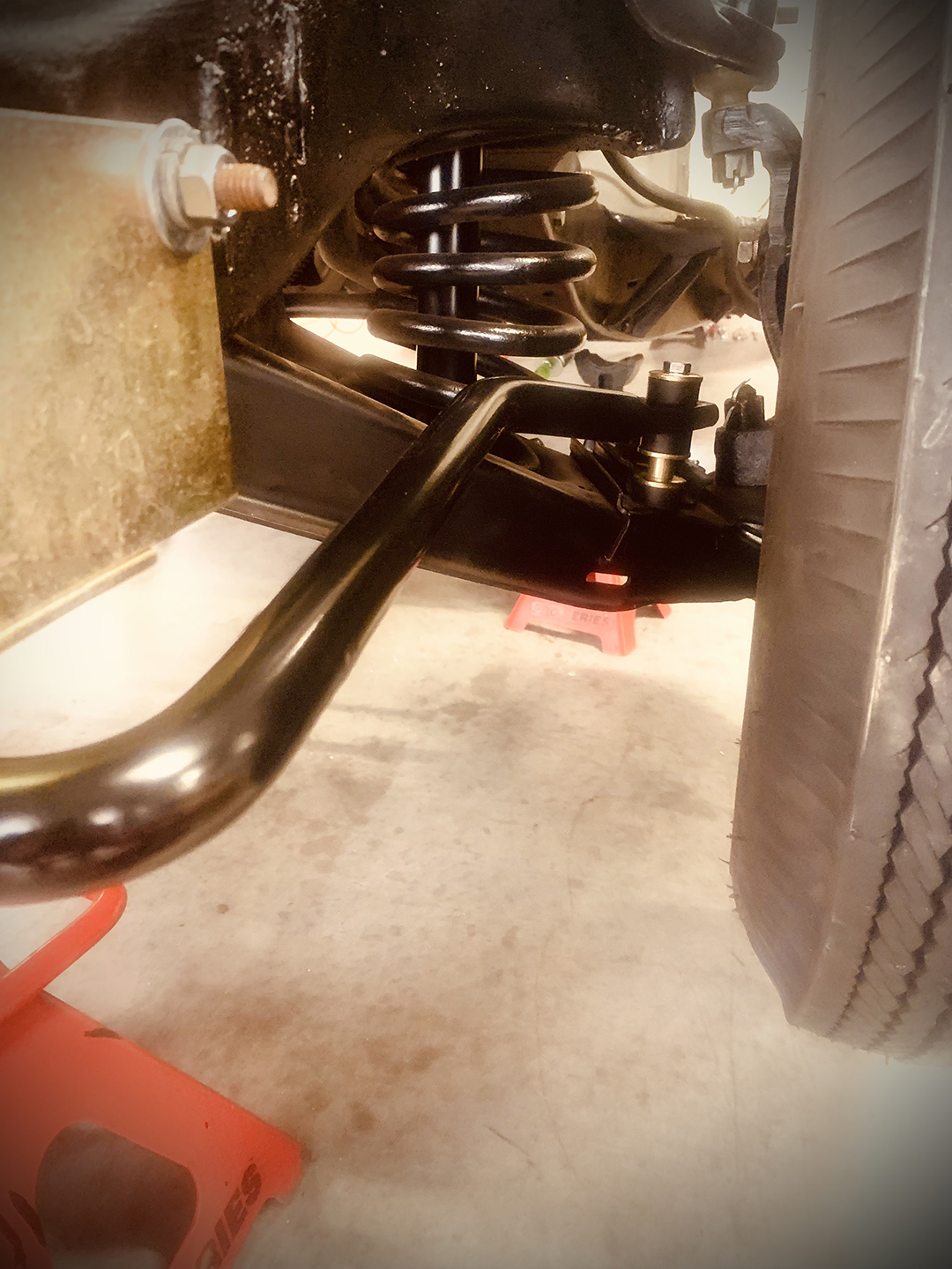

  1. Why can't that swaybar be mounted the same way as the factory unit?
    Jeff Norwell likes this.
  2. 34fordjay

    That's one super serious big boy sway bar. You are going to be happy with it. I'm
    happy to see that you already have it installed.
    Stogy and Jeff Norwell like this.
  3. Jeff Norwell
    Joined: Aug 20, 2003
    Posts: 15,280
    Jeff Norwell
    MODERATOR
    Oh yes.I picked them up and will be used for my 410.

    Ain't that the cats nuts? My brackets were painted black otherwise the same dealie. It made a dramatic change to mt '59's handling.

    That was a simple solution, no brake by me so I'd be machining them out of bar stock hot-rolled steel, which I have a lot of. I have a CAD drawing of my version of Cal Trac bars. And a shopping list roughed out. I'm using a pair of eBay yellow traction bars right now. The OG Cal Tracs are an issue as you approach the front spring eye, little real estate there.

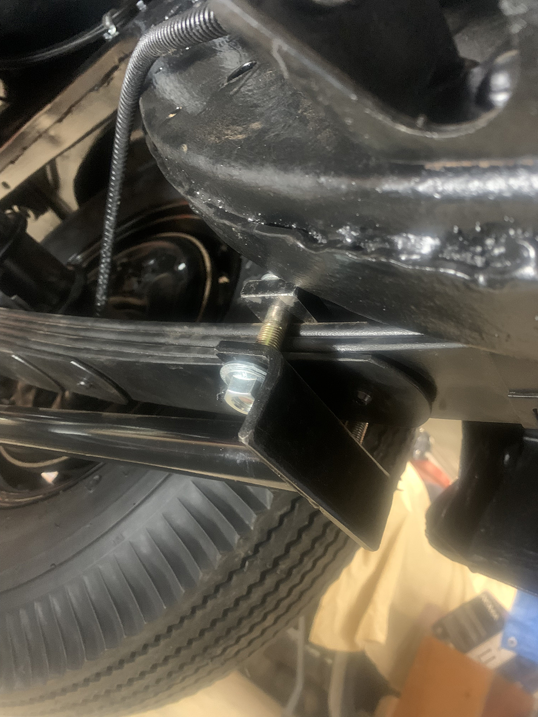

    .I really like that Ni-copp stuff.... All bent up and used all the OG Ford Br*** block/fittings... throughly cleaned all and removed 65 years of junk.
    they were in good shape..... I seem to throw away nothing....
    Sorry, not a lot of visuals.. but.... ya know.
    All lines are in and secured from front to rear... Went kinda fast....

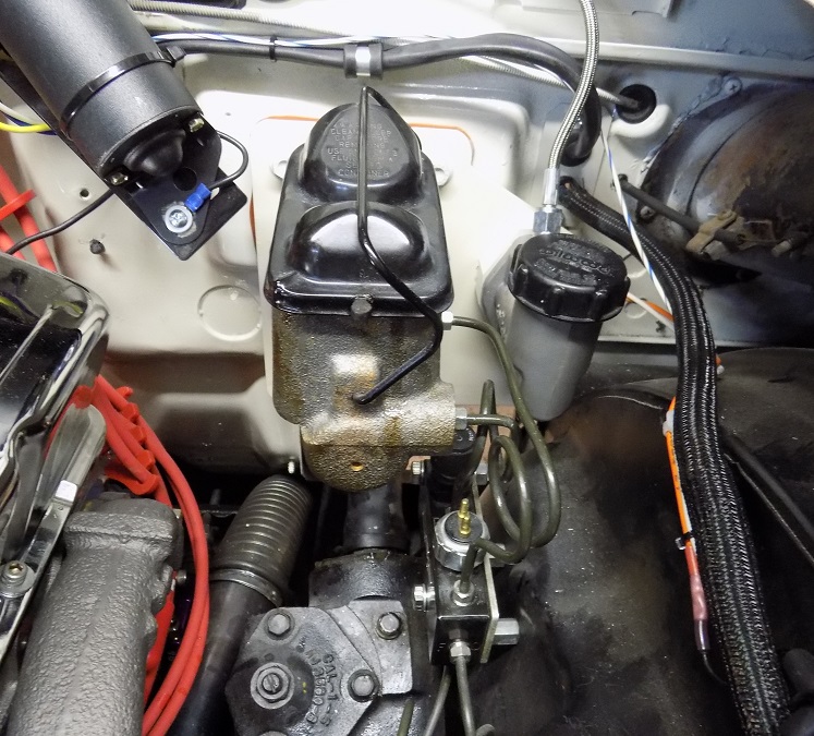

    Because I am running a Tilton release bearing....(I got it free, brand new) I have to run a separate master for the clutch. I went with Wilwood,(Part # 260-1304) the smallest master I could find with the longest Piston throw,..... It will mount neatly beside the Ford Brake Master and be tucked out of the way....Plan to run the same Ni-copp lines from it to the Tilton
    I know in the past,Many don't like an internal release bearing. but.. I have had them successful on 3 cars.. never an issue(as long as its set up properly)..... and..... it was Free.
    Speaking of Brake lines... I haven't yet run a line from the master to the whole system.... yet.... I need to get the Wilwood set up and the proper pedal ratio... with a Bump stop as well..... the main Brake line would just get in the way.....

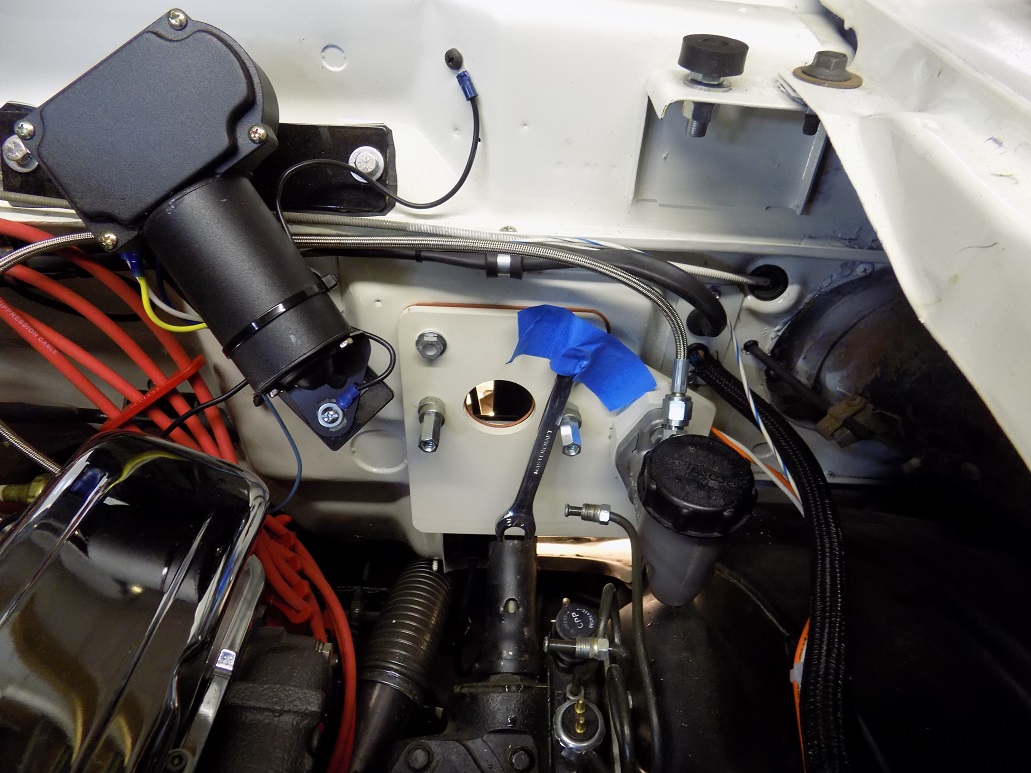

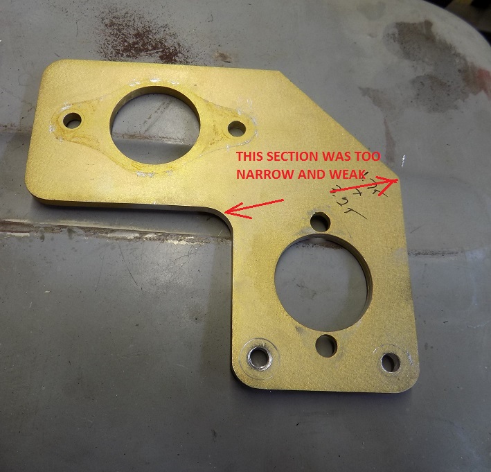

    My clutch master is probably the same. I made up an aluminum mounting bracket, too thin a section and has too much flex. A 1/4" steel plate was the answer.

    @bobss396 ..thinking the exact same thing.... Just might need a stiffening mid plate....
    great solution.

  12. I use a doubler plate on all clutch installations. The original clutches had very little spring pressure on the pressure plate and didn't flex the firewall much. Coming forward to hydraulic masters or Ford pull cable types and the firewall is always flexing which will lead to fatigue cracking. It's easier to spread the force and not have to repair than be repairing a finished car on down the road. If you don't drive your car, it's not a problem. If you put 5000 miles per year on it, you might consider this. The wider the area you can spread the force out on, the happier you will be. I don't know if Mr. Norwell will drive this car a lot or not. It looks to me like he needs to hire me to drive some of the many hot rods he has. Specially those that need burnouts to be happy. :)

    I have a few ideas on the firewall strength area for the clutch master....
    Got a parts car and an extra firewall to borrow from.... I would like to have any plate or stiffener inside the car... and possibly not on the outside in the engine bay.This may or may not be possible.Also have several other master/clutch/brake ***emblies to carve up if needed,
    but it will be shored up considerably ....

    I still get a little flex in the firewall, but it is tolerable. You could try another piece from the inside to sandwich it up, however that area is a tad busy with the pedal bracket and all. I'll look to see if I have a copy of the CAD drawing in my shop.
  20. bobss396
    Joined: Aug 27, 2008
    Posts: 18,738
    bobss396
    From the inside, even a sheet of 3/16" stainless would shore it up. I was thinking of 5/16" plate for the outside, but used what I had around. Now I think of it, the 5/16" wouldn't have helped, it has to be sandwiched. My 1st 2 tries were from 1/4" aluminum, not nearly strong enough.
