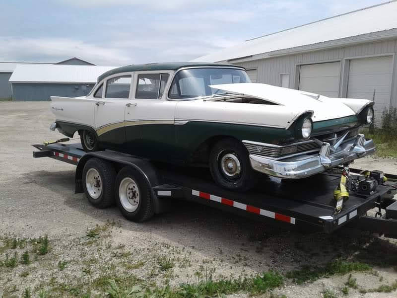

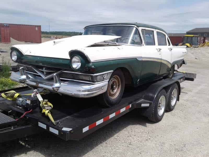

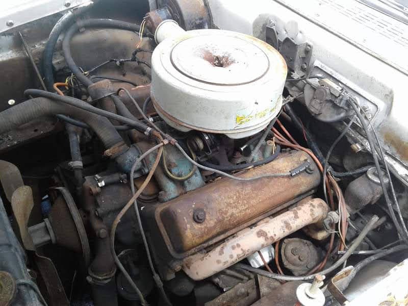

    Cmon… you all can surmise until the cows come home…
    I saw that car, inspected it and took what I needed.
    floors were completely gone… interior was destroyed, the 272 was Seized… the Ford-o-matic was not only toasted… they were a horrible transmission… the front end was deteriorated beyond fixing as the front crossmember was Swiss cheese.
    It was J U N K .
    Be happy it made a second life as a race car… and 7 people saved their cars.

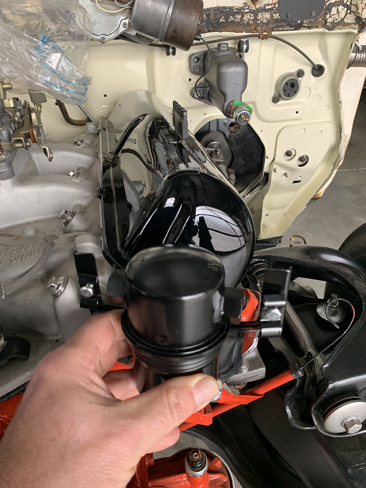

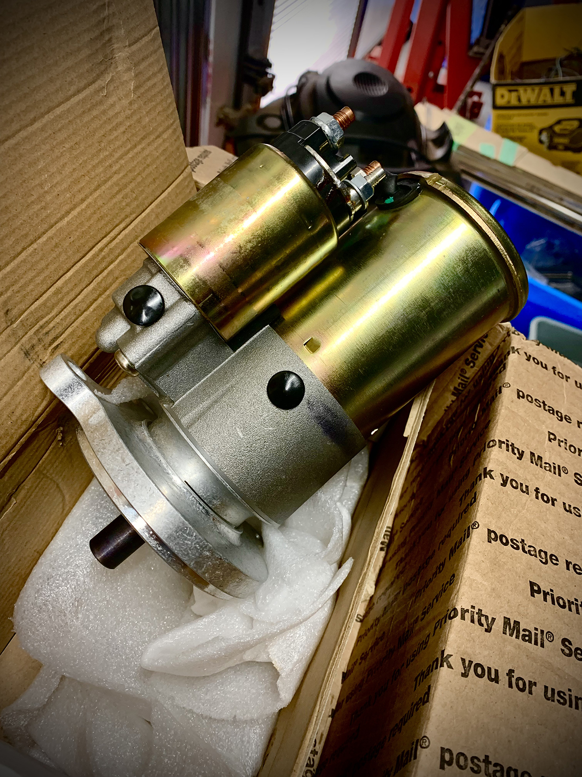

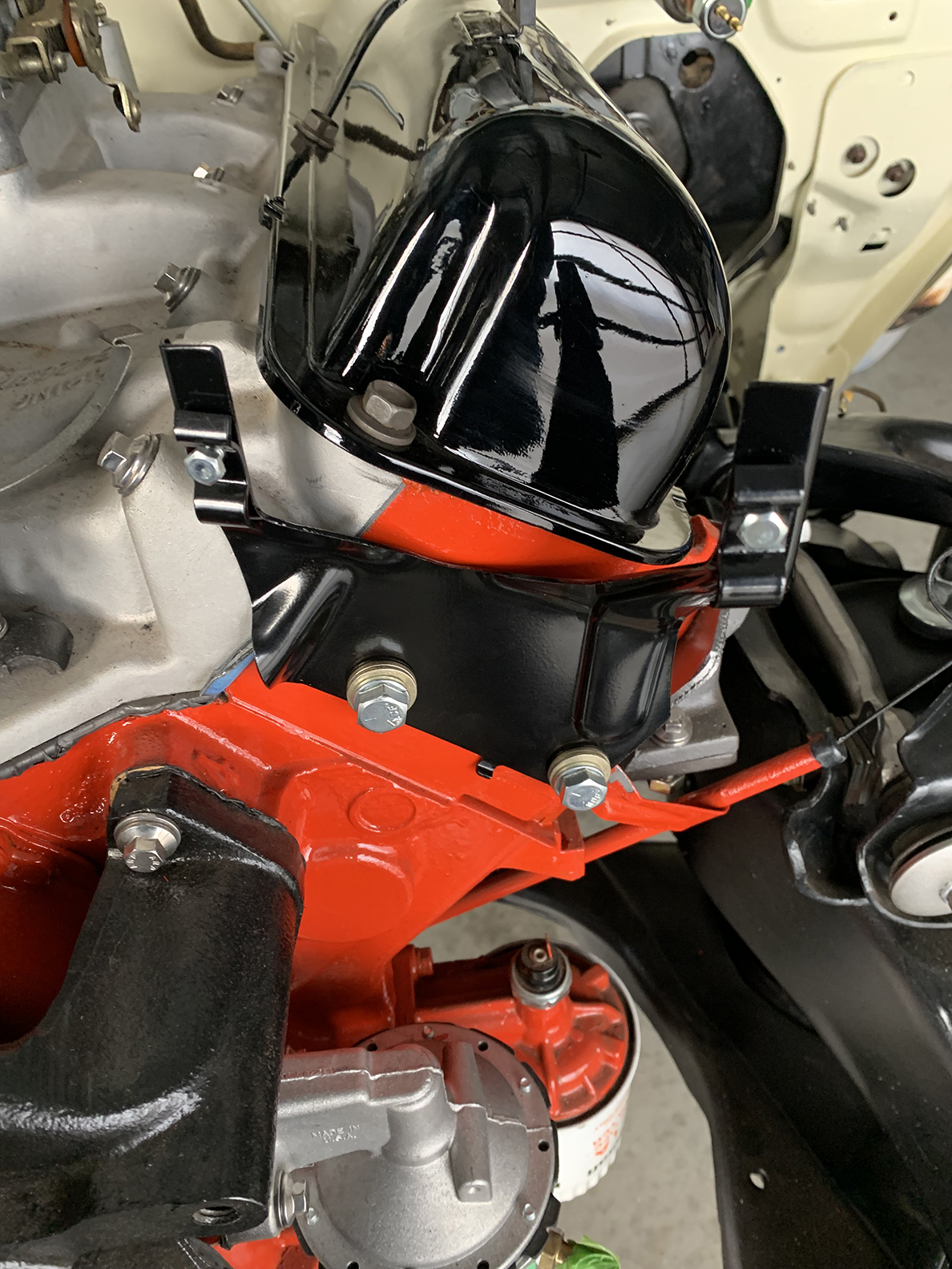

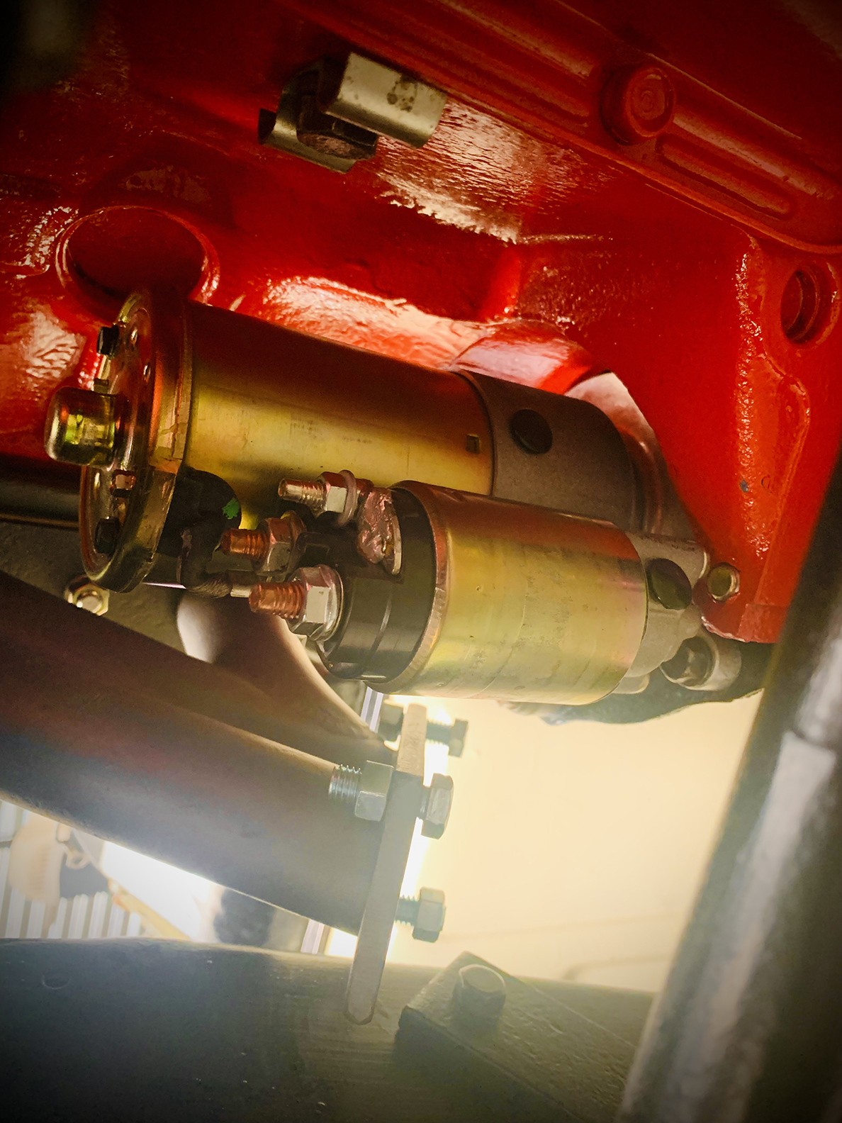

    My final parts arrived...... finally. my Robbmc starter arrived,. I needed this as the solenoid can rotate 360 degrees... fit like a charm,
    also received my fuel canister and mount.... mocked it up... and I will continue with the 3/8's line...
    Plan to go and get my driveshaft cut and spun up with an accurate measurement of 57-5/8's...
    and starting to ***embly the throttle linkage.
    Keep pushing forward....

    Is that a Holley fuel canister? I have a couple of them myself. They take the same element as the old Ford fuel pumps. I forget the number right now.
    Stogy, Thor1 and Jeff Norwell like this.

    @bobss396 .... The fuel canister and bracket is from a 1960 Ford unit..... and was used on 390/406/427 cars....
    I did not know Holley made one.. interesting.

  27. I am pretty sure the holley fuel canisters have 1/4 male fitting attached to the canister to slide 1/4 inch rubber hose over .
    Picked up a proper tri power / dual four chrome canister with a new filter at ancaster a few weeks ago , I'll break your heart Jeff 20.00
