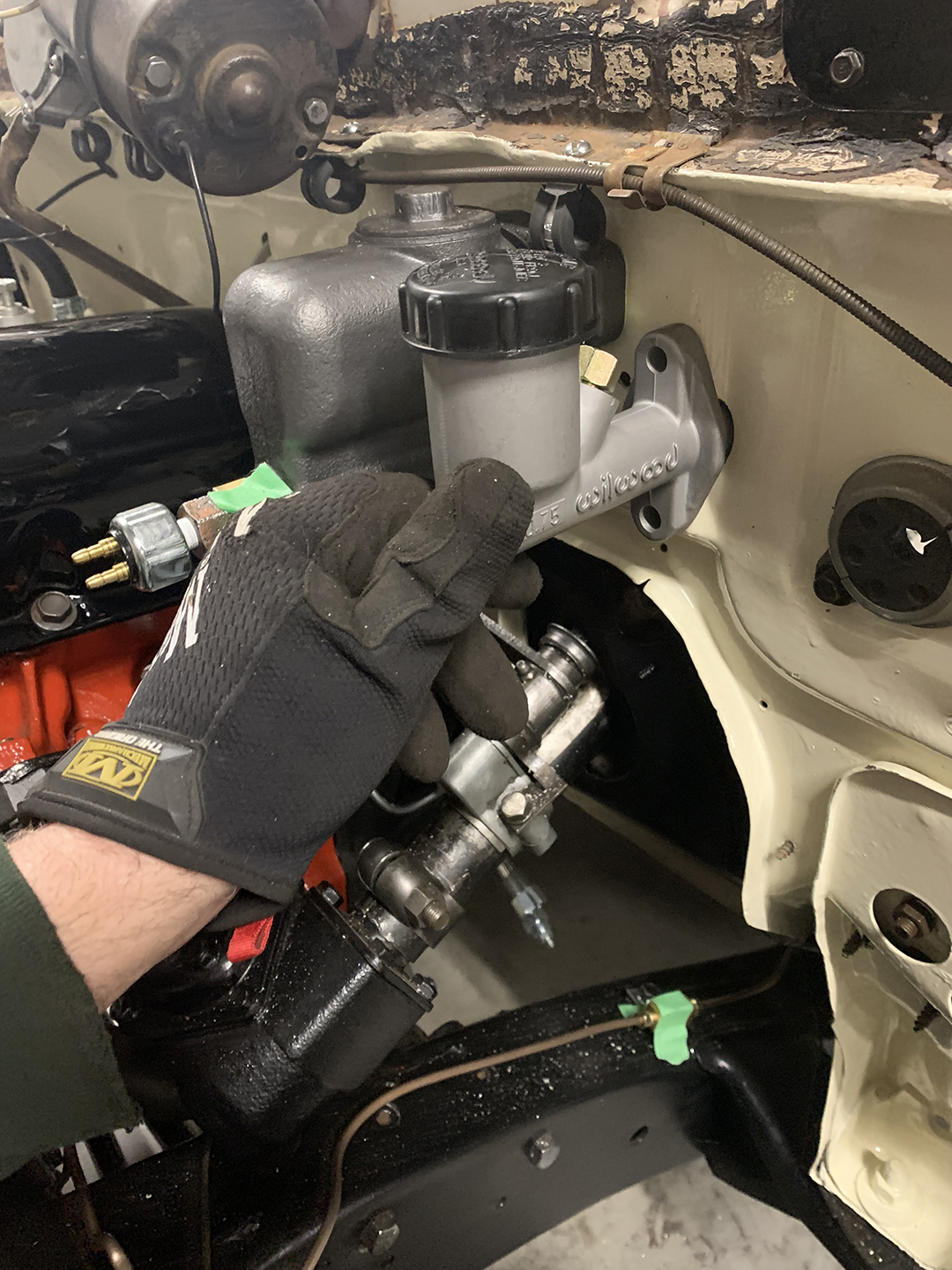

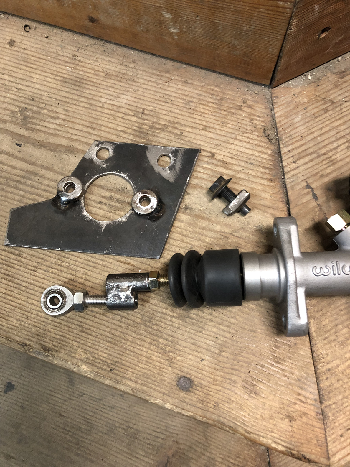

    Moving on to the Clutch Master..... we are making up an inner reinforcement plate..... surrounded by a cage type deal that will tie into the OG brake/Clutch bracket... I have no pics of this yet... but when completed I will up date.
    Unfortunately .... there is just no way to hide the master in the car at this point..... just not enough real estate ...
    Been playing with clutch pedal ratio and lined up the master and pedal in a perfect forward push.... no angle whatsoever.
    We are committed now.......

    Once I had my new master/clutch master plate made up I still had to get the clutch master situated a lot better. I made up a riser block to make more room for the pedal rod inside the car since I used heim joints.
    The clutch master I originally had up higher but dropped it down to get it the rod straighter. A slight angle can be tolerated. I had originally dropped the pedal rod lower on the pedal arm, no good. I lost too much leverage. I would up using the factory hole in the arm.
    I really only needed about 3/4" of clutch fork travel to make everything work, took us about 3 weekends and a lot of made-up parts went into the s**** heap.
    Deuces, Sky Six, Thor1 and 1 other person like this.

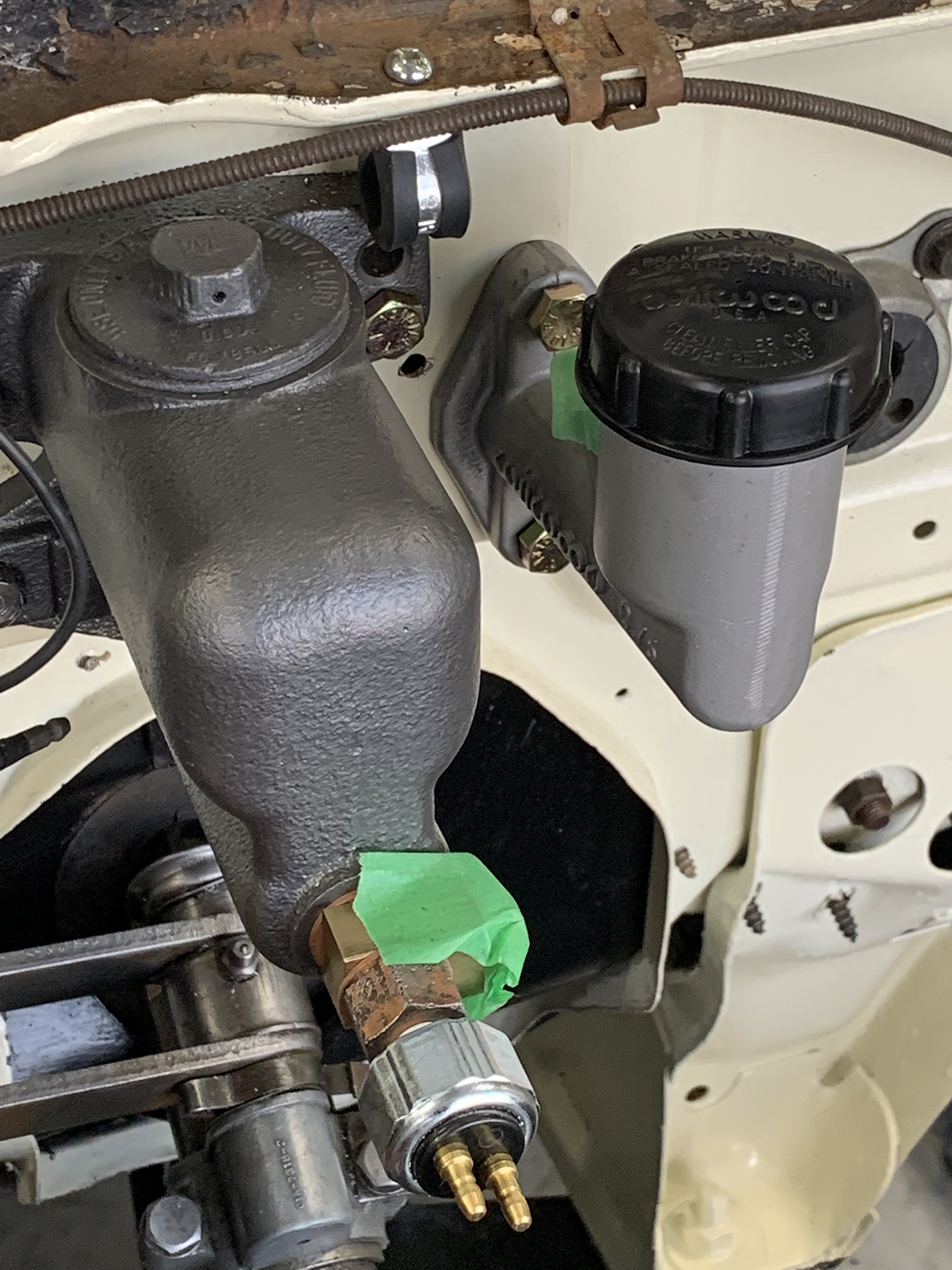

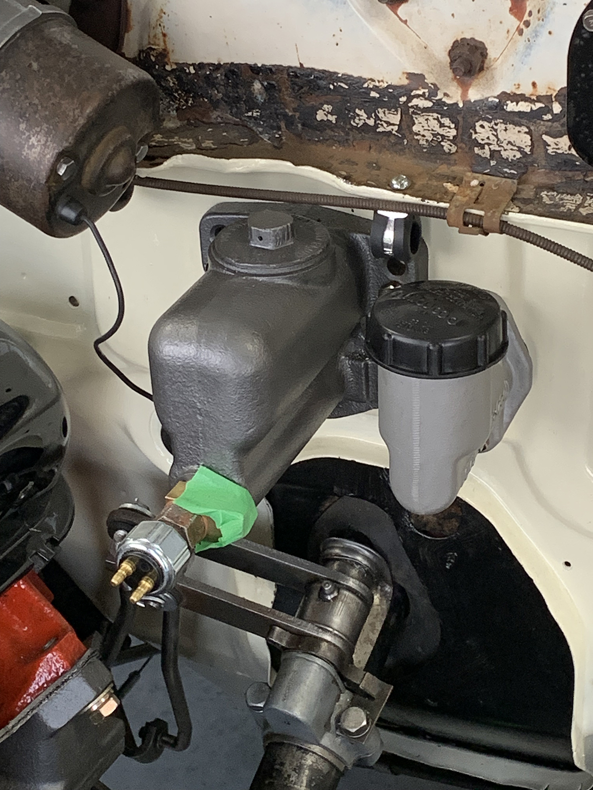

    So the clutch master is mocked up and working very well.
    A inside cage plate was made with added spacers to fill the faculty creased areas... about 1/4 inch in depth.
    The cage made also ties into the Factory Master/brake/clutch Big Bracket.There is zero flex.
    The pedal ratio is 5:1 and the Tilton calls for a ratio between 4:1-7:1... so we are good.
    Travel on the rod is about 3/4 of an inch... we are good on that level.
    The pushrod on the master travels perfectly back n forth.. no downward travel no upward travel.
    Just a fluid straight shot.
    One thing I would advise.. is on these pedal set ups.. there is a very DELICATE plastic bushing that is in the clutch/Brake ***embly(from the factory)
    Be ULTRA careful replacing this or using one from an extra pedal ***embly you have.... I destroyed 3 because of age and the fragility.Takes a lot of lubricant to remove or install.I got lucky on the fourth and last one I had....
    No sure of a replacement part# on these.... but... they must be common.. I can't see Ford have 10 different ones in the late 50's..... I have a sneaking su****ion that it was a universal part in Ford inventory.
    What that is... no idea...... yet.
