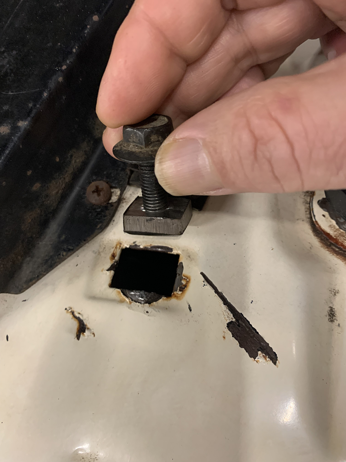

    Another small update.. but trudging forward.
    On the cowl of these 57's was a cage nut to secure on the left and right... the purpose was a point to attach your fender and used for fender adjustment.
    very poor design, 80% of the time when you would go to remove the fenders..... (and we are speaking an old crusty car here) The cage nut would simply twist away from the body and snap off.
    It was designed in such away you cannot weld another cage nut from the inside of the cowl....(it's sealed.)
    Mine are both missing.. left and right.At first I thought is was so important to have a moveable cage nut to adjust the front fenders ... not so.... the fender tab is very large and adjustment comes from there.
    So had some small chunks of metal made threaded fine and will spot weld them into place and hit a dab of paint over top.
    ***Note***---- There is zero Horsepower gain from this post.
    hahahah

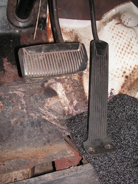

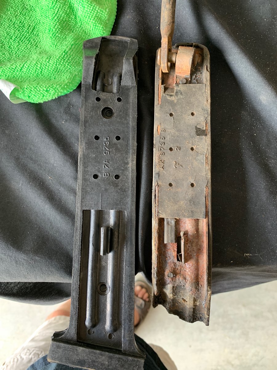

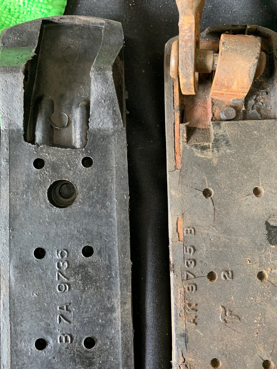

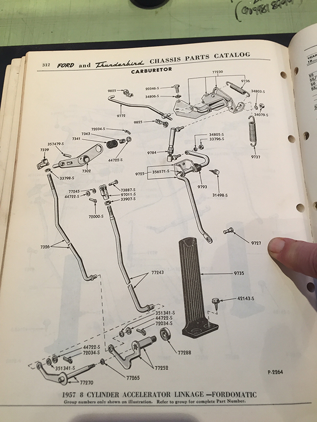

    So... I am moving on to install the G-Pedal..I covered it before with explanation on my other 57 thread..... so, Just gonna cut n paste it here as well...
    So.. motoring away on my build and crossing things off my list, I came to the point where I was now ***embling the Gas Pedal.
    Wanting a stock pedal, in stock portion.. it seemed like a simple install.
    Not really.
    After examine an old rotted pedal with linkage... the Repro's are nothing like OG's.... I remember my friend Gunther(From Austria) at some point speaking to this issue.
    I looked at the old ***embly and the new repro unit..... completely different.I ***ume many of you know all this.. but I had no idea.

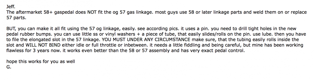

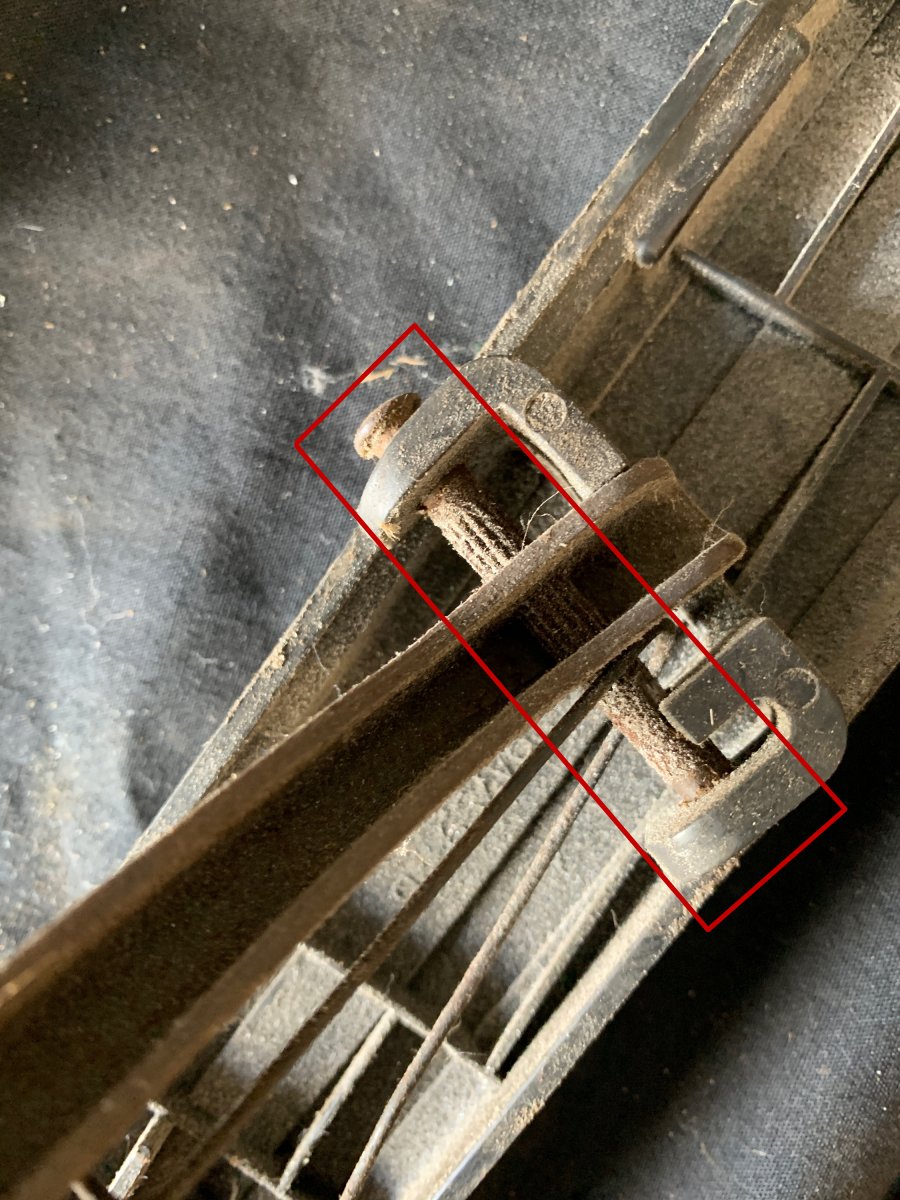

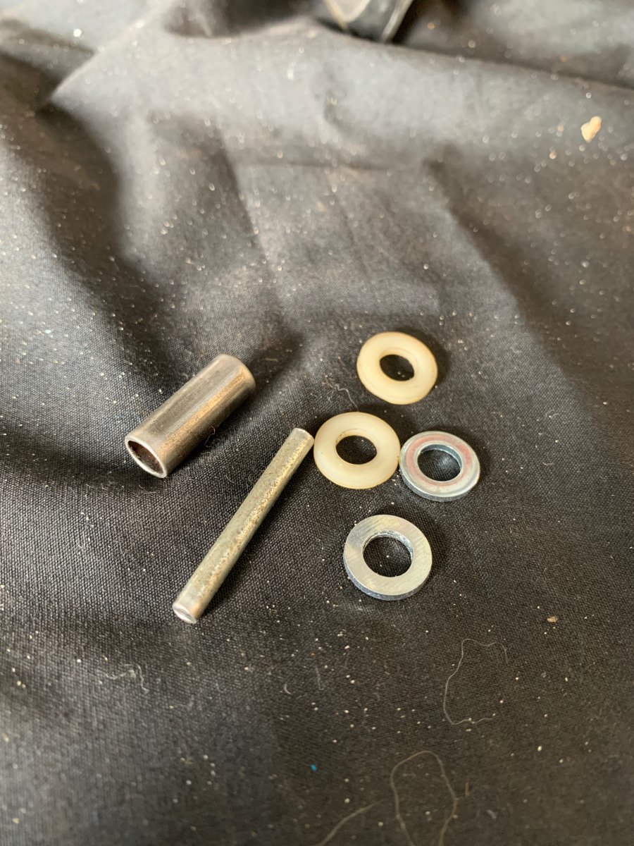

    So I crafted a quick email to Gunther and he provided a email within an hour with his solution...... simple and straight forward.....And with pics!

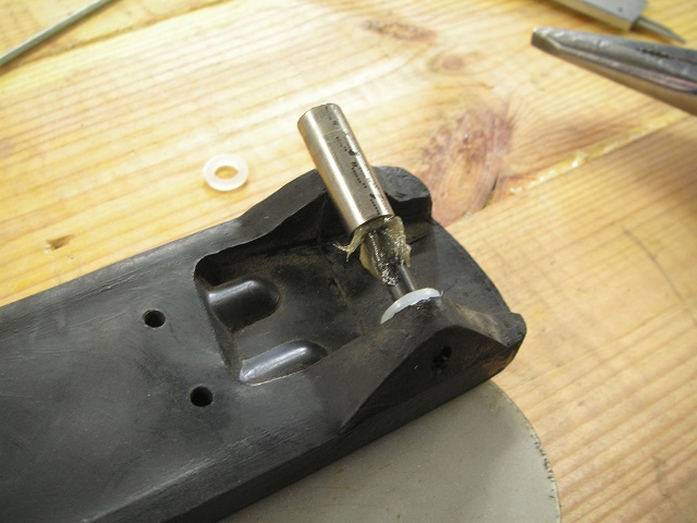

    After a few minutes.I gathered up stuff in the shop to do this..... I made a rolled pin to size but then looked at the old 60's, 70's unit that was in the car.... I saw a rolled Knurled pin that fit the 3/8's tube I was using perfectly.I like this knurled pin, due to the fact there was less chance of it backing out over time.But i tend to over think things.....

    It all worked out very well, and you need to take a rat tail file to the linkage area that the tube p***es through so there is no bind or catching......
    The whole deal took an hour to do but it really to the guess work out of what should be a simple install.There may be other solutions out there but I really want to thank Gunther for taking the time to lend a international hand..... instead of myself destroying a Reproduction gas pedal..... I think that what really bugs me is there are no instructions or solutions when this part is bought.Nor is it anywhere close to an original design.
    Anyhow.. some may have done this a different way or simpler.... but Gunther came to my rescue and the issue is solved.
    Hopefully it may help someone else in the future...

  29. my car was built in august of 57, that first pedal looks like mine, and its original.
    Thor1 likes this.
  30. no firewall rot for me, only the foot pedal fell off, and the rear floors arent very good.
