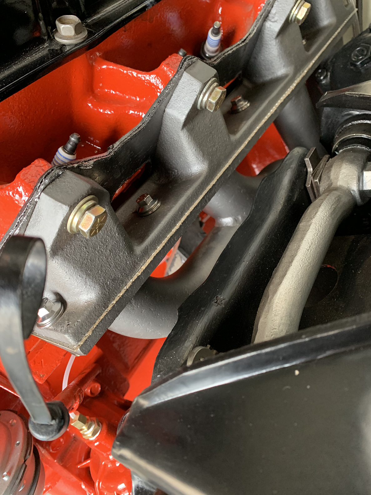

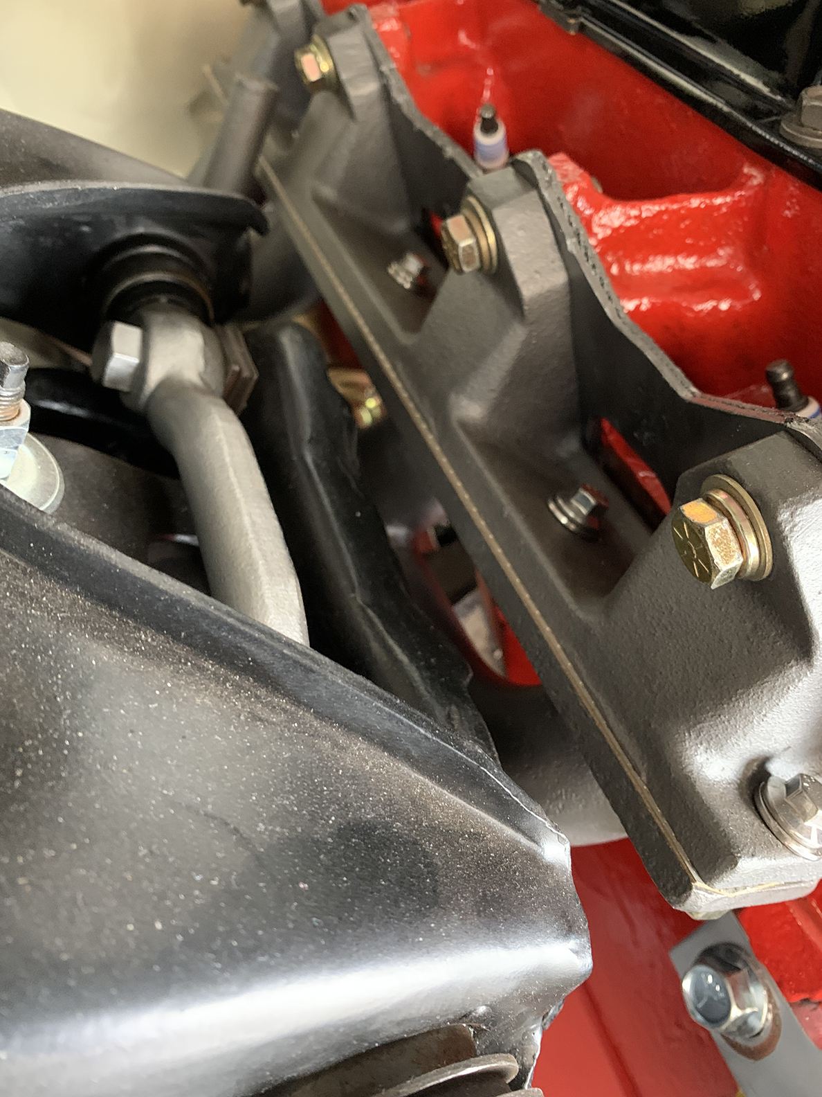

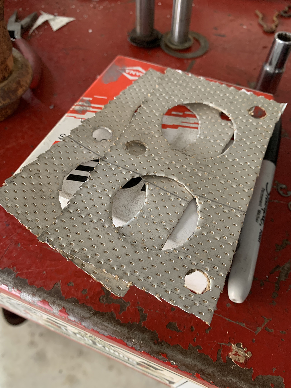

    So.. finishing up the headers,.... with Gaskets and tying in the collectors.
    Since no gaskets were available.... I located some Felpro exhaust gasket sheets, made a tracing of the pattern I needed,... and carefully made my sets....Using tin snips and slowly cutting the patterns,. I made 2 sets... keeping a set on the wall.. just in case.... ya never know.
    I did have the flat surfaces of both the headers, collector surfaces machined, to provide a good mating surface.Since these things are a 2 piece unit... I have taken all the steps for (hopefully) no leaks.
    I also (on several recommendations ) used Remflex exhaust Gaskets.... Came highly from a lot of FE guys.
    In the past I have used Por-15 Exhaust heat paint.... let them cure naturally, then the engine will cure them.... I have had way better results than any VHT product...
    Also.. when sandwiching and tightening the pieces together, I use the copper gasket maker.... again. always good luck with that stuff.

  21. That Ultra copper is good stuff.... It does take heat to cure properly, but I've never had a leak when I've used it.
    The guy that turned me onto it used instead of gaskets on a hobby stock with a heavily ported head, said he never had a leak.
