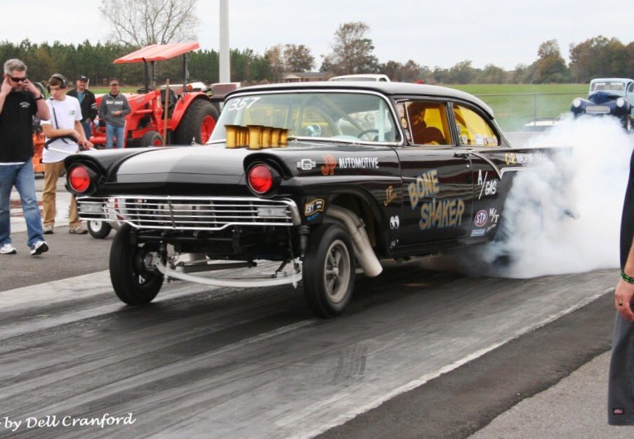

    That must have been a concept car from Ford of Canada as it has an early “flow-through ventilation” windshield!
    SAVE that grille...

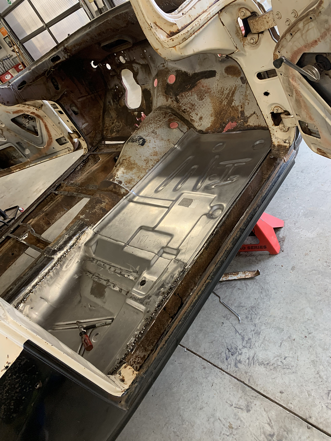

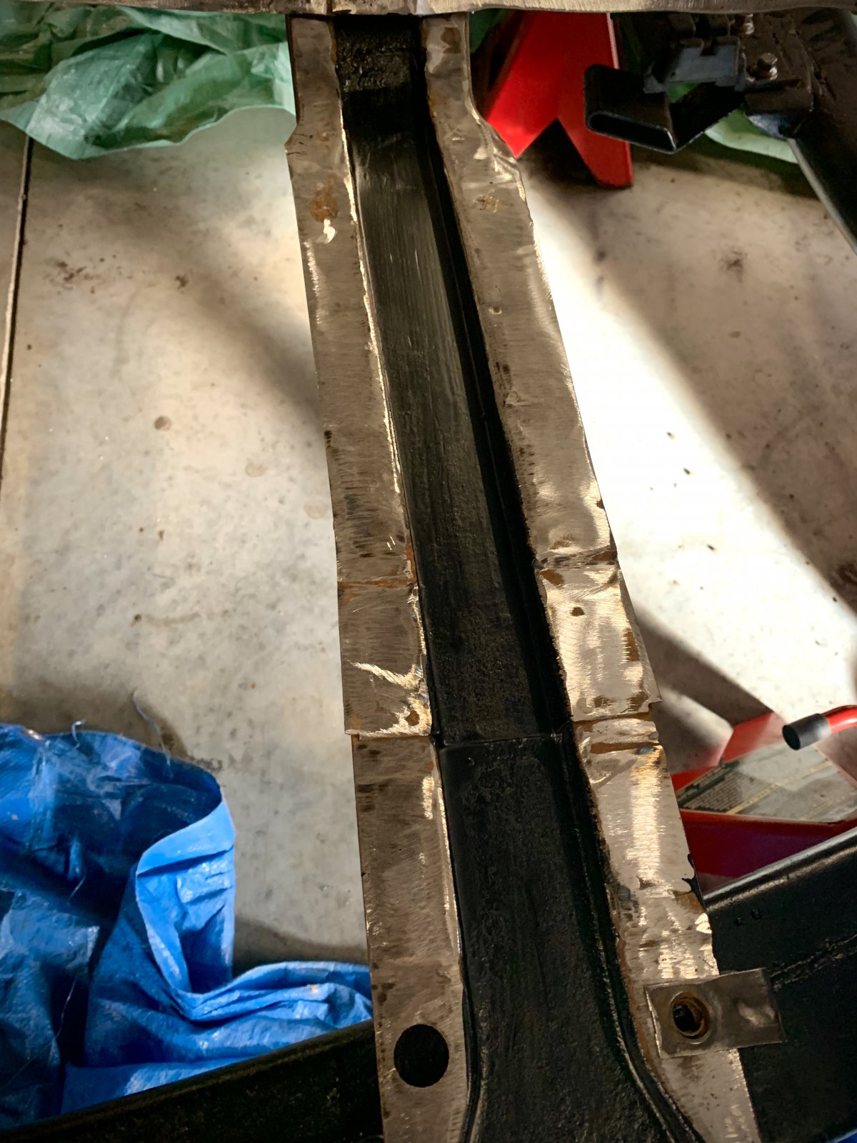

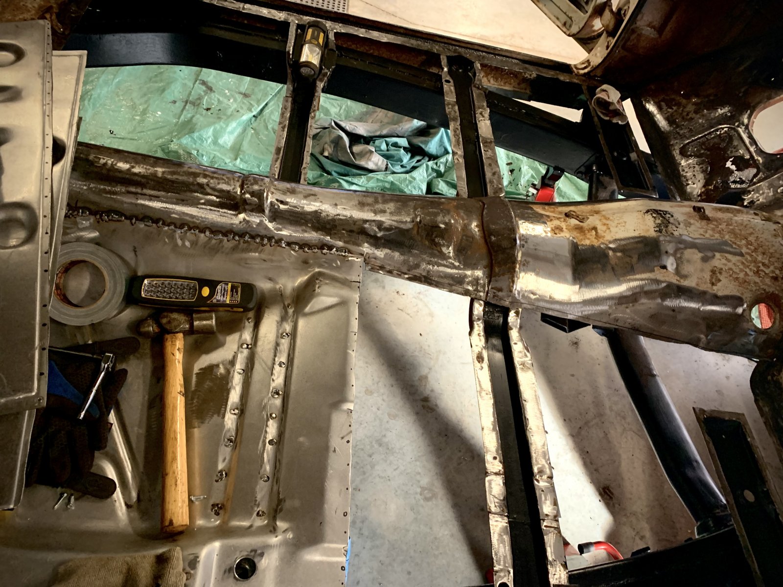

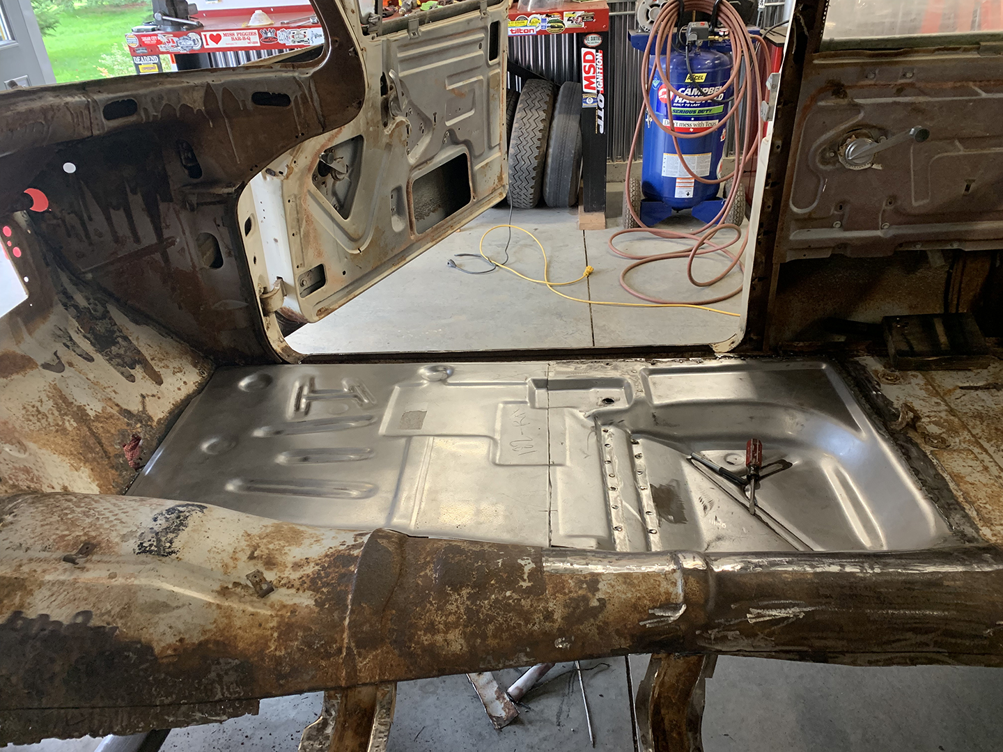

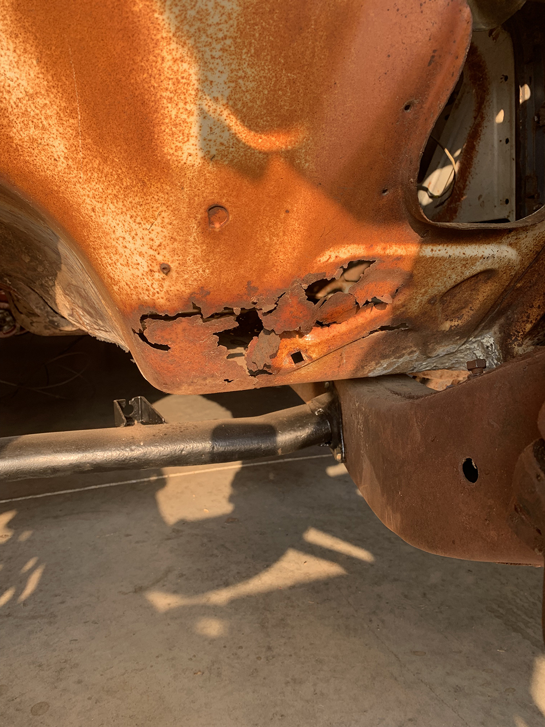

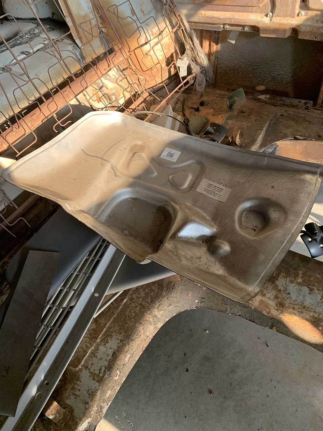

    Getting into the nasty dirty job of the floors..... just cutting, fitting and removing **** from 60 years in the channels and floor areas.The EMS pan and panels are the best. They fit very well.Some small rot, which is being fixed..... all in the customary problem areas of a 57-58 Ford.
    Pushing forward.

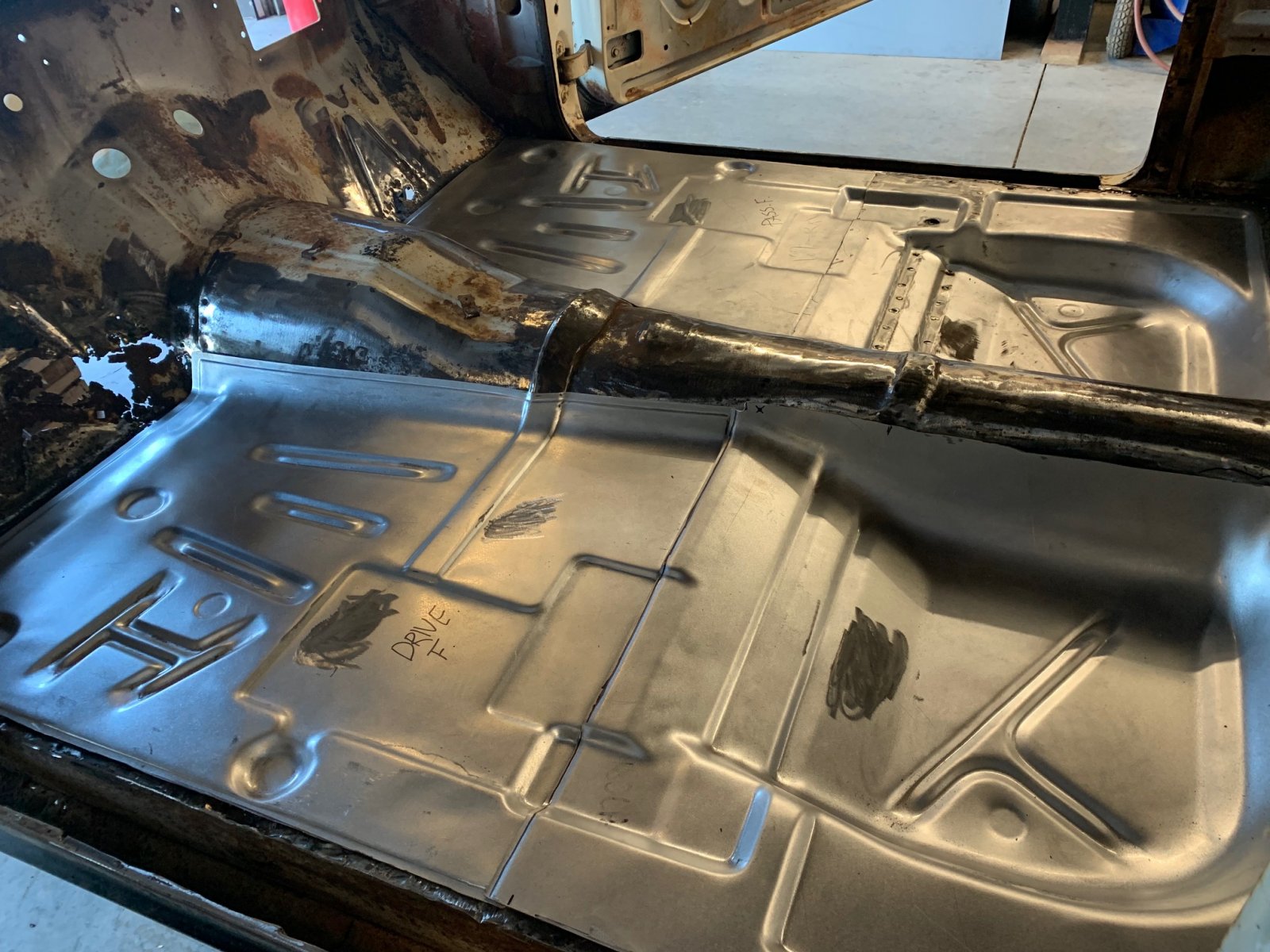

    Got the floors fitting to a good point.... now I will pull them off and paint the channels and frame sections with a garden variety of rust paint/protection......
    I have the left toe board... but may have to order a right... Unless I can cobble a small section in.....
    The left toe board is the worst... but its only a small area.
    Things I do in the evenings. ha ha ha.

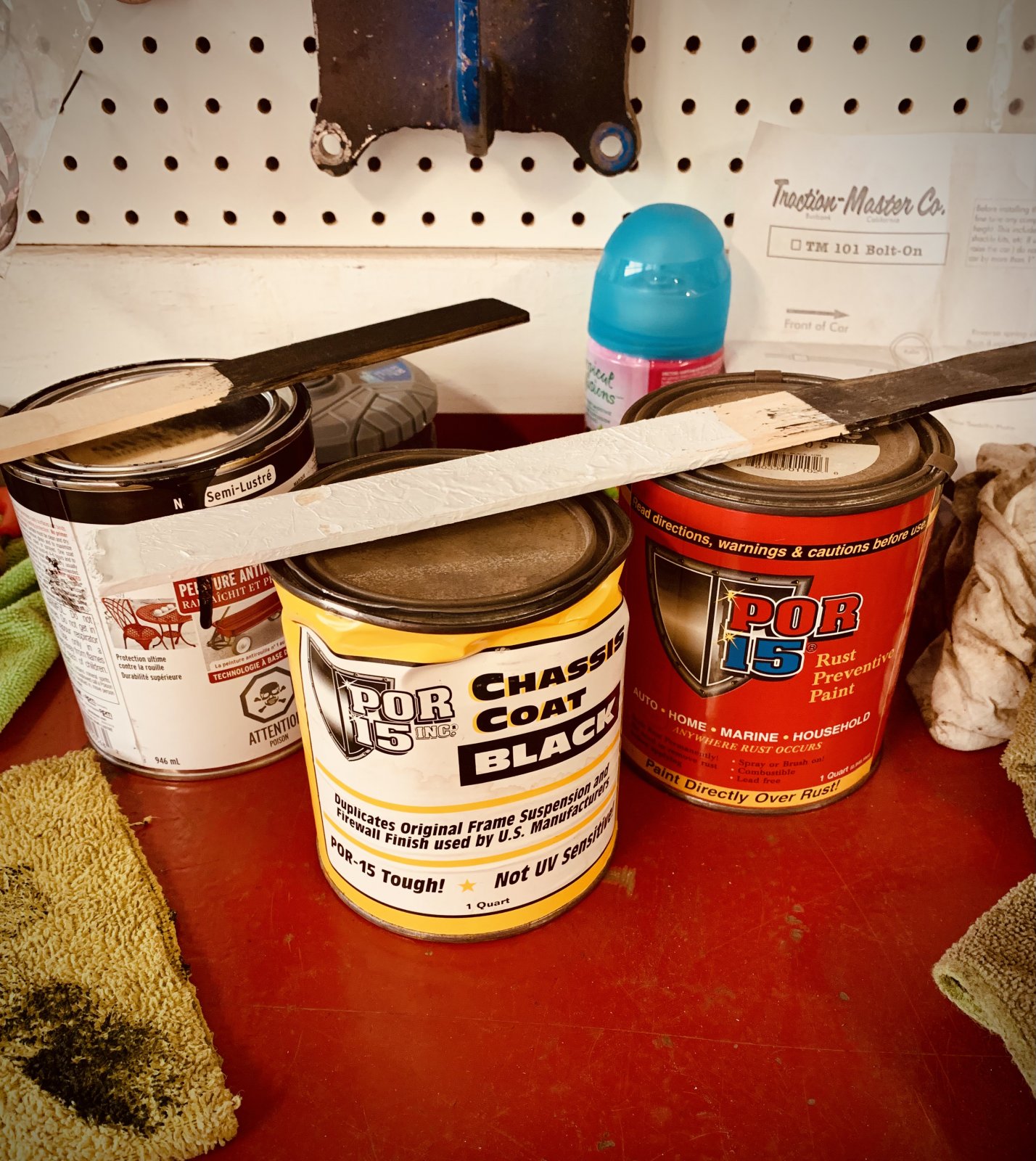

    Well… I do have some more progress… boring as it may be… but I feel necessary….
    The floors are all fitted and ready to go in for some spot welding… but now that the old floors are gone… it was the chance to clean and protect the inner channels and floor braces…they were packed solid with dirt and ****.
    Cleaned out and then prepped and painted the the inners.
    Also cut the rocker tops off and did them as well.
    Must have been 3-4 inches of garbage in there
    57 Rockers are nearly always destroyed…. These were very decent.also got the complete frame finished up as well. CB611994-4AE6-459A-99F4-8300021AFD73.jpeg D0E508FB-C0D3-431A-B209-572F12375A49.jpeg F93CCB8F-8065-482D-A077-6D98D51AFDF9.jpeg 5F8EF011-4CB8-4FE2-A159-AA46E31A3B35.jpeg
    I was surprised.
    I used some Por-15 in conjunction with a rust paint.

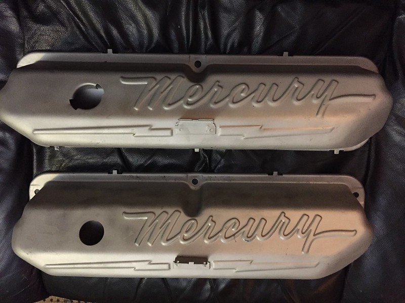

    BTW…
    Anyone holding a set of these… DM me… looking for a set.
