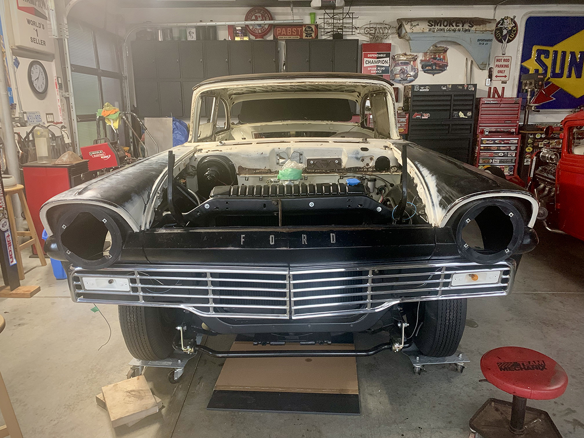

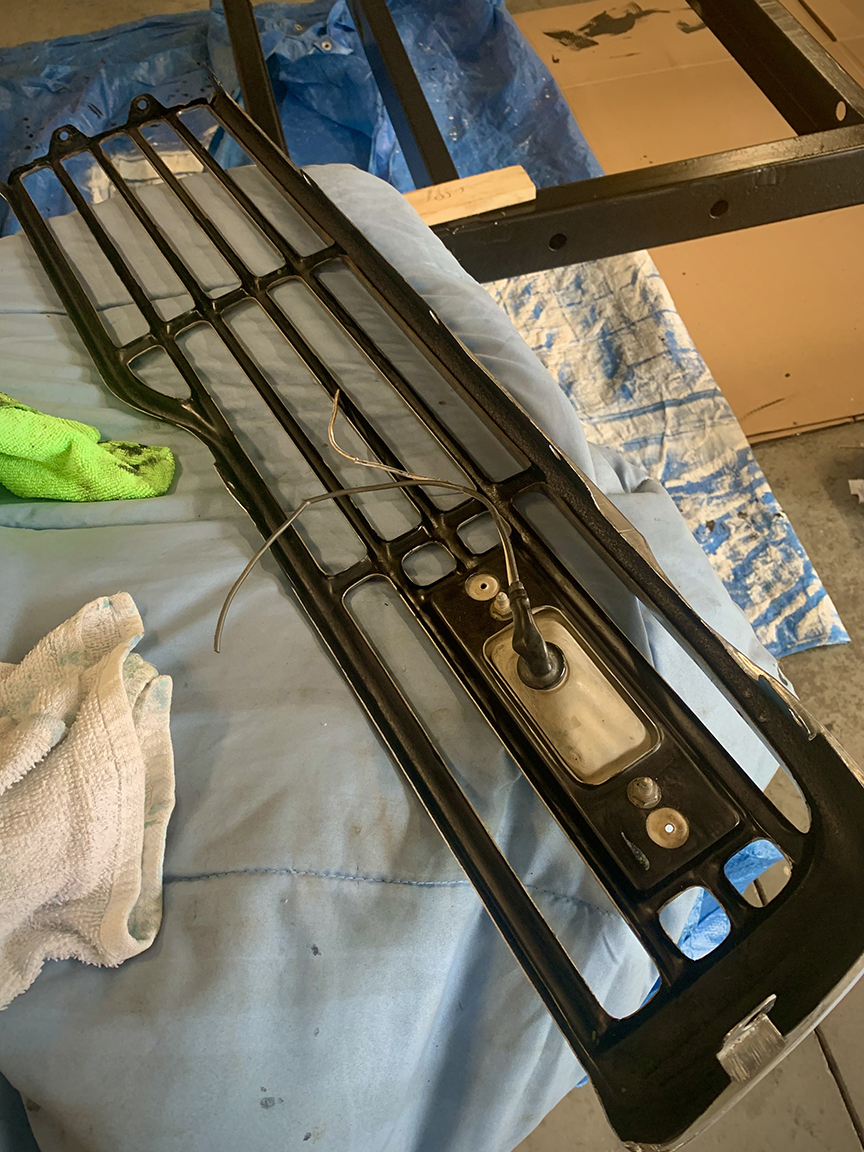

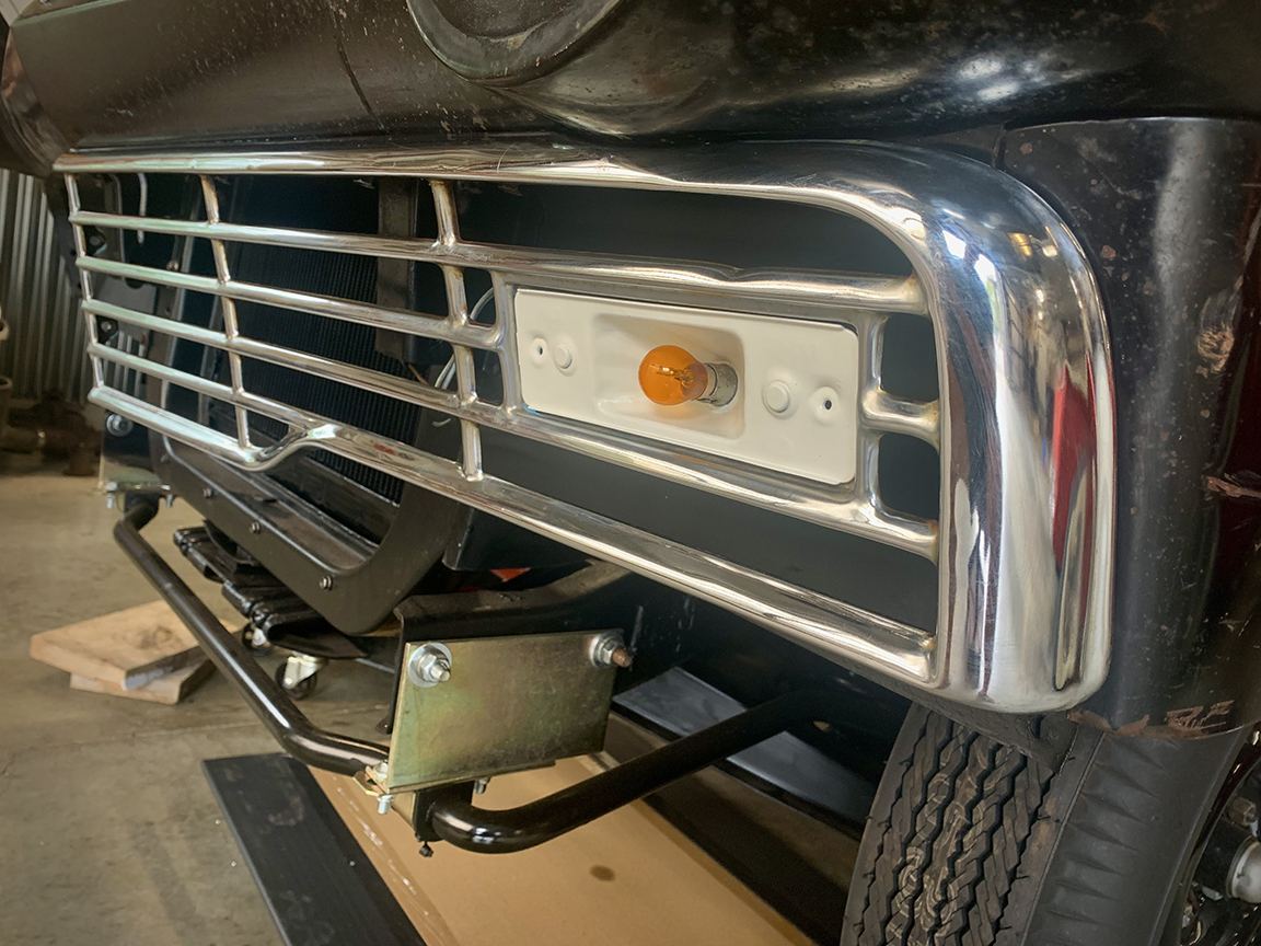

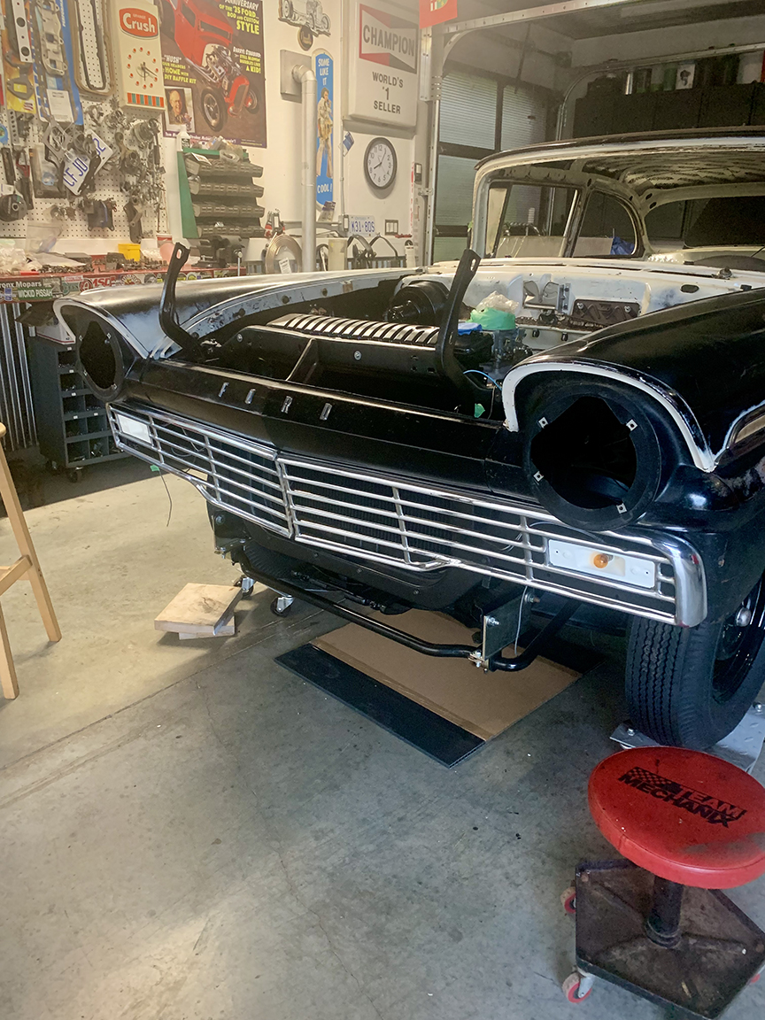

    Well. got a bit of progress done over the weekend. but not as much as I wanted.Fell off a mountain Bike...... bruised some ribs... I think.
    .....but I managed to fit the front sheet metal a bit better for fitment, the cleaned up the old grill.... Its just a good driver quality...
    Hopefully I can get a bit more this week.

    It’s about damn time!! Lol. Good to see you back on it, take care of your ribs, we aren’t as young as we used to be….

    Man, I'm not much of a patina guy but this one looks pretty cool with the current paint colors and fading...etc.

    I really like your front sway bar. Is that an aftermarket setup or something off of another car? The factory 57 Ford sway bar is a joke, it's practically straight across. This one looks much more robust

    Thanks Joe.... Yea..... Factory Fords Sway bars are a joke.I threw all of my OG's to the s**** pile.
    This one is the second one I have and they improve steering and front stability by 1000%(Now both 57's have them)
    I can't say enough about them.
    Otherwise,... it's like steering the Lusitania.
    I used this one. the biggest on the market.... 1-1/8 thick. compared to the weenie 7/8 factory one.
    20 minute installation.... probably one of the best things you can use on a 57-58 (and 59) Ford.
    ADDCO makes one. but not a big as this......
    I got mine here...... worth every penny IMHO.....
    https://www.larrystbird.com/product/front-sway-bar-kit-5758-1-18/

  12. Good to see progress. I'm not sure where you're at on final hood adjustment. You may have already done it. Thought I'd share how I do it just in case. I leave the grill and lower panel off, so I don't have to loosen and tighten the 4 bolts per hinge unit over and over. I put all the bolts in but only tighten the 2 top ones per side to a snug point. I then take 2 of my long reach vice clamps and clamp them as far up as I can on each hinge. Mount and close the hood. Now I can just bump the hinge units around until the Hood is exactly where I want it. tighten the other bolts good enough I can cycle the hood. It's usually right where I want it and final tighten all the bolts down. If you have already done the Hood, just mark this down to an Old Guy not paying attention and keep moving on. Wish I was at this point on mine.

    No....I have not yet, But its next on the list.You make a good point.I will probably enlist 2 friends to help.Nothing is set in stone yet.. but the hood... they are a pretty unwieldy thing to do by yourself.... and I am too sore at the moment to try ....
    All fasteners on the sheet metal are just finger tight..... Not sure if I am just lucky.. but everything seems to be fitting very well.

    The grill looks amazing, the one on my car is anodized aluminum and was in great shape. The sway bar helped my car out quite a bit too, same size as yours.

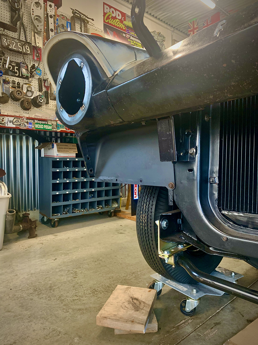

  23. I also have learned that to get the Hood clocked correctly Cowel to front panel the Core support may need to be shifted side to side a bit more than the factory center bolt hole will allow. A little help from our friends is often a good thing. Seem to be a must have on these 57-8-9- hoods.
