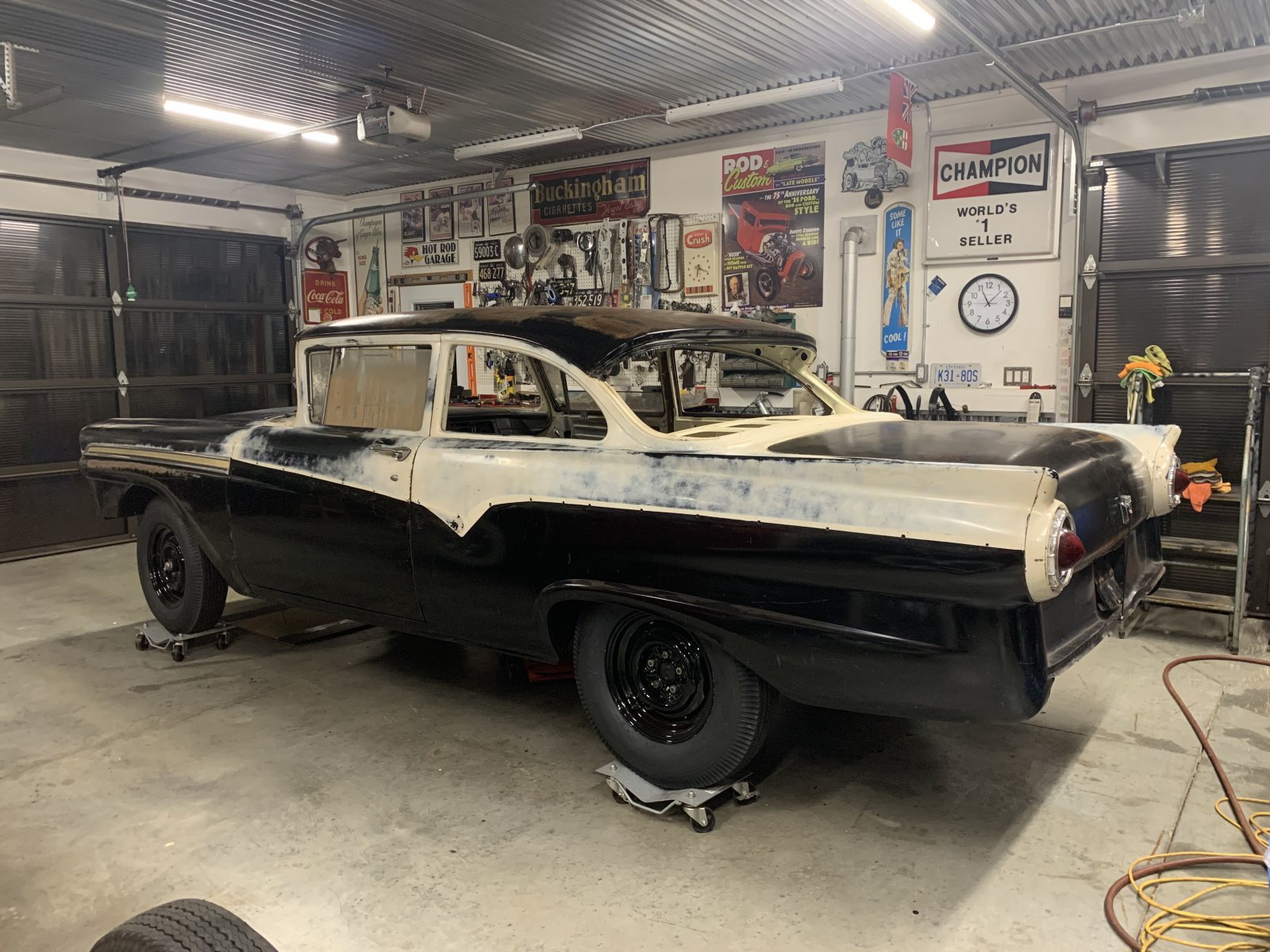

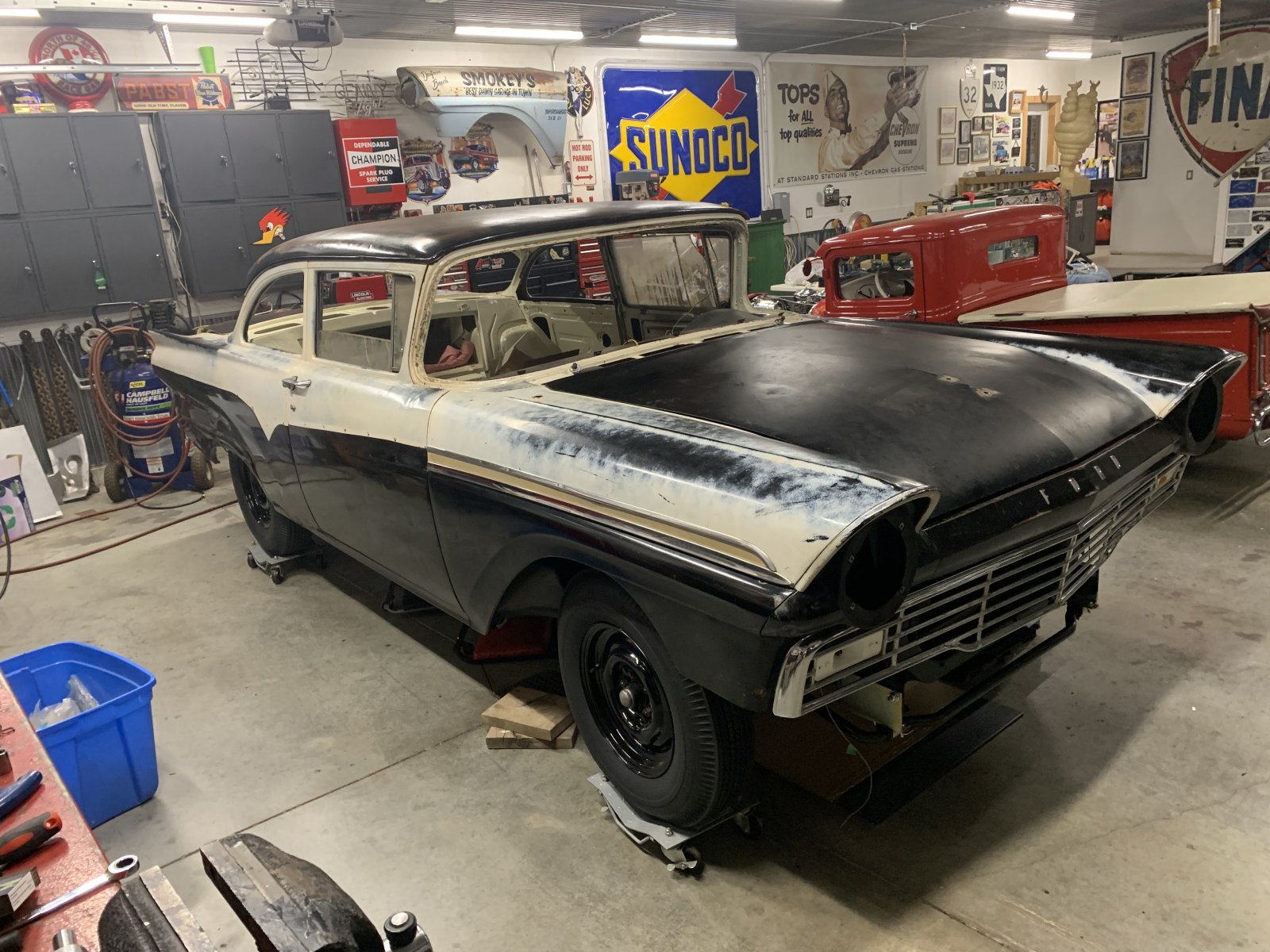

    A good night… my Buddy Terry and my Brother in law, Jeff helped finalize the sheet metal and we trimmed up the hood.
    All fitting well.
    Push forward.

    Yea...... last night was a good shop night... While I had the front metal at 80%.... My brother in Law (Jeff) and my good friend Terry came over ,got the sheet metal to fit very well... and fit the hood.Having 3 guys doing this made it a breeze.
    I will admit I was a bit nervous.. because these hoods can be a real PIA.
    But after 30 minutes....the hood was on and fit so well.
    I mentioned earlier about using a 59 Ford hood latch earlier. Wow.. they are so much better than a stock unit..... a 2 finger close!.... I think I was more happy about that than anything.
    So. yea. very fun and productive garage night....

  9. what is that stray wire i see? might wanna look at that. also, is it just me or is part of the front sheet metal missing...

    Uhh..... dude, the car is being wired at the same time.... just wiring that is hanging for the front lights and turn signals.
    all is fine... thanks.

    Great hood/fender/door alignment, nice grille, standing on new rubber, and you noticed a stray wire????:confused::)

    There doesn't seem to be headlights in there either. Might check on that too.
