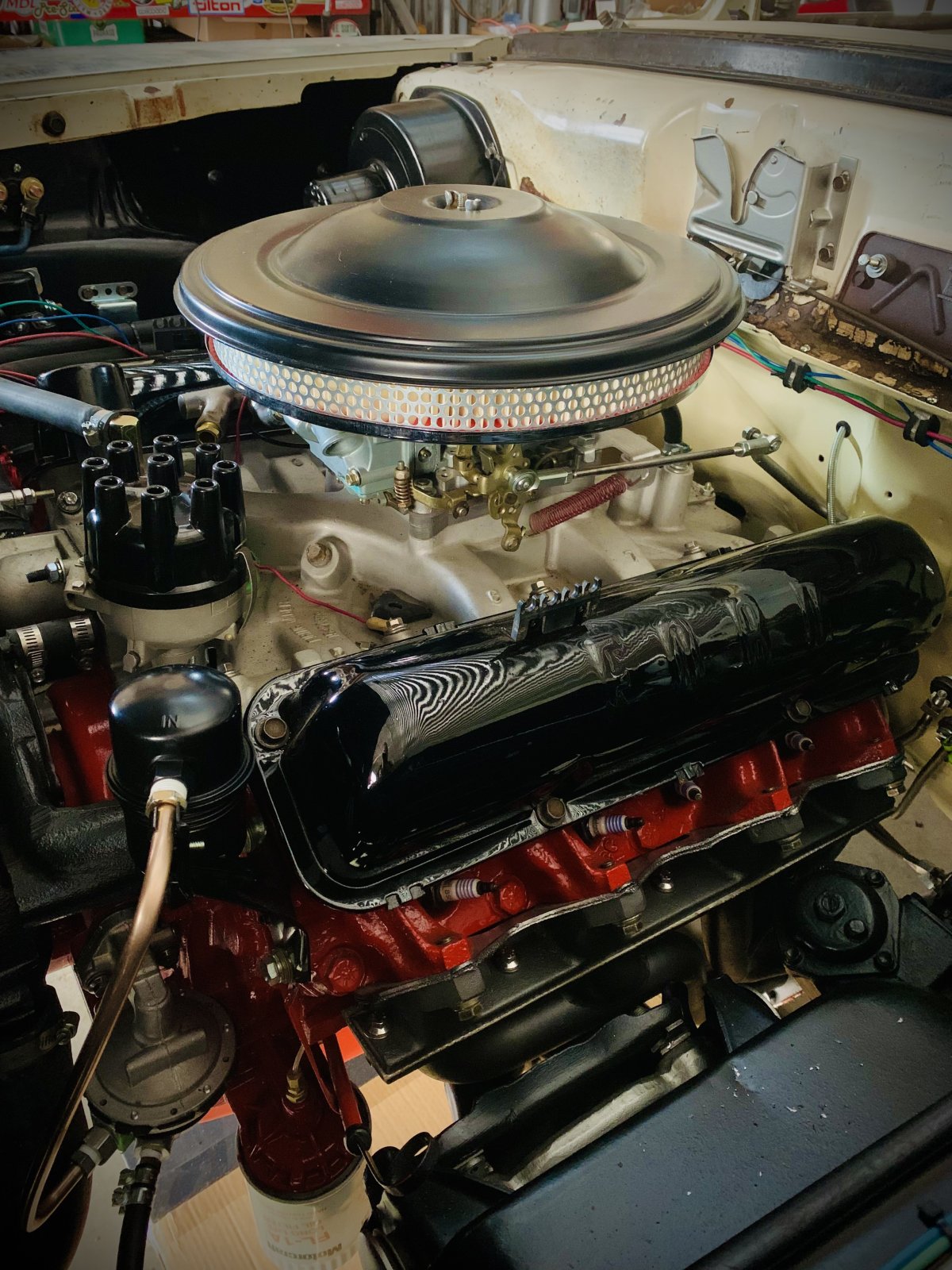

    still wiring(takes me a long time)
    need some small welding on the rear tail-pan/trunk floor area.

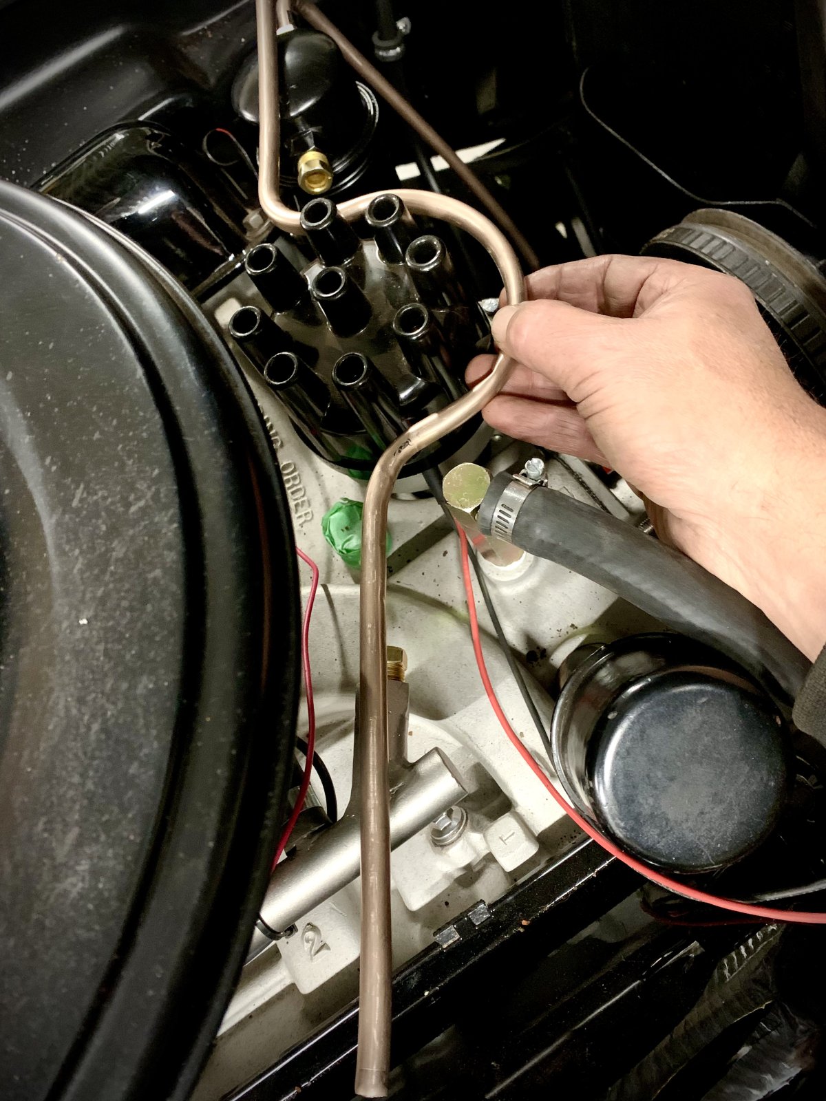

    finishing up the fuel system.... bending 3/8 lines can be a real PIA.
    Found a Ford hi-po air-cleaner (free is good)
    Changed over to a 59 hood latch..... such a better unit than a 57-58. the hood locks and shuts with 1 finger... instead of a slam!
    Yea.... we be rocking.
    After Thanksgiving I shall hit the gas again.

  18. That air cleaner has to be about as rare of a Ford part as there is. Your car has become something of a "community" car and that's not a bad thing. :)

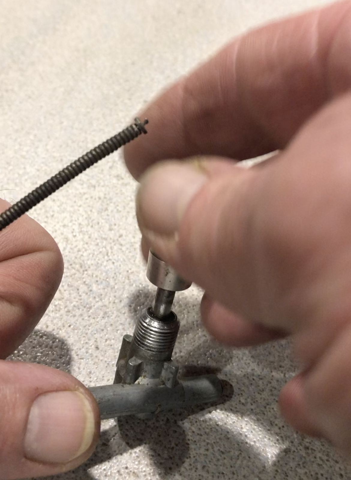

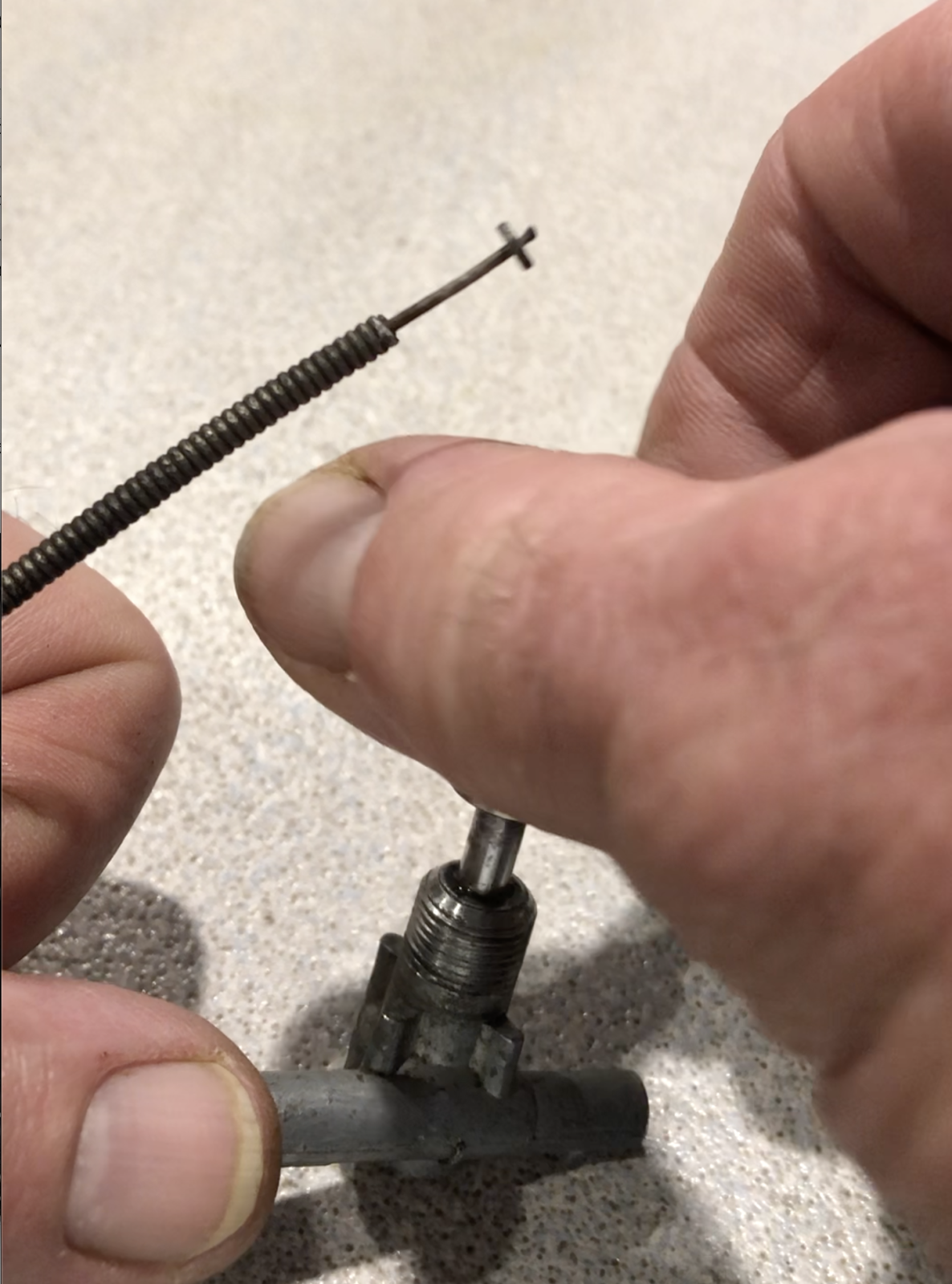

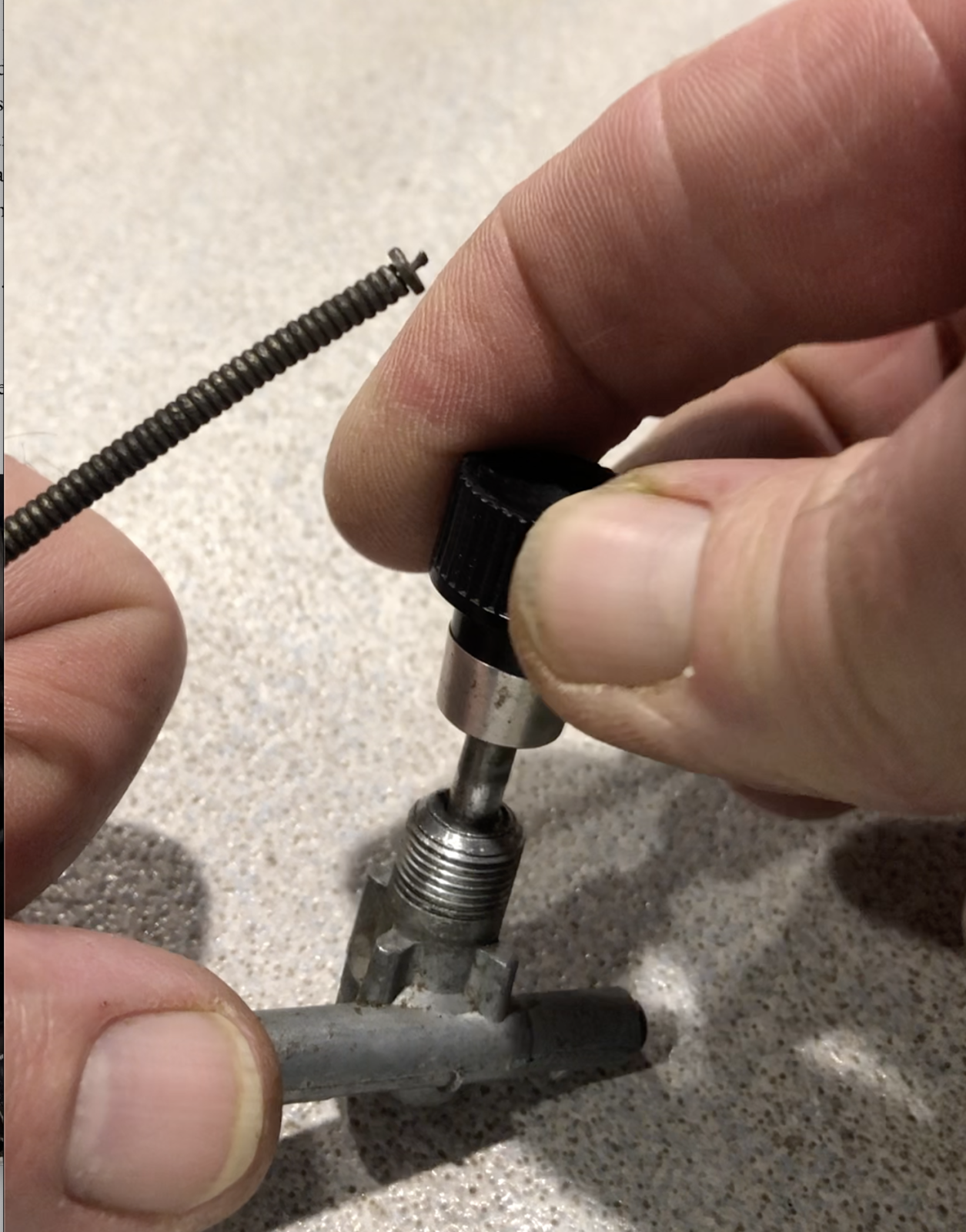

    Oh yea....... there was on other accomplishment that was achieved ....... since I am using a 60-61 ford electric wiper(yes. they fit)... the wiper cable switch was frozen..... I tried for 3 weeks to get it freed up.. dipped in oil for 2 weeks.. nope... WD-40 and Fluid Film coatings..... nope..... a muriatic acid dip..... nope
    The very small cable runs through a coiled sheath.... and the end(about 4 inches at the end) was seized....(rust)..... I mentioned it to my buddy Terry .... a Ford Tech.... and that guy after an hour had it working.
    I love that guy..... I hate that guy.
    ha ha
    I just wasn't gonna spend $150 bucks on a cable switch.... so..... it works....
    you need to be super delicate with these cables..... the little disk at the end needs to stay on the thin wire..... if you break it...... the unit is useless.
    anyhow.... yea.. happy ending.

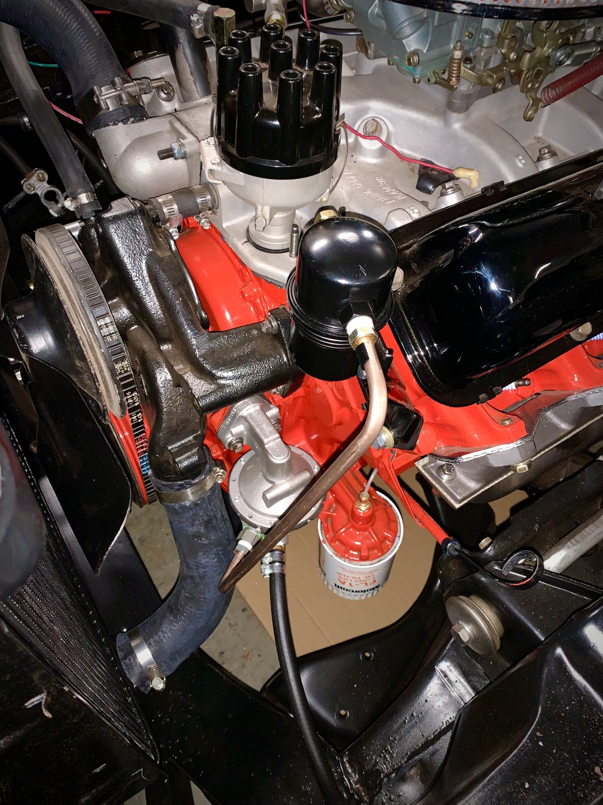

  21. that is a beautiful fuel line and filter setup!
    i noticed how the FE and the Y block seem to be quite similar in some aspects and very different in others. such as the small hose connecting the water pump and intake. by the way, for an FE swap do you need a ground strap from the engine to the firewall, or is that just a Y block thing?

    The FE was the next step after the Y-Block... both share some same characteristics ..... and yes.. I grounded the engine in 3 different areas.... the engine to the frame, the engine to the lower firewall and a ground from the engine to the battery as well.

    I was looking at this thread a couple of days ago and almost responded asking about progress. I didn't 'cause I didn't want to be a pest. However, now that it's reactivated I'll chime in. Thanx for the update.
    I bent up 3/8" fuel line on the 283 in Clarence about 30 years ago (I know; who needs a 3/8" line on a stock 283???).
    1. I was 30 years younger then
    2. I had 30 years more patience then
    3. I had more arm/hand strength then.​
    You did good on the fuel line; it looks great.

    Yes @atch ... patience is a virtue...... and I went through about 4 tries on that 3/8's line... yes,I know there are really fancy tube benders out there.... but I used a small Hemi crank pulley and an alternator pulley to make my bends....
    the groove in each pulley works easily.... bending the smaller lines... is quite easy.... the big stuff..... not so much.

    Jeff , the lines came out great! It never crossed my mind to use different size pulleys for bending lines, but that just makes perfect sense! Next time I´ll need to bend hardlines I hope I can remember your pulley trick... probably not:D

    Isn't that air cleaner lid the same as what the single 4 barrel '57 Thunderbird used? They were being reproduced in chrome back when I worked at a T-bird only restoration shop. I could be wrong but it really looks similar.
    Glad to see more updates on the car. As long as it keeps moving forward, eventually it'll be done.
