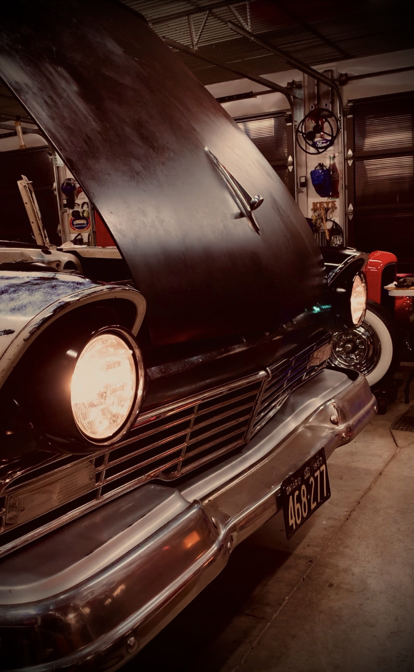

    Again.... not anything exciting but the wiring is nearly complete... about 95%.... checked all the circuits and we have life flowing through this old girl.
    Checked and working, brake lights, turn signals,Headlights and park lights, fan works, hi n lo,... wiper motor works well and is a 2 speed, with a return park.Engine cranks very well and the starter engages smoothly and well.
    All that is really left is to hook the horn connections and dome light. Very straight forward and I am happy.

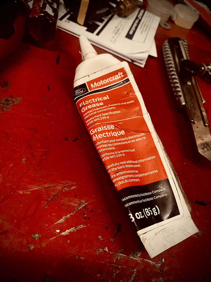

    Always learning about things. and that is conduit grease,... I had an issue were the front signals and rear turns simply were not functioning, of course I started to doubt my work and a pal of mine Terry swung by and helped me look into it.It turned out that the sockets of each bulb were super dry... not making a proper contact... so he asked if I had any of this conduit grease.
    I said yea. lots.. and handed him a tube of di-electric grease....
    Nope,... don't use that.... need conduit grease.. different animal.....
    So he told me to drop by his work and pick some up... solved everything.Of course I am using 60 year old light sockets... never really thought about it... anyhow... easy fix and I am very satisfied.Maybe it will help someone else.

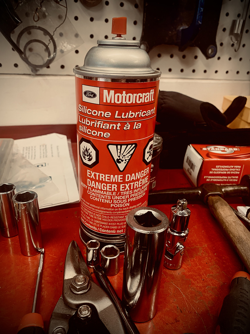

    He also gave me some rubber lubricate for all the door seals and trunk seals.. told me to use it after installation.(that's happening very soon.)

    I wouldn't have thought "electrical grease" was any different than dielectric grease. Good to know I guess. Could you tell the difference? Looking forward to the video on the first cruise, lol. Good job, Jeff.

    I too would like to know what the difference between conduit grease and di-electric grease is. I don't know if I've ever heard the term "conduit grease" before. I'd love to be educated on this one, I'm trying to learn about wiring systems and every little thing helps.

    just from my experience di electric is a thicker & stickier grease, that electrical grease is softer and more fluid.

  22. Conduit grease (often referred to as lube) is for when youre pulling wires through conduit in industrial applications. At least thats what i think you are referring to.
