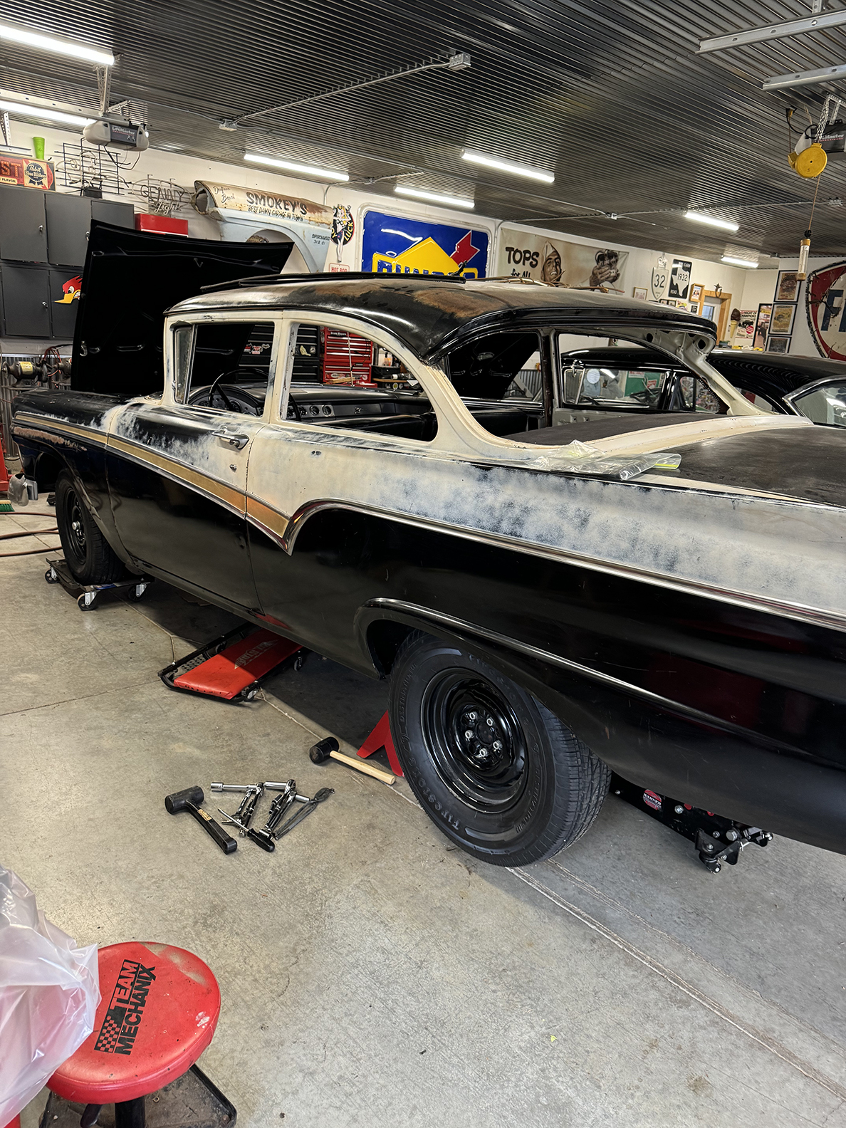

    Been a while on an update on car #2...... but Progress has been revived and moving forward.
    brakes Bled, Fixed the 2 rear brake cylinders with NOS stock units...(they were froze up ),Clutch Bled, but chasing a nasty Thermostat leak....
    I plan on firing this car in the next 3 weeks....
    (Fingers crossed)

  8. ive been curious, how hard is it to replace those window seals? mine are pretty much gone but i haven't looked into it very far.
    my thermostat housing leaks a little bit, and i dont know why.
    cant wait to hear that thing rip.

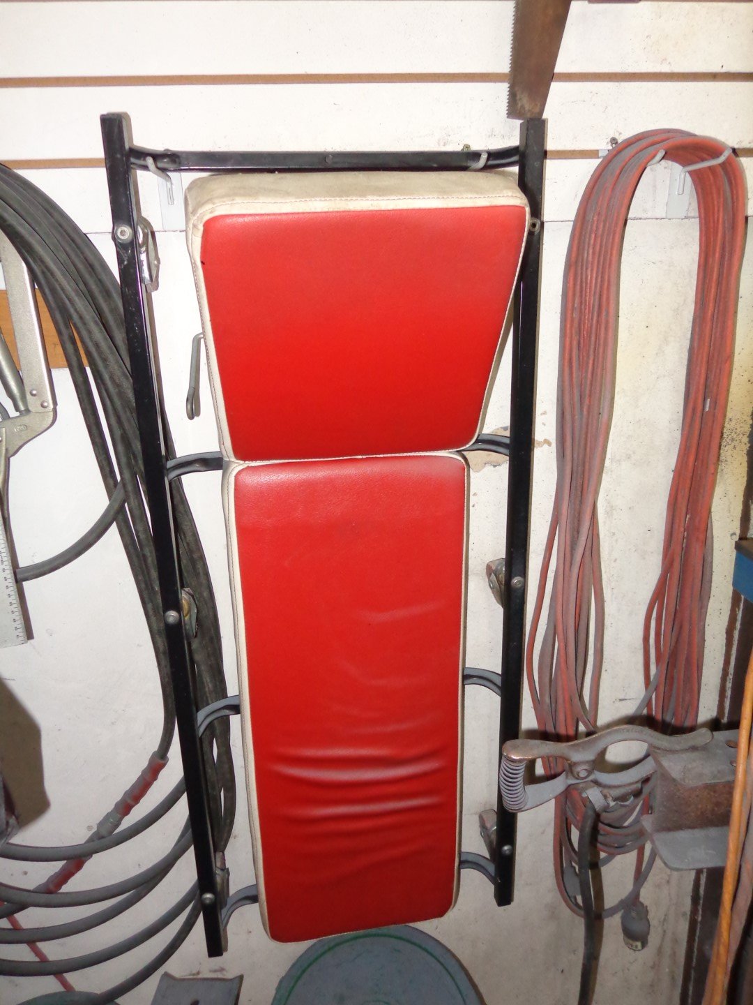

  9. OT question. Why do you not have custom upholstery on your stool and creeper? :)
    Jeff Norwell and The_Cat_Of_Ages like this.

    100% bad ***. I love the look of this car. I can't wait to see it running and driving and parked next to the black one.
    Come out in the morning and be like, "which one do I want to drive today?"...
  11. Jeff Norwell
    Joined: Aug 20, 2003
    Posts: 15,278
    Jeff Norwell
    MODERATOR
    Not too difficult...... just time-consuming.
    You need to remove all the gl*** and window regulators to get at it properly.
    You can get OEM looking window channels.... and all the little pieces.... which I did on the black car... but on this car.... I just went out to the local speedy Auto Gl*** and bought a section of window channel that would replace the OEM style.
    The original channels are fixed in with small biting fasteners.... mine where still all there and I have taken them out carefully, cleaned the them gently and will reuse them with the newer window channels.
    I will most likely bond them in with some kind of adhesive(not quite sure what that is at the moment, but I will research that)
    Also.. on this car. I need to rebuild the vent windows... and replace the rubbers and gl***.... which I will get into in the future.
    To be honest..I am kinda anxious to get the engine to run and see what it will do.
    I bought it as a unknown and hopefully the guy I bought it from was Honest.... it could be a huge POS..... but. we will see.
    I am not really worried as I have another a very Potent FE sitting in the wings that I know is ready to go.
    I will just keep moving forward.

  12. Jeff Norwell
    Posts: 15,278
    Jeff Norwell
    MODERATOR
    Ha hahaha
    I don't know.... I can tell you my shop is not one of them "Man Cave" Big screen TV joints...
    Just an old Radio and a pellet stove to keep me warm.... Stained floors and organized Chaos.
    Nominal, Stogy, Thor1 and 7 others like this.

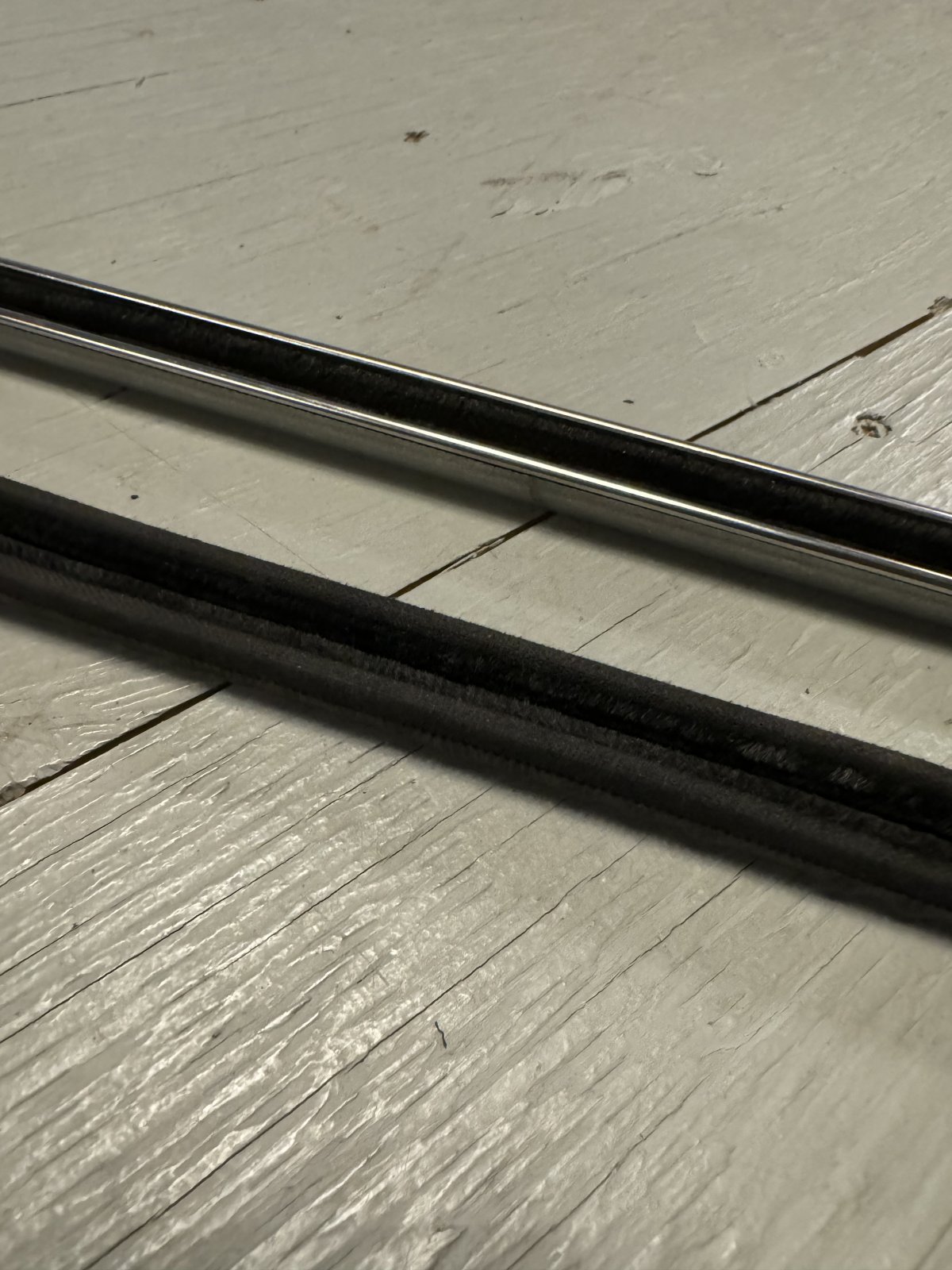

  18. bobss396
    Joined: Aug 27, 2008
    Posts: 18,735
    bobss396
    I went all-in with my gl*** installation. Every s***ch of channel runs are new. The ones I used are known as Y619 and Y620, flexible and rigid. I used the rigid for the vent gl*** verticals only, mine were just over 31" each.

  24. Jeff Norwell
    Posts: 15,278
    Jeff Norwell
    MODERATOR
    @bobss396
    These are the Channel runs I have here in stock....I do not know the names each one is called... you mentioned Y619 and Y620
    The channel run (in the pic) that is all black(bottom) .....is very flexible and very rigid....Easy to shape.Easy to get locally.....
    the Aluminum one is what came from the factory.... you can make tight bends... but easy to mess up.
    On this application.... I will use the all black one.....(hopefully)
    I just am not sure what the technical names are....

  28. bobss396
    Posts: 18,735
    bobss396
    My rigid channel was steel. I recall it being 31.25" long when I made the new ones. I copied what I had onto the new pieces and milled the slots and put the holes in them. I have the sketch somewhere...
    The hardest part was making the 90 degree corner bends in the flexible pieces. I didn't have a lot extra to play around with. I wound up cutting them straight and over lapping them in the door channels. The OG ones looked like they were notched and bent at the factory.
    The hardest pieces were for the rear quarter windows. That took a little thinking to fit well and have the window work smoothly.
