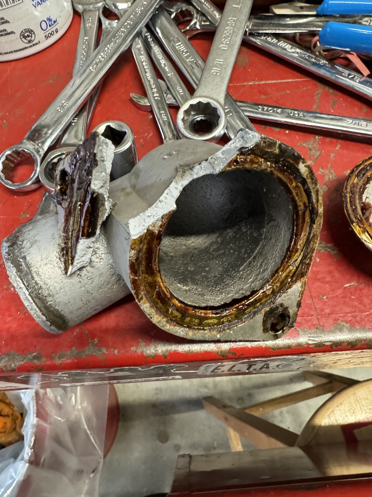

    This is a blessing in disguise. There was probably an internal flaw that weakened the casting. Better to find out now than when you are on the road.
    lothiandon1940 and Jeff Norwell like this.
  4. RmK57
    Joined: Dec 31, 2008
    Posts: 3,119
    RmK57
    I’ve had the same thing happen on a 170 Ford 6. The thermostat sits in a recess in the housing , the problem is it can slide down a hair when you go to install it on the intake. It doesn’t take much to crack a 60 year old brittle aluminum casting.

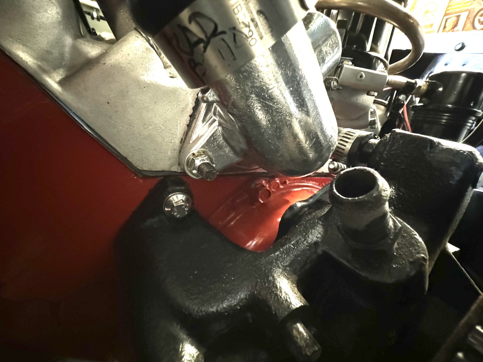

    Well.. that issue is now solved.....
    I checked the PN# on the early housing.... early 65.
    After 58 years of service.. I can't complain
    hahaha
    anyhow... next step is now to fire the car.

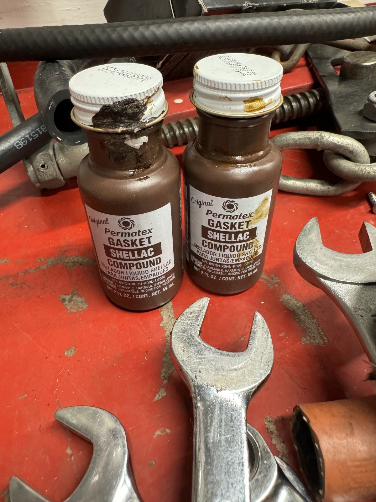

  9. you use shellac for thermostat sealant too?
    Jeff Norwell likes this.
  10. Jeff Norwell
    Joined: Aug 20, 2003
    Posts: 15,280
    Jeff Norwell
    MODERATOR
    Yes. Love it for gasket work... provides a real nice seal in conjunction with Gaskets....

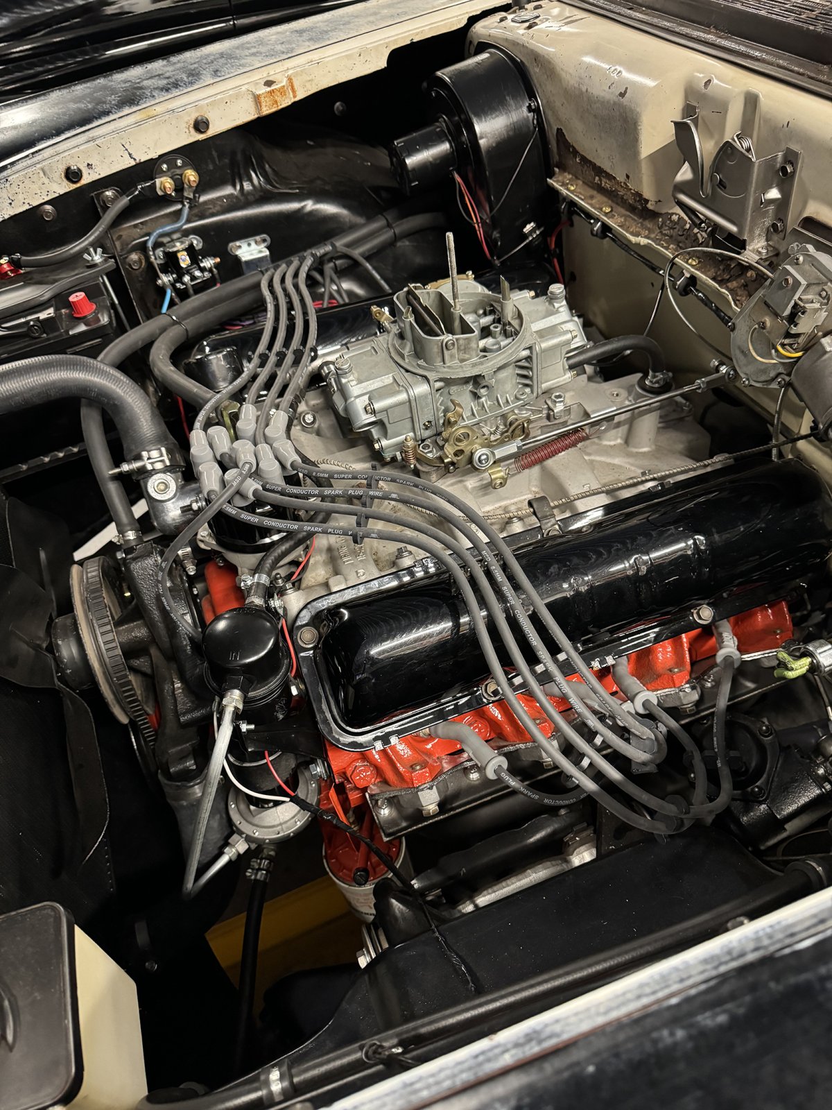

    All was set to fire....
    Power was keyed... and the starter solenoid relay took a dive.Not a big deal...... Using a jump wire.. the engine rolled over fine...
    Then discovered the timing was out 180. Easy.. pull the distributor, back 180, find number one at TDC and back together.
    Did a bit of fuel coaxing,.... and boom... she fired right up!..... the throttle linkage was needed to be adjusted,.... did that.... and then back to the key.
    again . she fired right up.... My pal Terry.... immediately gave me the kill signal..... fuel was ******* out the from the Fuel pump, the Ford Filter at both ends and the connection at the carb.
    stopped all,. inspected the mess.... and realized the flares on the hard lines from the pump, between the ford trash can filter and to the carb.. were poor.
    completely my fault and a lesson learned about them Ni-copp easy bend lines.
    Great stuff for brakes ... not so for 3/8's fuels lines....
    Terry prefers steel lines and now so do I .
    The material is just to soft to get a good flare on large diameter lines.I can't say this is gospel. but this is my feeling.I did the brake lines on both cars.. and got great flares and seals.... but to go big lines and tricky bends.... its a frustrating job(for me anyhow)
    So. the day ended..... Terry left and took the fuel lines back to his shop and used them as templates.... he made up perfect lines.... proper flares and so much more strength.
    All this in a bad blizzard this past weekend with the temps at -24 windchill.
    So.... everything is back together except one steel fuel line.... hopefully we should attempt again. and see what happens.
    I can say(which makes me happy) it when the engine did fire... it had a strong 45 psi at start up.... no misfires.... no strange noises... and no bad blue smoke or danger signs.
    This FE is a complete mystery engine .... so.. In that respect.. it has given me hope.
    And if it does **** the bed and is something that needs an overhaul ...I have a fresh 390 that I know the history on.
    This is a game of Snakes and ladders.
