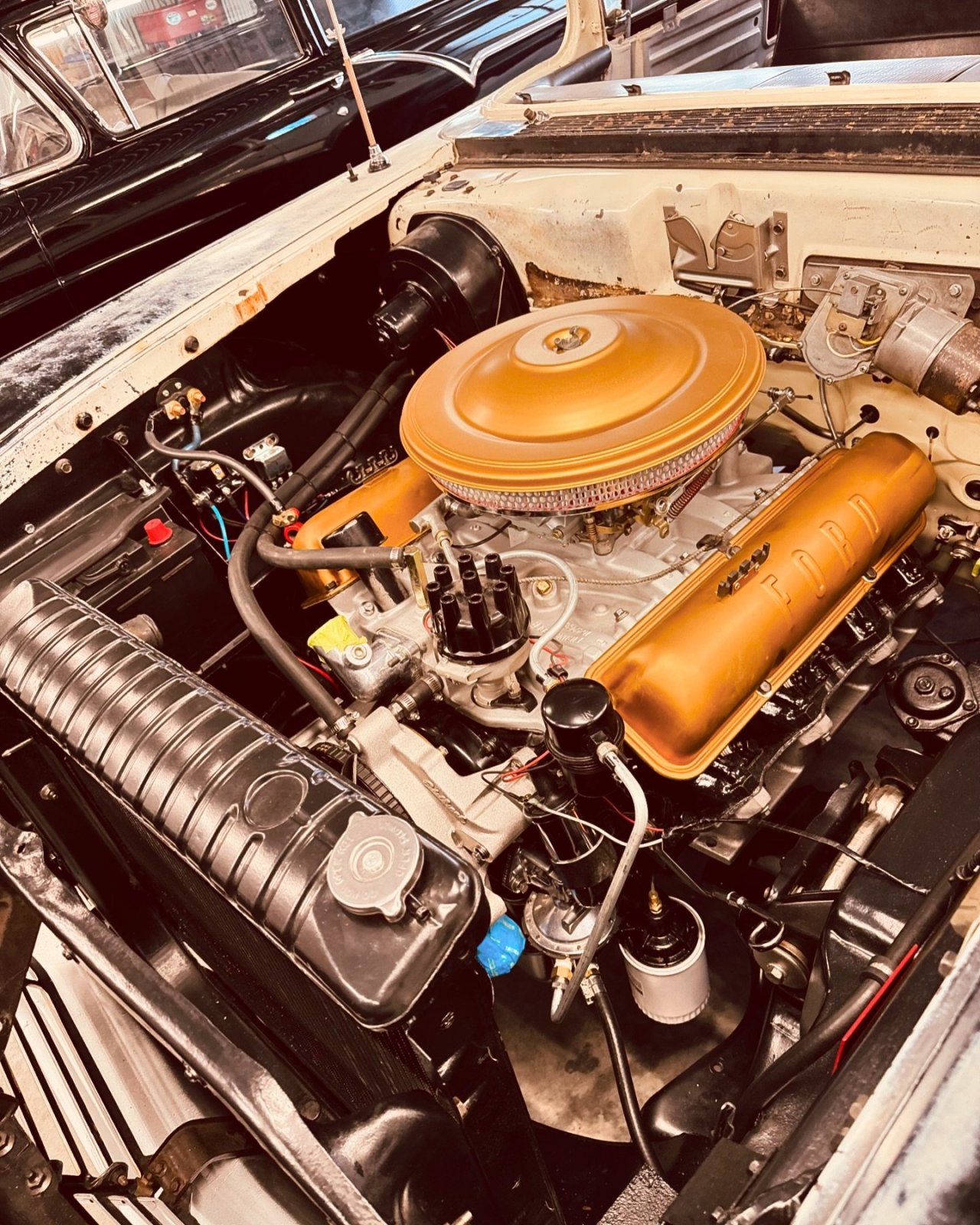

    Did you run the heater hose from the intake straight back over the top of the intake or sideways and then down the inner fender?

    The Latter Tim..... sideways and away from the engine as much as possible.. running along the inner fender to the the firewall heater location.

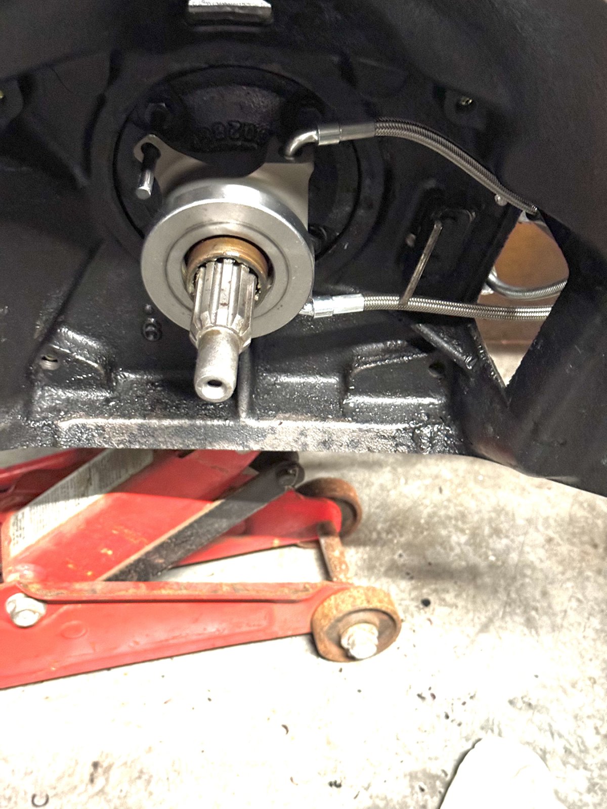

    So.... as the never ending story continues..... 40 pages....
    I fixed the throw out bearing issue... completely and utterly my fault.
    When I installed a few years back(or was it last year?)... I had the lines on the wrong side.... leaving them to "bend "out towards the rotating m***(pressure plate ***embly)....
    I received my replacement line, installed with the help of my good friend Terry.....
    took the needed measurements from the bell attached to the engine....
    Back to the trans and bearing.. set up the needed space...... and ***embled the throwout bearing to exit out the fork window.... clean and tight..... being a paranoid person..... I made sure and made small brackets to firmly keep the top line(bleed line) very close to the back wall of the Bell.
    I also.. in the initial install.... ran the bleed line at the bottom.Another dumb Newbie mistake.Needs to be the Top Line.
    Lessons learned....all is ready for ***embly.
    As I mentioned before.. the warmed over 352 is Out..... and a nicely built bigger cube FE is installed...
    Dyno read outs put it around 425-430 hp.
    This will give me the street grunt I desire.
    I will keep the 352 as a spare.... as there is nothing wrong with it.
    Just waiting to get some free time to install the engine and get it hooked back tot he toploader....Then fire it.
    Back to the throw out bearing...I need to make a peddle stop against the clutch pedal arm.
    already got it figured.. just need to find the time.....
    Move forward.... or die trying...... ha ha

    I have an incredibly stupid question... Why not use the factory mechanical clutch linkage? you know, the ultra reliable kind.....

    'specially since hydraulics are just a leak waiting to happen, IMHO...

    Not stupid at all Mark.
    I simply don't have another 57-58 factory linkage set up..... and the Tilton was brand new,.. and the most important aspect...... Free.

    Respectively.....I completely disagree....... I was the reason it failed in the first place..... I have run several cars with this system and never had a failure.....

    50 years of working on mechanical stuff and hydraulics were always one of the biggest head-aches, regardless of what it was on. There's no way I would use one of these set-ups near a clutch, but that's just my way of doing things.

    My concern is the braided lines chafing against the fork opening, I'd like to see those padded or restrained to ward off taking it all apart too soon.

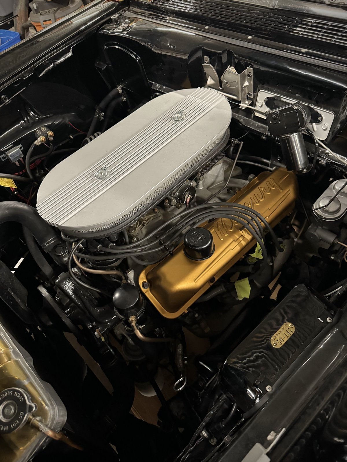

    Well. we are in and ready..... Hopefully I can fire this weekend.... second time is a charm.
    Just dealing with a nasty tooth infection and Pain...
    I got nothing else.

    Might be dumb, but I love the way the fuel line curves around the distributor. It's something like that that shows that despite the patina'd exterior, a lot of time and attention has been paid to the underpinnings.

    Yes!. and invisible upper and lower rad hoses!... VERY hard to find!
