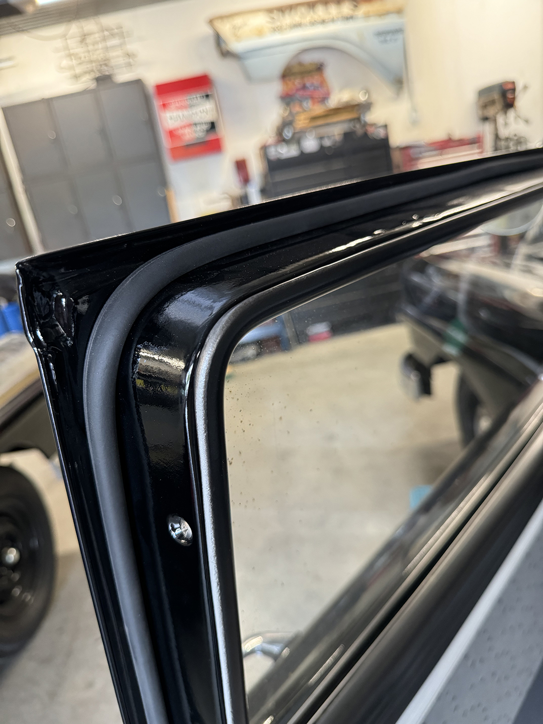

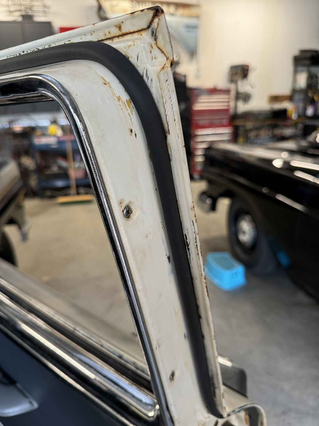

    Reason I mention it is when I bought my 57 it had all brand new rubber, but in boxes. After installing it the trunk closed pretty good, but the doors were awful. Both of them were way too tight, almost binding, and needed a very firm effort to close them. When new these cars were new they certainly didn’t need a break in period for closing doors, they closed right from the get go.

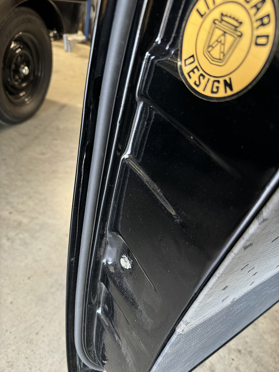

    Thanks Jeff I’m going to try those seals in the front of mine as they’ve disintegrated.

    I completely understand and agree.
    I have heard of some guys breaking gl*** because they have slammed their doors so hard to shut.
    Most have to go to the door striker and move it back a 1/4 to 1/2 inch to get the door to actually engage and shut.
    No Thanks. Not on a painted finished car.... that would be a heartbreaker for me personally.
    I looked for a part number, but I tossed the packaging already.Honestly, just do a search on Amazon... and choose the size and OD that would work best in your application.... Most are less than $20 bucks .
    And if you don't like it.. very easy to remove and no mess.

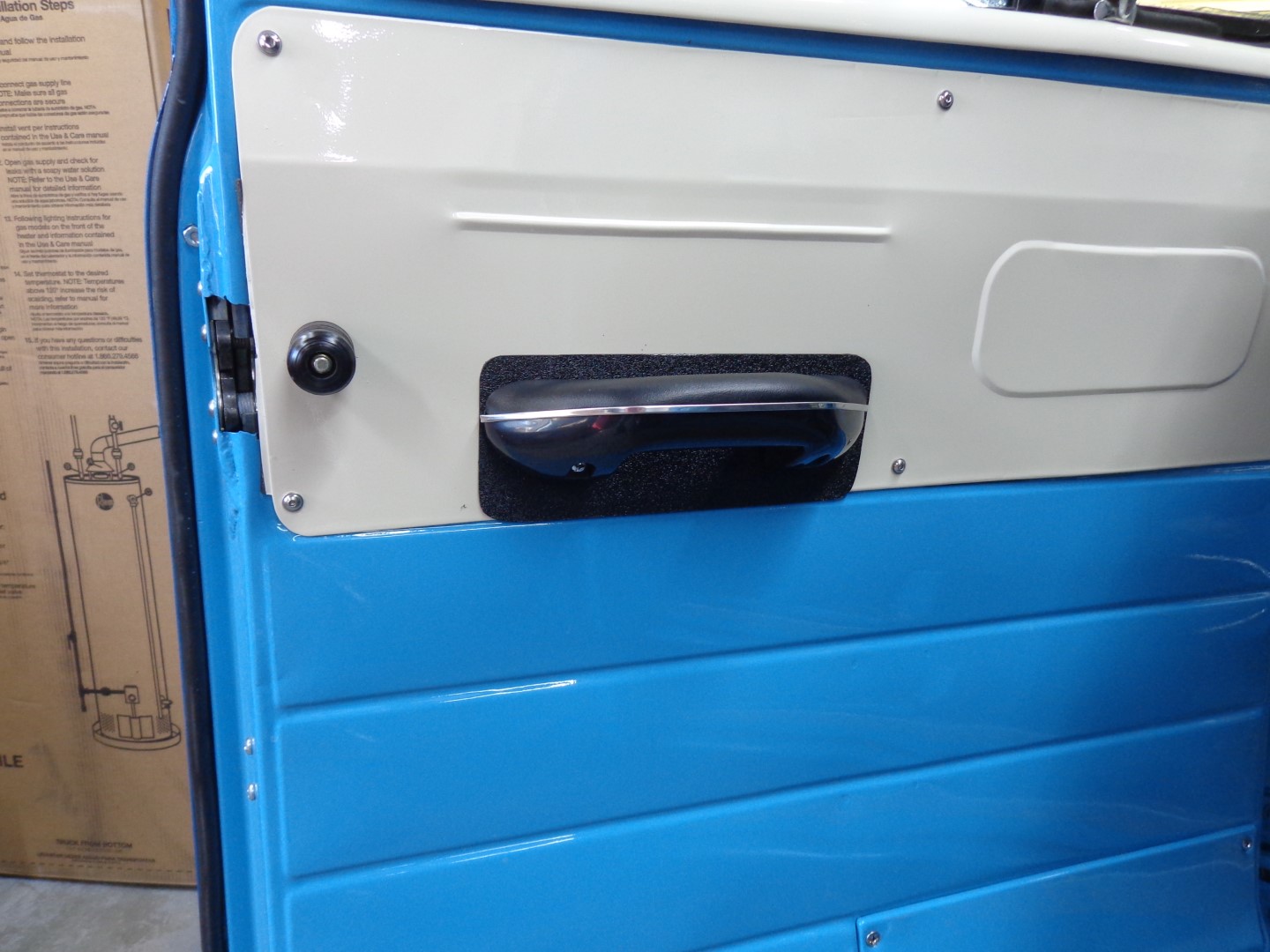

    Anyhow....I have used the door panels...,ripped of the material and used the stock card/masonite/ what ever material Ford used back then....
    My interior guy gave me a good size coffee container of this adhesive cement he uses in glueing his work together... I swear to god its a 2 part rubber cement..... so.....
    I would look locally for an art store that sells commercial art supplies or a professional craft store for a 2 part adhesive,.. with the rubber cement thinner to clean up with.(or simply get some from a local upholstery shop.)
    The door panel stuff(vinyl) I used was given to me by a local guy that built a 55 chevy g***er. Rolls of black vinyl .... so I have used that....
    I may get very lazy and use one of the OEM door panels I have and carry on on this car... hahahaha.
    In your killer build..I would use ABS panels..... they won't get damaged if they get a little wet in wet weather..... My Build and yours are very different(yours is not junk!!!)

    I'm also interested in a part number. I still have one side to do on my Ford, but the 1st one went okay. It pretty much settled down and the door closed easily enough and sealed well.
    I'm going to steal your door card idea. How smooth does the cardboard surface have to be? Did you use a padding under it?

    No padding used.. because that vinyl I used has a very small foam attached to the back.... like a 1/16 thick.... but Your surface of card or ABS should be clean and smooth.
    Hell yea!.. steal away..... Ideas and info are a good thing.

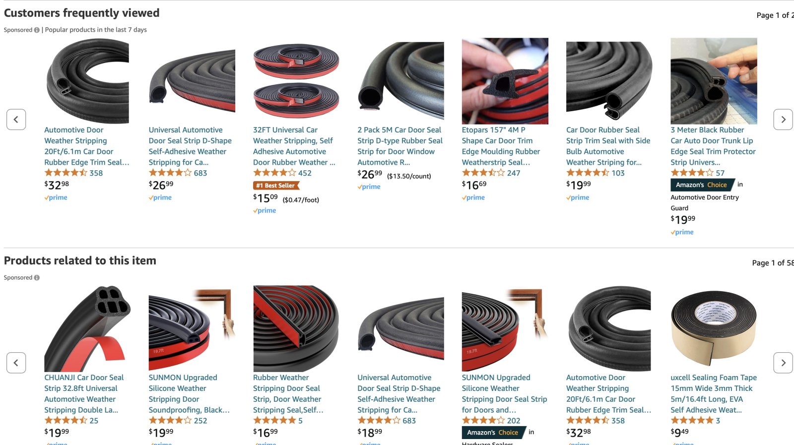

    As I mentioned about the door seals.. just search on Amazon.. you will get a ton of different stuff in diameters and thickness for less than 20 bucks......
    and as I mentioned.. if it nots to your satisfaction.... peel it off and and your good! Better that trying to remove OEM style and that nasty glue adhesive.... thats stuff is just rude.

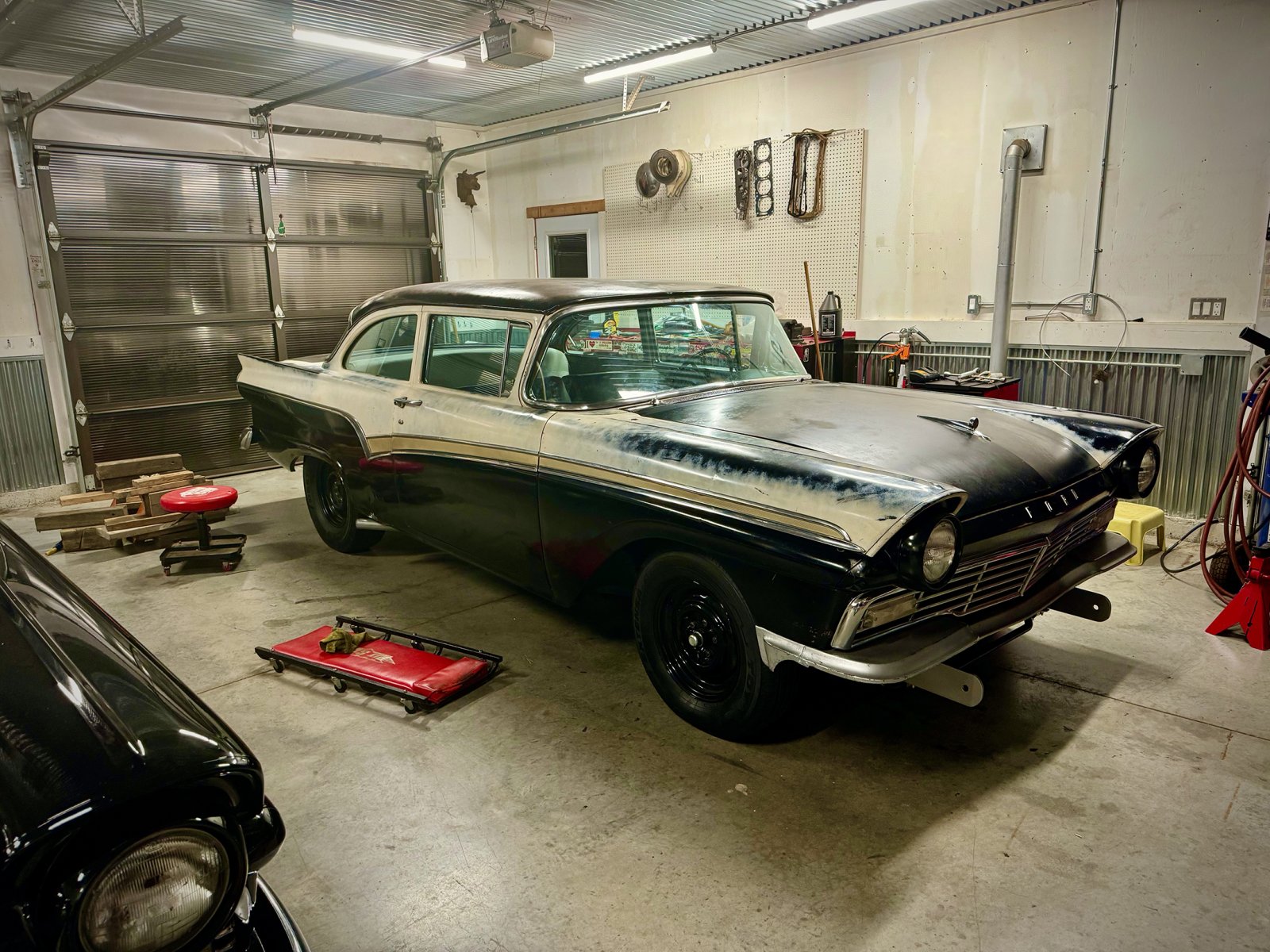

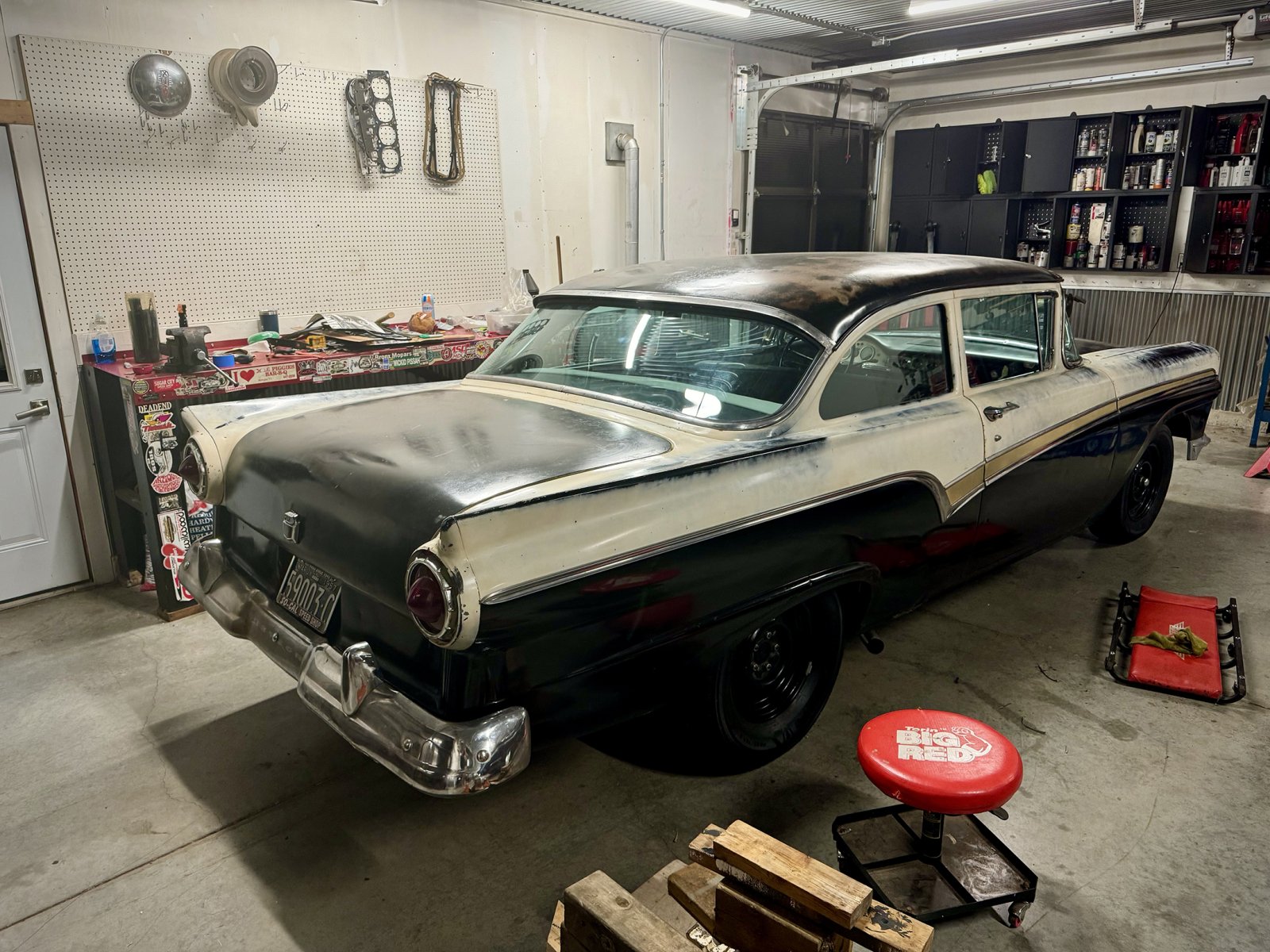

    Well... I think we are gonna call this..done.
    I finally got the gl*** installed.a factory green......
    My mission has been completed.
    I brought a dead Hulk back to life using mostly old Ford parts.It's no chopped n channeled 32 Tangerine Dream....but I am pretty darn pleased how it evolved and turned out.
    sorry,... no vids, or dramatic highway action.I just needed to get it finished....(if thats even a term.they never are finished)
    Had some great help putting this(both 57's) together.. very special friends.
    Pretty sure there will be fix ups and adjustments... but thats just the hobby we live in.
    I had to wrap this up fast as we are moving..everything is going into storage... so I can build a shop....
    so both 57's are being put away for at least until next summer....
    so yea...
    I am just Happy I got this old Ford up and running on the street again after 53 years of languishing at the hands of abuse and time.
    so...
    THE END.
