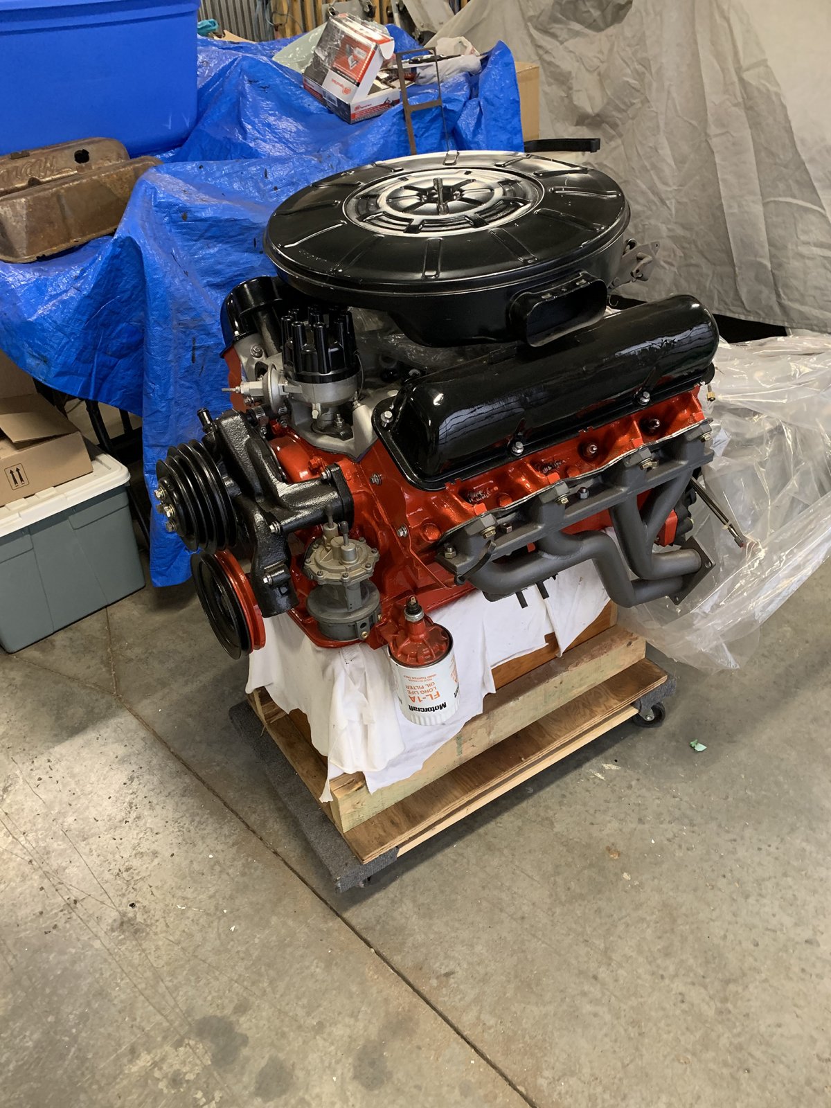

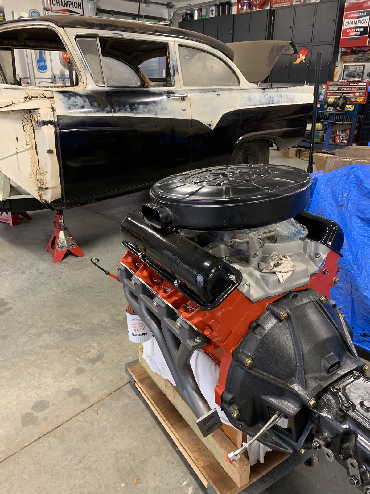

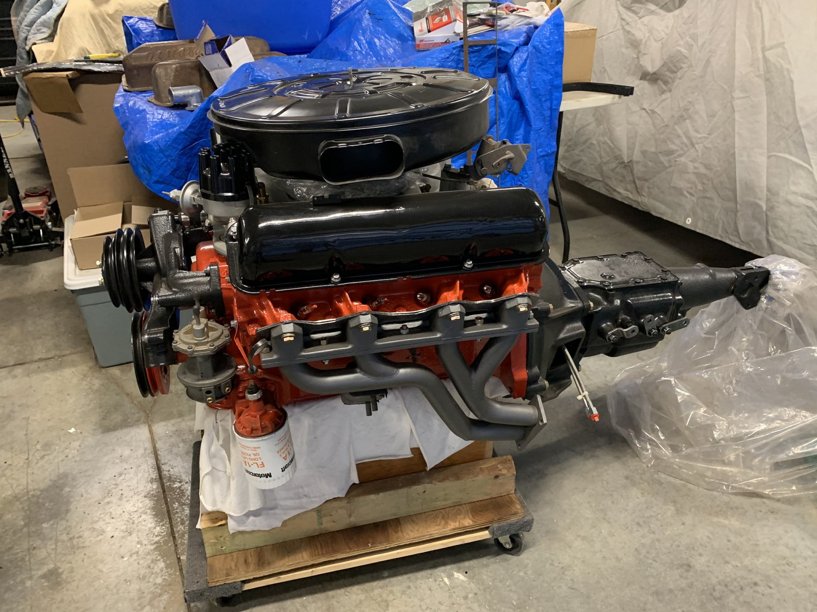

    The Engine/Trans
    A few years back I found a local guy selling a 352/with a cruise-o-matic from a 60 Bird project, where the orig. owner p***ed away.
    Not a big fan of autos.... so I sold it to a friend who needed it for his 59 Ford.
    Found a top loader which from what I can tell is a 68-69 vintage... pushing a 351
    Needed a bell housing.... got a truck bell(way cheaper than a car bell)...$50.Yes. we have talked about the truck bells compared to p***enger car.... basically the truck bell is a bit deeper and the Trans in put shaft is longer.(not by much. anyhow... )mine works and fit together with engagement no problem.
    There are a great many threads on this issue on this board with very helpful insights.....
    As far as I can tell.... my research indicates this engine is a 60 or 61.... it did orig. come with the older bell(auto) and the long style starter..(can't use that in the later style bell I have.)

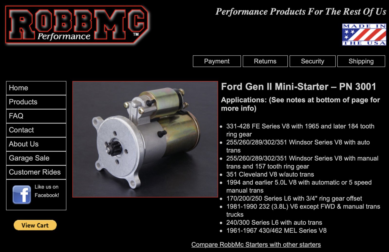

    I can't use a later Bosche style starter because of interference of the Solenoid with the early Hedman Headers..... so..I am pretty sure I am going with the RobbMC mini starter... fully rotatable and very compact..... Made in the USA... not offshore.
    But not cheap.... what is?
    Why a 352?..... well.. from 59-65 using a FE was the hot lick for Ford guys in a 55-58 Ford... yep.. could have done a 390. and I have a good core... but..... this combo just spoke to me.... and I have been always fascinated with the little FE.
    yes.... lots of stories about the 352 were dogs... but after 63.. they were really designated for base engines and trucks.... 390's 406's and 427's were the big dogs and this engine was forgotten.A 1960 HiPo version Haunts me.... maybe one day.
    I have met many guys who make these thing really ring out.
    and if this experiment fails..... I have a 410 Merc Stump Puller waiting in the wings.My intent with this whole car is to make a sleeper from 1960-61.
    Anyhow.I digress.....

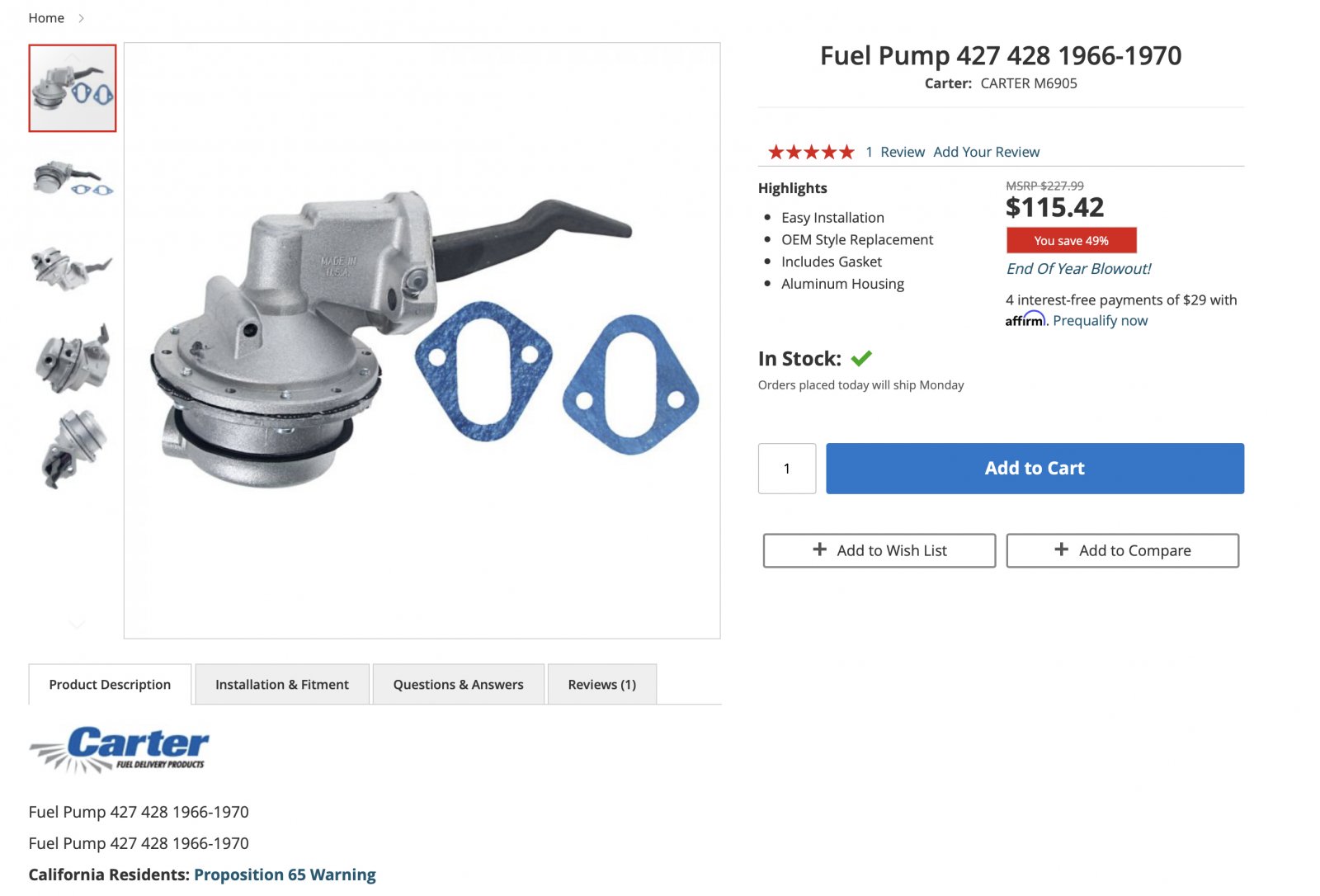

    I am not sure about the fuel pump..... looking at a good Carter unit.... I just not sure if I have enough faith on that oddball stock unit....
    Definitely the RobbMC starter and I will get the stock distributer re-curved from a pal of mine in Philly.
    Lots of small pieces still needed but hopefully it will come all together.

  17. I've had several good running 352's in several 57/58 Fords as well as 2 first gen F-100's. I've never said wish I would have held out for a 390. All were just good drivers that just got with it. I agree with losing the dual action fuel pump, but I never ran the one you show. I chose the Carter CRT-M4008. I like the built-in filter with the large replaceable cartridge. They also make this style for the small blocks.

    That FP looks to be a good choice Wizz and less that half the price.I will look into it.

  19. Doesn't this pump have the small outlet? Like a 1/8" pipe thread?

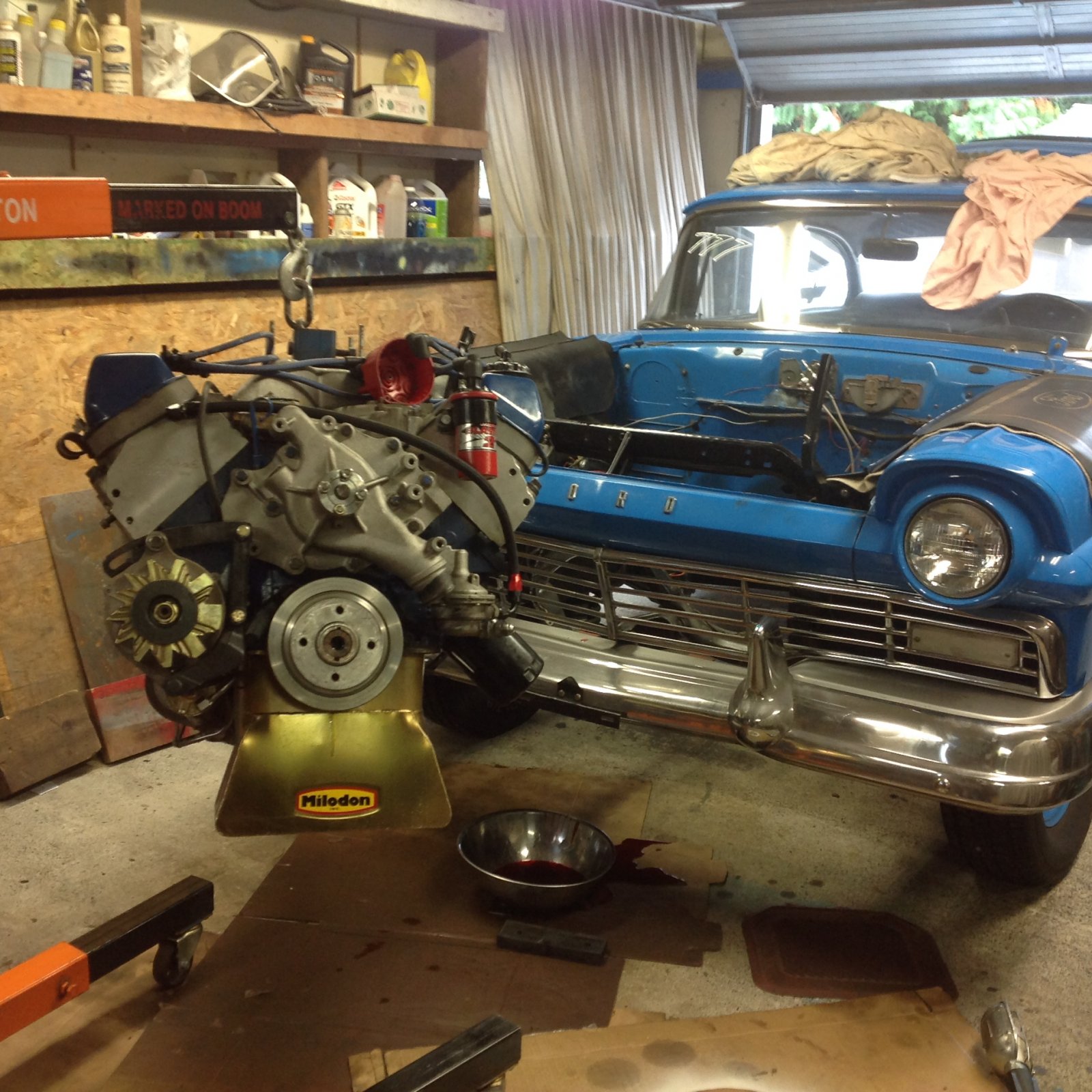

    The lift plate on the carb pad is a non-issue. This is close to 800 lbs. with the c-6 behind it. I've also lifted it a couple times with the old iron heads and exhaust manifolds in place.
    The Carter fuel pump looks like the same performance pump as you can see on my engine. I think they are rated 110 gph? Great pump, has been trouble free for 8 years. One thing you may want consider is going to a 3/8" fuel line from the gas tank to the pump. The pump outlet/inlet on mine are 3/8" pipe thread.

  21. Good question Steve. I went from memory on that specific part number. I believe #DOTZ-9350-A is the 5/16 line but well worth double checking. In fact the first listing may be for a 302. If I remember correctly all pumps for FE are 5/16 line fittings. The multi carb'd FE's had an external canister past the pump for the filter cartridge. Not sure if they went to 3/8 line or not.
  22. I know some of the aftermarket pumps have the small outlet because I've seen them (and bought one). And they generally seem to be the ones with the pictured inlet, not the OEM style threaded inlet. But that also seems to be the only one available with the built-in filter. I had to buy an adaptor to connect the existing fuel line to it on the one I had.
