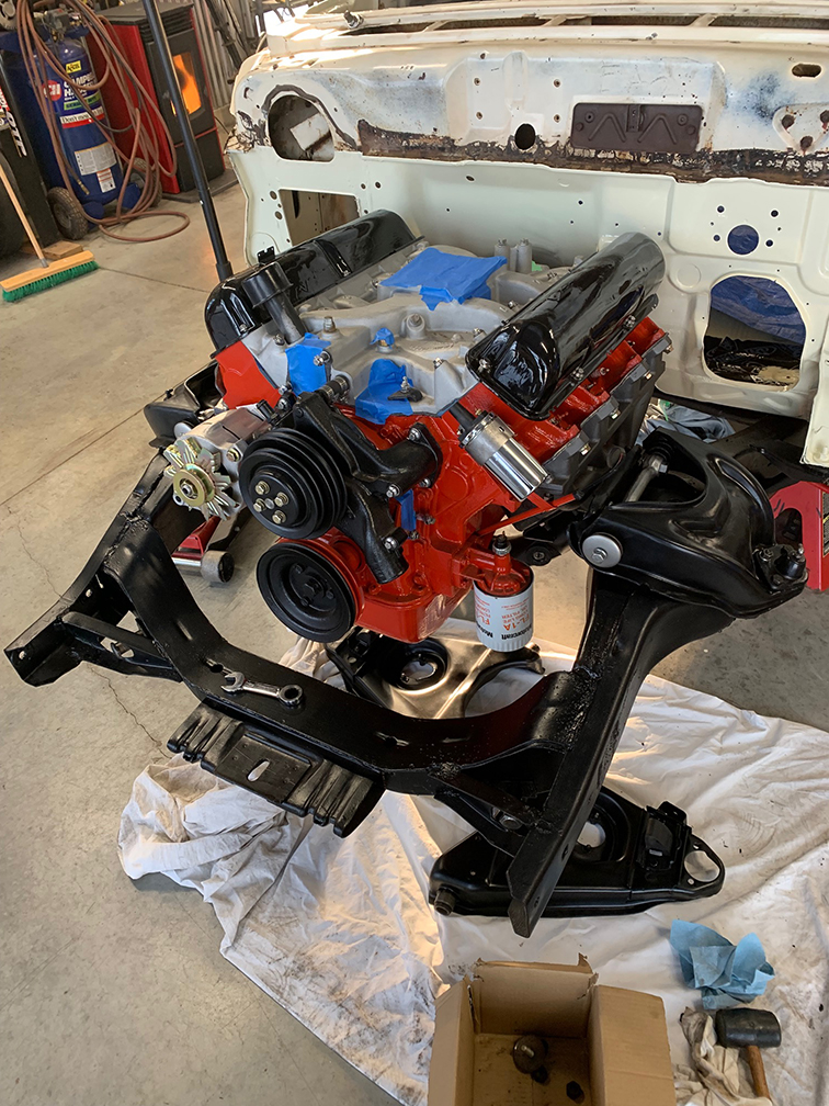

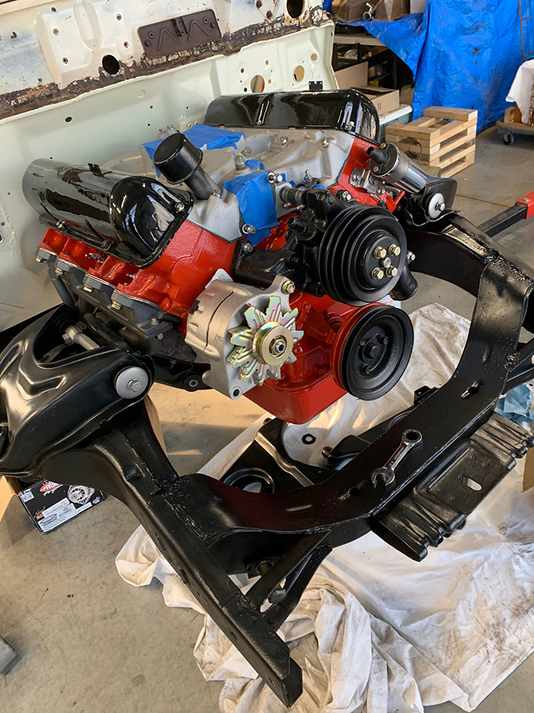

    Engine/Trans in.. front suspension ......next.

    "Hopefully" by late spring... it will roll on its own steam... but.. I don't want to set up for disappointment .

    Slowly moving forward .
    Installed the upper A arms, installing the lower ones today.
    Did some horse trading with a friend and picked up Brand new PowerMaster Alt. Since this engine used a Generator(and I thought about it) I will need to mock up some brackets and such to hang it properly.The boss on the block is not on the face of the front of the engine.... on the side.... not a big deal.

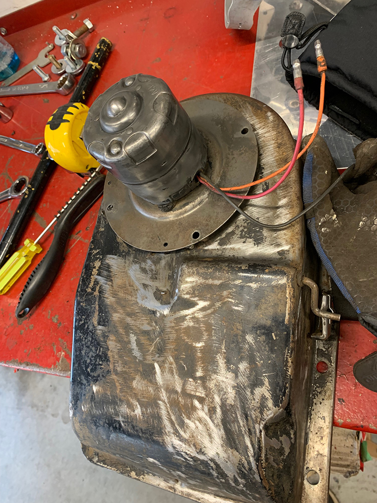

    Dug through a few heater boxes and motors... and found one in good working order, did a 12 volt test and all is fine.
    I'll scuff it and shoot it black.....Just need to find the fasteners.... they are somewhere....
